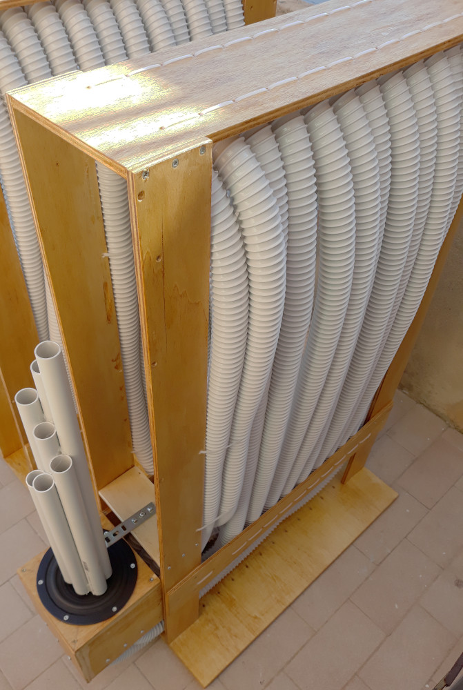

Great project Claudio, Wow.
How would this work with TC9FDs?
In the projects I do not take into account the TS parameters. The prototypes made so far are not optimized for a specific driver and should also work with yours. I don't know the TC9FDs driver, the specifications have a little low efficiency.
The length of the high frequency guides is less than 1 meter and can be obtained by re-proportioning the series of the 21M7 project.
For low frequencies, the logarithmic series for the eight guides in spiral sheath of the 22C71L8 project can be used, re-proportioning it. Increasing the length of all the guides increases the response to low frequencies according to the rule L / 4 for TL.

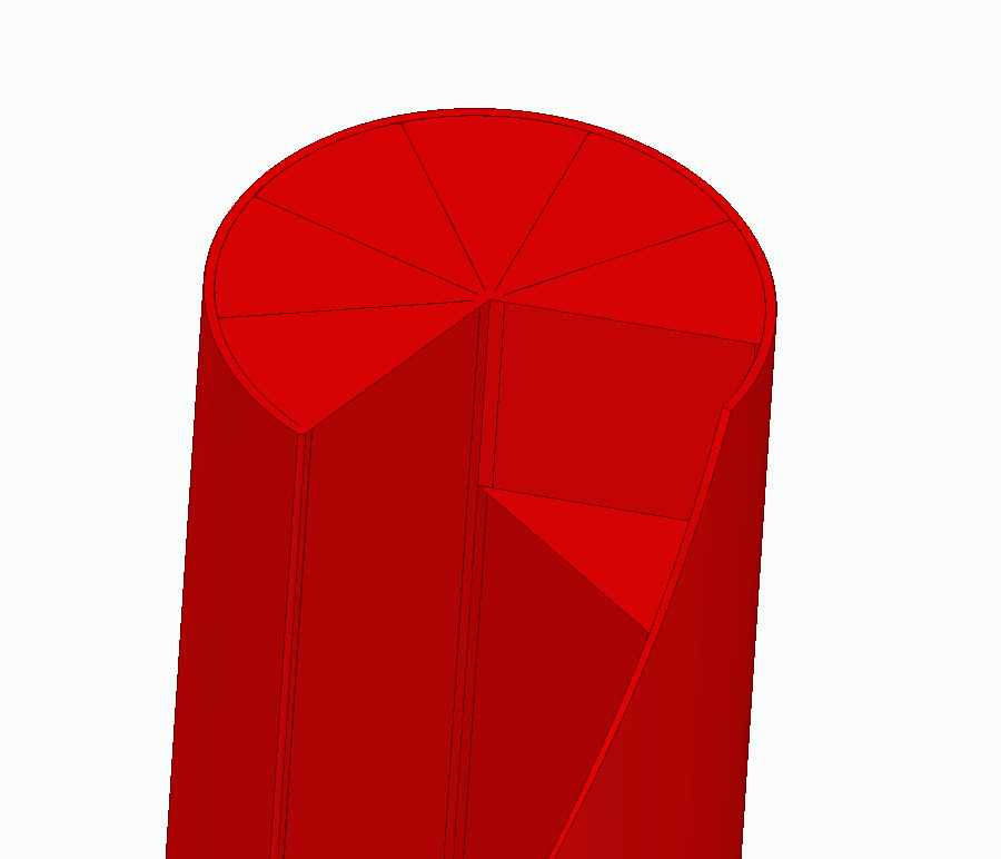

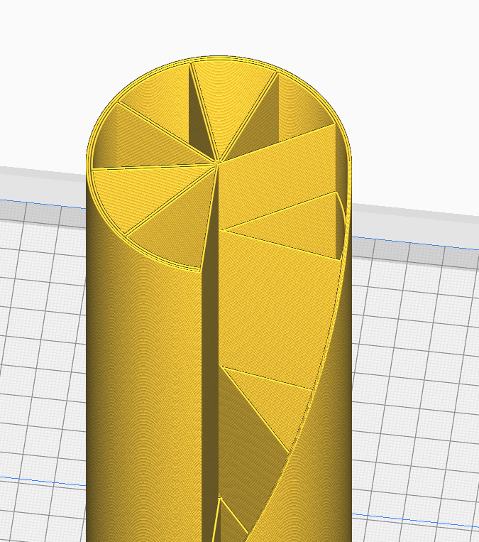

Hello All,
I made a new version of the spiral printable in Vasemode!
Let me know if you prefer another height of the pieces to accommodate your printers.
The base seems to be too big in STL format to upload, but you can find it as a STEP in the assembly.
It should print faster and because of vase mode get a nicer surface finish than the other one, although it does not have the assembly slots that make them latch on to each other so they would need to be glued to eachother... atleast untill i figure out a better solution!

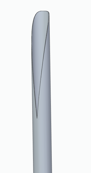

Well it was very much like in post 90.Hi Squeak
I didn't understand the geometry you suggested well (a drawing would be needed). If you propose a single waveguide with small holes distributed on the walls I have already tried the solution in some prototypes with which I started the patent practice, then abandoned (acoustic diffractor and 665g prototype).
The single guide with multiple holes generates coherent and delayed sound wave fronts by diffraction (as in MDD projects) but does not simplify the problems of resonances. Many resonances distributed at different frequencies partially compensate each other. With a single guide you would always have only one resonance that should be perfectly matched with the driver and listening room.
Only the outer turns would probably need to get tighter or else most of the sound energy is going to escape through the path of least resistance.
You’d probably need very little, if any support between the wall of the spiral. Definitely not full length walls since they would just invite the resonant modes you tried to get rid of. If not in the air columns, then in the structure itself.

So basically you mean like only keeping the outer tube but with the "spiral" slit opening?
Edit: just remembered i got tweeters like that https://www.diyaudio.com/forums/ful...onator-0-53x-dual-tc9fds-317.html#post5658102
No your own render is pretty much it: 34c9 a MDD full range speakers.
Not so much a slit as a narrowing of the spiral, towards the outer edge, to avoid all the sound energy taking the path of least resistance.

I am preparing a structure that allows to fix the spiral sheaths of the 22C71L8 project in predefined positions and to change the driver (up to 5 ”) leaving everything else unchanged.
You can reduce the space occupied by using straight waveguides with right angle fittings. The total surface of the sections of the waveguides must be similar to the surface of the driver used. I have not done any tests for now, my suggestion is to use the structure of an optical periscope, with surfaces inclined at 45 degrees at each angle of 90 degrees.
To have a 3D effect, the suggestion is to distribute the outputs of the waveguides in height and depth. The distance between the right and left channel is already sufficient for the lateral dimension.
The isobaric driver has a purpose if you want to carry out the 22C71L8 project with the spiral sheaths replaced by a sealed box. I don't see any advantages if you stick with the rear emission with waveguides. I have not yet made high SPL measurements, I live in an apartment building.
In the "MDD Multi Delays Diffraction (Multi TL, omnidirectional, single drive, ...)" tread I inserted a post on the MMDXH135 prototype. It has an omnidirectional MDDFL front loading for high frequencies, very simple to make, and an MDDBL rear loading for low frequencies that requires more work. I will continue to insert the new posts in the "MDD Multi Delays Diffraction (Multi TL, omnidirectional, single drive, ...)" tread.
The MDDHX135 prototype goes beyond the limits of projects that use the 3FE25 driver of only 3 ". The MDDBL rear loader can be adapted to accommodate even 6 ” or larger diameter drivers. The speaker remains accessible and can be easily replaced by removing the MDDFL front loading.
On the MDDHX135 page I published photos and indications for making a replica. It takes more time for measurements.
The MDD 34c9 project (replicated by pelanj) with the aluminum waveguides is the best aesthetically successful one.
In the thread MDD Multi Delays Diffraction (Multi TL, omnidirectional, single drive, ...) other projects with better acoustics are presented. Greater bass extension and greater MDD effect. The aesthetics are for a laboratory, not for a home. MDD tecnology web site.
Before the summer I will publish other configurations that you can choose from, I already have a prototype on test.
