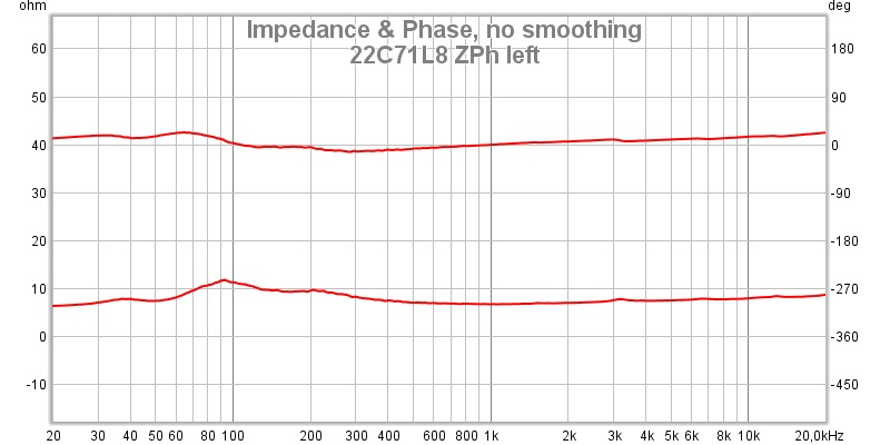

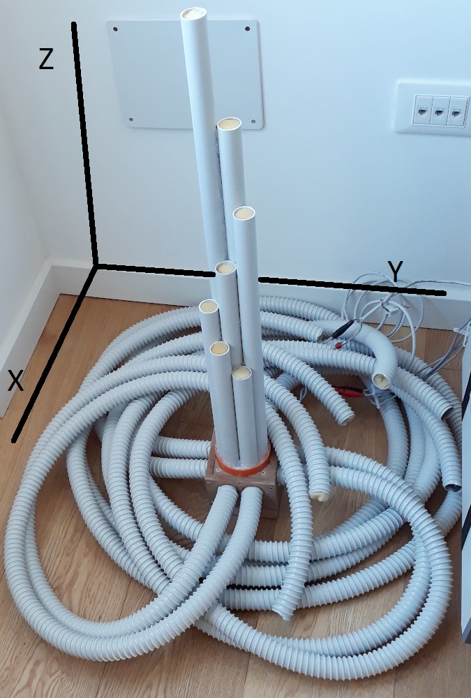

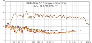

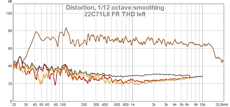

In the photo the 22C71L8 project, I understand any doubts but it sounds really good.

Is that foam stuffed into the exits of each of the ports, and I am still not sure how higher frequencies make it out of the tube without a bunch of smeared time delays? What does the measured step response look like?

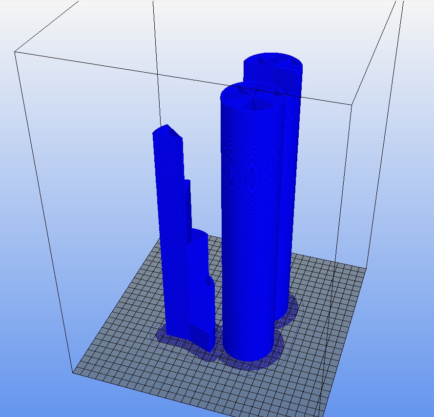

1 meter long round 9 section MDD with 4 mm outer wall thickness and 1 mm inner wall thicknes without the speaker attachment and rounding at 0.3 mm layer with 0.4 mm nozzle would consume 260 m of filament and take 60 hours to print for one piece (and 90 hours with 0.2 mm layer). With some extra for the speaker attachment, it would still be well in one spool. I would print in smaller pieces and one by one. So full 3D printing is actually feasible and with some cool looking filament color, maybe even no surface treatment would be necessary.

Hello all,
I have attached all the 3d printable files needed to print the spiral version seen here.
34c9 a MDD full range speakers.
It would consume about 1,3kg of filament to print one 100% solid. It is made for printers able to handle max height of 198mm.
I just got a 0,8mm nozzle for my printer so instead of continueing with the spiral version i will make another one that will be printable in Vasemode to recuse printing time and filament use.
Edit:Added STEP file for those who prefer that

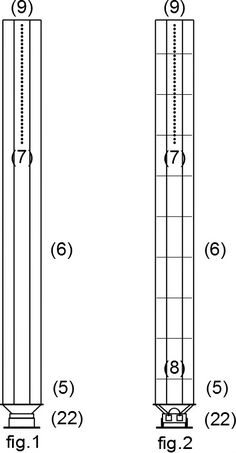

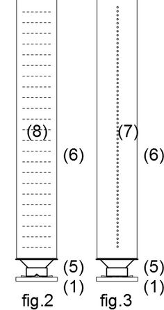

Hi Squeak
I didn't understand the geometry you suggested well (a drawing would be needed). If you propose a single waveguide with small holes distributed on the walls I have already tried the solution in some prototypes with which I started the patent practice, then abandoned (acoustic diffractor and 665g prototype).
The single guide with multiple holes generates coherent and delayed sound wave fronts by diffraction (as in MDD projects) but does not simplify the problems of resonances. Many resonances distributed at different frequencies partially compensate each other. With a single guide you would always have only one resonance that should be perfectly matched with the driver and listening room.

Octopus is one of the names I thought of, even spider is suitable, it has eight legs for the bass and 7 eyes (one is missing) for the highs. Then considering the average life of my prototypes, a few weeks, I stayed on alphanumeric acronyms.
The foam at the exit of the waveguides is almost irrelevant to listening. The effect is evident only in the impedance graph. These are foam cubes of a few centimeters that can be easily removed.
The impulse response graph is not very significant as one of the objectives of the MDD technology is to create a series of coherent delayed fronts that complicate the interpretation. In the 22C71L8 project page you can download the REW file for further analysis.
