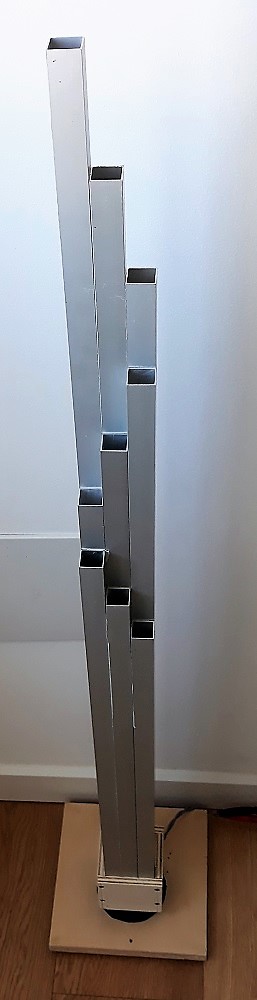

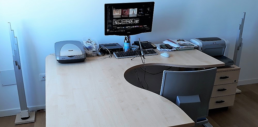

34c9 a MDD full range speakers.
MDD (Multi Delays Diffraction) is an innovative technology for loudspeakers.
MDD uses acoustic diffraction to emit coherent secondary sound waves, delayed by a few milliseconds at different points in space.
The 34c9 project is the first compact version made with MDD technology. Other features of the 34c9 project:
- zero internal acoustic reflections,
- sound insulation from the floor in the audio band,
- omnidirectional emission on the horizontal plane over the entire audio band,
- no damping material,
- 3FE25 speaker from Faital-Pro.

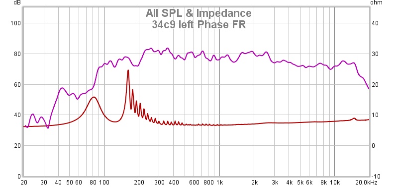

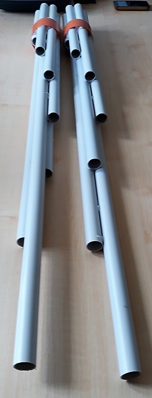

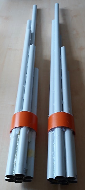

I used rigid pvc round guides in the 227h project .
The easiest configuration to make is with seven guides, one in the center and six on the diagonals of a hexagon. In each diagonal three guides are aligned, in this configuration in a 6" driver you can use 2" guides, with a 15" you can use 5" guides (You can complicate the configuration using different diameters). With seven guides I suggest using this logarithmic series for the lengths: 552, 610, 673, 743, 820, 906, 1000 mm.
And all copper or brass
Copper and brass tubes (smooth inside) are suitable to work as acoustic waveguides, if you have them available it's fine. Given the value of the metals I would do before tests with rigid PVC which is less expensive. The system can be made adjustable by sliding cardboard tubes inside the rigid ones. Once I found a satisfactory configuration I would pass to the definitive one in metal. 

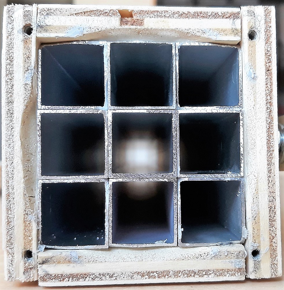

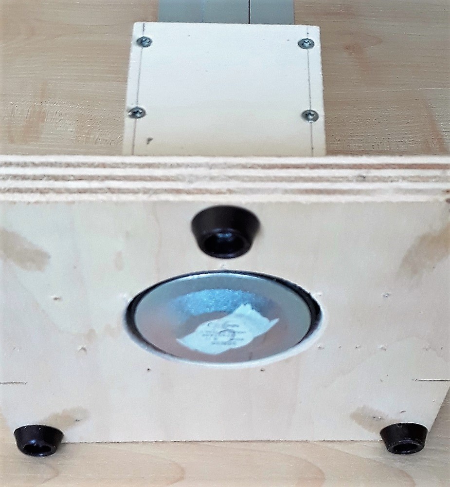

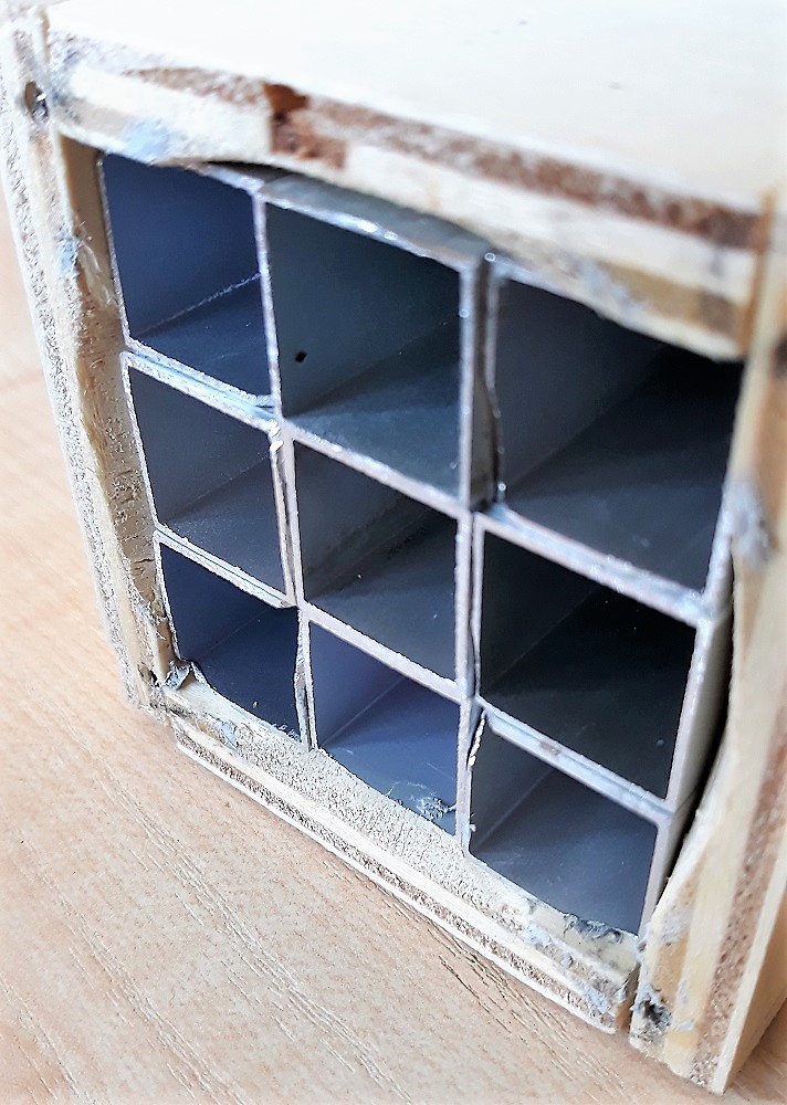

I have first two questions - just to be sure how it is made (to clear my understanding of your description).

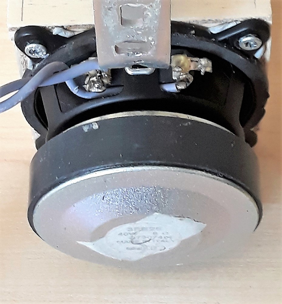

1. the square holder for the pipes has no bottom, the speaker is screwed directly on to the sidewalls. And the holes around the frame are sealed by a sealant - what would you recommend to use? I think silicone or hot melt glue should work.

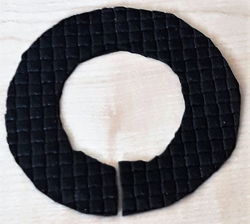

2. the polyurethane ring at the base is a fit on the magnet, so when the whole thing swings, it slides on the magnet, to create a kind of seal. Is that correct? Do you have any suggestion where to get this foam from?

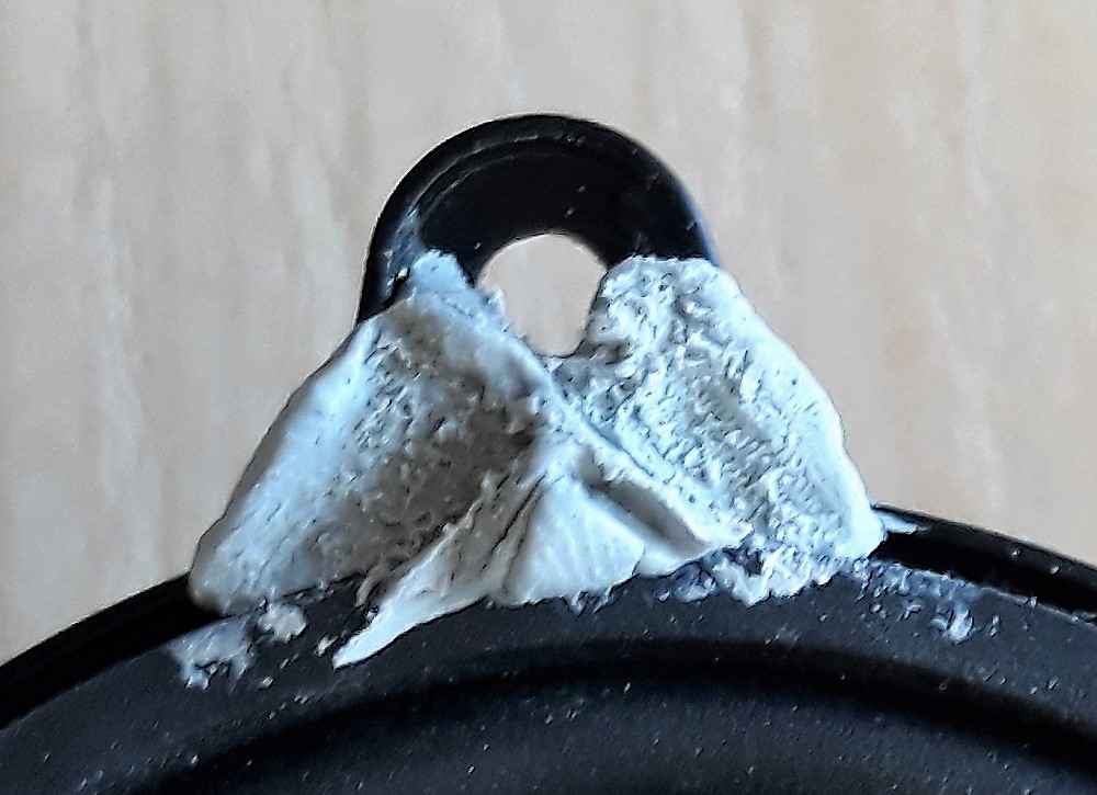

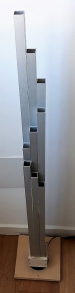

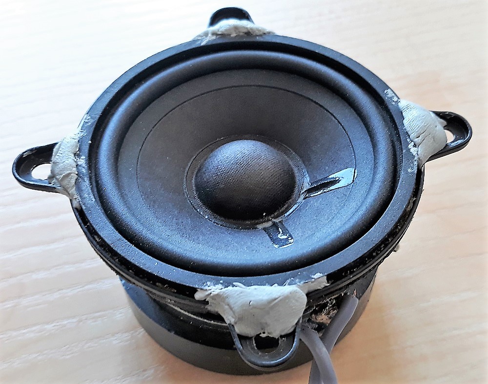

Attached are some photos that I also published on the site to better clarify the assembly. From the enlargements the defects of the manual workmanship can be seen well. The inaccuracies in the workmanship do not create problems if there is the air tightness between the loudspeaker and the guides.
  • the support is a wooden pipe with the internal sides slightly flared (2mm) to prevent the foam of the cone from coming into contact with the corner at the center of the inner side.
  • the speaker is screwed directly onto the sides, the four holes are visible.

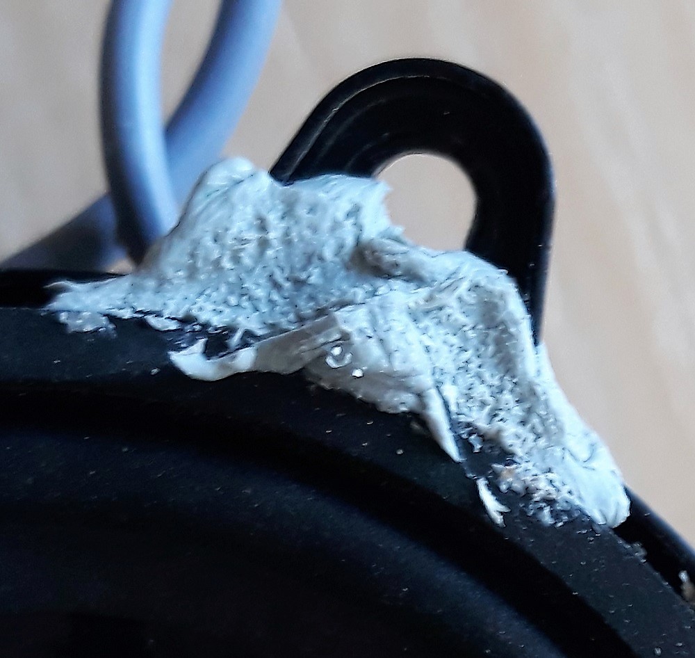

  • I used a built-in steel sink sealer that always remains soft, it can be reused in case of disassembly by reshaping it. Trade names: butyl sealant, Sikalastomer, Elastuk, is similar to plasticine used by children. Silicone and hot glue must be replaced if disassembled. Attention, the hot glue is very tough and can break the gasket of the loudspeaker in case of disassembly.
  • The polyurethane ring has the aesthetic function of covering the crack, I have repeatedly started listening to music forgetting it and I have not detected any difference. It can be replaced with fabric, rubber or cardboard, the important thing is that it does not interfere with the oscillations of the guides.
  • Passing from 1 to 1.5 mm the internal section goes from 18x18 to 17x17, I don't think it produces detectable variations to listening. There is the advantage that you have more material to round the upper edge of the guide which can be sharp.

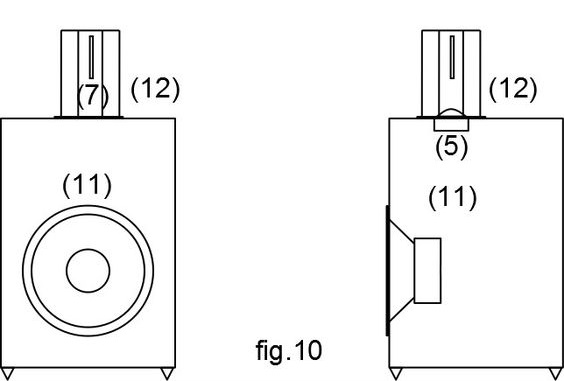

so it's essentially the same concept as a shotgun microphone filter tube assembly used in reverse,no?
No filter. It is easier for me to list differences than analogies. The microphone is a strongly directive device that works using negative interference between sound waves for different angles from the one desired. The 34c9 project has an omnidirectional emission using the phenomenon of acoustic diffraction (Huygens principle).
