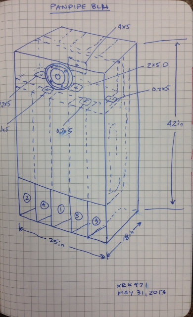

Interesting project! I had a similar idea but different length pipes for the back loaded horn.
The PANPIPE (Pentahorn) BLH Speaker
351904d1370032907-panpipe-pentahorn-blh-speaker-panpipe-dwg-2-jpg
Unfortunately, I never got around to building it.

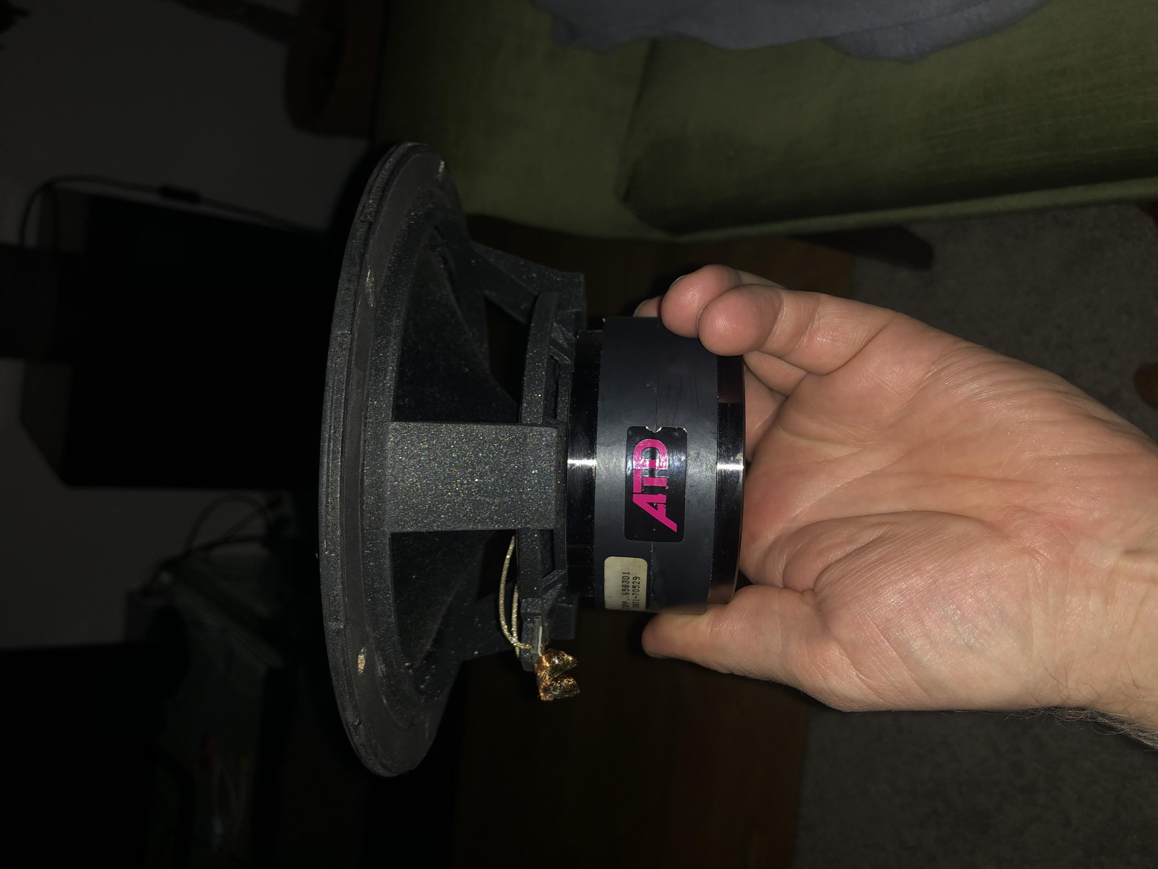

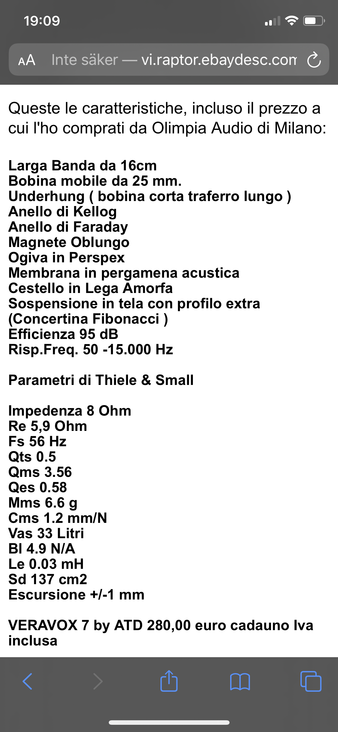

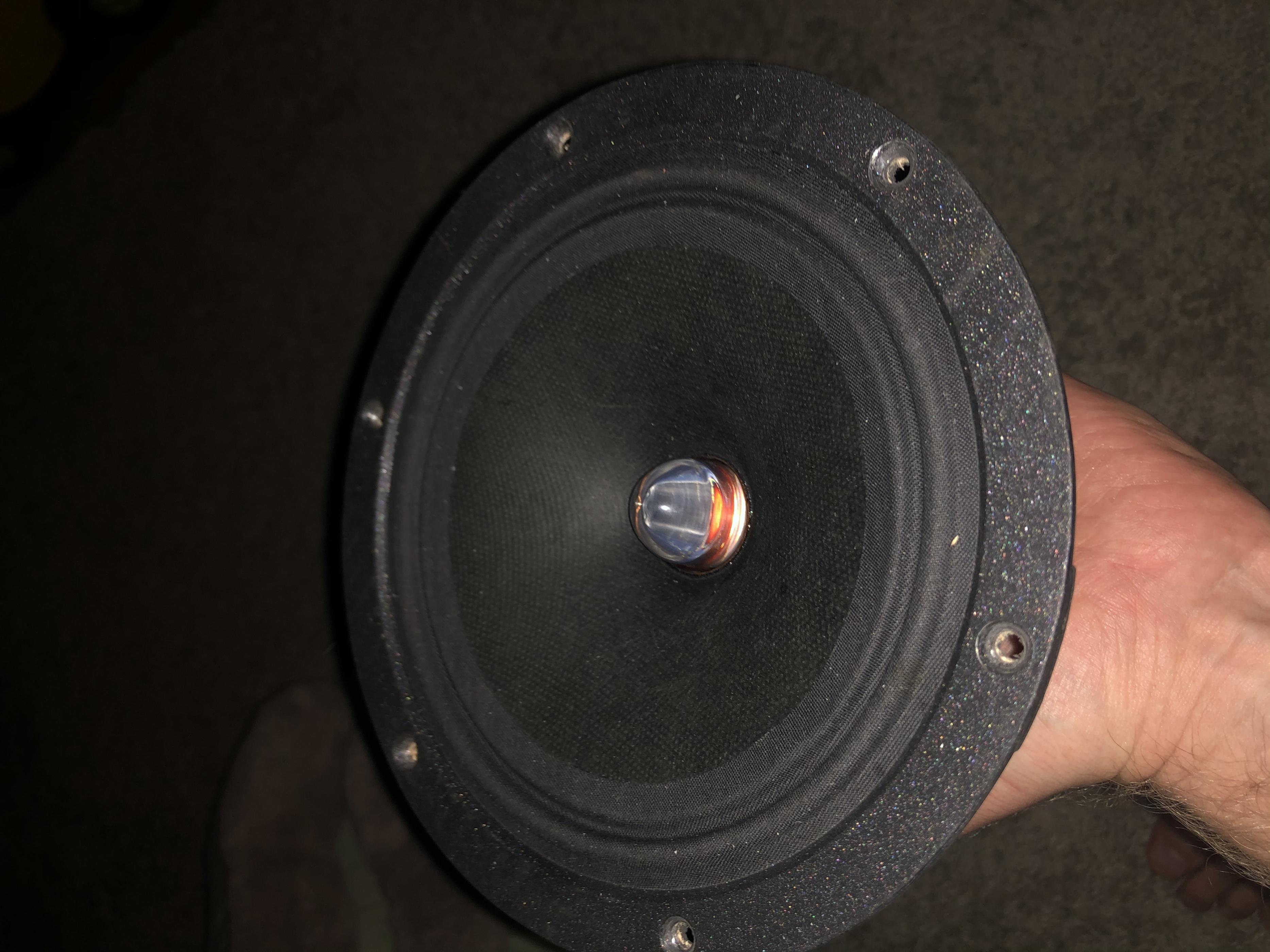

I would like to try and make a MDD for ATD Veravox 7 driver, it’s a 7” fullrange unit (italian make �&#56841😉
My wish is to mate it with a subwoofer so it only need to reach 80~150hz.
What model should I build? Can I expect the mids and highs to be as resolved as a direct radiator driver?
The woofer section Will be either tapped horn or dipole.
XO Will be active.
Some pictures and some parameters for Veravox 7

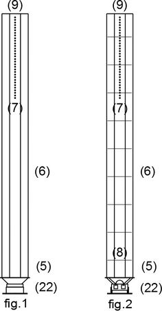

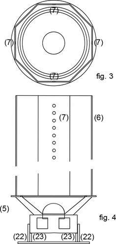

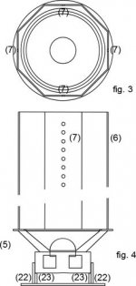

Hi Pepe
I have not yet made MDD prototypes with drivers with a diameter greater than 3" and the following considerations are hypotheses to verify with 6" drivers. Before switching to larger drivers, I still have a couple of configurations to check with the 3FE25 drivers.
The final section of each waveguide can be thought of as the surface of a flat tweeter facing upwards. At high frequencies (wavelength less than the diameter) increasing the diameter increases the fraction of energy sent towards the high and decreases the sound energy sent horizontally.
At diameters of 1, 2, 3, 4, 5 cm the frequencies 34.1, 17.1, 11.4, 8.5, 6.8 KHz correspond. Geometrically on a 16 cm cone, square matrices 3x3 x 5 cm, 4x4 x 4cm or 5x5 x 3 cm can be constructed. Even with seven 5 cm circular guides you can easily build an MDD load.
With smaller diameters, 1 or 2 cm the construction is complicated but there is an omnidirectional high frequency diffusion, already tested up to 15 KHz.
With large diameters the construction is simplified but there is the risk of attenuating the higher frequencies at the listening point, however the listening could be good due to the effect of coherent and delayed secondary waves. Your mono listening indication is special and I don't know how you will use the system. The horizontal emission can be increased by drilling holes in the final part of the free walls of the waveguides, fig.1 and fig.4. It could be enough 10 cm with 3 mm holes. The holes can be replaced by a line or a K-tube type profile.
If you want to experiment I recommend the use of PVC pipes for hydraulics or electrical systems, the material has low costs and is easily available.
If you want a system with a neat appearance and secure audio features you have to wait for the further development of the MDD technology.
