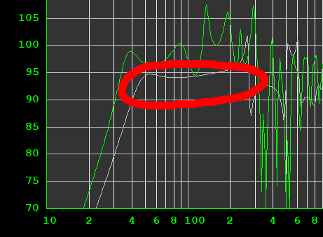

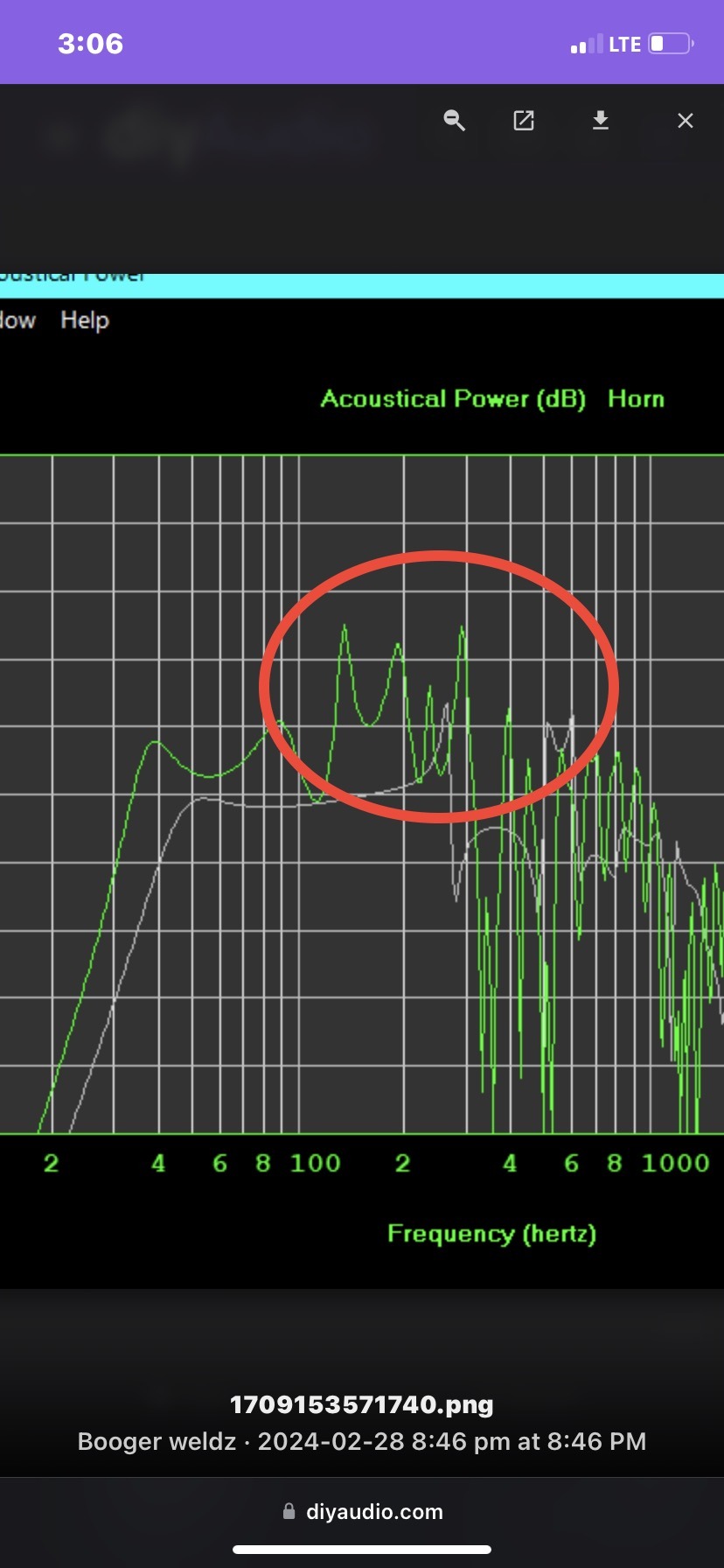

It doesn’t ‘suck’, anymore than the you drivers don’t purchase and speaker boxes you still haven’t made 😝
they easily survive in those really demanding/harsh/fatiguing sounding paraflex designs we experimented with for awhile... but nothing sounds particularly ‘good’ in those(??) so who knows if a ‘tapped horn’ is going to sound any ‘better’ when those are just a mess of resonances and cancelations after 3 x Fb where the paraflex version fills it all in? (But paraflex has no bottom end , and rolls off from like 50 hz on down ??)

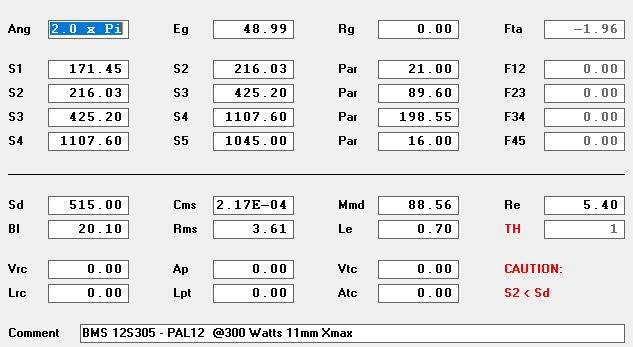

I found a demo BMS 12S305 at 50%off, same cost of a DDX12
I will hit the trigger on it
https://www.bmsspeakers.com/index.php-33.html?id=bms_12s305

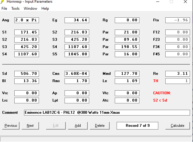

so that means is for like a HT small cube like sub, not a horn like the PAL12These low Q numbers = smaller enclosures!
Electrical Q Factor: Qes 0.278 Total Quality Factor: Qts 0.265
ok the LAB12 have
Electromagnetic Q (Qes) | 0.39 |
Total Q (Qts) | 0.38 |

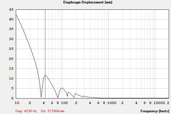

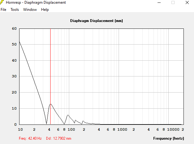

ok the LAB12 can take only 150 watts to reach 12.8mm XMAX
the 12S305 can take double... 300w to reach xmax of 11mm
Small enclosures in general.so that means is for like a HT small cube like sub, not a horn like the PAL12
ok the LAB12 have
so means that i need to find drivers with Qes and Qts above 0.35 at least ?
Electromagnetic Q (Qes) 0.39 Total Q (Qts) 0.38
Drivers with Q's <0.30.

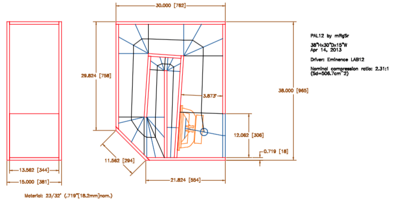

Ok from post#1 in this thread we got the specs of
Now that the sub is constructed and tested, we can post some final specs.
Operating frequency: 34Hz----120Hz +/-3db
Dimensions: 30"x38"x15"
Impedance: 4 ohms
Power handling: 400w rms, 800w program High pass 32Hz 24db/octave minimum"

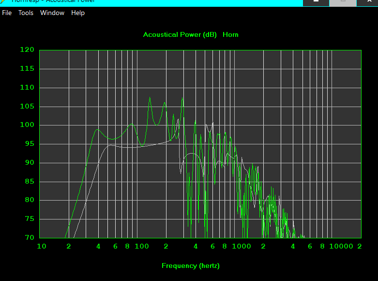

How come you can feed 800w to the LAB12 and on the HR sim it hit xmax at 150w, what i am missing here 🤔
