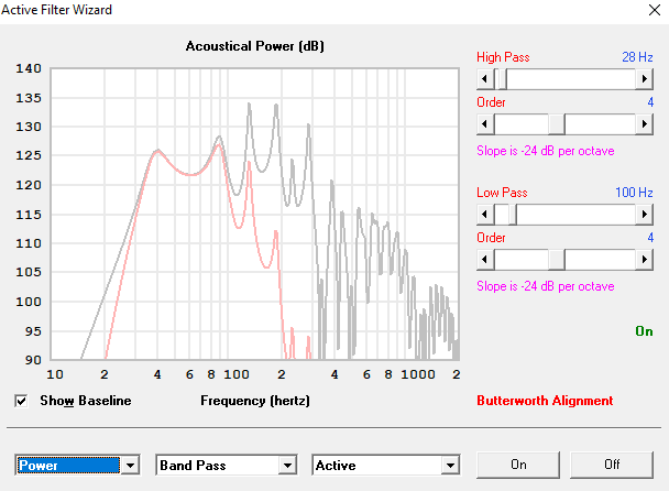

Your closed box cabinets would be a better choice for very low frequency reproduction (below 20Hz) than a 36Hz Fb TH like the one this thread is about, which is more than -24dB down at 20 Hz from 40 Hz.

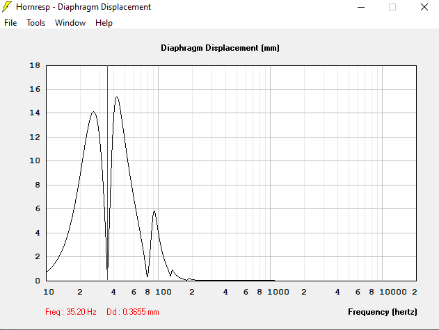

In the Hornresp simulations in post #6, you can see the excursion minima (Fb) of the TH is around 36Hz, and the horn path length around 3 meters long, roughly 1/4 wavelength. Below Fb, the front and rear output become out of phase, the excursion goes up while output drops.
Doubling the path length of the horn would lower the response around an octave. The Danley DTS-10 is an example of a TH with an Fb around 18Hz using drivers similar to the LAB-12, with dimensions of 59.5 x 44 x 16 inches.
A 5 Hz tapped horn is theoretically possible, but would require around 17 meters of horn path, a huge enclosed volume, and would only remain "clean" and "coherent " up to around 20Hz.

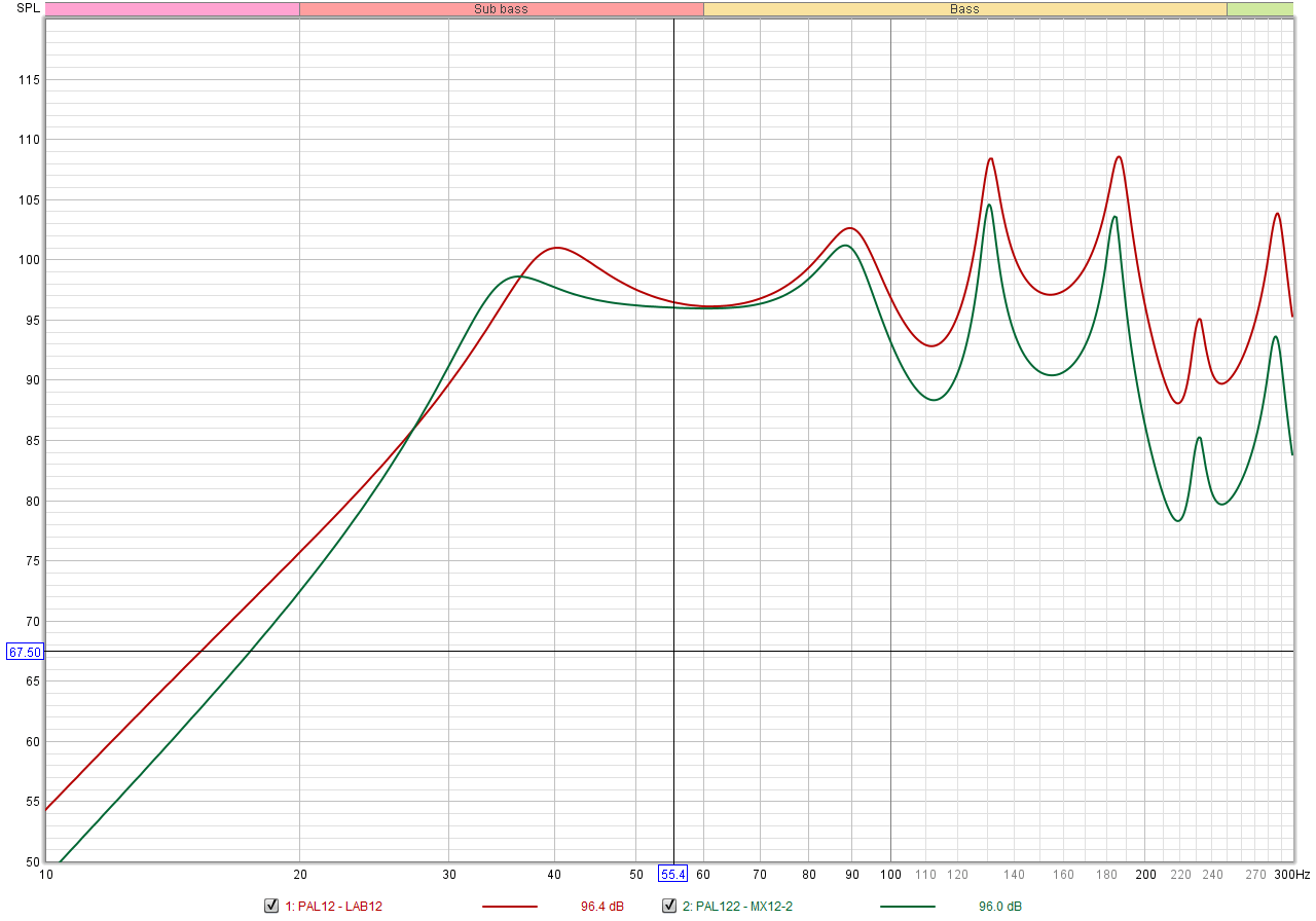

The pricing is indeed attractive which brings them closer to the original $325 price point. I wonder how well the Dayton holds up versus the Lab12. Definately like the idea if the rubber surround on the Dayton but like the Kevlar impregnated cone on the Lab. In other words, I wonder of it can it take the pressures in a professional application.
Here's how the two compare in the PAL12 - LAB12 in red, MX12-2 in green. Theoretically you give up a bit of output at 40 Hz and gain more output below that. And the MX12-2 has 6mm more Xmax than the LAB12, so overall you should get more output than with the LAB2 if you feed it more power.
Of the two however, I'd probably build neither, unless I had the drivers on hand and I wanted to build a TH with them.

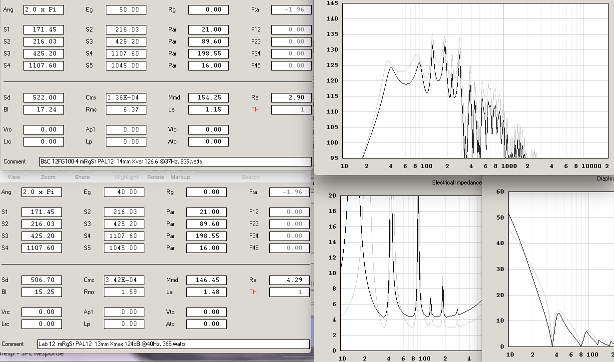

Wasn’t aware of the B&C 12FG100-4, but it’s higher FS of 34Hz compared to 22Hz for the LAB12 is quite a difference. The physical differences are enough that the 12FG100 won’t be a “drop in” replacement for front mounted applications.
The 12FG100-4 bolt circle is the same as the LAB 12, but it’s baffle cutout diameter (and Sd) is slightly larger, so a retrofit in mRgSr’s PA12 would probably require a slightly larger cutout to keep the surround clear of the opening.
The B&C 12FG100-4 (light gray lines) models well in mRgSr’s PA12 design:
LAB12:12FG100-4 PA12.png
Given over twice the power (839 watts at 50 volts at the impedance minima of 2.98 ohms to reach Xvar of 14mm, vs. 365 watts at 40volts into 4.38 ohms to reach Xmax of 13mm), it appears the 12FG100-4 would have greater output potential with a bit more extended and smoother response than the LAB12.
Given the larger voice coil and additional cooling vents, the power compression from voice coil heating would probably be less for the 12FG100-4 at those power levels.
