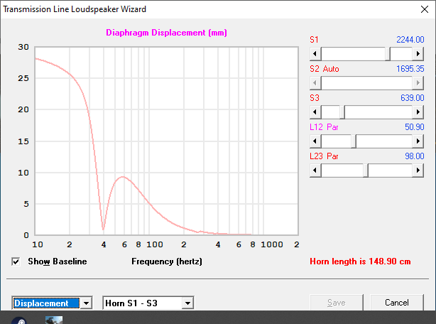

The sim just for you!Has anyone tried modeling this sub with the Eminence Kappalite 12" ?
(I haven't yet learned how to model horn subs.)
Now that I have some pretty good 2 x 12" reflex subs (Thanks again, Art !) I'm ready to try a TH design, but it must be as light as possible and I'd love to be able to use my existing Kappalite drivers.

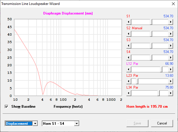

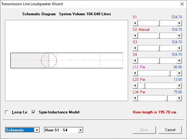

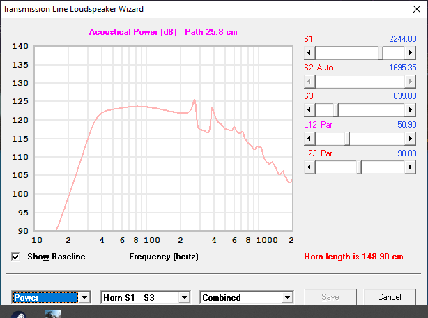

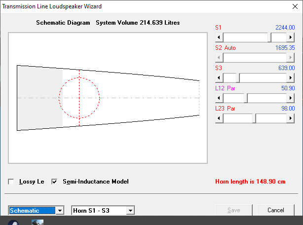

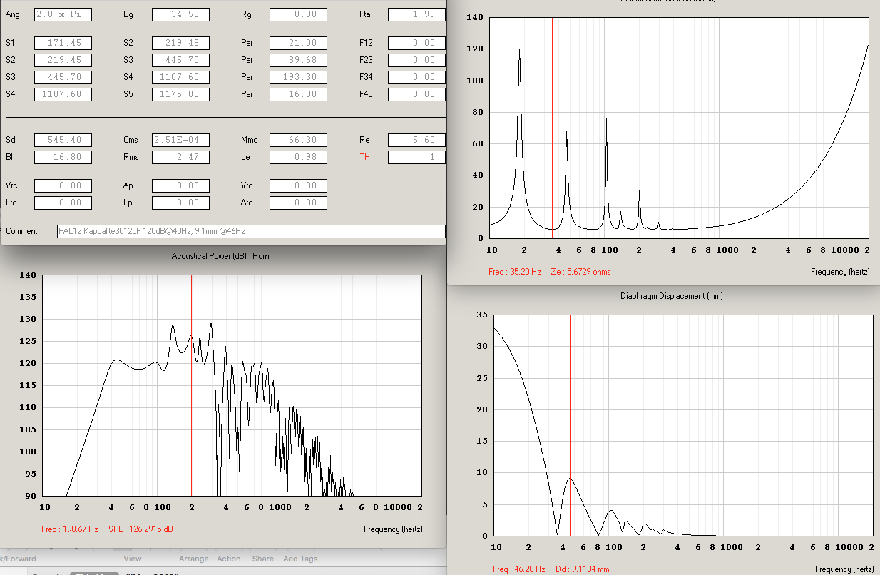

The Kappalite 4012LF can't take much power without flapping the cone in this design.
The 4012LF is great in small BR, not so good in a large low tuned TH, output to enclosure volume is poor.
At 34.5 volts, about 210 watts into the impedance minima of 5.7 ohms, reaches Xmax (9.1mm).
Looks pretty flat from 40-100 Hz, but only 120dB, not much for a 10 cubic foot box.
A pair of these loaded with the Kappalite 4012LF would be larger (and heavier) than a single Keystone or Xoc1 TH18, but have around 4dB less output.
I'd suggest adding more of your "pretty good 2 x 12" reflex subs" and some "barn doors" if you want more output and want to stay light.
Art

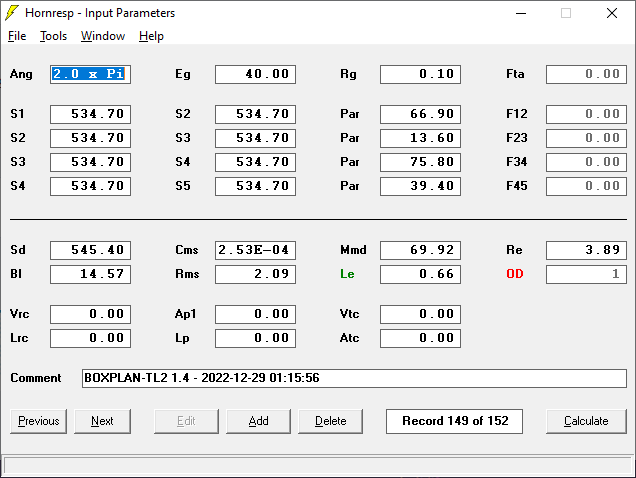

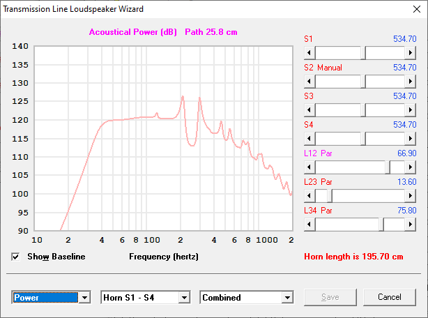

120dB is the same amount predicted for the 3012LF in a straight ODTL that's a lot smaller, albeit at a higher voltage. And the passband is wider and smoother.
