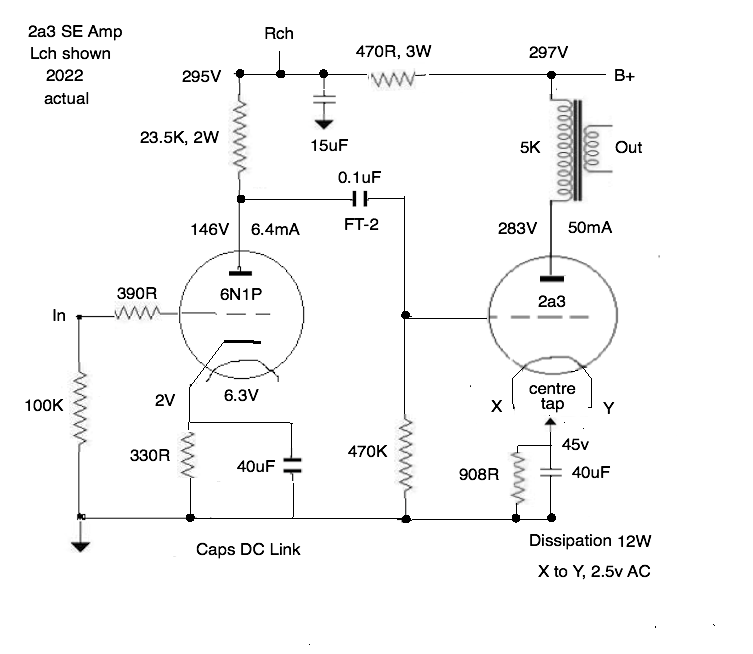

I'm in the process of renovating an existing 2a3 amp with no room for more complex solutions. My own system uses a 10Y driver with 1:4 step-up on the input, Hammond 1140-LN-C from their broadcast series. That's as good as it gets for me after throwing the kitchen sink at 2a3 drivers. But for the renovation I want to use just a single double triode driver with a mu of 25 or more so the amp can be integrated with no pre needed. My past experiments are as follows:
So once the amp is set up I'll try 6N1P, E80CC and E180CC. Simple circuit, anode and cathode resistors with DC Link bypass.
Anything I've overlooked in 9 pin double triodes?

Well, I got the 2a3 amp working with 6N1P driver and it's rather good - better than I expected. I substituted some 5K Techno OPTs for the 2.5K Hammond ones which were huge and heavy, and I really need more B+ like 350V whereas I have just 300V. The 5K OPTs are fairly small and probably only good for 45mA-50mA. Just guessing since I don't have the specs. So right now it's giving 12W with 50mA current. Needs to be 15W or close to - I can try taking up the current a little. Good parts - Holco resistors and teflon FT-2 coupling caps and DC Link for bypasses and last cap in the PSU. Excellent Hammond iron, big choke.
Sound is kind of "fruity" and dynamic. Quite involving. Detail is OK though not micro-detail. Probably best on jazz and popular music, though classical music is OK too. Voices are good. More dramatic than a 6SN7 but not as neutral and not quite as detailed though it's close. Much to like. I was pleasantly surprised.
Schematic attached.

I really like 6N1P-EV tubes. I first used them years ago when I started building tube amps. My first few amps were Decware Zen SE84C clones. Your schematic shows one half of a 6N1P as the driver for the 2A3. Is the one triode sufficient to fully and properly drive a 2A3?Well, I got the 2a3 amp working with 6N1P driver and it's rather good - better than I expected. I substituted some 5K Techno OPTs for the 2.5K Hammond ones which were huge and heavy, and I really need more B+ like 350V whereas I have just 300V. The 5K OPTs are fairly small and probably only good for 45mA-50mA. Just guessing since I don't have the specs. So right now it's giving 12W with 50mA current. Needs to be 15W or close to - I can try taking up the current a little. Good parts - Holco resistors and teflon FT-2 coupling caps and DC Link for bypasses and last cap in the PSU. Excellent Hammond iron, big choke.
