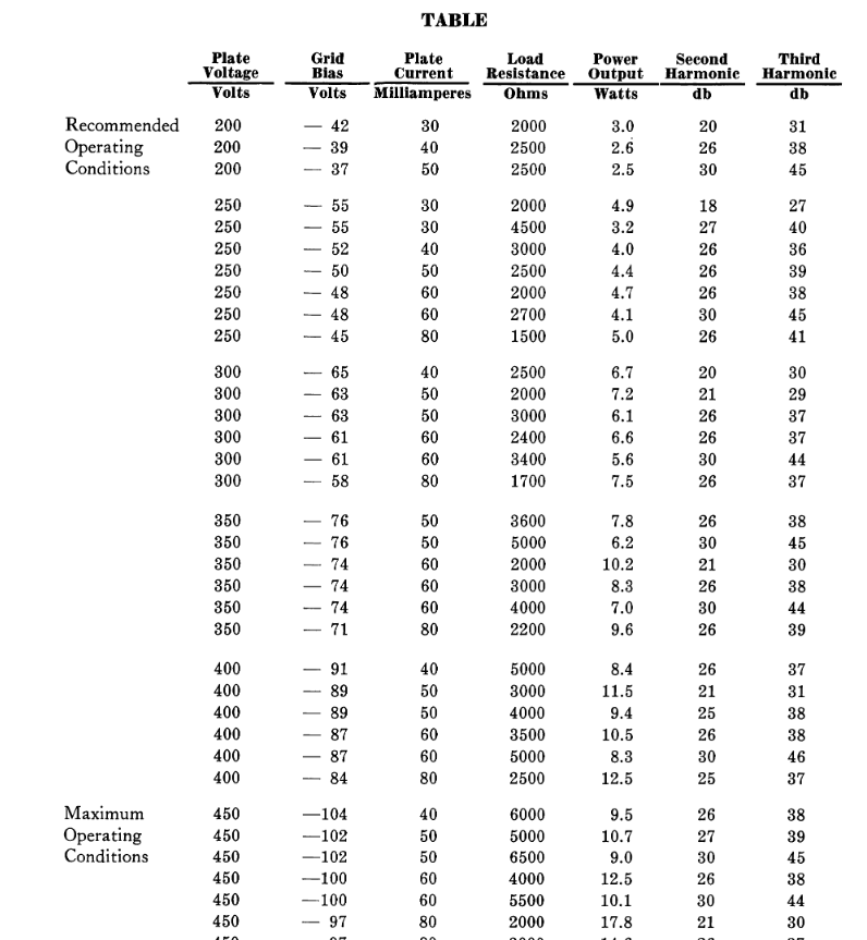

With (Z1/Z2) = 5k/5 = (n1/n2)^2 = 1000, if Z2 = 8, then Z1 = 8K! So much for your 5K transformer, and perhaps you have gone further than Sakuma sanin exploring alternatives...what is/was your loudspeaker Z when you did that?

I think the other posts have covered this. Speakers were Mission 761, 6 ohms nominal. I never got the 300b to sound as good as a 2a3 so ditched it a few years ago. In fact I use EL12n outputs most of the time so I can use a 26 input tube and thus get a 2 stage amp with a DHT driver. Much better driver stage than using miscellaneous 9 pin tubes so the final sound is much more to my taste.

Oh absolutely. And those tube curve charts are a guideline, not something written in stone. I get a circuit close and then fine tune it with some experimentation and listening to it.

Right ... but if you use -for example- 5K load, the estimated (max) power decreasing only 3.5dB, but distortion will halved.

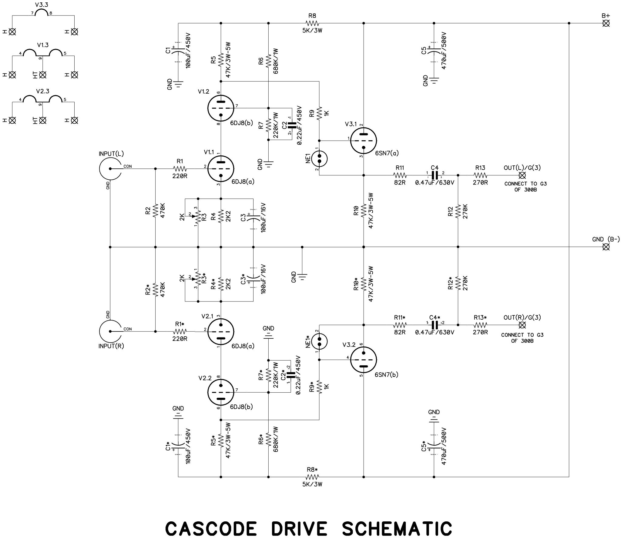

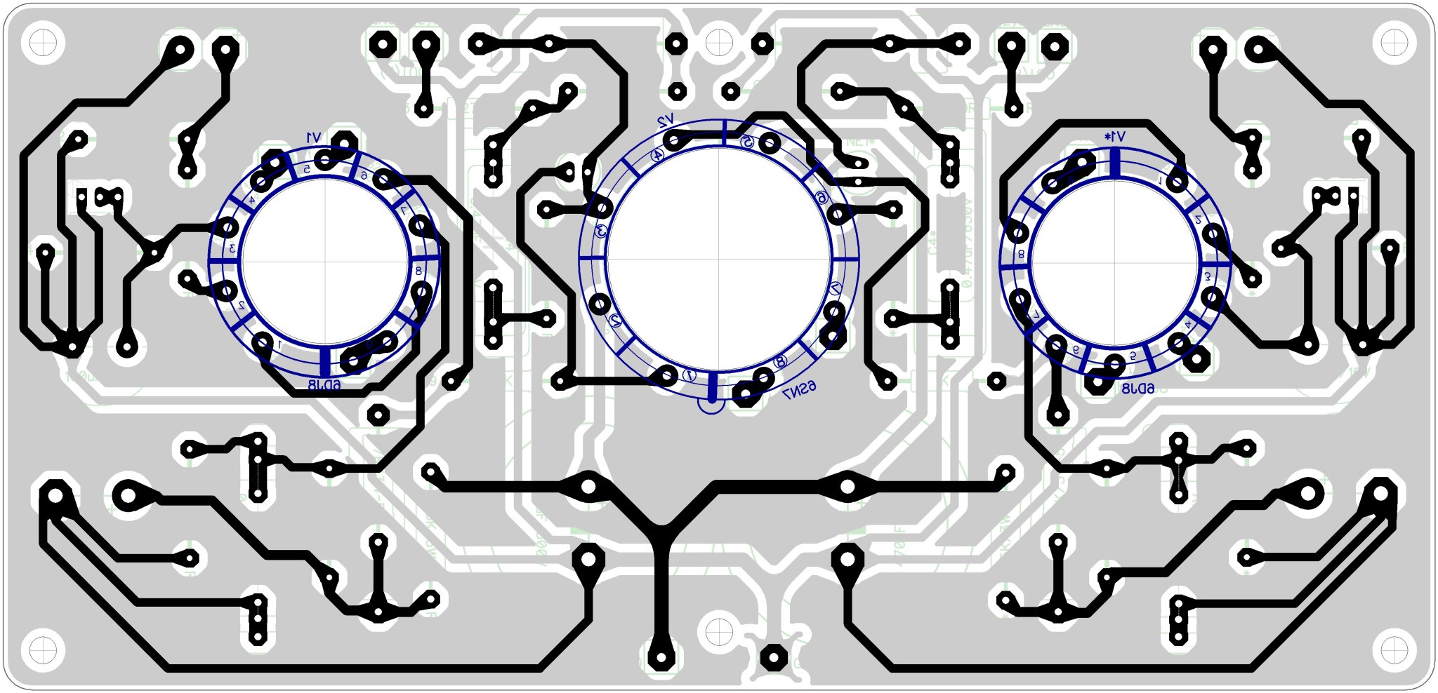

btw, @stephe i used your 6sn7 cascode to drive the 300b, but the owner finds the gain of the 6sn7 not to his liking, so i designed a 7dj8 cascode buffered by the Russian 6H8 and gains are a lot more...

The other thing people ignore is the speaker and the impedance curve it has. The OT impedance is based off the load and many times, the speaker is not exactly 8ohms. It's overly simplistic and ignoring the whole system to look at the OT Z in isolation. And yeah, that 6SN7 cascode doesn't have a ton of gain, it really like a pre-amp or at least a fairly hot source. Your solution looks interesting!
