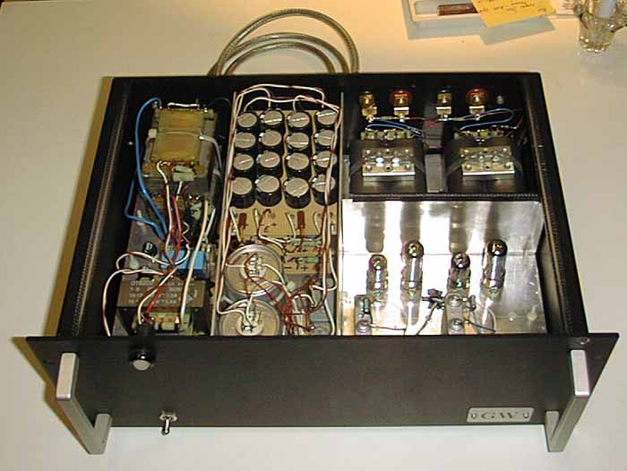

Unfortunately, the outcome of those "high end, ton of money" amps is, if it comes to commercial ones, often just a desaster. ...
...and plays wonderfull music. A german designer, Götz Willimzig, has proofed to better a 300B amp with just a simple PL82 tube. When it comes to real music value, the 300B had a hard time to beat the tiny PL82. It simply was more musical sounding as the legendary tube. Still cost just pennies. But you need the right speakers for it.
So, Schmitz77,
What do you have to back up that claim? How did he do dat? He must have used some stuff other than just a PL82...what stuff? They still cost just pennies. And, what are the "right speakers for it"?
Best, RC

Maybe I can help out.
The famous PL82 amp is a work of Mr. Götz Willimzig, formerly one of the editor of the german audio magazine "Das Ohr" (The Ear). This was a magazine published during the 1980's to 1990's and having been the first one without being dependend on advertisments and only publishes listening impressions of the tested gear, instead of building the test upon measurements in combination with an absolute scale of stars and ratings to give for the reader to rank the equipment. Götz later did write books (for example, this "Höchst Empfindlich" (Highest Efficiency)) book, where he introduced audio systems, that were able to work in combination with high efficiency speakers.
I think it was in this book, where he described this concept of a small SE amp, that heavily depends on an excellent PSU and therefore can bring all the qualities of that small pentode to life.
Here is a pic of a reproduction of that amp, and its visible that the PSU has become a substantial part of the search to extract the best sound of any electron tube. The circuit itself is relative simple, but engages a real good output transformer pair and good parts.
