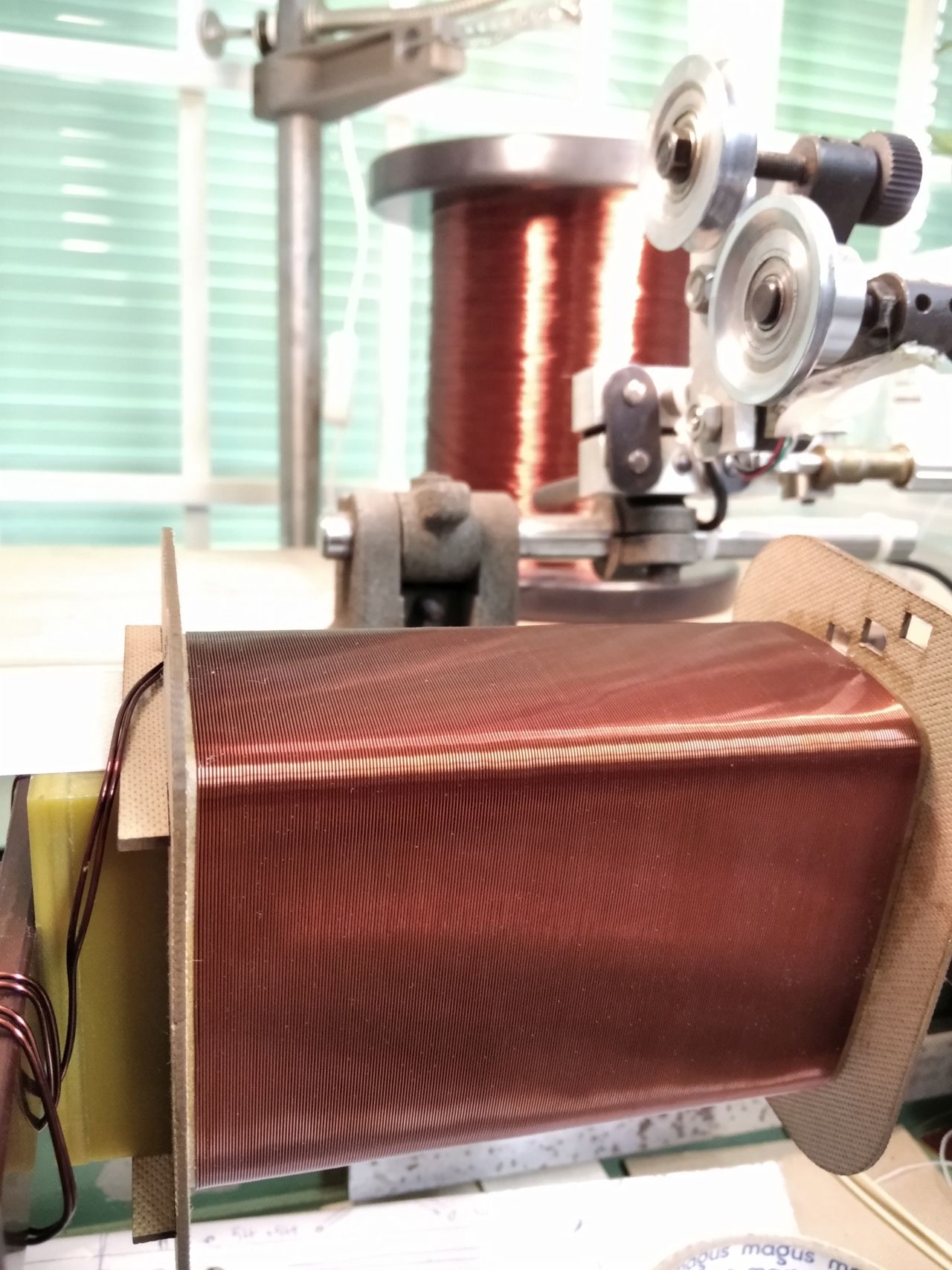

Are you going to rewind them?
If so, how ?
@TonyTecson
Will you post images of this progress?
sure thing.....

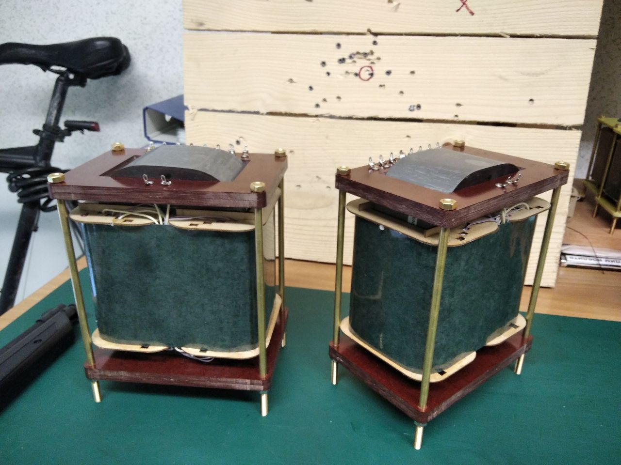

Stirring things up. Here's my 5K 100W SE OPT on 21sq. cm core 😀
https://www.diyaudio.com/forums/att...ngle-stage-driver-c3m-img_20200922_114321-jpg
Do you shoot the less successful pieces with a shotgun? 🙂))
BTW impressive pieces.
i plan to do mine with the coil on just one side of the c-cores...
@euro21, honestly didn't think of it! 😀
Tony, yes, you can. The main advantage of double-bobbin C core audio transformer is the reduced overall MLT, which will slightly reduce Ls, Cs and ohmic losses for the same core. But you get the increased working time of connecting the primary between bobbins.

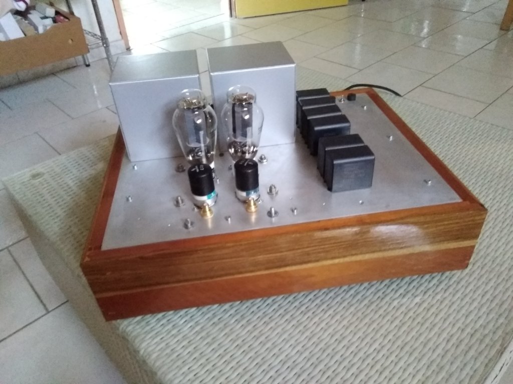

Fixed bias is always an option. I've always used self-bias. I intend to do a bypass cap shootout - want to try some polypropylene caps, some DC Links, some motor runs and some electrolytics.
Has anyone done cathode bypass cap tests for the 300b?
