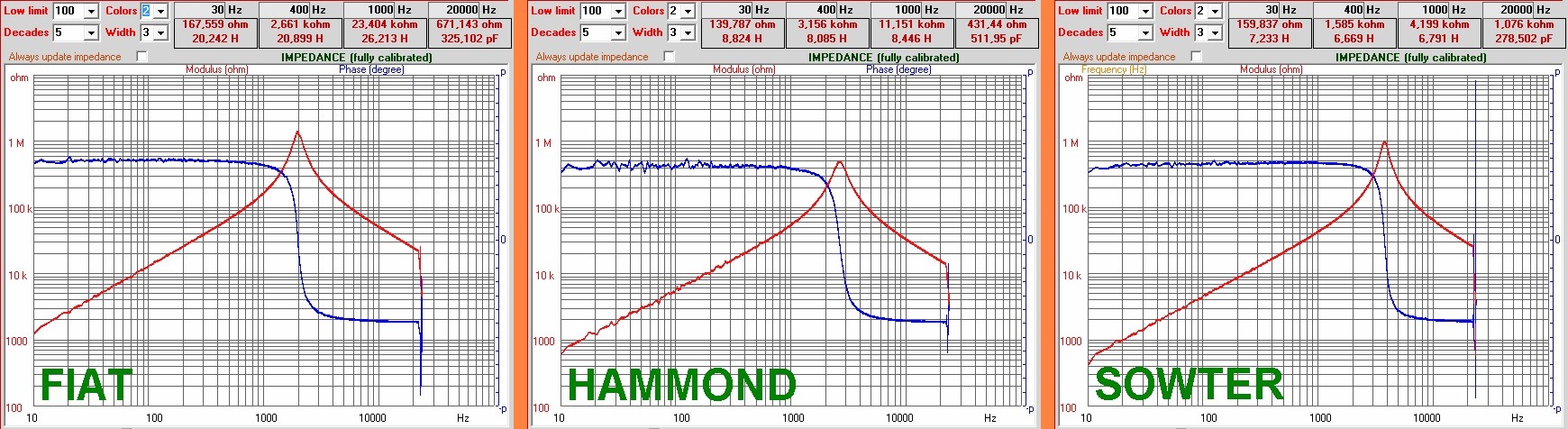

In attach some graph already posted time ago on another thread.
All s S.E. types, similar in Z.
The Fiat is custom made for me, the Hammond is 1627SE and Sowter SA(SF)08
The test is only for trafo without output circuit
The response is, at the end, enough for all three. The THD vs, frequency is differente mainly in the low region.
The reason is in the other graph ( second post)
Reactions: 45
In these plot there is the andament of primary inductance (secondary open) and it is possible to see that where the inductance is reasonable high the THD is lower. The plot is limited to 20 kHz
Is clear tht at 1 kHz the THD of the trafo is extremely low
With the entire circuit a power tube that see a low impedance due the OT limit gives an additional contribution at THD mainly at low frequency( but also at high for different reason)
