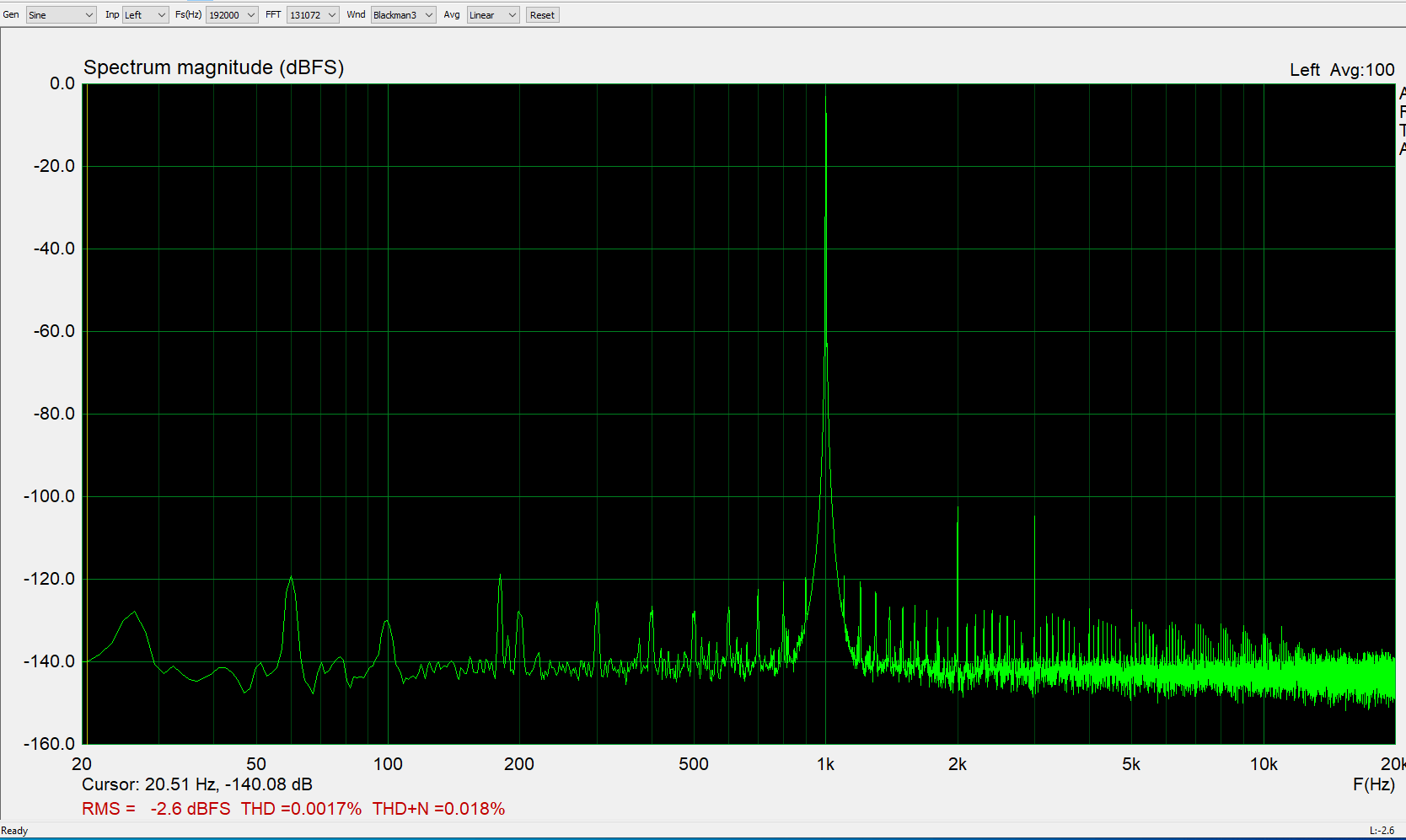

OK, new computer in the lab (Garage) and new sound card with lower floor and THD. The old computer was probably 10 to 12 years old and a hodgepodge of parts from my son's discarded gaming system.

I still haven't been able to get Audio tester 3d to work happily with the sound card (Asus Strix DLX). ARTA on the other hand seems to be working with the line out (Speaker) drive and Line in. I really liked the display interface for Audio Tester, but it looks like I will have to switch since ARTA works with the line out which has lower THD than the headphone output.
I still have to figure out the cal files to zero the output at 1vrms.

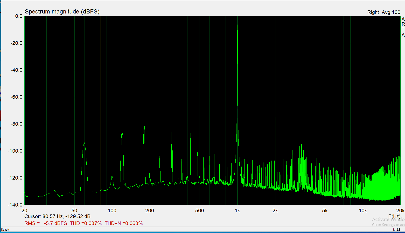

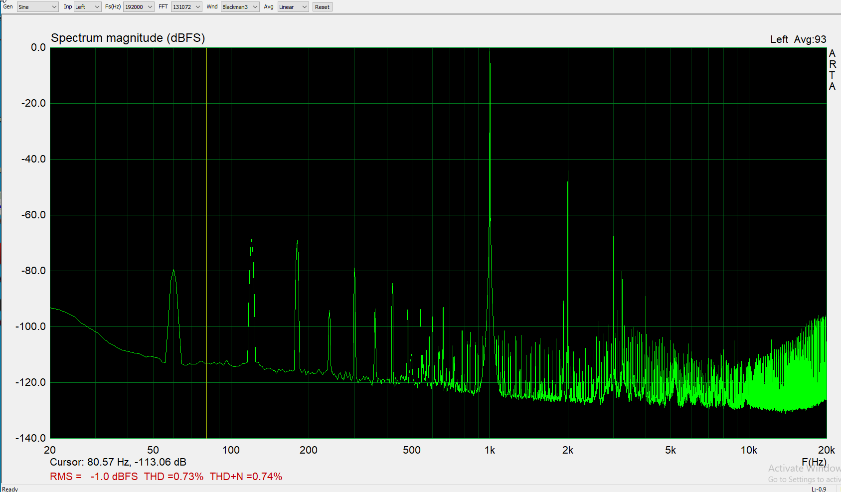

Here are new scans with arta, new computer, new sound card. First is the driver output. Second is the output at 1W at an 8 Ohm resistor. Outputs are scaled through resistor dividers in an attempt to get 1Vrms at the sound-card input. The output tube is the Electro Harmonix that went wonky on me previously.
