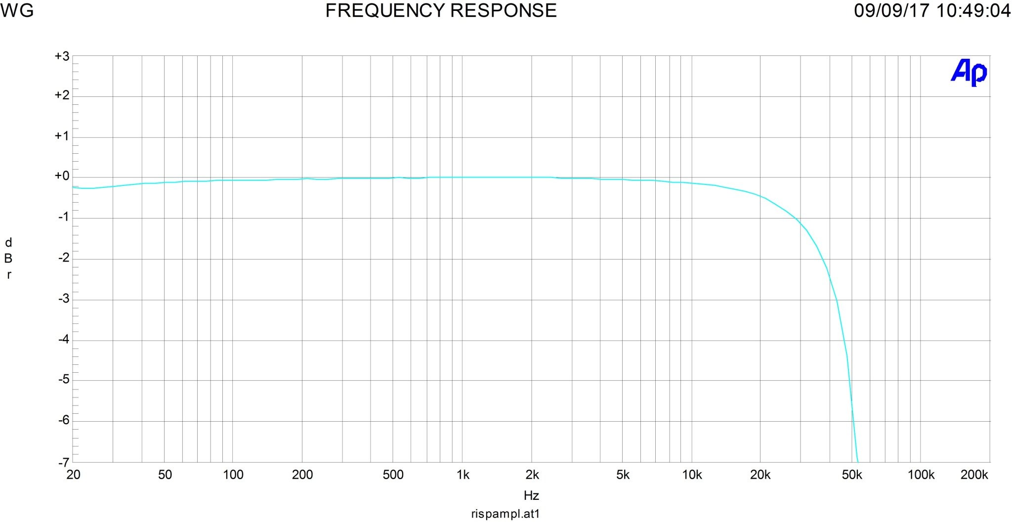

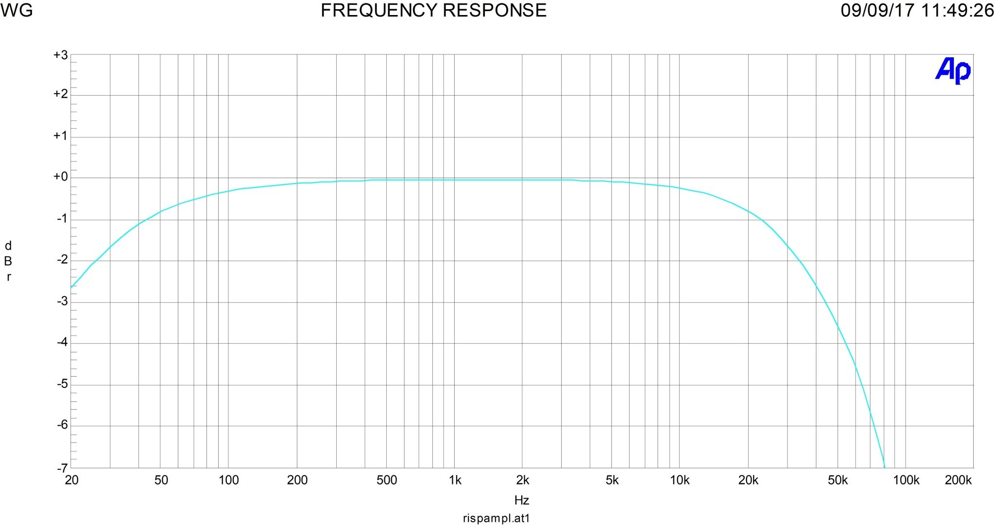

With Fiat trafo I got (8 ohm resistive), 1 kHz
1 W con 450 mV input / 0,23% thd
8 w con 1.3 V input / 1,5 % thd
With Sowter
1w con 450 mv / 0,30% thd
8 w con 1.45v con 1.7% thd
But the response 1 watt on attached graph

In attach some graph already posted time ago on another thread.
All s S.E. types, similar in Z.
The Fiat is custom made for me, the Hammond is 1627SE and Sowter SA(SF)08
The test is only for trafo without output circuit
The response is, at the end, enough for all three. The THD vs, frequency is differente mainly in the low region.
The reason is in the other graph ( second post)
