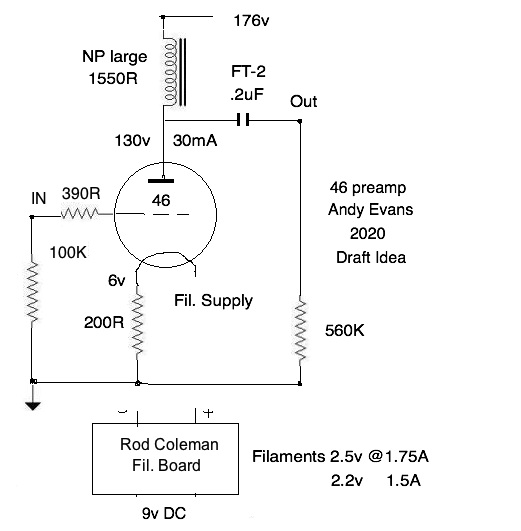

This is approximately my 46 driver. The output has 100K to ground into the 300b. As I was saying, inductance of the amorphous NP plate choke is 180H - it's pretty big. I chose 6v bias to keep the unbypassed cathode resistor lower in value. I don't know if you feel that more than 6v would be an advantage. With 10v bias the cathode resistor goes up to 333 ohms.

Hi Andy,
If you raise the HT to about 205V, cathode resistor of 470R, then anode voltage will go somewhere closer to 160V, bias around 13.8V to 14V with a 30mA anode current. This will give you about 160Vpp maximum output with an input that can swing nearly 13V before grid current becomes high enough.
I suspect you will get a stage which will have less odd harmonics (H3) versus even (H2 mainly). I'd bet you a beer it may even sound better. That will give your DAC more headroom.
Only tradeoff is the LF cut-off corner from 3.5Hz to about 5Hz which I think is good enough and worth trying. Also gain is just below 5 around 4.8-4.9.
You only need to change cathode resistor and adjust slightly the powers supply if that is possible?
