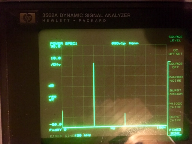

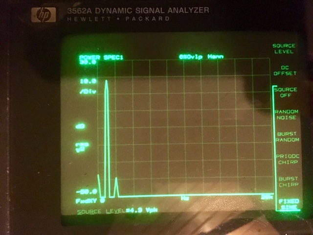

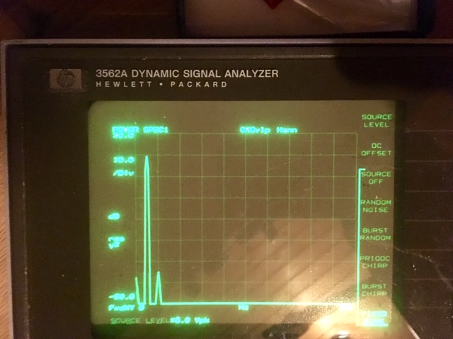

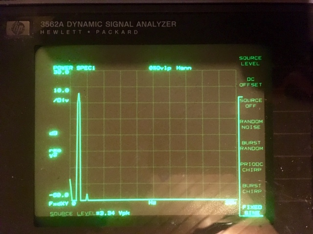

The 30A can do a tad better: first picture is
1khz 244v pp, loaded with ISO NC 20f, secondaries open.
Next picture is 1 kHz 283 v pp. Still between -50 and -60...
Next is 1 kHz 188v pp, and the last is 30kHz 188v pp.
As you can see distortion rises with increasing frequency, and with falling frequency. I could not find the pictures from the low frequencies.
The 30A benefits from the higher andode- cathode voltage (400v in my case)
Than the 45/47.
I am curious Ale if you observed variations in thd with rising and falling frequencies?

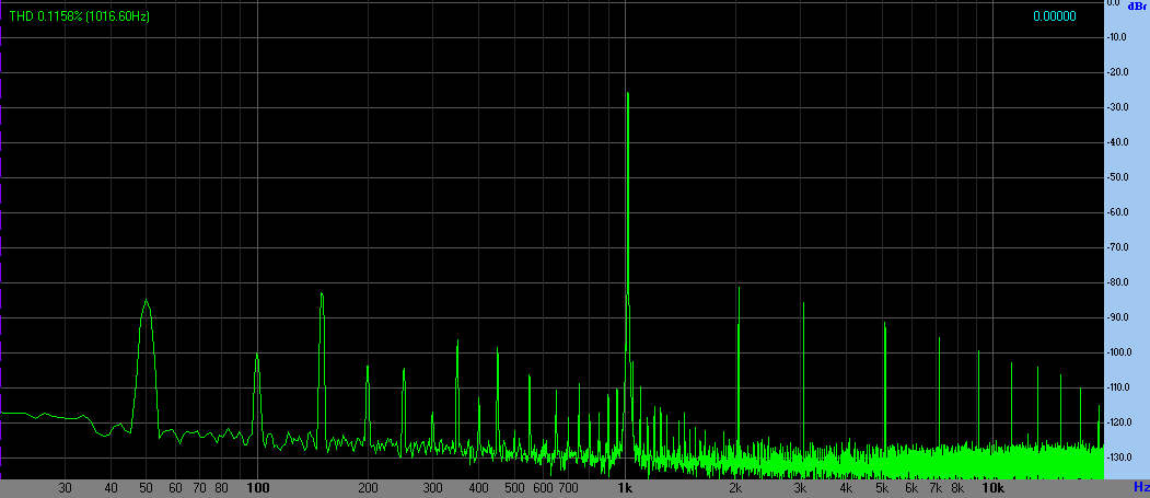

Hey Vegard,
Nice to see this. I forgot about the EML20a I have around which I eventually get back to the mercy of my abusing tests! Surely can do as good or perhaps better
I was struggling to read the measurements on the pictures as also the fundamental isn't at 0dBFS. Anyhow seems to be above 50dB for H2 so it's good!
In my driver, the THD is flat at 0.13% up to 20kHz. Coming below 100Hz, the expected LF distortion of the SUT takes to dominate and increases up to 0.3-0.4% for 200Vpp which is still very good in my view.
High frequency distortion could be caused in your case by the transformer and the slew rate caused by the grid capacitance of the output valve. I remember you had it connected to a hefty transmitting triode!
Anyhow, there is a slight electrical advantage in the hybrid mu-follower here versus the transformer coupled as the transformer performance will play as well.
How does sounds in comparison, it's another matter as we all know.
