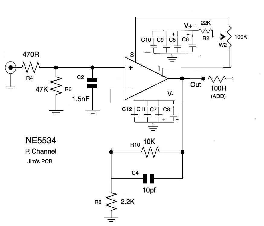

Long-term follow up. I went through several dual op-amps for a 5x gain stage and then started on single op-amps. LT1028 was detailed but the treble was rather brittle, AD845 was better but treble was a little un-smooth. Maybe oscillation problems or something. The best turned out to be a Signetics NE5534 - smooth and quite natural sounding. I got some PCBs from Hong Kong which worked nicely.
So here we are at what looks like a stage I can live with. Schematic attached.
I'm assuming that the purpose is just a low pass filter to keep high frequency garbage out.
If I flip through my copy of Douglas Self's Small Signal Audio Design I see that he typically uses 100R in place of R4 and 100pF in place of C2.
Thanks, Heath. 100R and 100pf is a 6db rolloff of 15,900Khz which is pretty high. 470 and 1.5nF is 226Khz which at least is doing something.
But don't forget that the output impedance of the previous stage also factors in as audiowize points out. If it has significant output impedance, your rolloff will shift down and start causing measurable rolloff in the audio band.
I'd use the 100R and 100pF on the non-inverting input and then use the cap in parallel to the feedback resistor to define a lower rolloff for the stage if desired. That one will function the same no matter what piece of equipment you connect to input or output.
