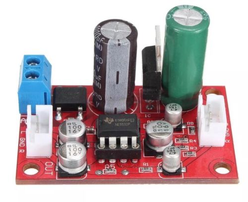

Good news - my new dual supply op-amp setup is now working. Did some fault finding, installed protection diodes, earthed the centre point of the 20-0-20 toroid. No hum, music coming out now. Now I can start optimising the setup.

I also have two setups - the new dual supply stage and my existing single supply chi-fi board which sounds pretty good in fact. All SMD except the socketed op-amp. Right now listening to a LM4562 in the single supply board. Better than the NE5532, particularly in the treble, and more detail. It's pretty nice. The idea of an initial op-amp stage is clearly realistic in my tube setup. Now I have good sound and enough gain and just 2 DHT tube stages. Exactly what I set out to do.
Listening to my usual audio demo list and very pleased with the sound. If it gets better than this I'll be delighted. If any of you guys want to try it, here's the single supply board I'm listening to right now with a LM4562 in it. Unbelievably cheap for such a good sound.

Op-amp testing starts in my NE5532 chi-fi single supply board....
NE5532 - baseline. OK, nothing special but generally good.
OPA2228 - improvement on NE5532 but not as good as others tried. Smooth, low distortion, good vocal timbre, lacks ultra transparency. Musical. A bit down in extreme treble. Less detailed and airy than LM4562, less inner detail in orchestral textures, can sound a bit duller, not so involving, less punch.
LM4562
Very detailed, airy highs, transparent. Strings can be a little thin. Plenty of punch in the bass. Overall sound is similar to the OPA2134 and LM6172, which is to say better than the OPA2228
OPA2134
FET input. Very neutral, does everything well, smooth, good voices, even frequency response, good tone. Overall very nice. Versus OPA2228, better in all ways. Versus LM4562 smoother, more balanced FR, less extreme highs and air, but highs nicely there. Could live with this one.
LM6172
Very similar sound to OPA2134 plus just a tiny bit more transparent. Very neutral, does everything well, smooth, good voices, even frequency response, good tone. Versus LM4562 again smoother, more balanced FR, less extreme highs and air, but highs nicely there. High slew rate and would need to be checked for oscillation (I don't have the means). If correctly implemented this could be very good, but more fussy than OPA2134.
Overall it would need more listening to decide between LM4562, OPA2134 and LM6172. I just used 8 pin DIP devices here, and by using a SOIC adapter some of the latest op-amps may exceed the ones tried here. These are all duals, no singles tried yet. For further op-amp shootouts it's over to the chip amp forum. I'm very encouraged by what I'm hearing. Neutral, transparent sound with good instrumental tone.
