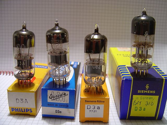

In CeasarII D3a works with Uak>250V.
I once tried my D3a`s with Uak around 240V. It did not sound good, not for my taste.

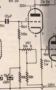

Shuguang SG-845BS amplifiers schematic
A friend brought me two of these amplifiers (minus tubes) to get running.
The first thing I did was drew a schematic (attached) as there seemed to be very little technical information regarding these amplifiers on the net.
I purchased tubes from eBay 2x(6SL7/300B/845), replaced the 450V filter caps with the biggest 550V ones I could find, added a second relay contact to switch ALL the HV during filament warmup and both amps put out a clean 25W into 8 ohms. Not my favorite amp, but included my schematic here, as there seem to be quite a few similar amps out there.
Mike
That 10uF has wrong polarity.
I wonder what happens when the amplifier is switched on and V3 is cold, not conducting. PS choke pushes the supply to 500V.... hmm.
This in the light of someone copying the circuit and replacing the 6Vac with modern filament supplies which in turn might be ignited before switching on the PS...

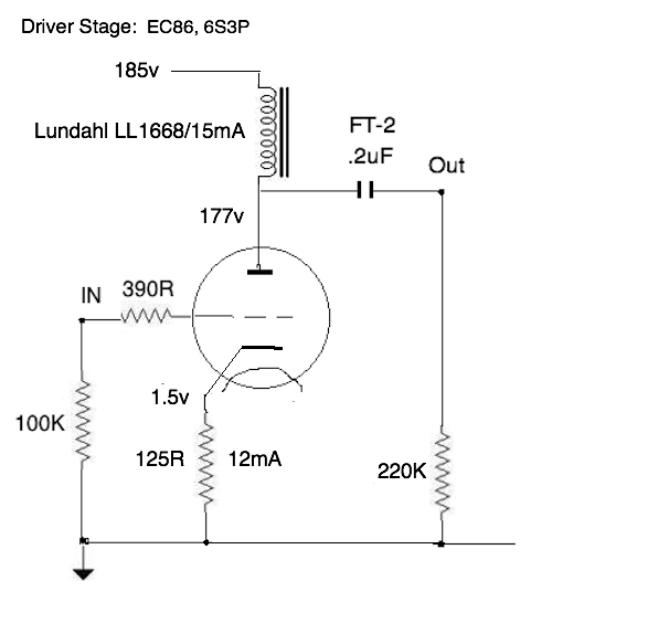

I've built a few 300b amps recently that I've been very happy with. My strategy is quite simple:
1. 2 stage amp. First stage preferably a triode or pentode in triode.
2. Plate choke with high inductance (150H) on the driver. Reasons for this:
a) I prefer it to an active load, smoother sound
b) A resistor load can't cope with higher currents unless the tube has very low Rp which is unlikely with a high gain driver tube. Exceptions like 6e5/6e6
c) With a Russian teflon FT-2/FT-3 coupling cap I prefer the sound to an interstage.
3. Now we have a high inductance plate choke we can use an unbypassed cathode resistor up to around 220R. This allows for some flexibility with tube and operating point.
To complete this design use a choke like Lundahl LL1668/10mA or LL1668/15mA. Then try out a variety of drivers in triode, like D3a, C3g, 5A/152, EF810, E280F, EC810, 6e6P, 6e5P, EF184, E180F, EC86, 6S3P, 6C45P...... plenty to try.
This plate choke circuit gives you great flexibility. Attached an example with EC86 driver, but any of the above will work.
  • EC86 + LL1668:15.png

Hi Andy,
Noob quetion can we not use an interstage trafo instead ?
Of course you can.
In my case I've had a few Lundahl interstages like the LL1660 and I preferred the sound just using the primary as a plate choke with a FT-2 teflon cap. My preference based on what I've tried is for a plate choke. Cheaper as well as a sound that I like.
I haven't tried any exotic interstages like Tango, but in the case of Lundahl I would certainly go for a plate choke like the LL1668. In my case I use an amorphous plate choke from NP Acoustics which I'm very happy with.
