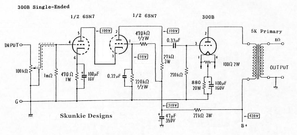

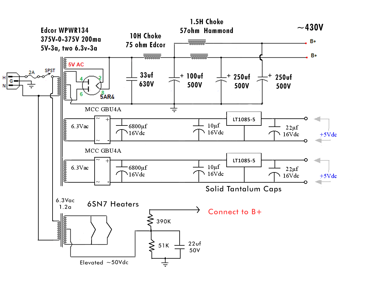

I just finished a 300B amp based on that "first schematic" attributed to JC Morrison and honestly I wasn't impressed. As someone else said, that direct coupled front end farted out at very low drive with weird asymmetrical clipping. It was super sensitive but had no drive for the power tube. Thin bass and the top end was too bright. I rewired it more like that "Time Bandit" example, with a cascode using a voltage divider for the upper section grid and it sounds WAY better with 3X the output. My CD deck/phono stage is plenty capable of driving it with no preamp. I'm sure the 300B can handle even more drive but this sounds nice for a very simple circuit using 6SN7 tubes. Attached is the schematic + power supply using a single transformer setup as a dual rail with regulated DC heaters for the 300B and 50V DC offset on the 6SN7 heaters..
