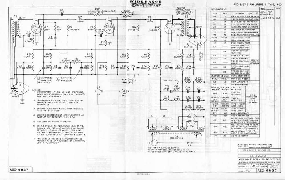

If he want it simple, that first schematic can made even more simple.I would go with the first schematic, it's a bit simpler. You could build a stereo amp. The power transformer should be capable of at least 250mA. However, if you are going to use a GZ34 rectifier, you should reduce the HV secondaries to 375-0-375, otherwise your HV will be much too high.

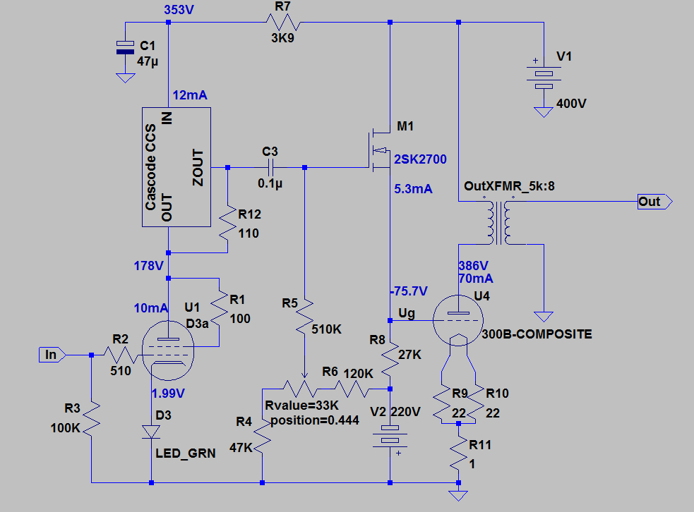

as an alternative idea why not a 6SL7 as the input and voltage gain tube which is RC coupled to a source follower, in turn DC coupled to the grid of the 300 B. The source follower is loaded on a choke so that it doesn’t need a negative supply rail. I was looking at toapology like this in my Krakatoa thread.

The circuit you posted on post 18 is the one approaches the original W Electric version. The bootstrap capacitor requires separate pair of resistors 100 ohm each across the filament . The rectifier tube effects on the high frequencies character. Shuguang has the replica of WE274 .

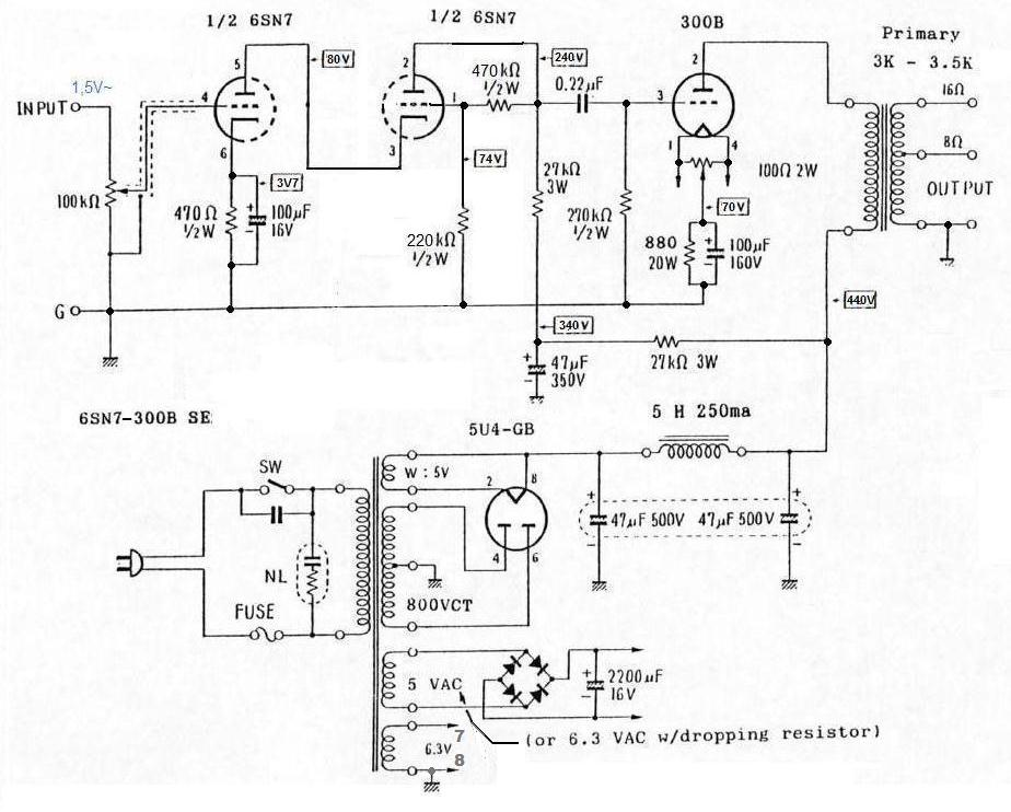

so the biggest problem is, that the 300b need a potent driving stage.
The mentioned 6SN7 circuit from diyaudioprojects isn't enough?
A more complicated circuit would't be a problem - for example the one mr. Wavebourn mentioned (ef86 into 12bh7)
@Wavebourn - Am I right, that the 5V 300b heater wiring is directly connected trough the 300b's filament? No hum pot, no 880ohm or 1k 50w resistor?

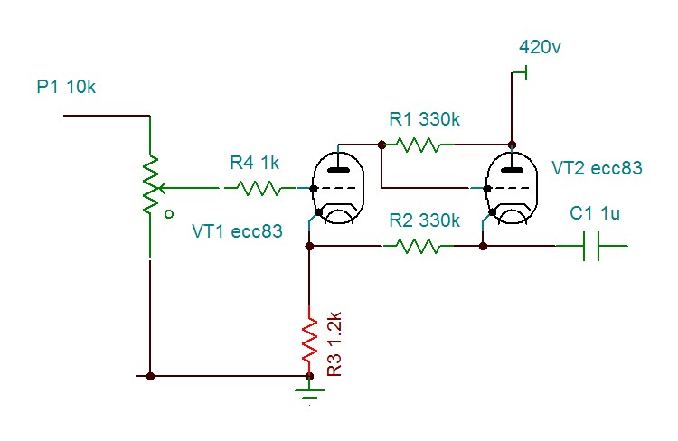

It is only according to Rangon that 6SN7 double triode is not enough. If you are looking for high gain low output impedance here is mine . Direct driving a 300b . With pentode, the output impedance is just enough for 20khz, but the sound is much warmer .

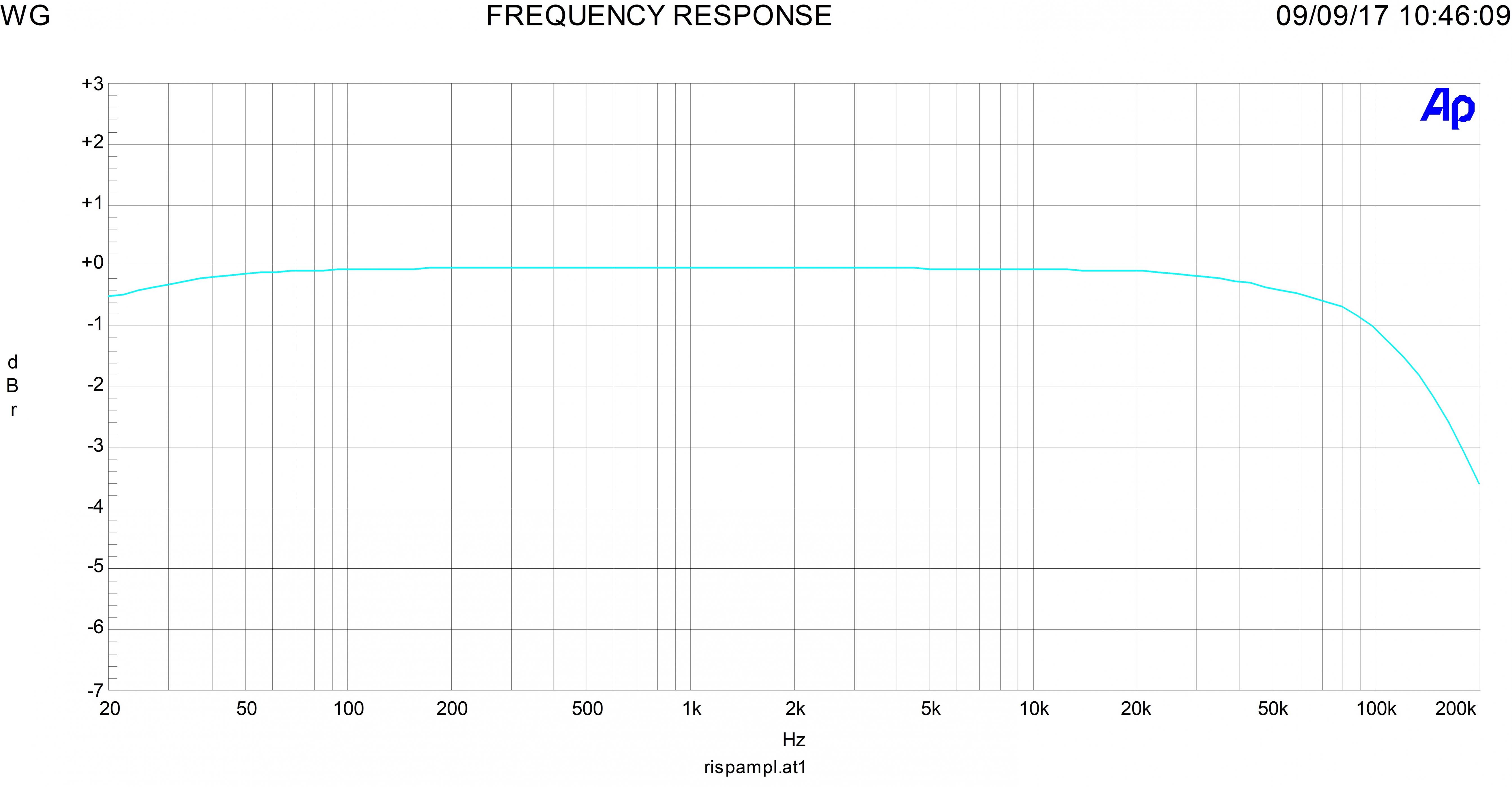

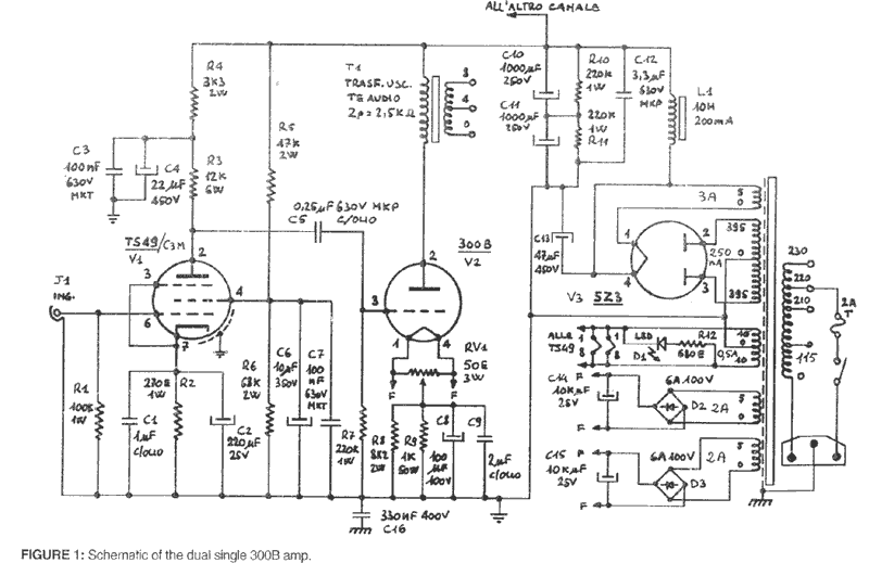

Also this one run well. The E88C is a single triode and you can find some Siemens gold pin at reasonable costs. In fig. 1 the response with 450 mV in and 20 Vout of the input stage. The Zout is around 1,3 kohm The OT is 2400 ohm prim and 6 ohm sec, made by Fiat in Roma. Fig. 11 is the response at 8 w - 8 ohm load
Walter
Walter
FYI the information written on the transformer should read 18-17-16 for 0 ohm, not 17-16-15, but you probably spotted that.

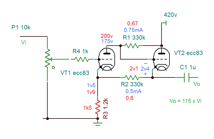

That's a gain of 115x thanks positive feedback.But with only ½mA in the output not much drive capability.It is only according to Rangon that 6SN7 double triode is not enough. If you are looking for high gain low output impedance here is mine . Direct driving a 300b . With pentode, the output impedance is just enough for 20khz, but the sound is much warmer .

The positive feedback just cancels the negative to get 0v ac on 1.2k , by this no need for bypass capacitor. Note the output is not symmetrical providing more negative than positive about 30%, increasing the output excursion hence more power less distortion.
YouTube
No, it's over compensating.The positive feedback just cancels the negative to get 0v ac on 1.2k , by this no need for bypass capacitor.
Simpel bypassing the Rk gives gain 80x and with the feedback you get about 115x.
