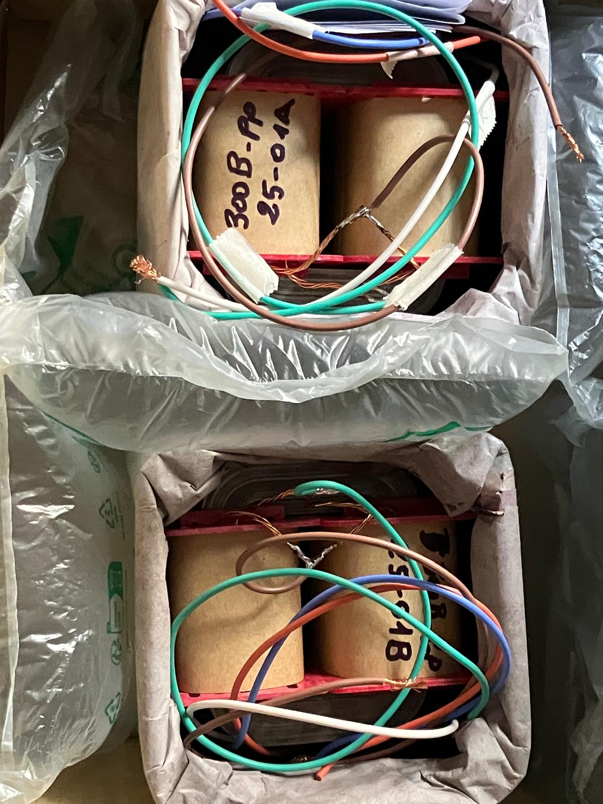

In the little factory there is a beautiful wound machine comes from Switzerland and was property of Da Vinci brand
Regarding the potting I will take note of your consideration; I was thinkin to check one free air and one potted to understand the the specs; there are metal box 13x13x12 cm ready.
In addition there is very good interstage trafo 5:1 for line out and 1:1+1 for p-p drive ( or s.e) with a little irona always nano. Tested very good ( for me)

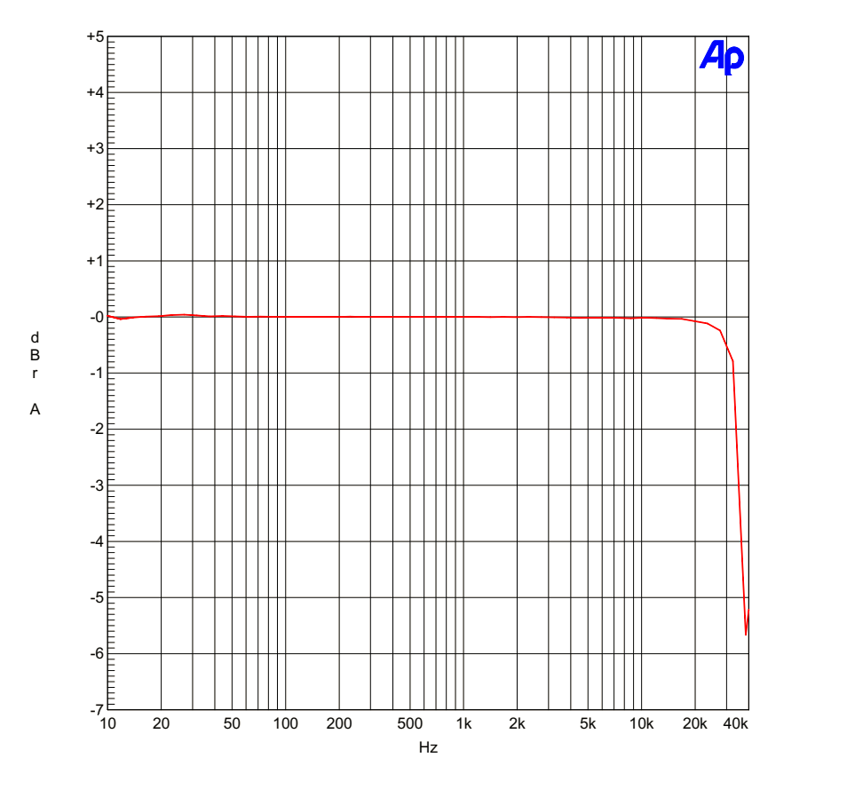

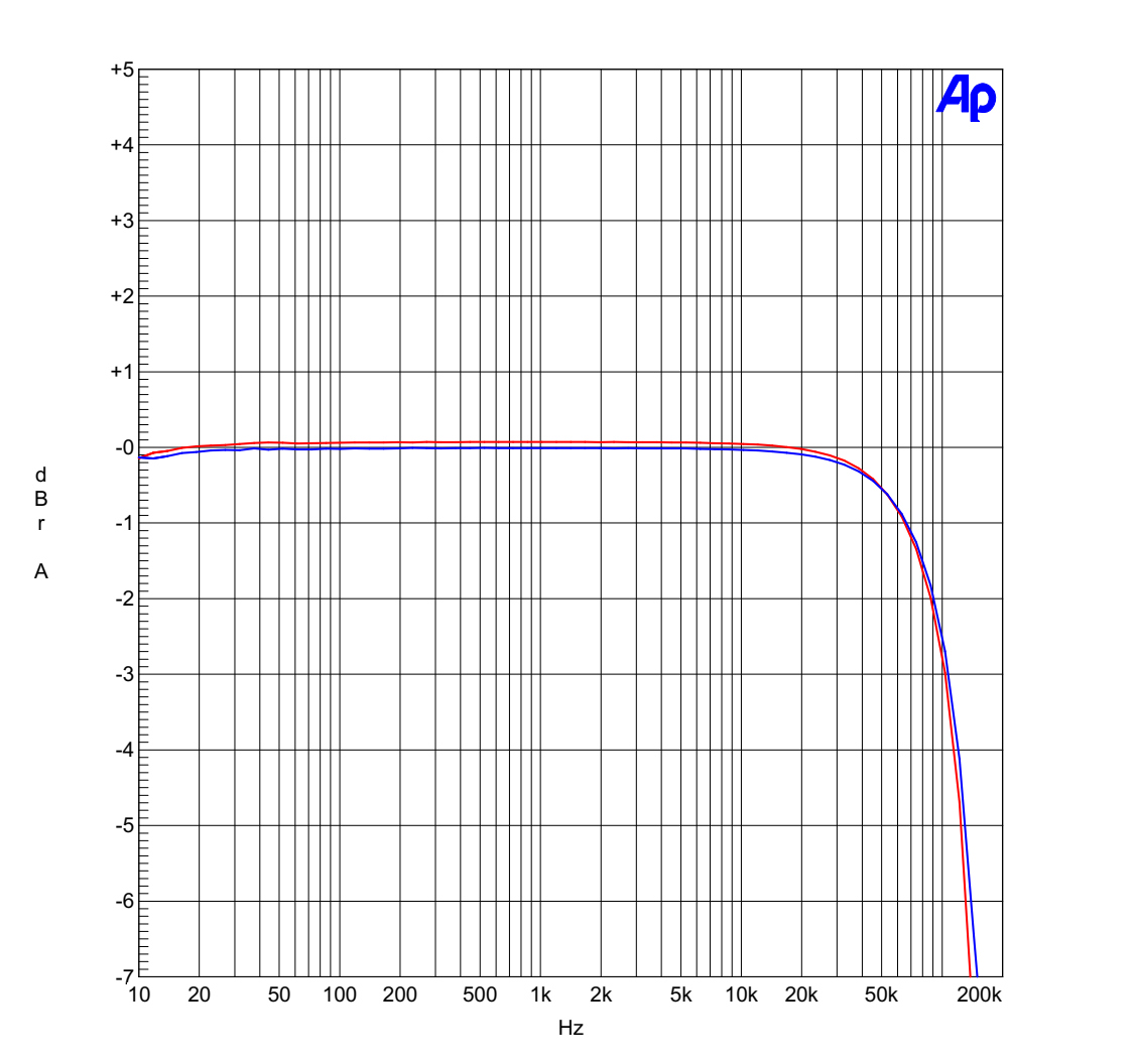

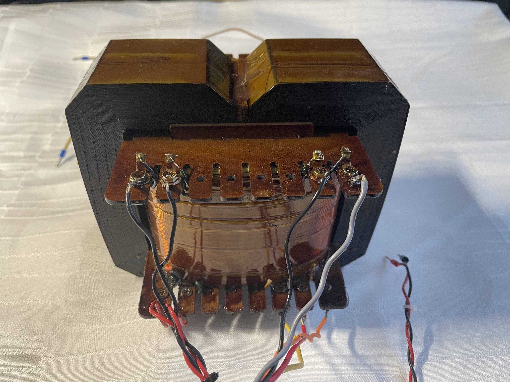

New entry as proto.
300B p-p nano
Ratio: 28:1
secondary fixed at 5 ohm
Freq. resp.
backward method; 100 Vrms on 2 kohm ( half of the nominal impedance, arbitrary choice) on primary acting as secondary; 5 watt rms.

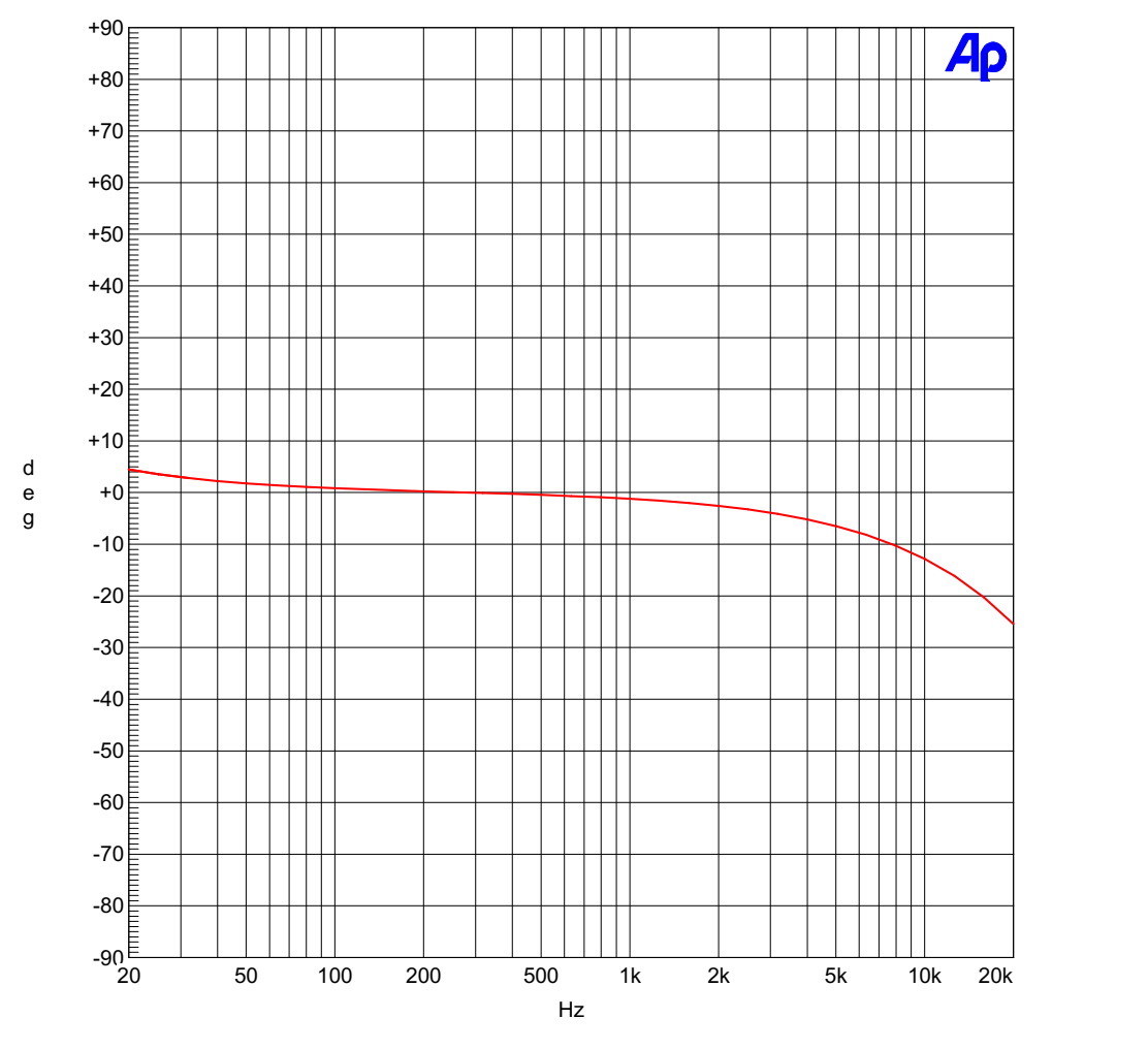

Pair
Phase
300B p-p nano
Ratio: 28:1
Freq. resp.
Pair
Phase
Forgot to list the electric specs for 300B p-p
Rdc primary = 60 ohm
Rdc secondary = 100mohm
Lprimary = 140 H at 120 hz
Lsecondary = 180 mH
Walter

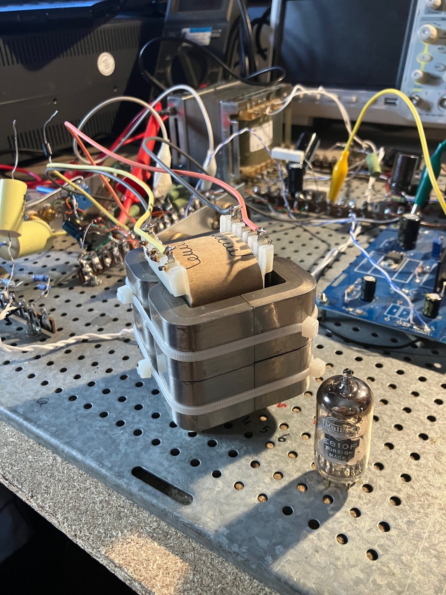

Walter,
Are you sure that operating point (voltage) values are OK?
Trioded E810F ordinary operating points at about 150V, about 20mA, about -2 .. -2.5V.
240V is too much.
240V is too much.
I have checked from 150 to 240 Vdc; of course it is an hard point ( normally I go close to 100% of dissiaption)240V is too much.
This setting seems to be fine. The Pa is within spec
The Rk is 200 ohm
Vin is 500 mV
With 1 Vin, I got around 47 Vrms out with 1,5% THD
Walter
