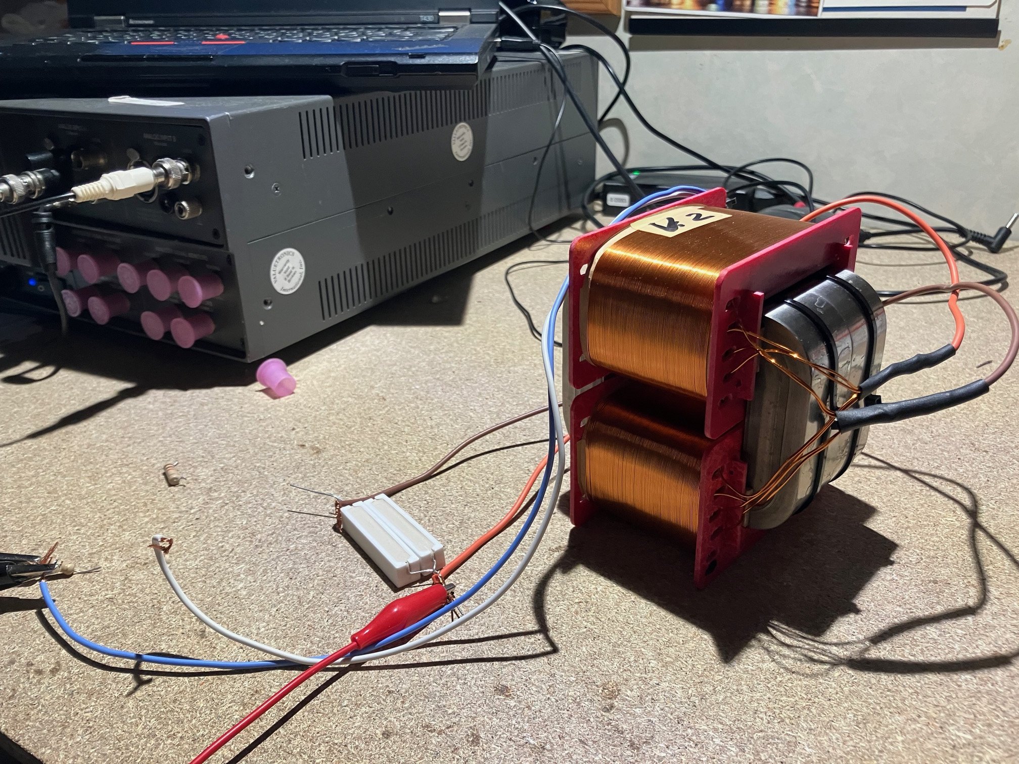

300B OT nano, first test
Walter could I ask who is making for you the custom transformers or are diy by yourself?
I am working with a little lab in Roma , now the trafos are in the final tests.
We found a good supplier for iron and box.
The intention is to put in catalog in next future.
With power trafo, C nucleos or EI
At the moment are four /five different types, only Nano
And one for MC cart. in mu metal
Walter

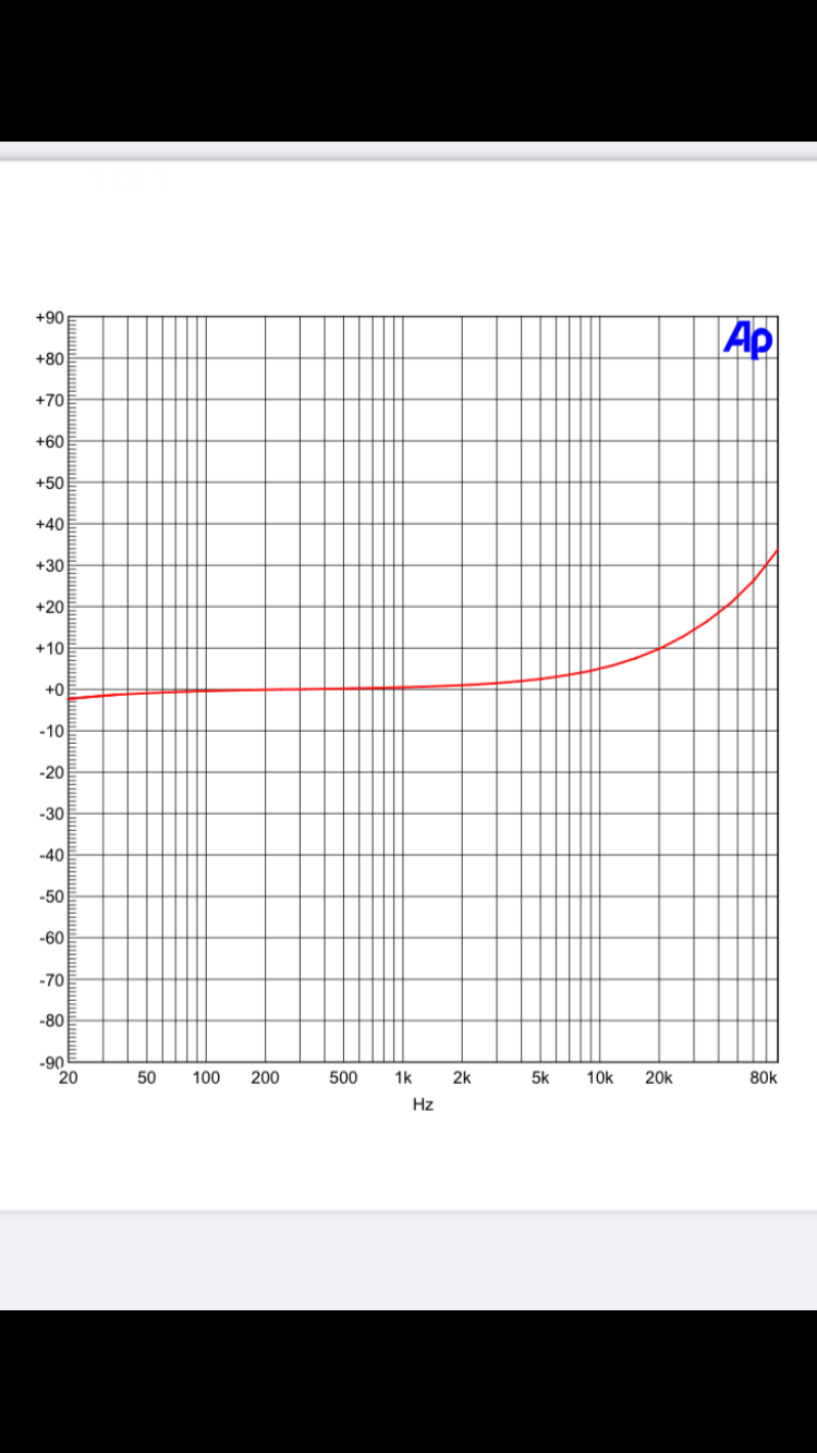

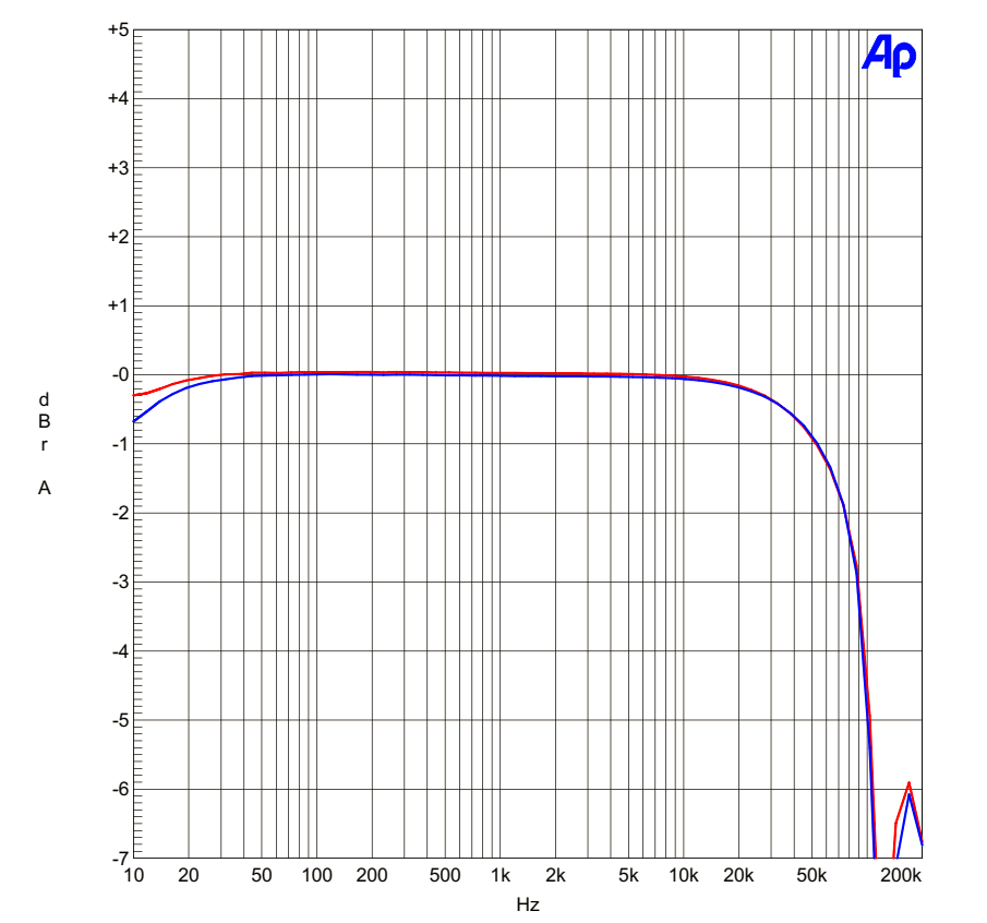

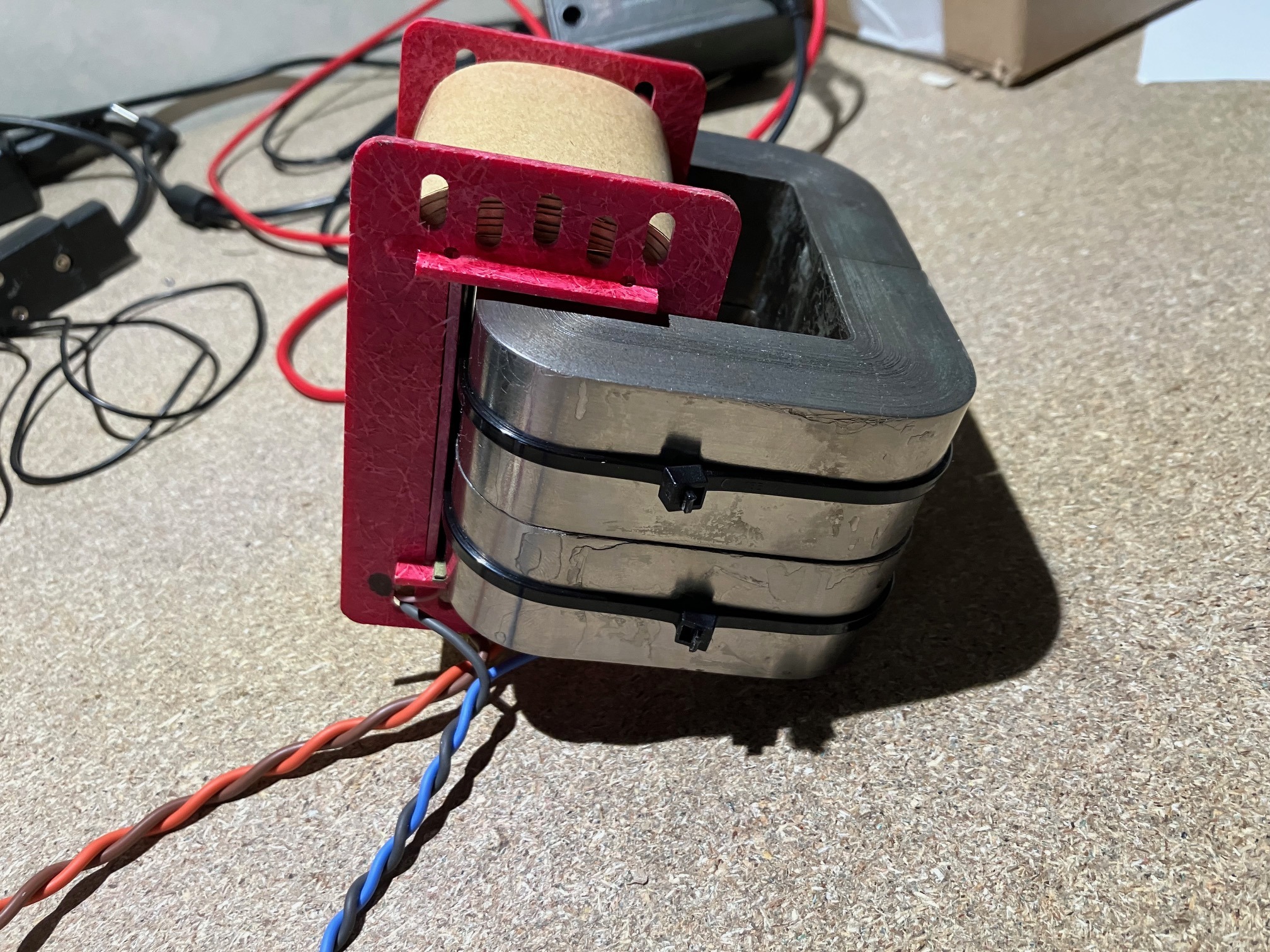

These last tests on s.e. 3.500 ohm / 5 ohm, final.
20 w nominal
Same nucleus of p-p
Nano.
Around 40H
Rdc primary = 76 ohm

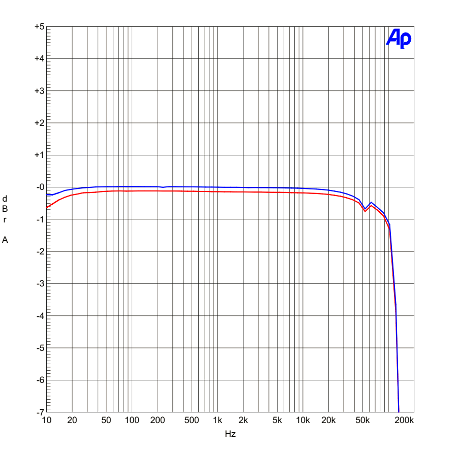

Backward test
Response, two trafos, 5 watt on 750 ohm
Phase
Reactions: fortyfive
