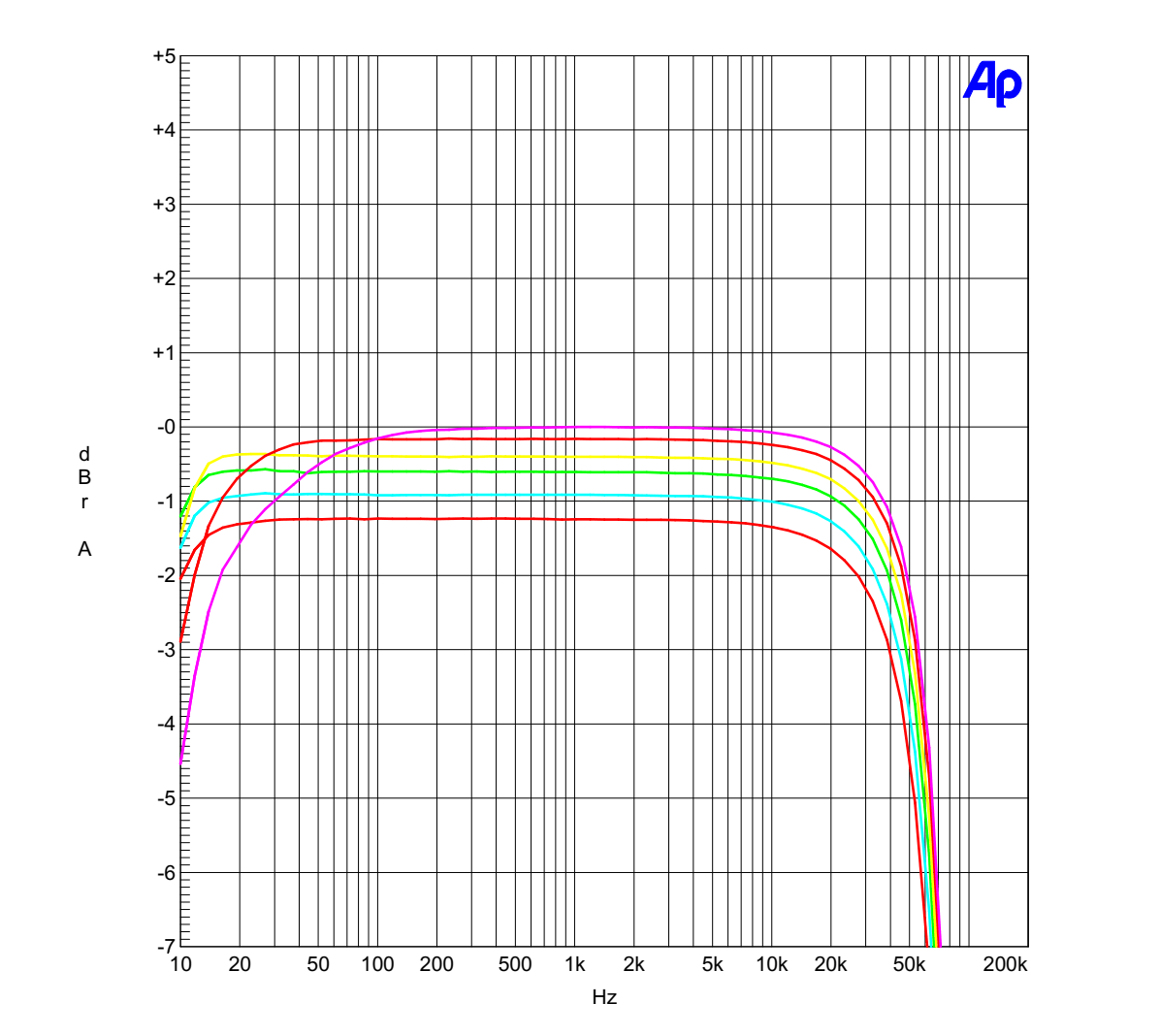

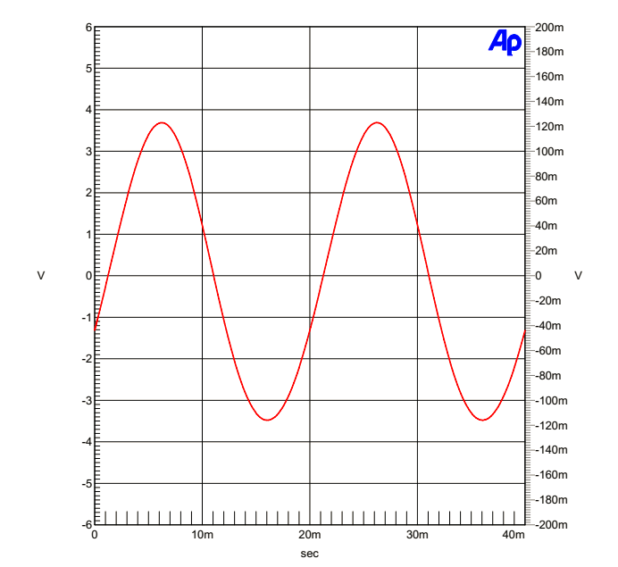

Some lab test with a KT88 in triode mode gain 7 time, one stage without any driver
6 Vin from AP
Vdc around 390 volt
Ia between 50 mA to 100 mA
50mA red bottom
60 mA cyan
70 mA green
80 mA yellow
90 mA red
100 mA violet
until 80 mA the response is very good and compliant with the reverse mode

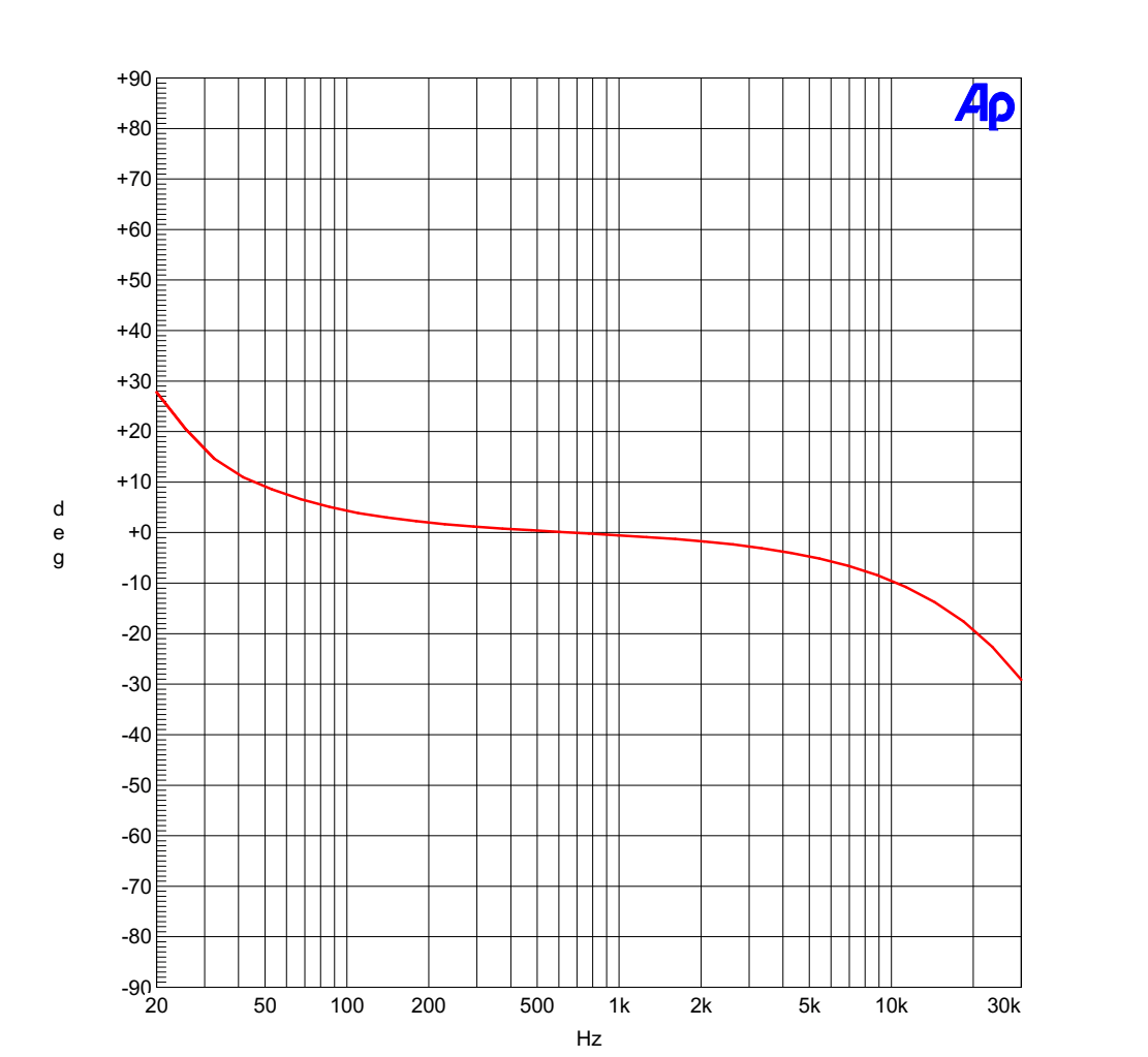

The phase

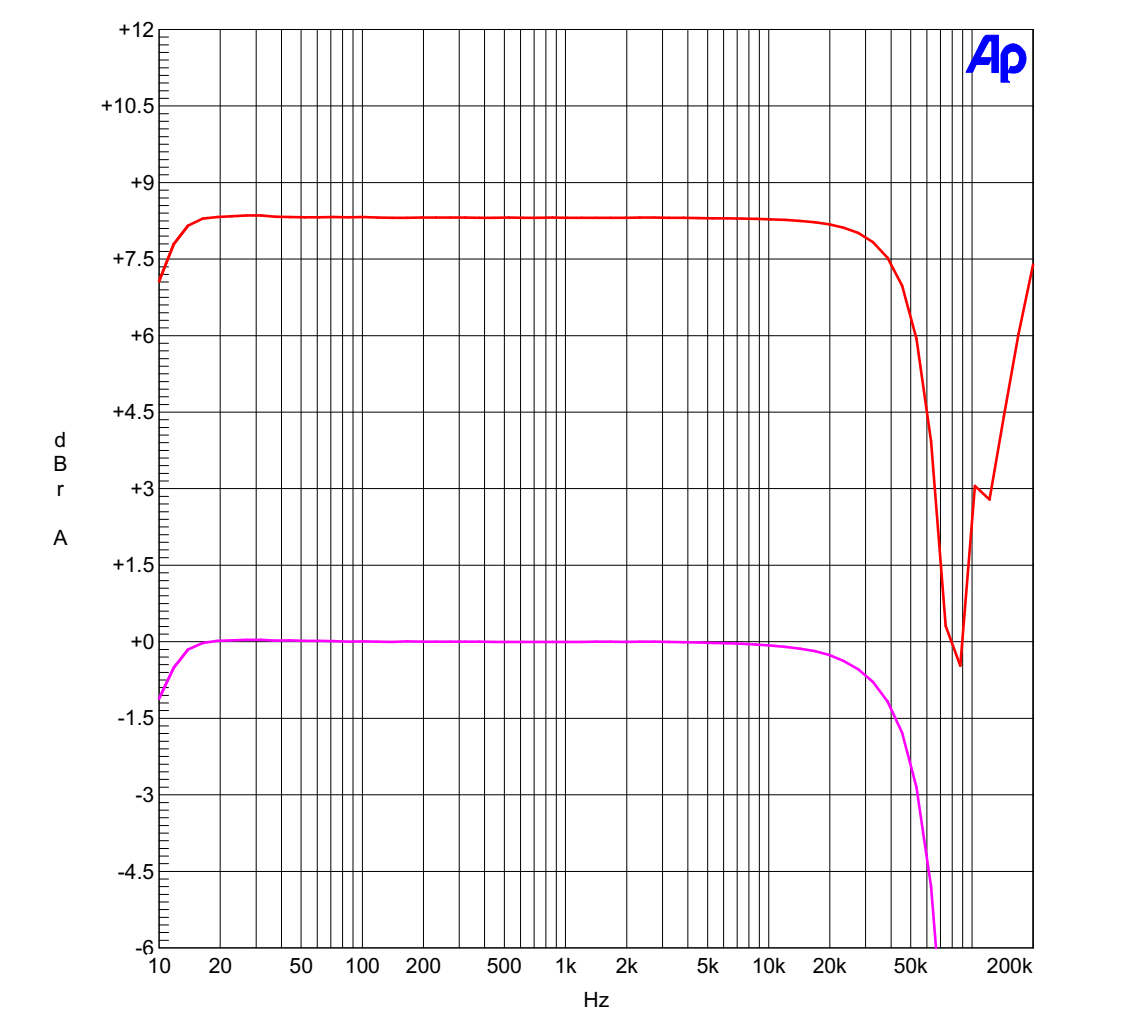

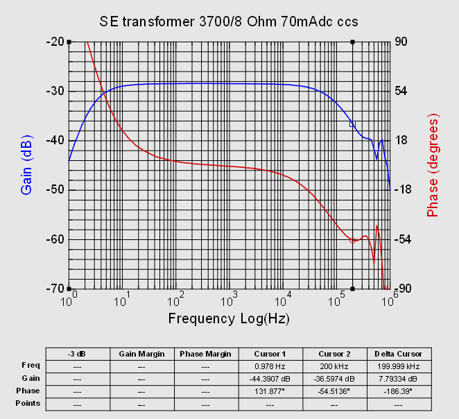

With a differential probe the response on primary (top) with some resonance at 200 kHz and a little step on 100kHz
and secondary ( on the load, 7,5 ohm )

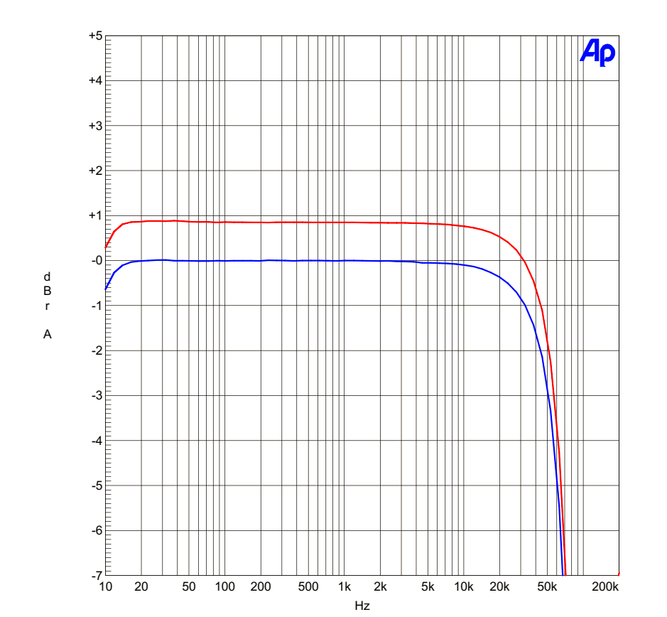

I check the 7,5 ohm and 5 ohm load; Vdc 380 V, Ia 70 mA, KT88 Triode
At 50 hz the Z is ( on live circuit)
7,5 ohm = around 5 kohm,
5 ohm = around 3500 ohm
Safe
I ahve also tested the Z on different level at 50 Hz, with Rl=5 ohm
with
68 volt around 3300 ohm
With 7,5 ohm the results are better but similar
The THD stay around 2,2-2,5 %, no sign of saturation

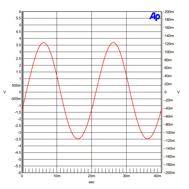

68 Vac on primary; 5 ohm load, 50 Hz
Freq. response
The difference on level is around - 0,8 dB for 5 vs 7,5, same shape of curve

Walter,
"The THD stay around 2,2-2,5 %, no sign of saturation
68 Vac on primary; 5 ohm load, 50 Hz"
Of course no signs of saturation (transformer or tube cut-off). For that you have to go down to 20Hz and/or make the signal bigger (you are now between 0,5W and 1W) but if you do so, yes it will do so. No worries, physics still stay the same as always.
And 1 more question: post 1 was 3000 Ohm / 5 Ohm and now it is again different. Please don't switch all the time (if you want a reliable person with a reliable transformer) What are the specifications of your transformer now?
