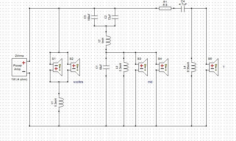

And John, I understand the circuit but not frequency respond graph. How should impedance curve be interpreted? Is it the overall response from xover?
Another question: shall I keep C4 value of 220 uF? (150 + 72 = 222 uF in my case)

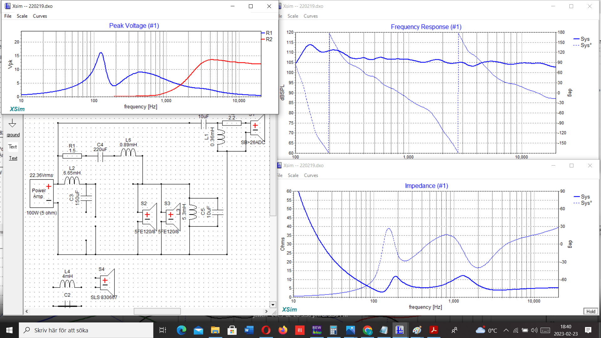

Your welcome.
Yes its the simulated frequency respond graph and impedance curve.
Impedance lays around 5-ish and have lowest 3,2 ohm at 130 hz and highest at 1300 hz with 12 ohm
Also simulated how many volt your resistors will have at 100 Watt, 1,5 ohm resistor will have 16 volt and 2,2 ohm resistor about 13 volt at 3000 hz.
Al looks fine !

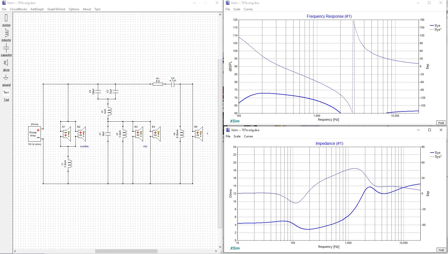

Ran original xo circuit in xsim but lack of driver parameters (exclamation mark on each driver) produced a weird frequency response, see image.
Jawen's xsim response is based on his new drivers and not on mine, right? But they shouldn't differ that much so I carry on. Always something to learn.

Yes pelleplutt, you can´t use XSIM without all drivers parameters/FRD file and ZMA file ( the impedance curve)
Or make parameters , a so called FRD file with a mesaured curve and then use SPL Trace in VituixCAD.
Think you orginal drivers/speaker will sound better with the changes, and of course even much better if you invest in the recomended drivers Faithal Pro and Sb tweeter

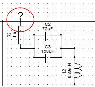

Now to mid range. I've have new Jantzen eleCap 150 and 72 uF, but you (jawen) advices 120 uF once again. I'll start with one 150 uF but can order 120 uF if necessary.
One question:
- Resistor before this 120 uF, not sure where to solder it on the "warm" side, towards +side so to say. See image.
This is a never ending adventure...

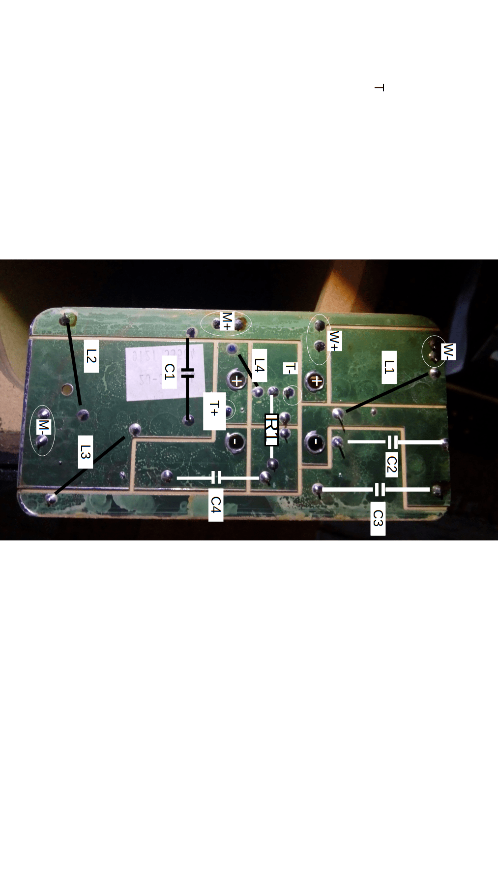

Hello, hope you are all doing good.
When studying my PCB compared to what I thought was my 707a circuit diagram I noticed something odd. Following power input, then each component to driver input and output, and then back to amp, it doesn't make sense compared to diagram. I thought my diagram looked like moorclos' 707i, with only two component values differing. But, if you shift (+) and (-) input from amp, diagram and PCB make more sense. Audio signals are ac, but phase should be important for the drivers.
So I shifted speaker terminal inputs and, voila, what a huge difference! Everything so clear, even bigger sound stage, deeper and tighter base. (I promised my wife to clean up the house, she arrives in 30 minutes and I haven't done a ****! Only been listening all day.)
Both Jamo and Rotel manuals advice connecting (+) to (+). Yet, amp(+) to speaker(-) gives best result. Anyone in for an explanation? Should my diagram be "mirrored"?
(Never mind component values on diagram, they are the original)

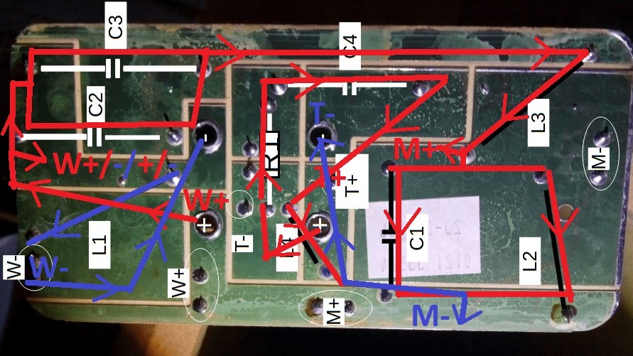

Every succes is good Pelleplutt (y)
And music are better then cleaning hahaha.
But photo is to small, i can´t se.
/john

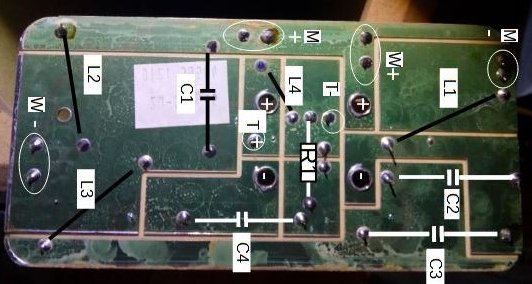

Yeah, she forgave me, but not only that. Yesterday evening we sat down in the sofa listening to a bunch of songs she likes. And she was impressed! "I hear things I haven't heard before" she said.
Attaching larger image, hope Jawen can see better. Since my 707a seems to have an identical schematic as Moorclos 707i (and most of the 707's and also D590 except for a few component values), this is what puzzles me:
If you look at input signal from amp(+) and start with tweeter section, it connects to L4 and tweeter(+). That's not what schematic shows. But if you switch input polarity it suddenly makes sense (at least for tweeter section). Or am I just confused? :unsure:
Anyway, for me this project is now about optimizing these speakers with their original drivers (just for fun, maybe shifting to new ones further on).
So I need driver parameters.

Real quality when also wife "is on the train".........Me still single hahaha.
I have spend some hours to figure out how your xover goes.
And i can´t se "inside the PCB but have drawn the lines where things supouse to go.
The most importent when you look at my picture, is thatTweeter, Midrannge and Woofer possetive side goes somewhere between "the 2 component" that i draw, and the same with negative. ( And maby your tweeter is inverted on the scheme, you have to try it out...so possetive side can be negative )
And where i writes W+/-/+/- it means go to 1 woofer to + and from same woofer - to the 2 woofer +, and from 2 woofer - to negative on xover.
Good look
Regards John

First of all I want to thank Jawen/John for starting this thread and for all the help he has provided. Also sending thanks to everyone else that has contributed, like Raymond, Moorclos, Belemakare, shadowplay62 and a few more.
I started following this thread without even the knowledge of how to reach the woofers which needed new surrondings (I couldl hear that). Now I am tweaking components in xover. That's a fairly steep knowledge ascendance! All thanks to you!
John, I feel ashamed you spent hours trying to figure out PCB coupling. I will study your image later. Maybe you are right about the tweeter originally being inverted. The Danish guys probably knew what they were doing.
I spent this afternoon listening to music and shifting speaker cables between (+) and (-) over and over again. Couldn't hear that much difference as I thought I did before.
Bottom line is: it sounds amazing! You know something is improved when you suddenly begin listening and admiring music you haven't cared for in a long time. You just can't stop, but you know you have to eat, sleep and so on.

Mid:
Changed original C2/C3 150//72 uF -> 150//68 uF (Jantzen Audio eleCap 5%) and also ClarityCap 4,7 uF in parallell (so 3 caps in parallell, total 222,7 uF)
10 uF (original I soldered back) should be changed to maybe Jantzen Audio Standard Z-Cap 10 uF.
I listened on Spotify to track number 12, Madan(King) from Salif Keita's Moffou (20th Anniversary Edition). Oh boy, what an experience!
It has everything (though you might not like the song itself), treble, base. I started laughing out loud after 30 seconds, never heard such a sound from these speakers before!
And one thing seems to be very important: where you place yourself. I started on a chair 4 meters from the speakers, not very much base. Sitting in my sofa 2,5 meters away from speakers, and my ears a bit lower than on the chair, everything changed. I was suddenly sitting on first row at a live concert with a huge stage in front of me. Wonderful!
Thanks again!
When you shift speaker cabels between + and - , you shift all drivers inside the speaker because its a 3 way speaker.
You have 1 tweeter, 2 midrange and 2 woofers, connected across a xover, so shift speaker cabels between + and - doesen´t do the trick because it just inverting every driver.
You can di that with a subwoofer for example, because it only have 1 driver.
On tweeter side maby you should try to take the "R1 6,8 ohm -> 4,7 ohm (Jantzen Audio)" away, and listening without resistor. ( easy done )
And on midrange side try to take away the 68 uF cap on the "C2/C3 (150//72 uF -> 150//68 uF and also ClarityCap 4,7 uF), just unsolder the 68uF cap and listen for a while.
Glad you really like your sound now pelleplutt, god music and sound is like medecine for the brain and body.
Regards John
