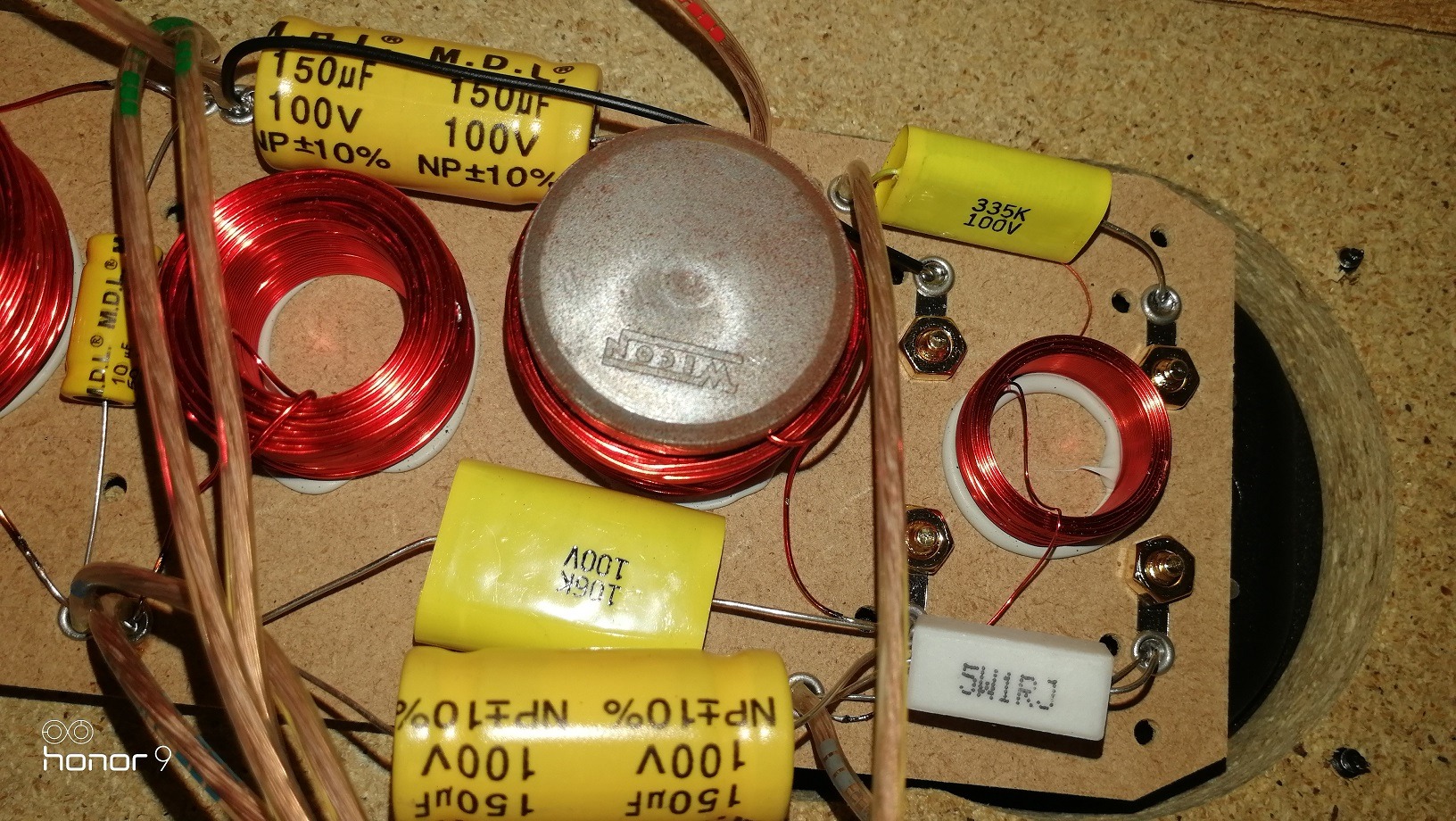

What is the green and orange components on the filter? They where not on the orginal filterHallo agian folks

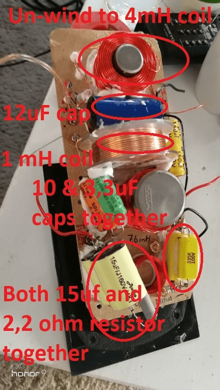

You haven´t done the "final" modification on your crossover Belemakare, so hard for me to tell!!
The final xover was on page 13 post #254 including "how you do it" and
2 X 15uF caps
12uF cap
one 1 mH coil
2,2 ohm resistor
/per speaker
Post 127 was only 3 caps

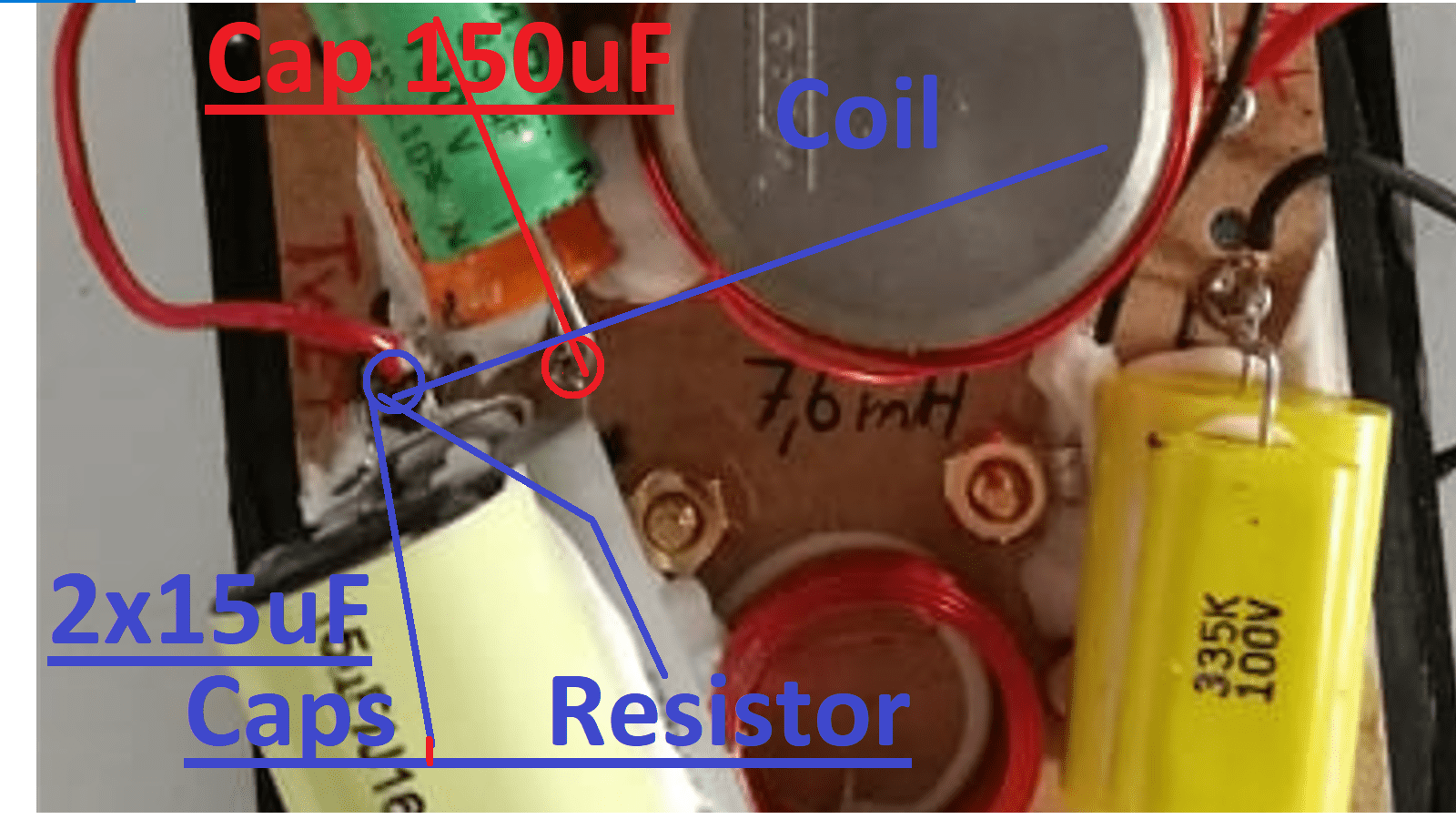

Will look it up and be backWhat is the green and orange components on the filter? They where not on the orginal filter
Wait a minute!What is the green and orange components on the filter? They where not on the orginal filter
Thats 2 big caps for the midrange a belive. ( total of 133 uF if i recall it right)

I have wrote in the "how to do" post on page 13
"On my pic xover 5 you can see i use 133uF insteed of the orginal yellow 150uF, and did that to get the impedance up a little bit but its not necessary.
I just what to mentioned it, so you don´t think anything is wrong!"

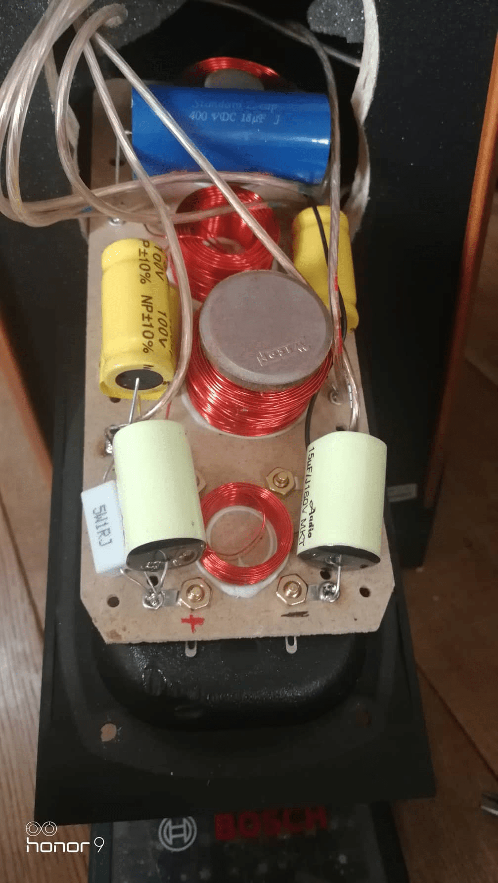

Yes thats it,but 12 is best?
Ahhhh.....Are you going after my final xover modification, so YES use a 12uF if you can. ( I was thinking you follow my 3 caps mod )
My hole xover mod was built after simulation on also the Peerlees woofer, so i dont know if it change a little if you use some other woofer ( think it work great anyway)
You fix the modification easy if you read my "how to do" manual, go for the final one.

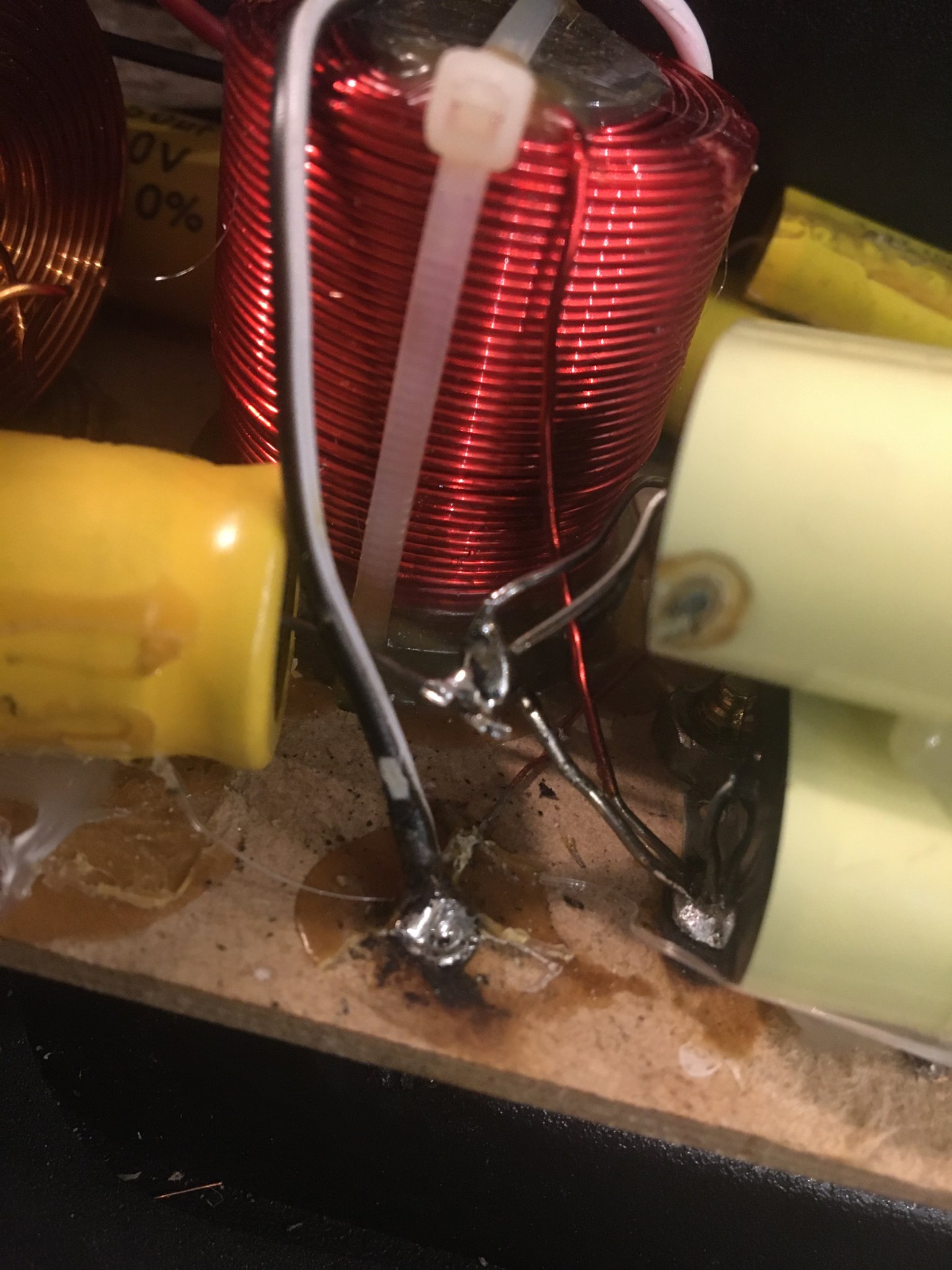

Should there be a connection between the caps to the right and down to the black and white cable? It look like **** but the ends where so short so had to improvise
You have 2 connections hole in the plate, one near the edge and one o bit in on the board.
The inner hole have 150uF cap and the small first coil at the connection-point ( if i remember right)
The connection near the edge have 2x15uF, resistor and coil in the same hole.
Did a "drawing" for you, ask me again if you need.
Was a long time sinse i did this, but hope i remember right, and that this help you.
Best regads John
Okej so the twin 15u caps plus 2,2 resistor goes to the hole with the tweeter cable and the 150 goes to the hole with the big coil?
!Okej so the twin 15u caps plus 2,2 resistor goes to the hole with the tweeter cable"
YES, also with the small front 0,47mH coil
"the 150 goes to the hole with the big coil?"
YES
