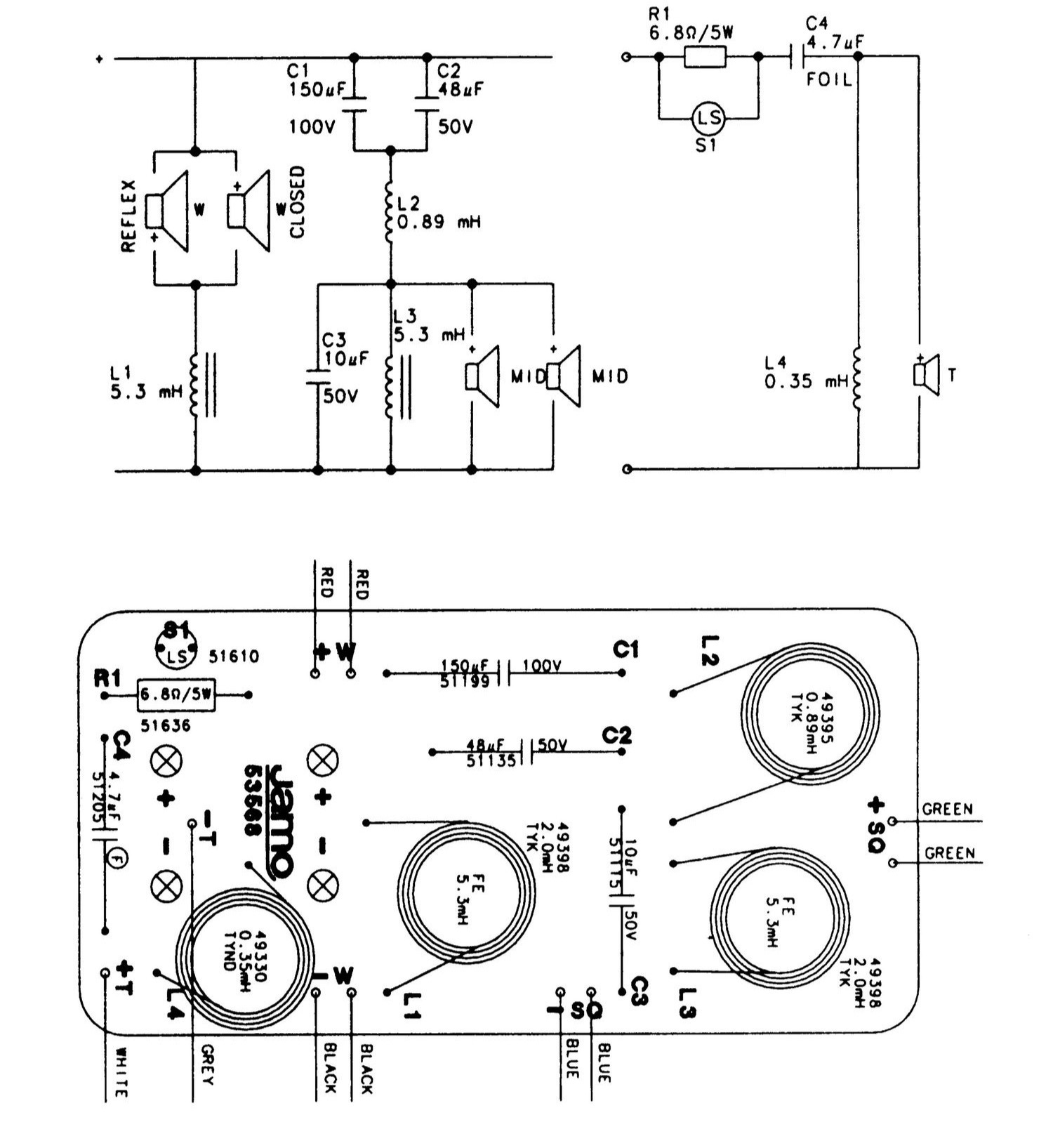

Here is the XSIM i did for Jamo 707, and it say´s 30uF and 15uF for the tweeter, and 0uF at the bandpass-filter, but 120uF before the coil.
Cheeper caps are this caps, you can use one 100uF and one 15uF and you more expensive ClarityCap CSA. 4,7 uF = 119,7uF in total.
And the more expensive 4,7uF cap are going to give you better "total" sound from midrange.

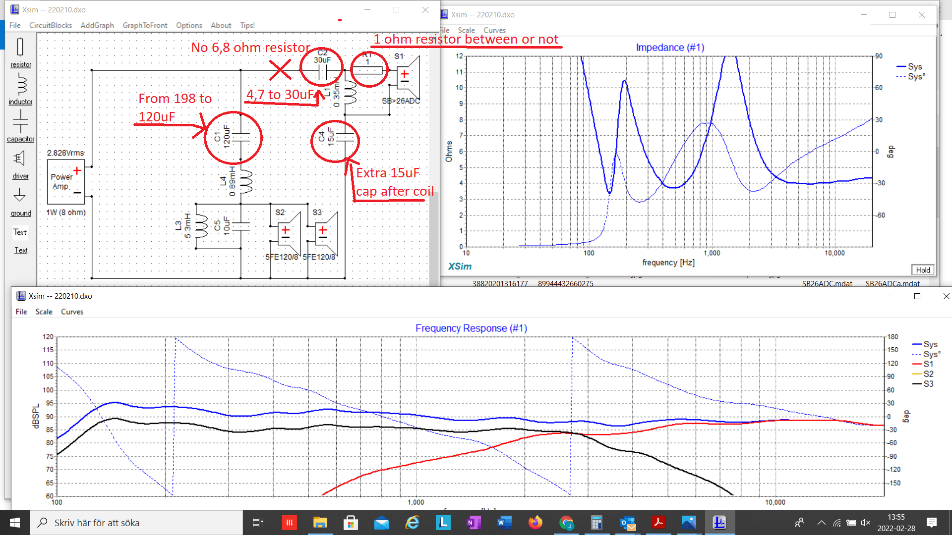

I find my rekomendations for Moorclos Jamo 707, and it goes like this.
1) Change the 220 uF cap to a 120uF cap
2) Put a 1,3 ohm resistor before the cap (220 to 120 uF ) 1,3 ohm resistor will get 11 Volt at 100 watt from amp, so use a 10 or 20 watt resistor!
3) Take away the resistors before cap on the tweeter side, and change cap from 4,7 to 30uF
4) Put a extra 15uF cap after the 0,35mH coil on tweeter-side (and connect to Minus-side)
Then if you think the tweeter is "to much or to high", put a 1 ohms resistor on PLUS-side just before tweeter
Best regards John

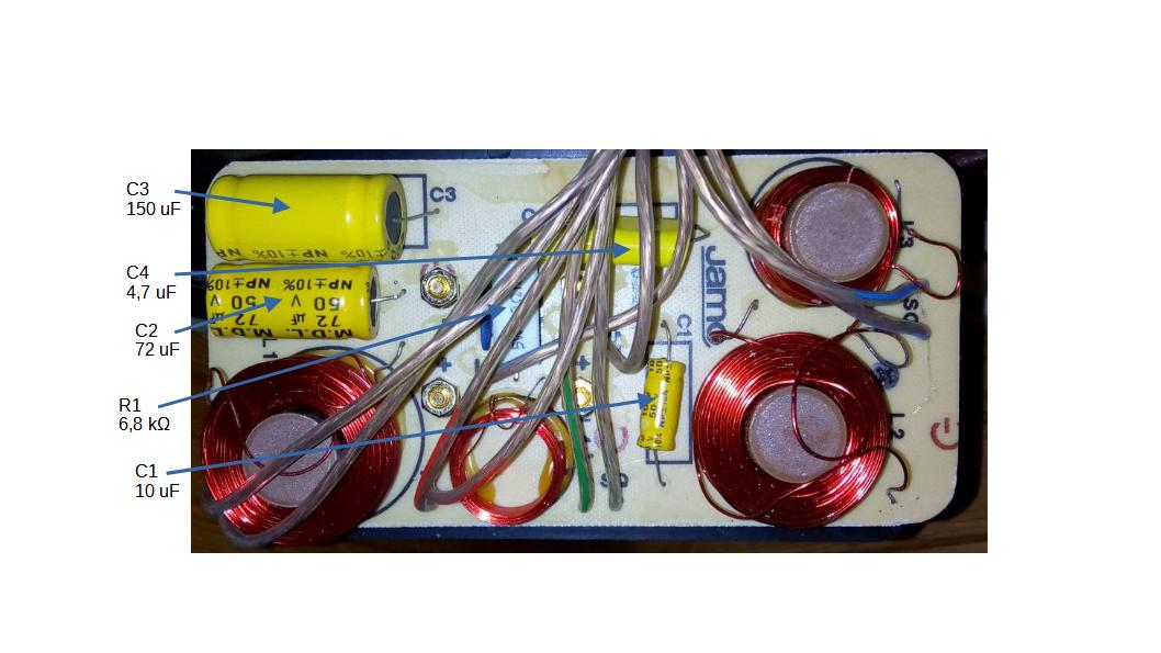

Hello John
Thanks for your quick reply and suggestions.
My Jamo's, 707a according to label on rear side, are the first ones in this "series" produced by Jamo early 90's. I bought mine 1994. Not sure of the exact chronologicals but there were 707A, 707i, and maybe more. D590 still had the same oval box design but downfiring single bass instead of push-pull reflex. Correct me anyone if I am wrong.
Viewing these xovers (before D590) they look pretty much the same, except for component values. Capacitor values on my xovers are the same as Moorclos provided (post #172), see image. Also attaching an image of my xover with tweeter and mid capacitors (original, before modification).
So maybe your suggestions are to be revalued?
About resistors, I read on another forum about 707 that changing to film resistors made a huge difference. Anything anyone has experienced?
Best wishes,
Per

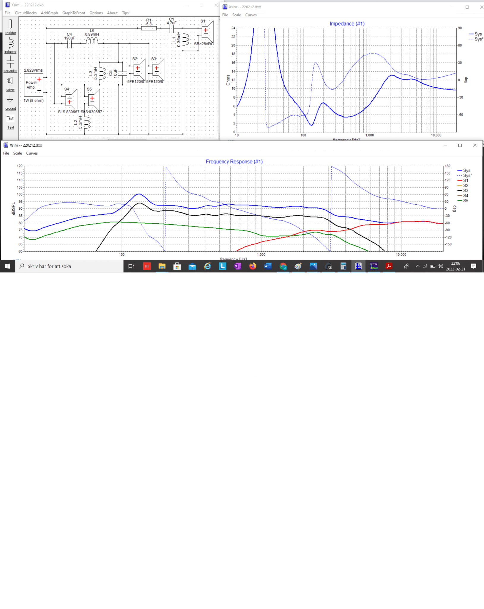

Yes Per, my recomendations was for exact that xover on your Jamo 707 so follow post #370 and #371.
You will get a much better open sound

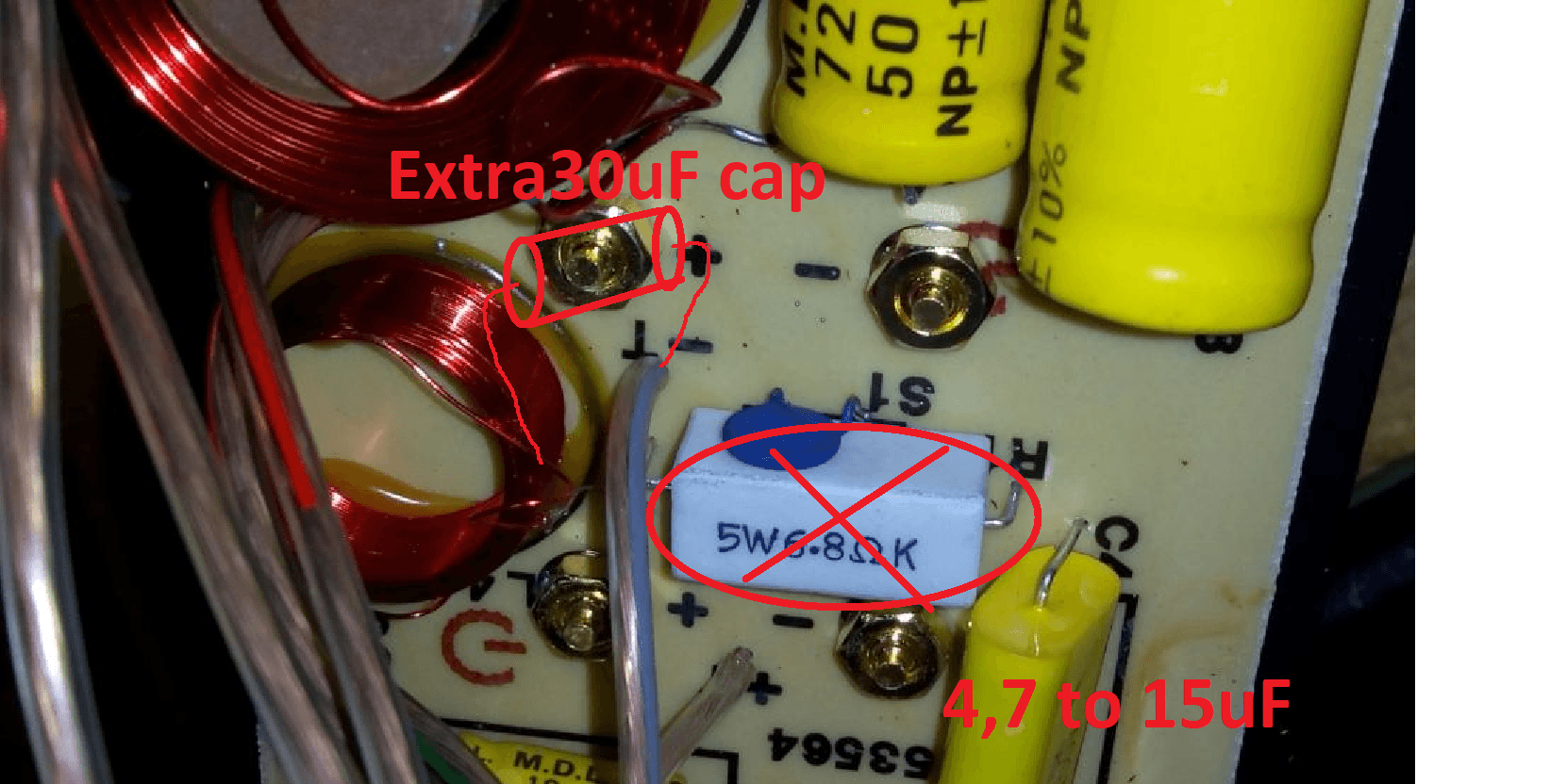

Pic pelleplutt is for tweeter modification
Then:

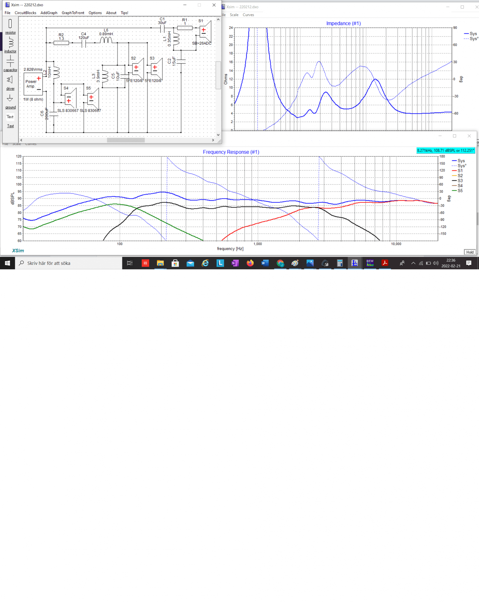

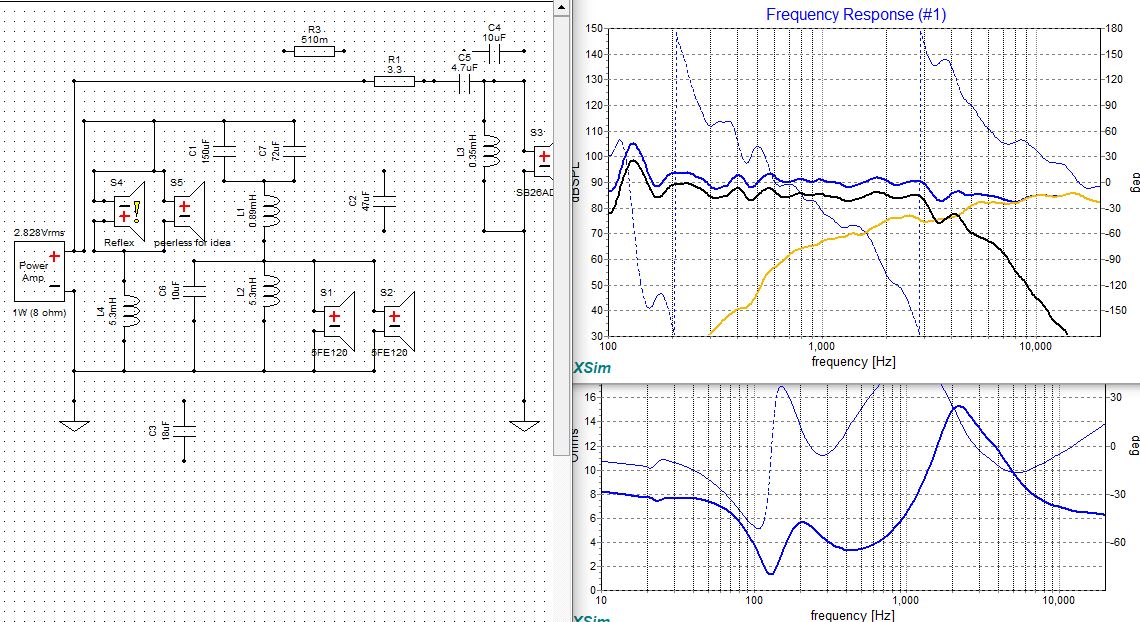

is for midrange modification, i give you my pic for Moorclos recomendation xover changes.
And last pic a simulated respons on your orginal Jamo 707 xover before modification.
And you se how much the response dropps after 2.700 hz, thats why you hear a weak tweeter!
Regads John

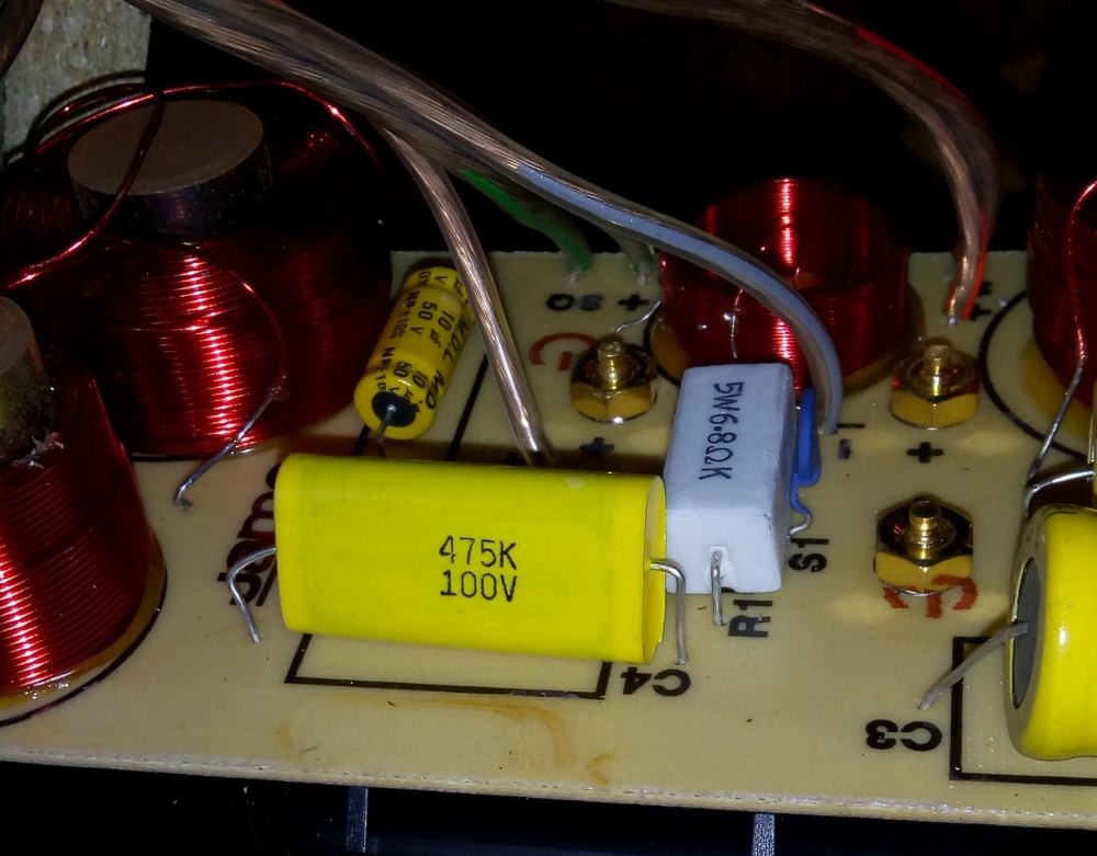

Ok John, hope you do not hit the roof, but not sure I follow. There is/was no 200 uF.
Attaching an image showing the whole original board. Besides coils, there are only five components (except for the small tantalum (?) in parallell with 6,8 kΩ)-
C2 and C3 together on your xover is 222uF ( as i called 220uf)There is/was no 200 uF.
Both go together from + down to coil 0,89 mH, and further on to 10uF/coil 5,3mH( bandpass) and + to midrange drivers.
Here is a picture,so you can se how it goes on your xover ( but 1 thing is different, your C2 is 72uF and on picture 48uF, dont care about it)

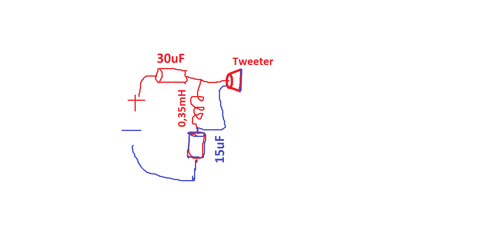

- Extra 15 uF cap after 0.35 mH coil - not sure how this is to be coupled in reality but I will study.
Yes, but negative to tweeter in the middle where the extra 15uF cap and 0,35mH coil meets....Like the pic under

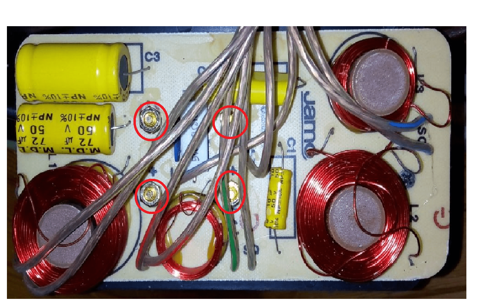

Pelleplutt, you have to unscrew the 4 nuts on the xover, so you can se the backside of the xover and solder on it.
Take a photo and show it to me also
Regards John

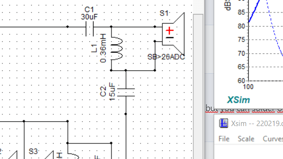

Basically you have the two caps connected in series. You can remove the 15 uF cap and substitute the 30 uF with a 10 uF as the total capacity of capacitance connected in series is calculated like this:
Ctot = 30*15/(30+15) =10 uF

Pelleplutt!
This make it much easier for you, you only have to change the 4,7uF cap to a 10uF cap on the tweeter-side!. ( and take away resistor/thermistor)

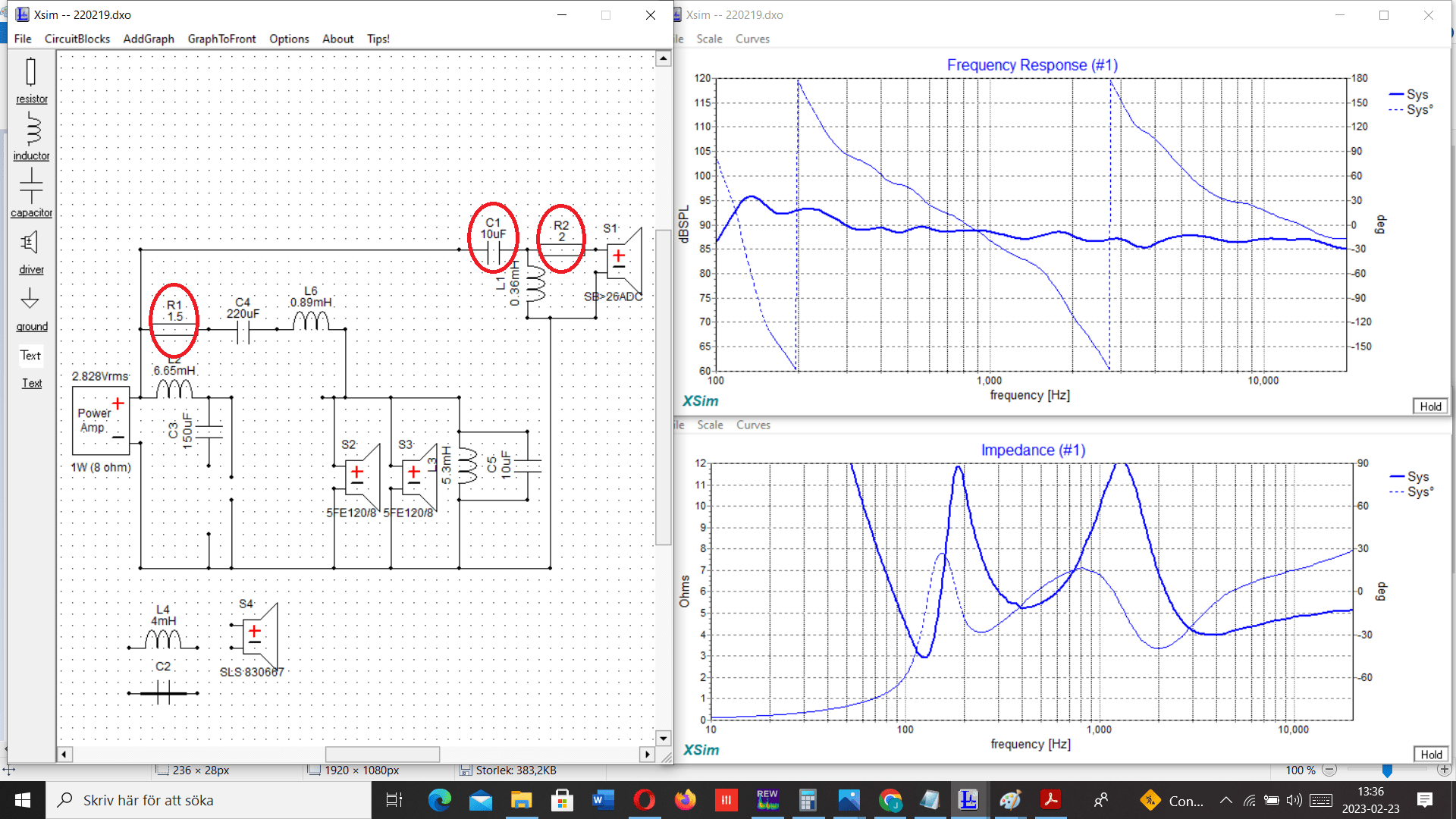

Now after shadowplay62 post ivé spend some time in XSIM simulation your speakers.
Just to make it easy as possible for you, just change your 4,7uF cap to a 10uF cap and put a 2 ohm resistor between the cap and tweeter +.
Also leave your 222uF caps ( 150+78uF), and put a 1,5 ohm resistor before the 222uF caps.
So just 3 things!
Look at the pic.
