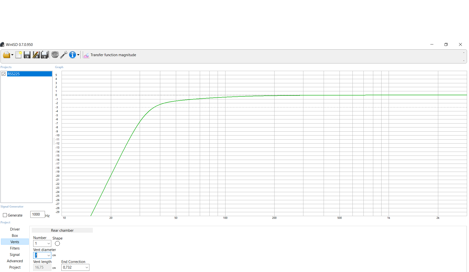

My calculation say´s around 45 liter for the sph-225 in a ported box.
I always calculate like this: VAS x QTS x QTS x 5,7 = liter
So if we calculate the sph-225 with VAS at 24 liter and QTS at 0,30
24 x 0,3 x 0,3 x 5,7 = 44, 44 liter
Also Dayton RS225P fits the box at around 45 liter ported

For the Dayton tuned to 34 hz a 3 inch port (inside its 70mm) = 16,75 cm
Will se i can find wdr file for the Monacor and come back to you
Reegards John
Thanks! What port for the sph-225 do you recomend?
Try to make a wdr file for the monacor sph-225, but things seems a litte strange when i simulate...
Think it will be fine with about the same as the Dayton, so the monacor sph-225 = 16 cm 3 inch port ( 70mm inside)

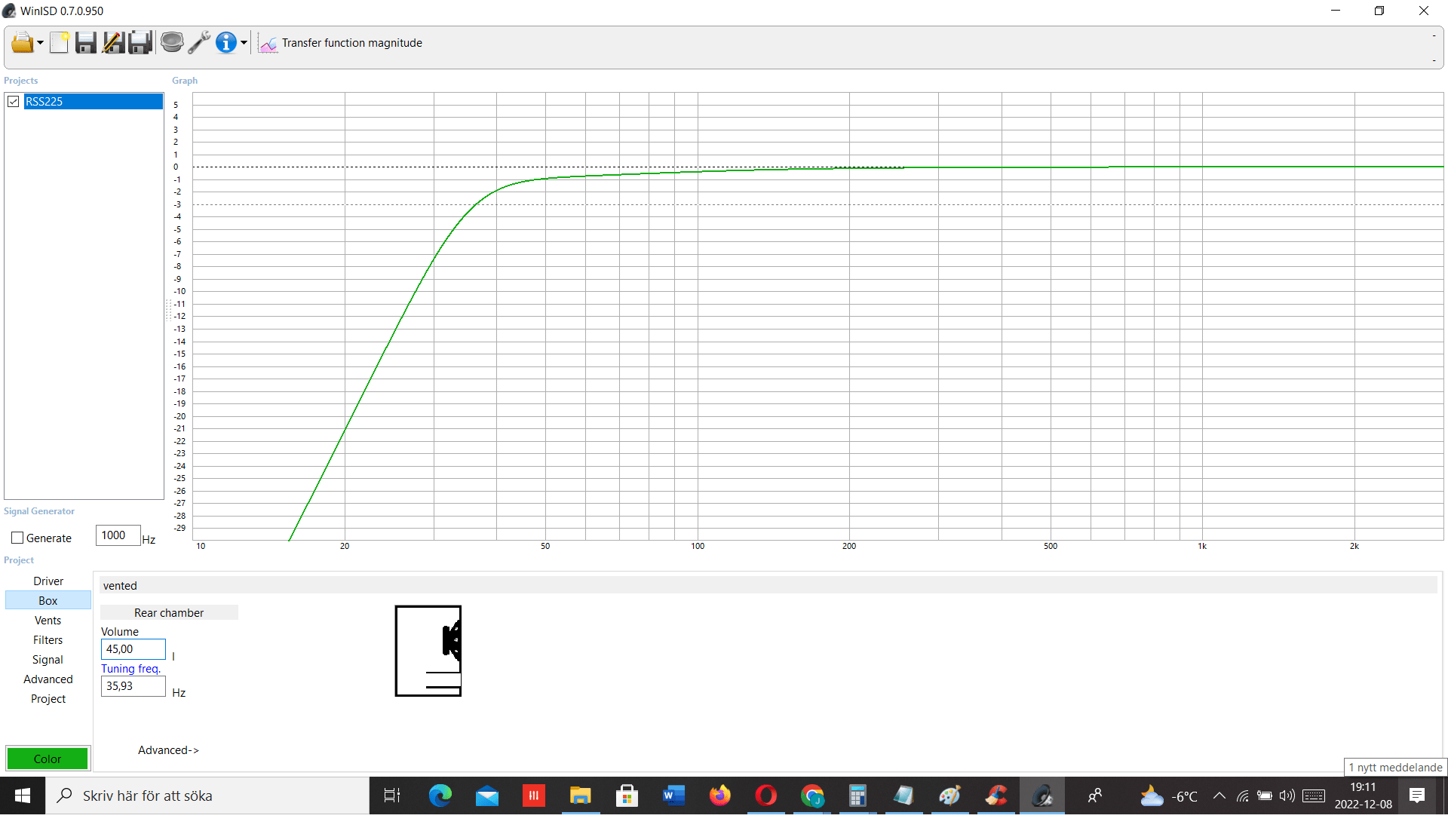

The 4 Ohm version have 1mm less XMAX and are rated 35-5500 hz but posetive thing is 92,9 dB
The VAS is also 46 and total QTS 0,38, so calculated 37,86 liter
8 Ohm is rated 30-7000 hz ( don´t know why) but 90,3 dB ( 89,1 dB at some pages)
The VAS is 69 and total QTS 0,34, so calculated 45,46 liter
Think both will be fine, but maby the 4 ohm version demands a more "low ohm stable" amplifier ( will se if i can check it with XSim)
Here is the 4 ohm verison tuned to 35 hz, 3" port 14,7 cm long
