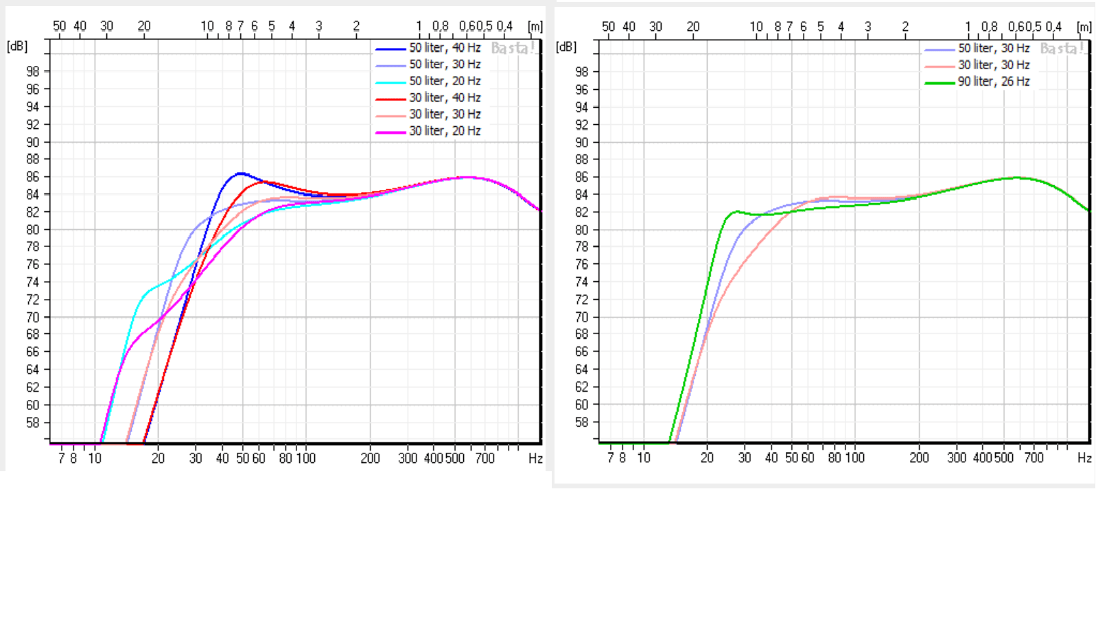

Here is also a simulation in program BASTA for that Peerlees woofer, it´s perfect with 50 liters and tune in at 30 hz as i have done👌
Best regards John

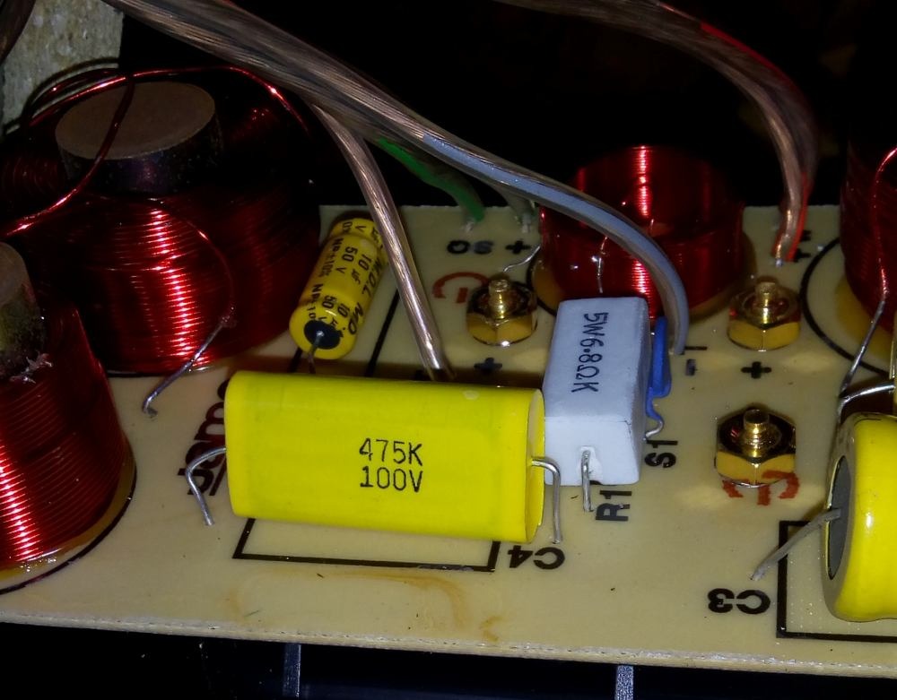

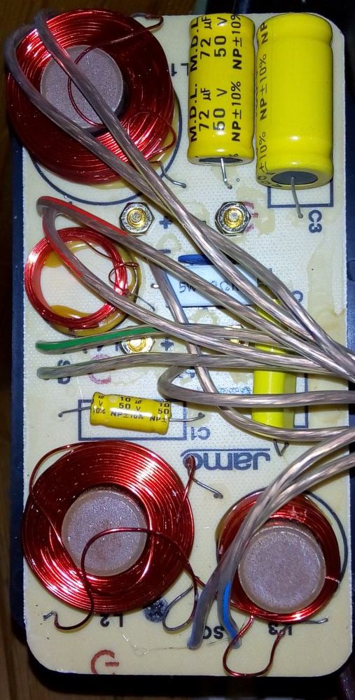

Hello all of you Jamo owners! And thank you for really interesting readings. A special thank you to those of you who provided schematics of xovers. I was going insane trying to figure out how my xover was coupled. Never heard of this isobaric xover.
Been reading this for a couple of weeks but joined this forum today!
The reason is, I own a pair of Jamo 707a (yes, 'a', that´s what the label on the rear terminal says). I bought them in 1994 and it seems like Jamo kept this curved design for quite a while, as it can also be seen in 707i and D 590 models (maybe more models?) The interior changed, though.
To cut it short, I have never been a hifi diy-guy but I had to refoam the push-pulled 8" woofers, with success! (Mind you, I am 70+). Since the cabinett is very well built, IMHO, it seemed like a terrible waste to just throw them away.

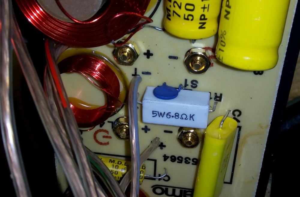

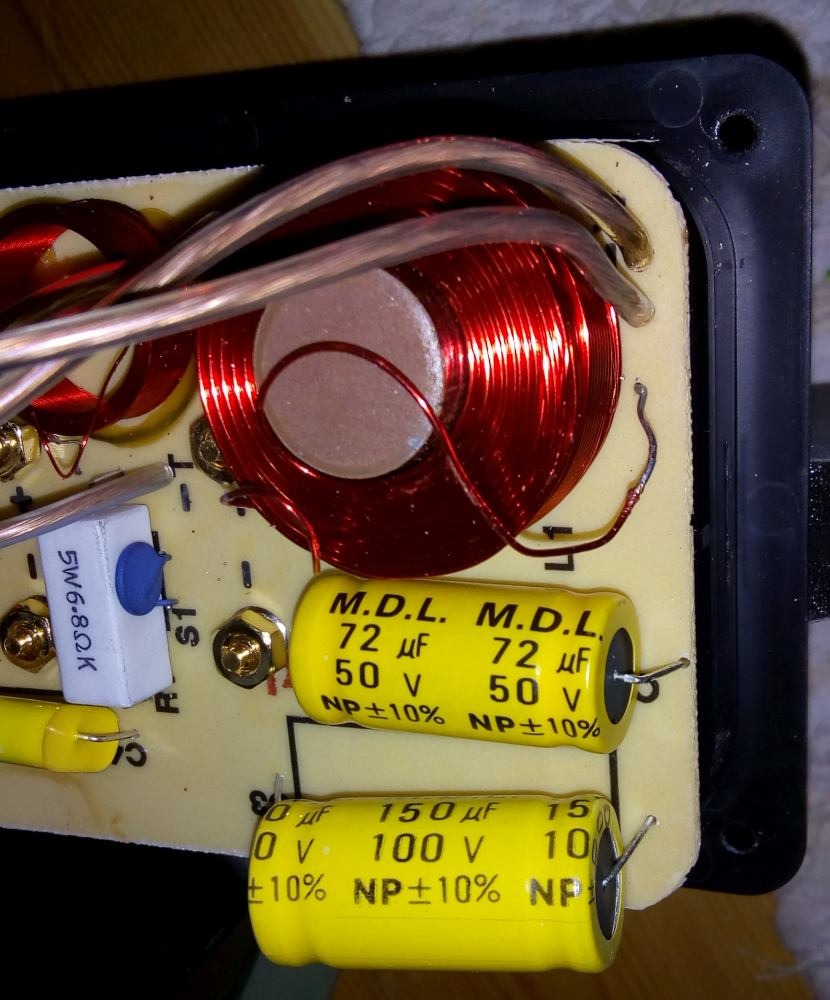

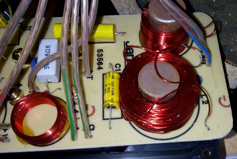

I recently bought a new integrated amp, Rotel RA-1572 MK2, and the speakers sound just great. However, what to do with a 28 years old xover? I think I need some more clarity in the upper regions, or maybe it's just my aging ears. But they are the ones usually listening.
I can see from Jawens (hey, I'm from Sweden too) and Moorclos' posts that my xover should be the same isobaric 4th bandpass, with other values and names.
My capacitors are: C1 10uF, C2 72uF, C3 150 uF, C4 4,7 uF. Attaching images.
Well, stopping here before you get tired of reading. Your help will be highly appreciated!
Thank you and take care!

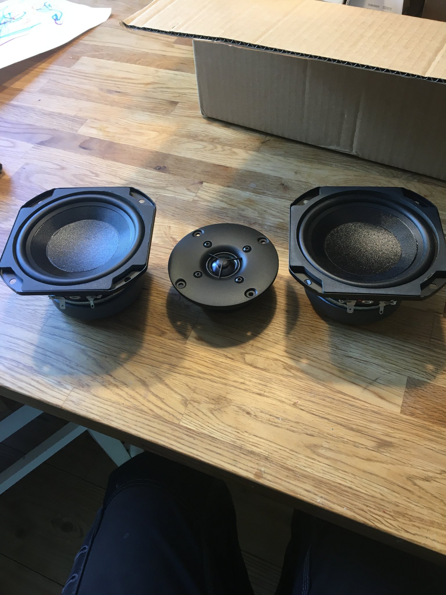

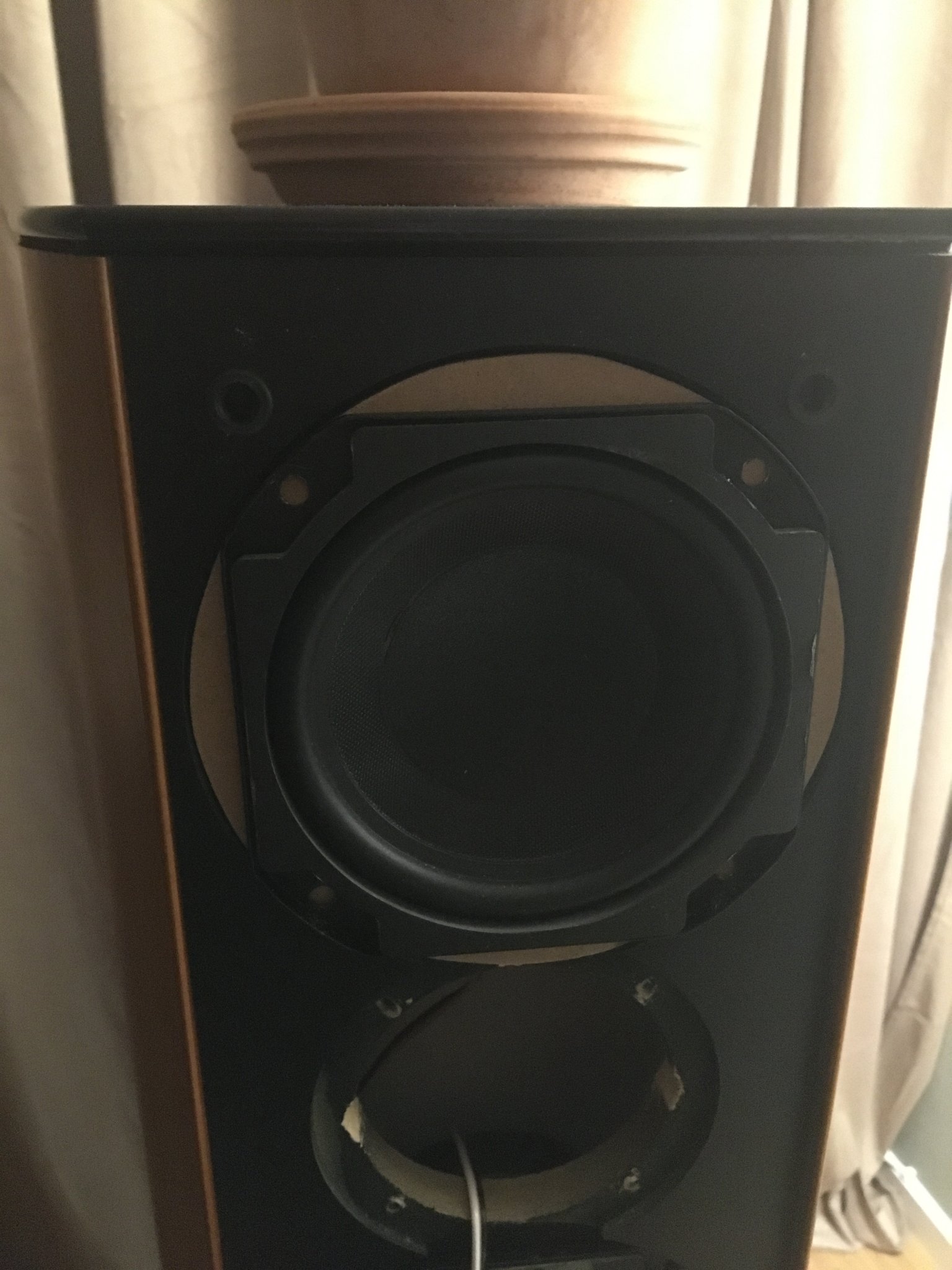

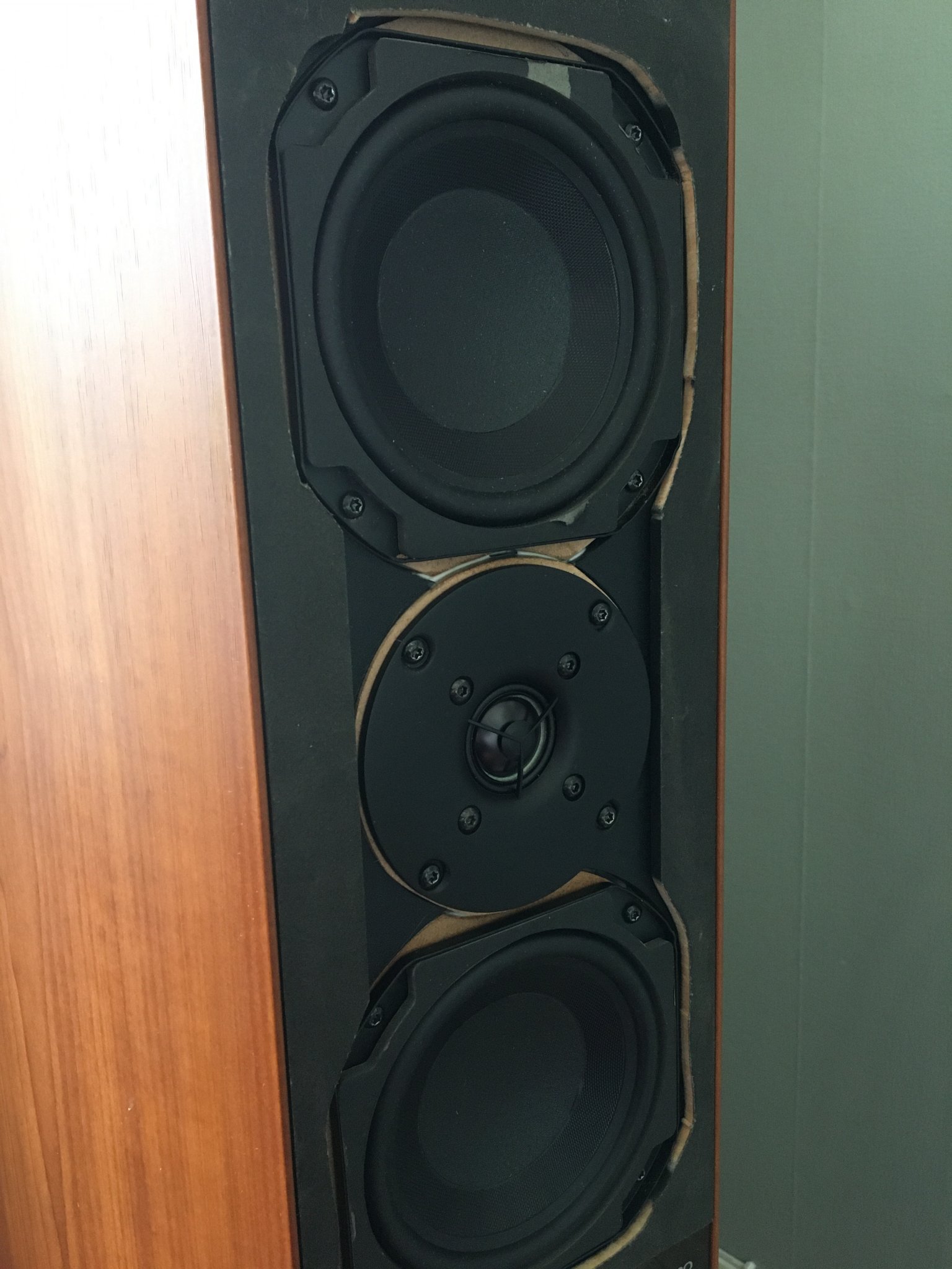

Alright now i have tested the new mids and tweeters and its a nice improvment!
more details in voices and tighter,faster midrange

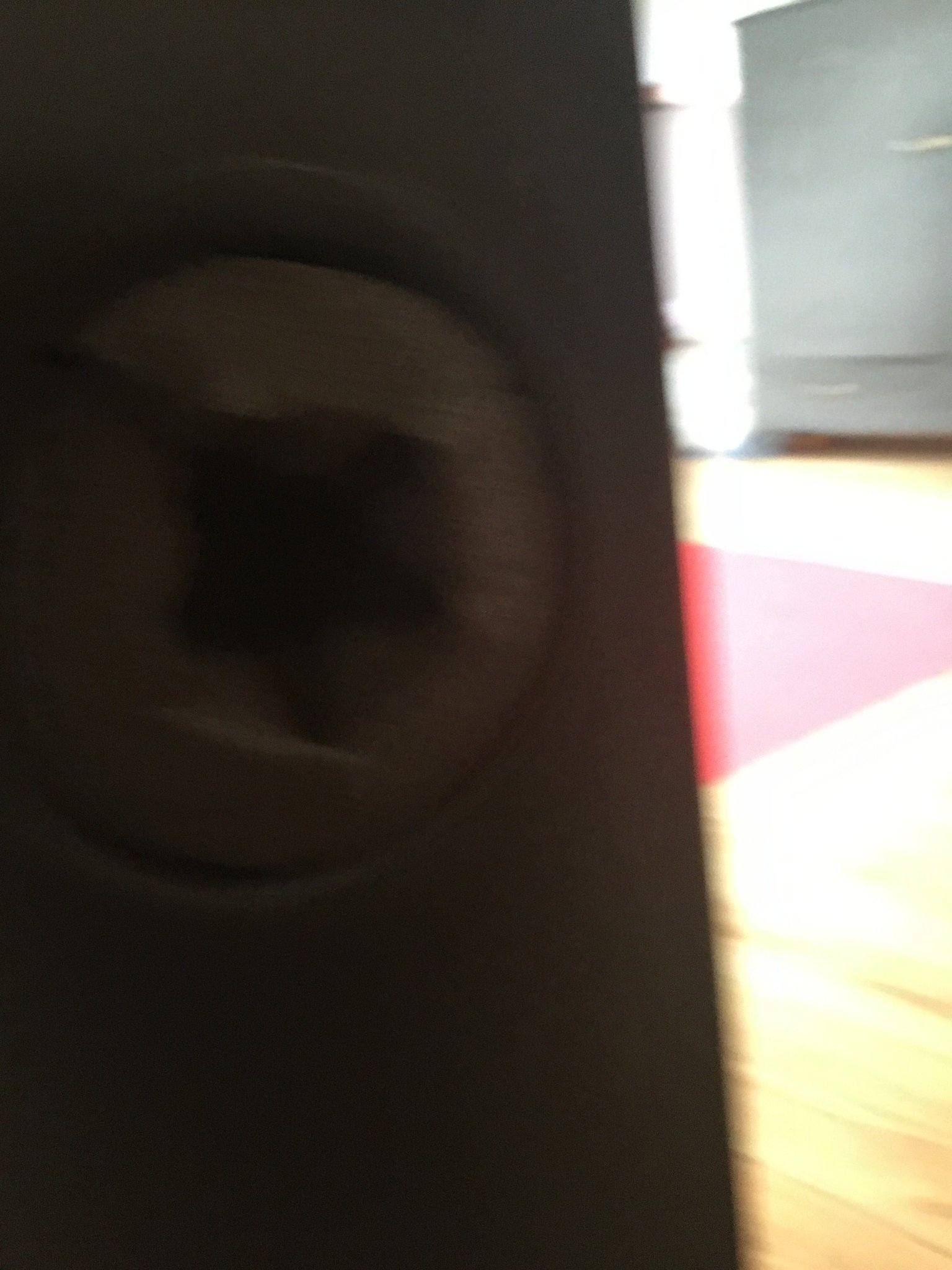

One thing i noticed is there is only about one mm sealing area between the hole for the tweeter and the mids..

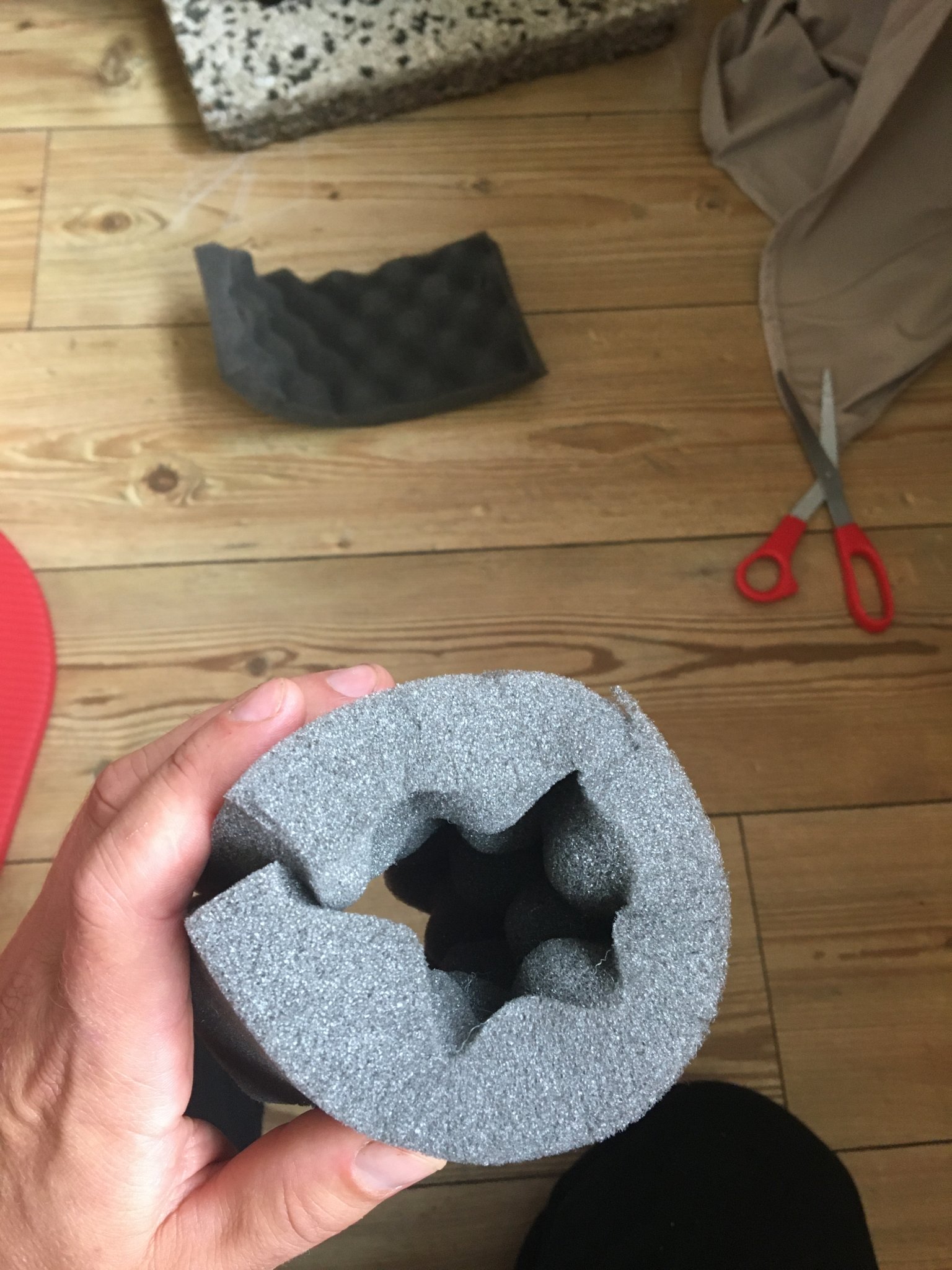

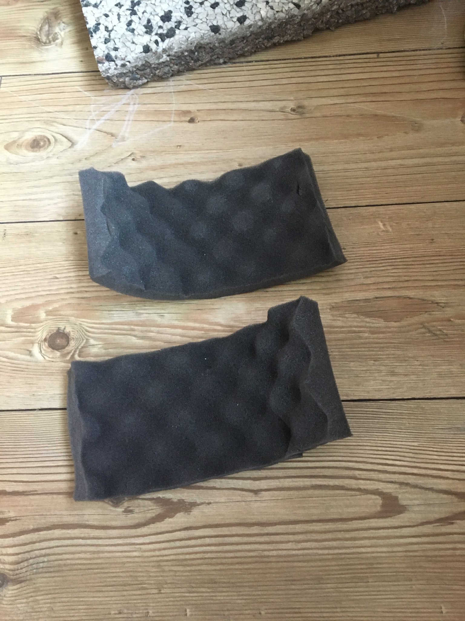

I also tried with foam in the bassport to ”stiffen” up the sound and it works at least a little and probably leads to a more correct sound but maybe a bit boring🤷🏻♂️
At least in my home the speakers have a lot of bass,but not as tight as i want..,they stand about 30cm from the backwall and 70cm from the sidewalls

Maybe keep tweaking positioning. Another old trick you could try is a bunch of McDonalds straws in the ports 😆

But Messing around with the bassport today and this seem to be a nice compromise for now,less bass but a little less sloppy but the bass is still like a tired slow sub..

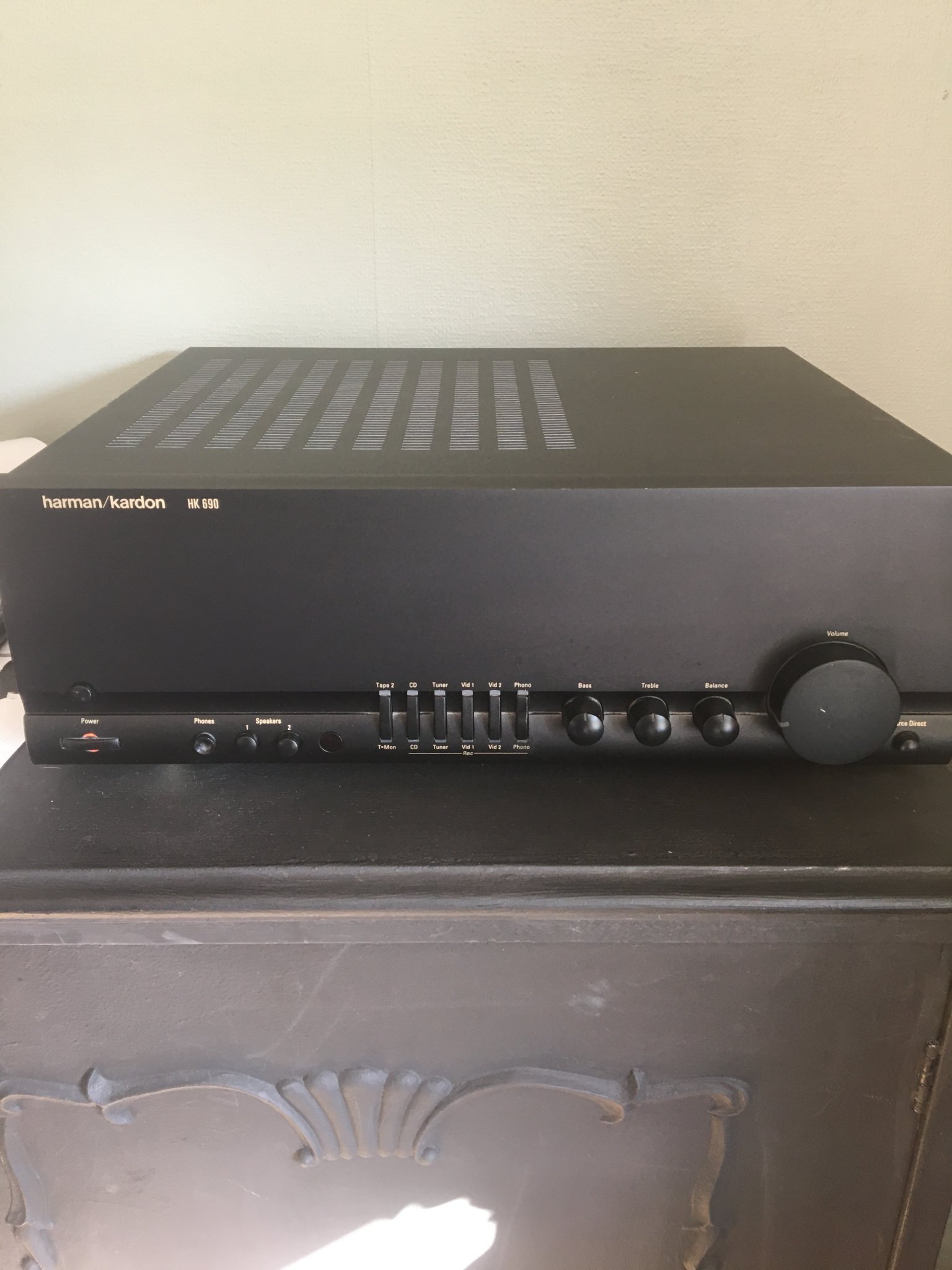

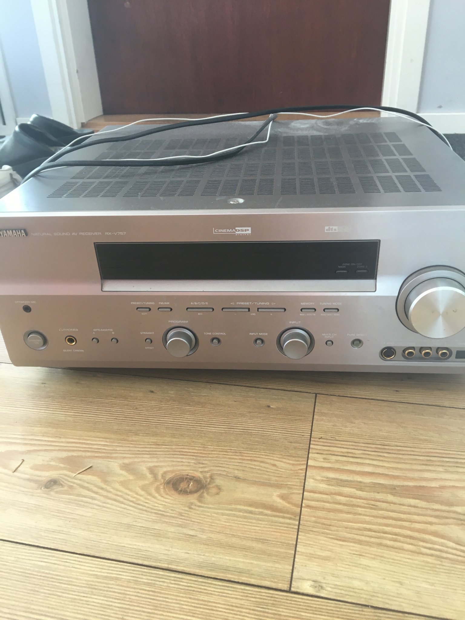

Out with the old yamaha and in with the
”New” Harman/kardon
And this was a nice upgrade! More air and seperation in the sound and with this one its way clearer when you play loud,
The jamos never sounded this tight with the yamaha!
”New” Harman/kardon

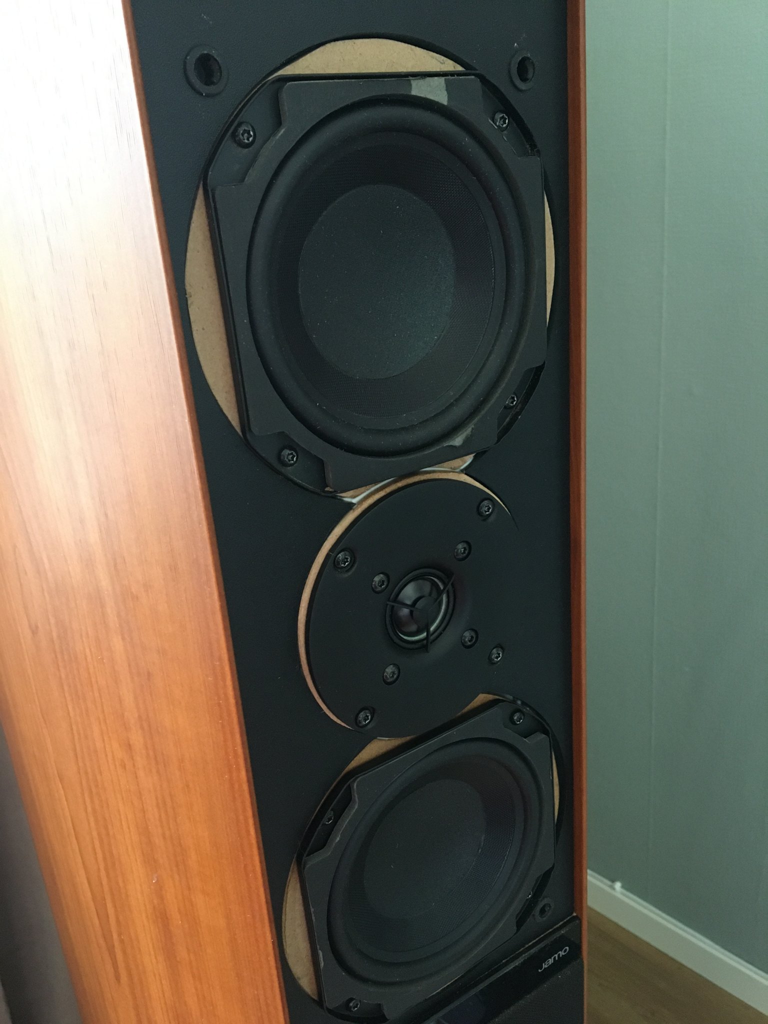

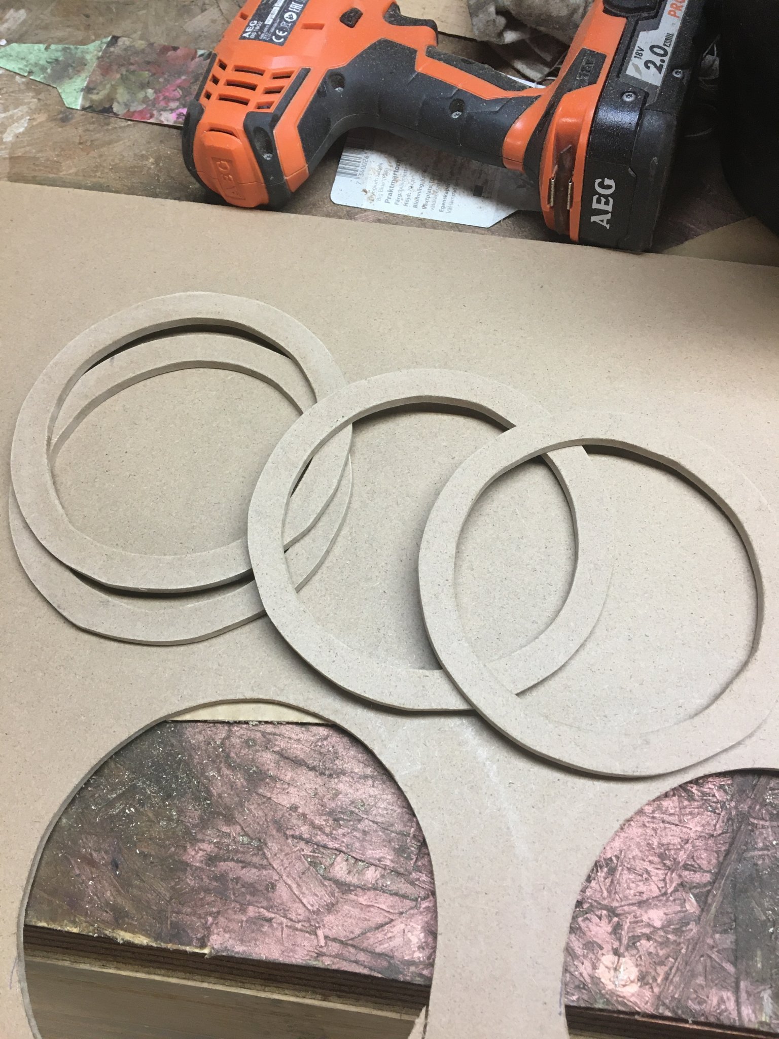

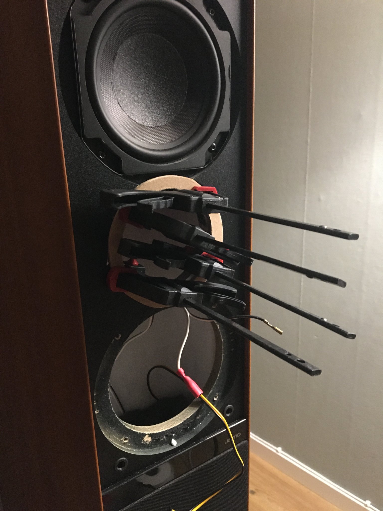

Cut out 5mm mdf spacers for the mids,should fit under the original grill with some minor trim to the frame of the grill,

After listening to the speakers for some time with the new mids,tweeter and amp i think it sounds really good but the treble is a bit low still, thinking about trying the
Scan speak discovery D2604/833000 tweeter with 94db sensetivity

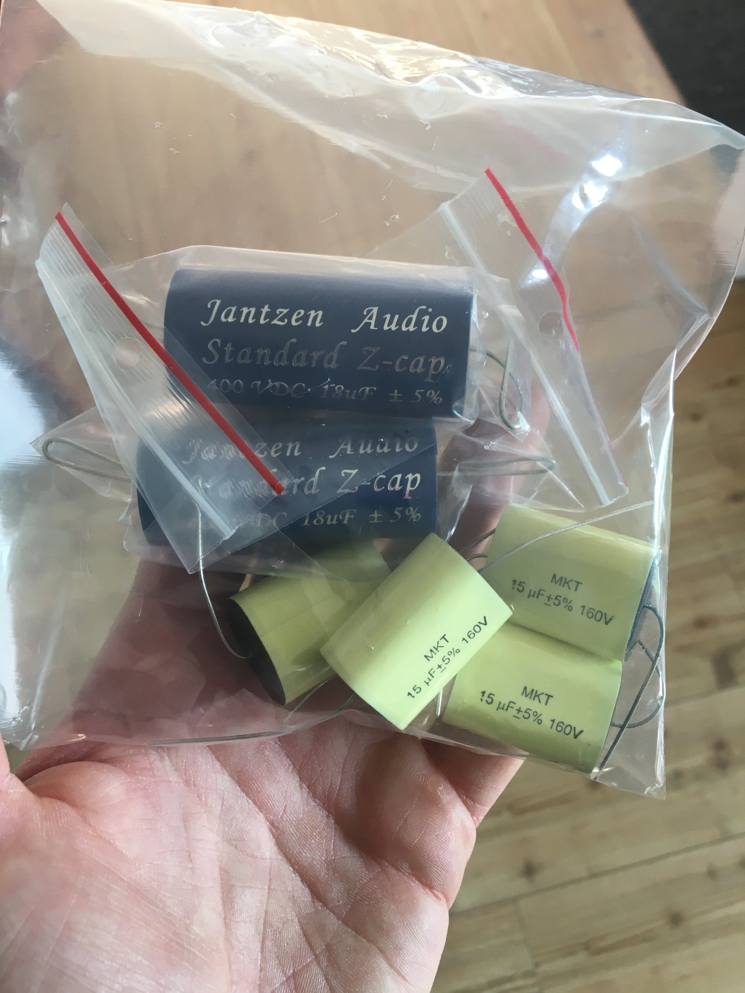

Alright now the modified xovers are installed and tested and wow what a difference! A brighter an clearer sound in the upper range and guitars more up front in the sound🎸👍🏻
Probably a nice thing to do even if you dont do anything else to the speakers.
So far all the modifications have been worth doing
The quest continues😉

Now the spacers and the grill is installed and it fits perfect,havent listen yet but there should be at least a wider dispersion of sound?
