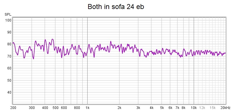

Just to mesaure what i hear today ivé mesaure both speaker in stereo at the listening-point in my sofa (there i use to sit and listening)
Also good to now how the curve you like look´s i think....and learn more of course
I mesaure from 200-20.000 hz because under 2-300 hz is just the room impact, so better trust your ears 👍
And my room gives 30 hz at same spl as the rest of the curve, but have a peak at 45 hz and 90 hz.
And i still have orginal port, now in both speaker beause the xoverboard could not fit when i had the 100mm x 48 cm long port in.
There was no room for it,!
So i will now buy 2 pieces of 70mm port insteed and cut them at about 20 cm length.
Mesaurements in 1/48 Smoothing !

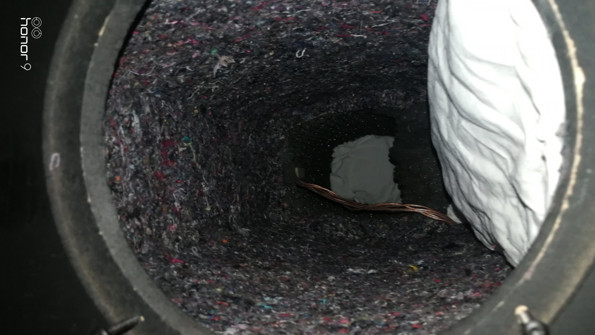

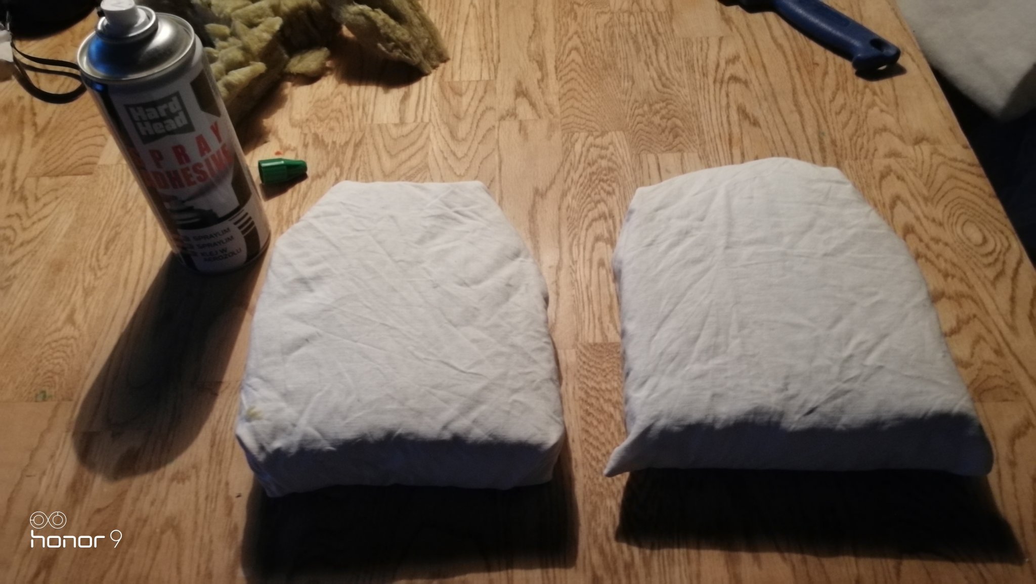

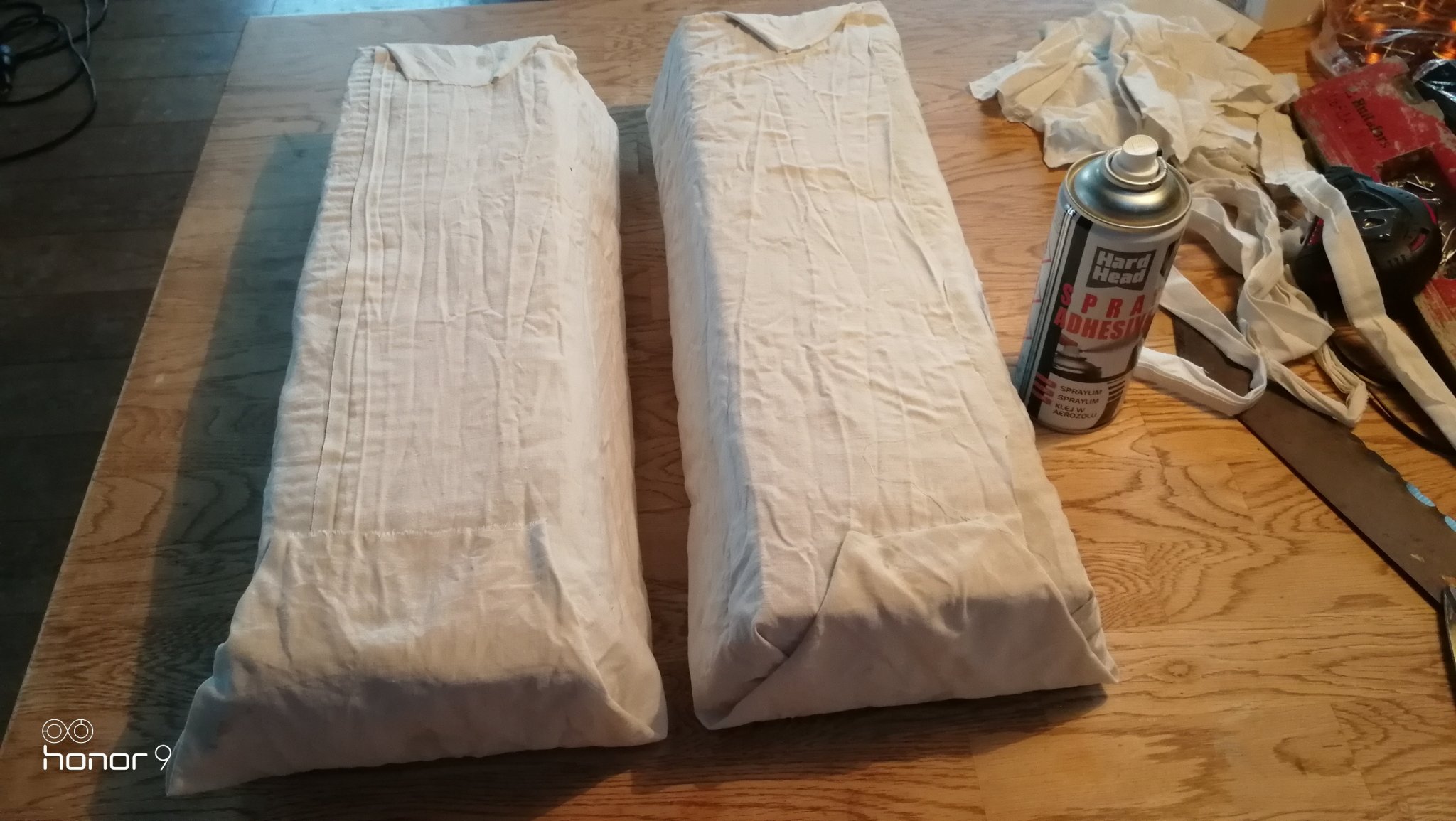

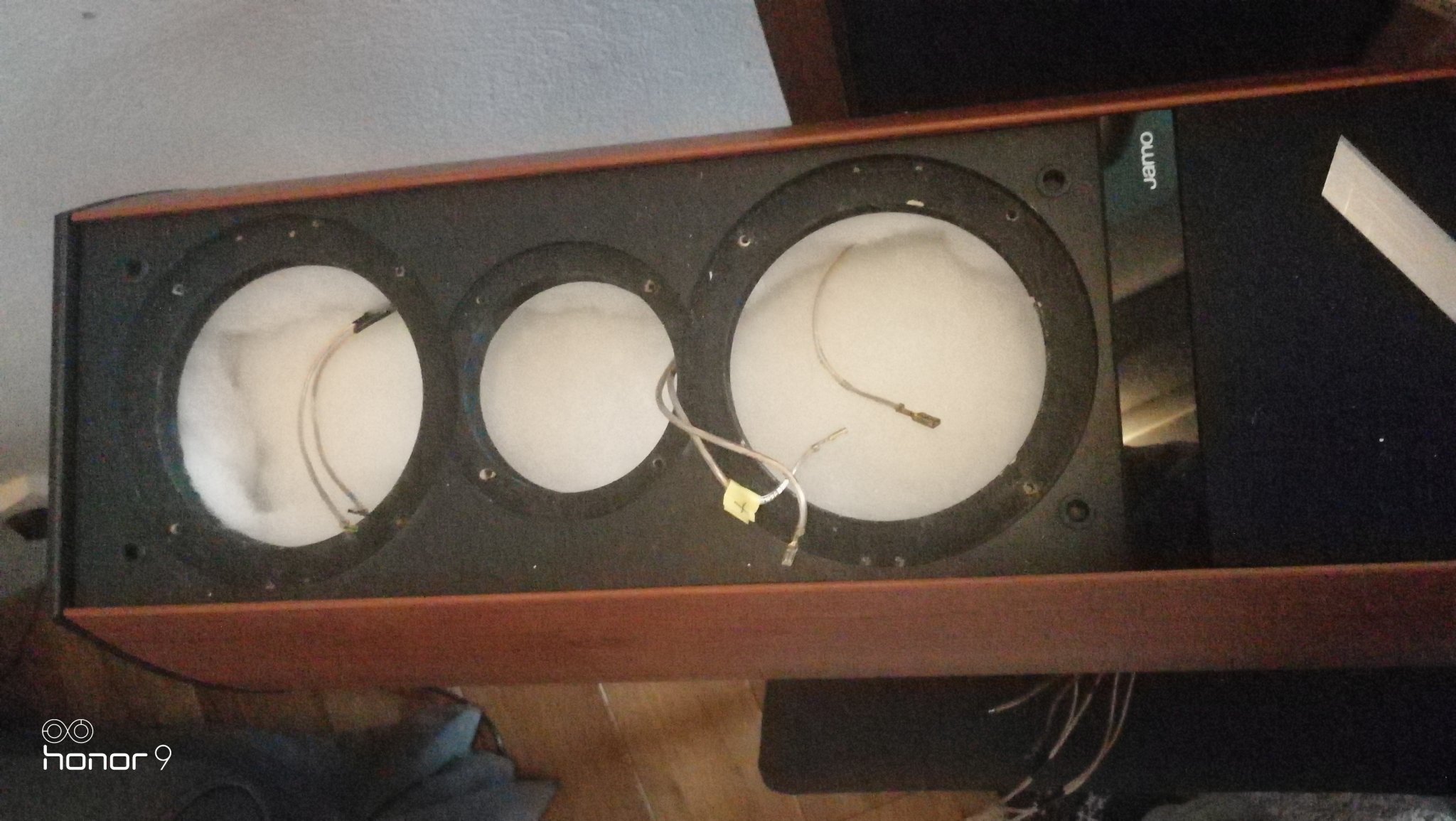

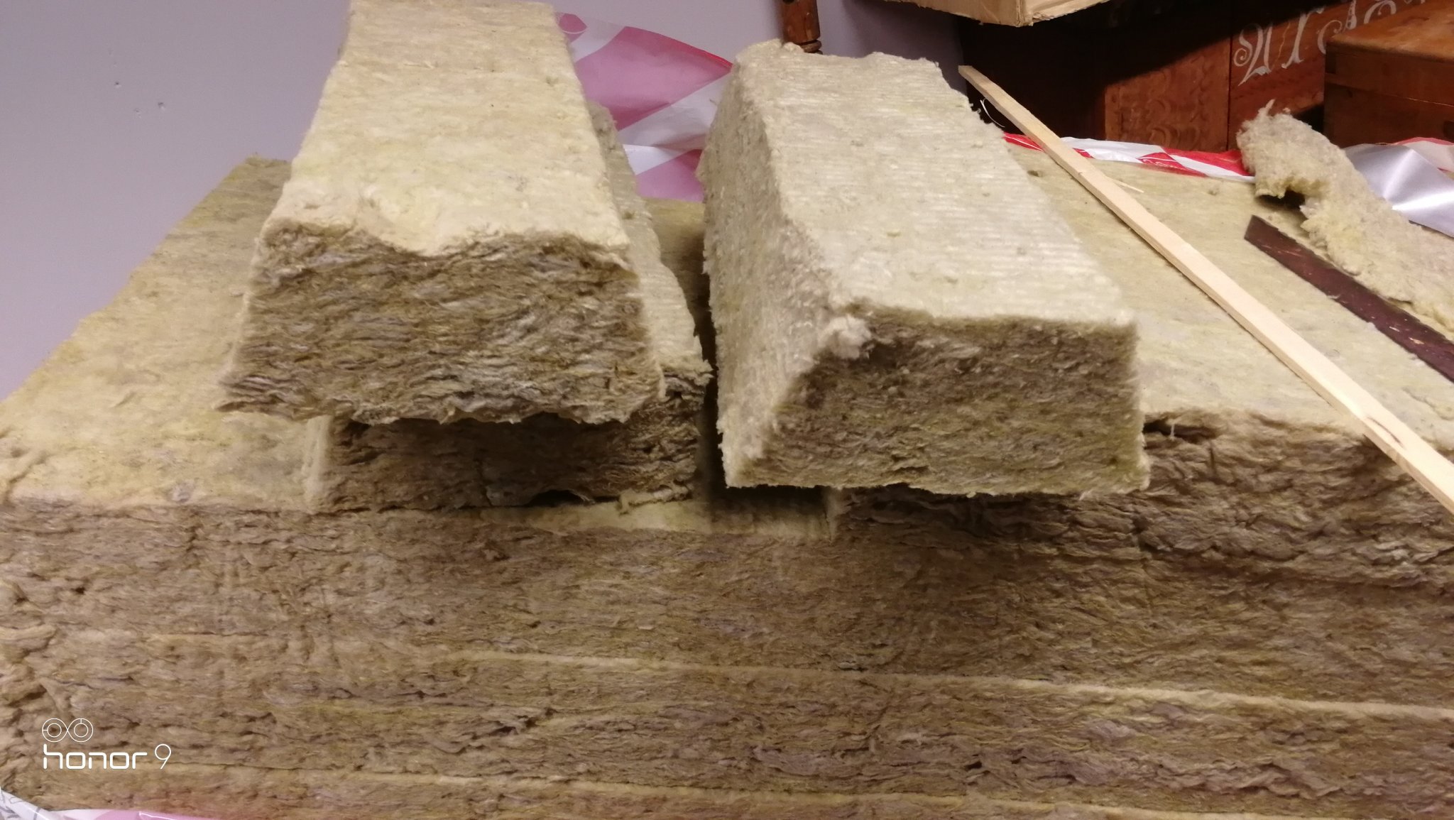

Have you been messing around anymore with damping or is it the standard foam?
Here what i think about damping in this project Belemakare.
If you dont change the orginal port, there's no point doing modified damping/Filling work, because you dont get "more clean bass" out of it.
So if you dont modify orginal port, let the orginal daming/filling as it is.
But if you modify orginal port you have a gain also modify orginal damping/Filling !
Im using rockwool on one side (inside cabinette), and also a small piece at highest point inside behind the MTM ( Direct under the top glas on top)
When you play loud the biggest vibrations is on the top of this speaker, therefore the little piece of rockwool at the top inside.
And on all other surface i staple 8-10 mm filt-material ( you can look at the picture )
Wrapt the rockwool in a piece of old sheets, so it don´t releases hazardous fibers into the ear because its a reflex-cabinette.
And i also rebuild MTM damping with a 30mm rockwool in the bottom, and ordenary polyester-sheets covering al "naked surface inside"
Best regards John

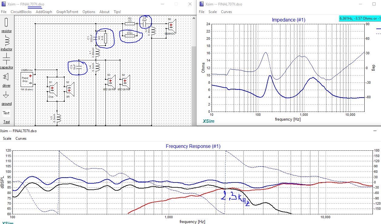

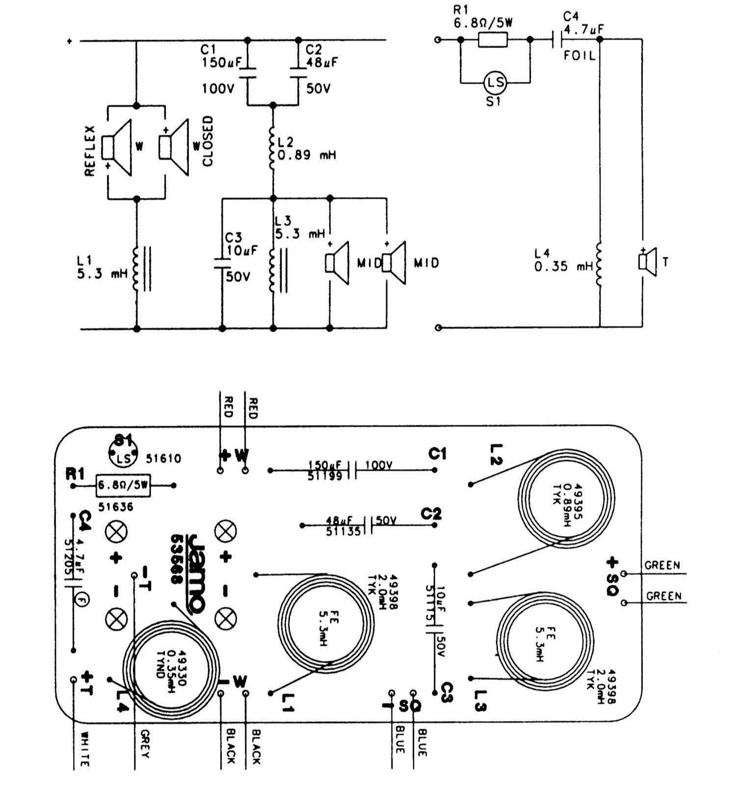

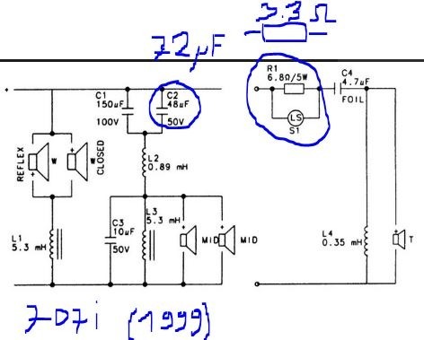

(I used your 'moorclos sim' John) - tried many, many adjustement, some did the same job.
And try to use the easiest adjustements,
[with real mesurements in cabinet post 154]
It seems to be the best I can find.
Only 4 changes that I should do (on my cross - Jamo 707i from 1999)
in // with the 222µF (on the board) R6.8ohms [make impedance 'good']
in // R510m ohms (with 3.3R on the board) [near to do the same job as -| |-30µF and the R]
10@18µF (Medium)
4.7@10µF (Tweeter)
If you have observations on it, ty

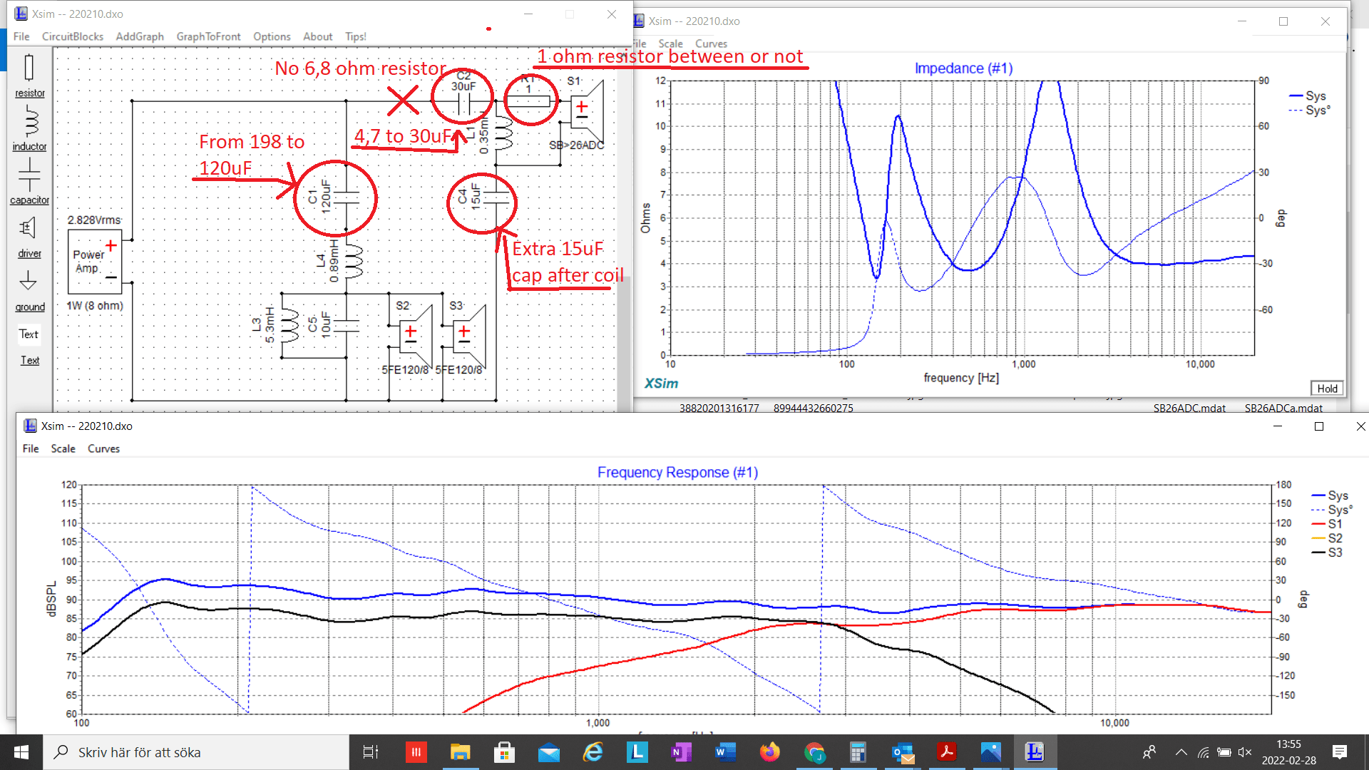

You can´t build like that, your 6,8 ohms resistor gets 45 Volt at 100 watt from amp.
And i think the curve doesen´t looks so good.
Better try follow my last XSim or this one in this post.
1) Change the 220 uF cap to a 120uF cap
2) Put a 1,3 ohm resistor before the cap (220 to 120 uF ) 1,3 ohm resistor will get 11 Volt at 100 watt from amp, so use a 10 or 20 watt resistor!
3) Take away the resistors before cap on the tweeter side, and change cap from 4,7 to 30uF
4) Put a extra 15uF cap after the 0,35mH coil on tweeter-side (and connect to Minus-side)
Then if you think the tweeter is "to much or to high", put a 1 ohms resistor on PLUS-side just before tweeter
Also think you will get alot more on woofer-side if you put the coil before woofer + side, and also use a cap after ( like my earlier post show, when i use the Peerlees woofer in a example)
Best regards John

Maby skip the 1,3 ohm resistor before the cap 220 to 120 uF.
I was some time since i sat in XSim with your Jamo 707 filter Moorclose, so i dosen´t remember exact all details.
But things looks okey without the 1,3 ohm resistor ( Function is It dampen the mid´s a little, if you have needs for it)
/John

Thx John, you gave me a lot of time, to help me learning (xsim can do things, but without knowledge in theory craft, and math, you can easly make something wrong --- like with resistor, (I had the feeling, that something was wrong)
[for the woofer, my considerations ""I rode that with a isobaric 4th, in bandpass, it's not easy to build(but here the cabinet, was build for it, only variation it's the event), but it act like a natural high an low pass (so don't need many things in the woofer line"")
