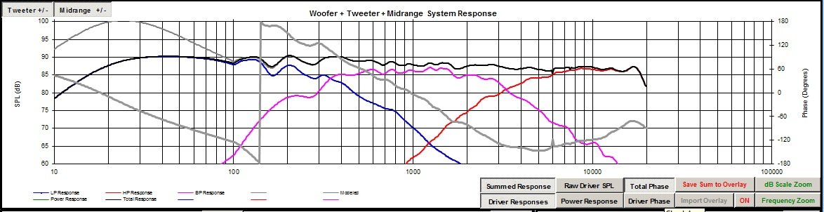

3-way to active - Hypex FA253 - learning project

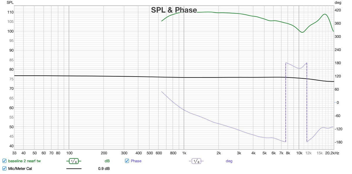

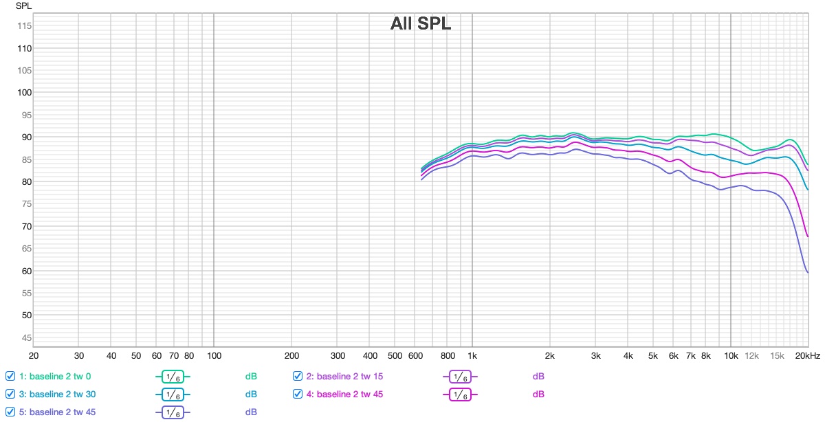

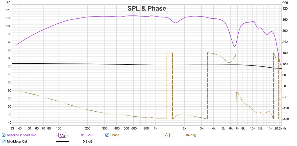

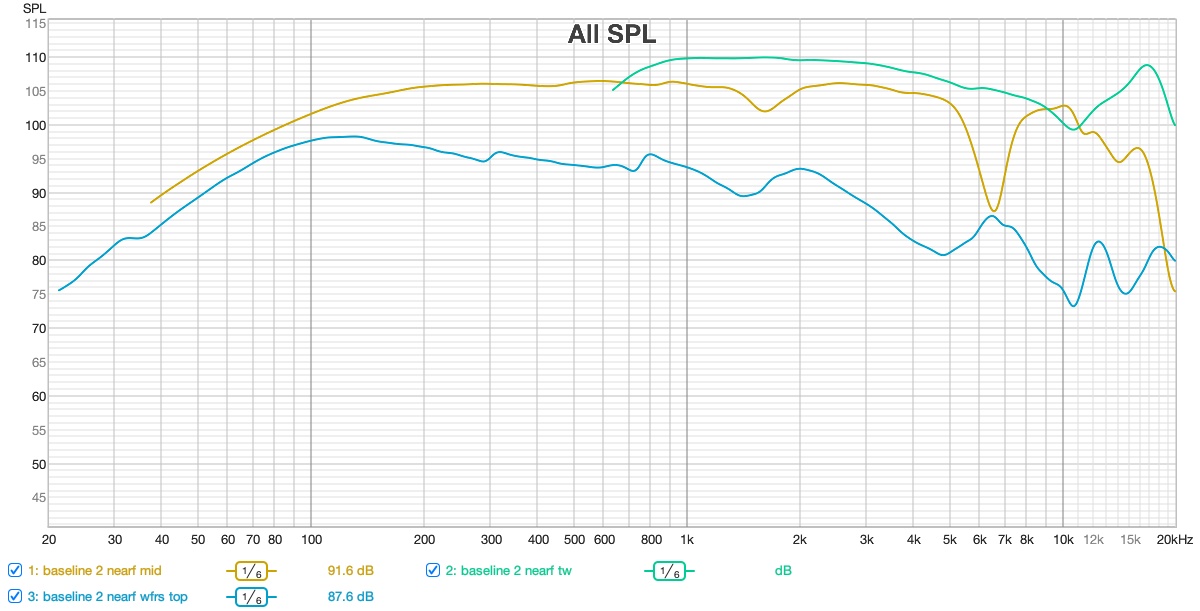

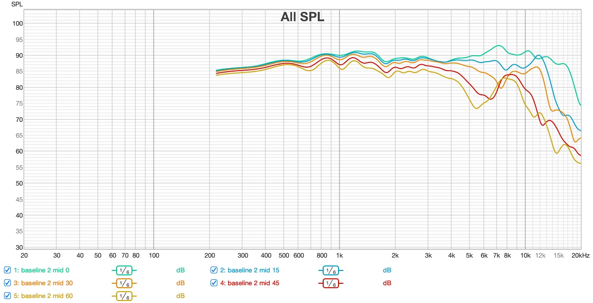

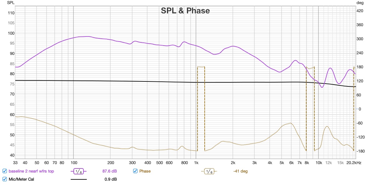

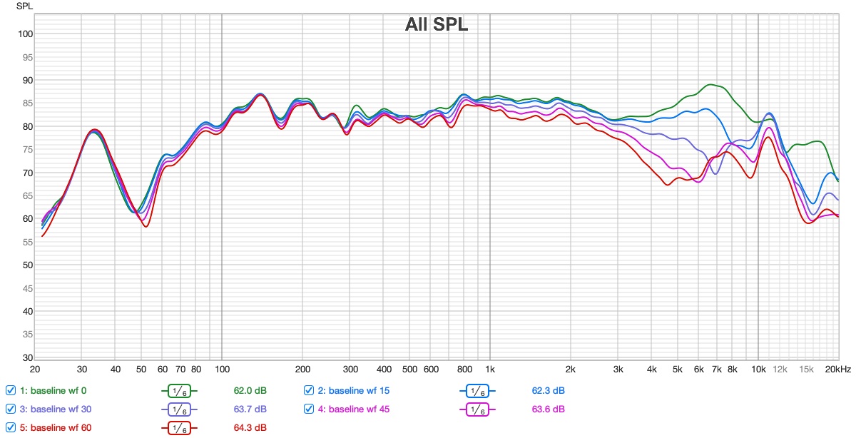

graphs with updated scale, tweeter, mid, woofers
No values shown, just responses. Don't look too close below 100hz, That's just simmed from a straight line response below 100hz, and with some boost. I think with the boost, it would look like the flatter response.

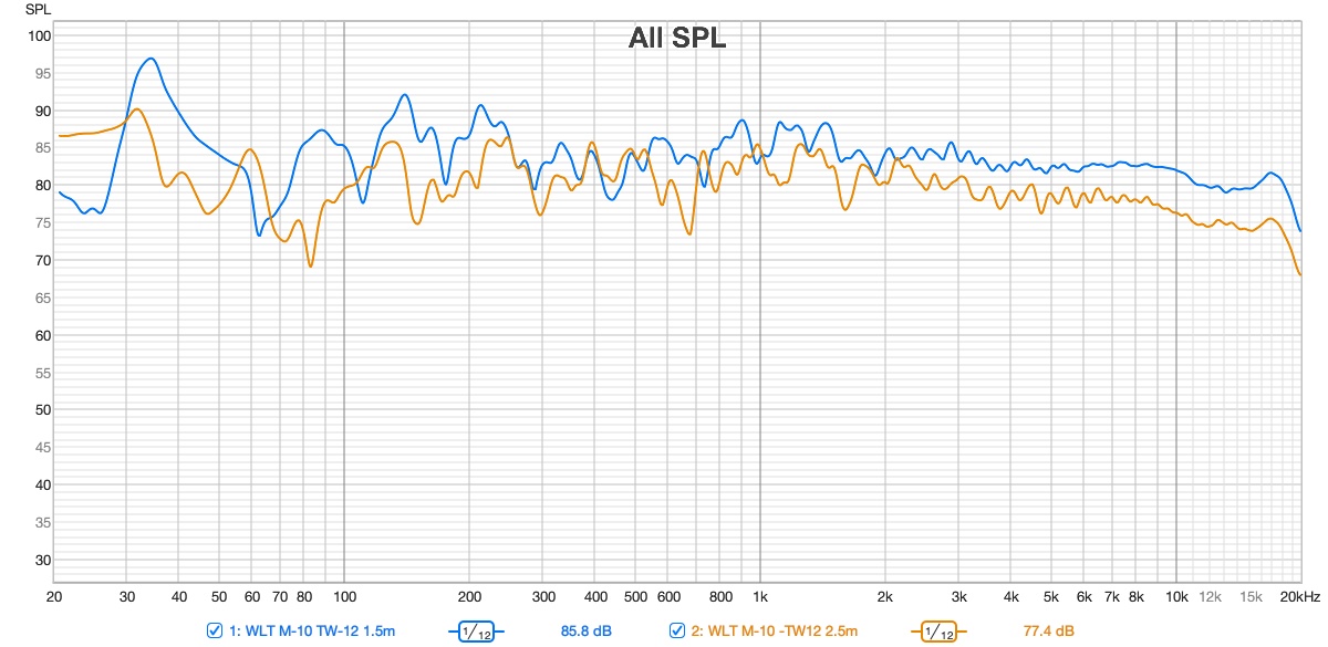

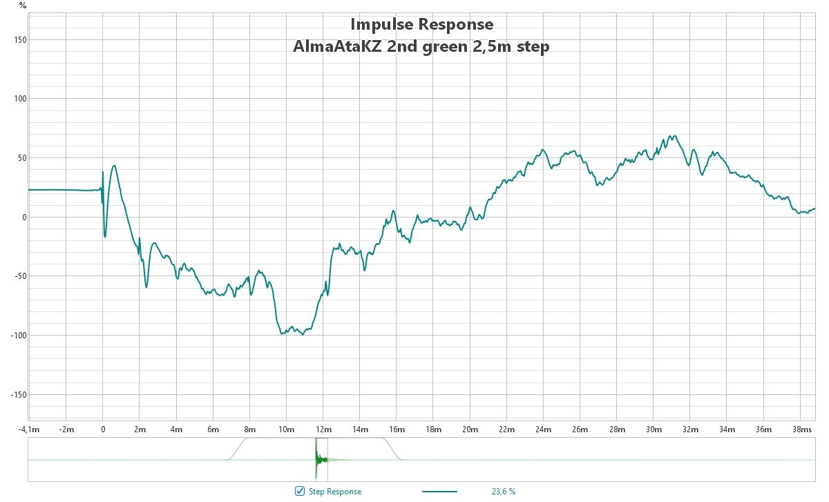

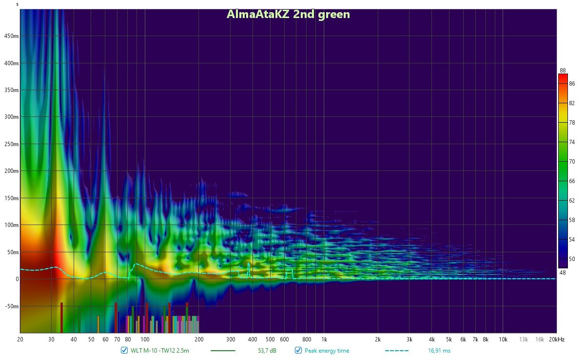

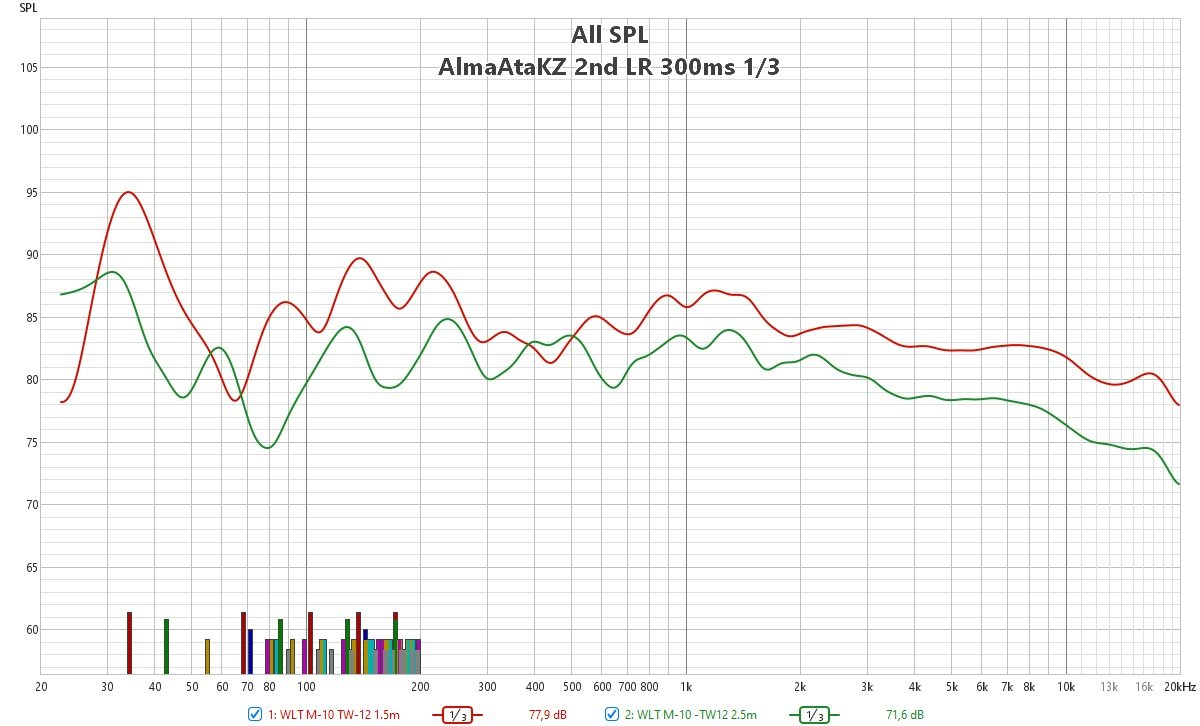

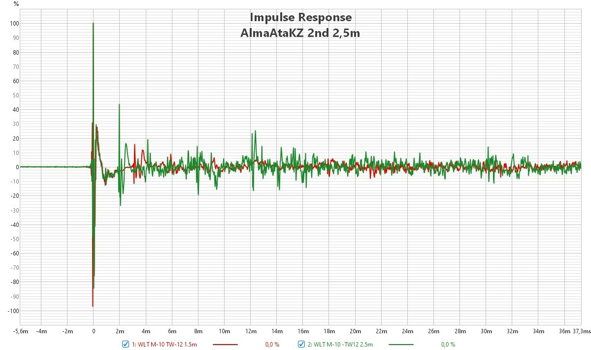

More details from 2nd attempt crossover, measured at 2,5m in-room. Are red and green L/R speakers?
  • Room is playing too big role to see step response and crossover match clearly
  • I would let tweeter play louder, or at least the bump between 800-1500Hz should be tamed. Yhis is on-axis long gating so it reflects listening window estimate in VCAD.
  • I think low bass has too much lift, but room boost is high as well
  • obviously eq for each driver and delays must be tuned
AA 2ND XO WMT 300ms 13.jpgAA 2ND XO WMT imp.jpgAA 2ND XO WMT green step.jpgAA 2ND XO WMT green wavelet.jpgAA 2ND XO WMT red wavelet.jpg

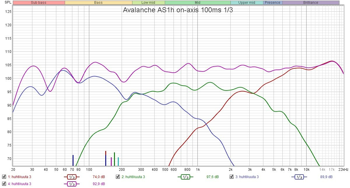

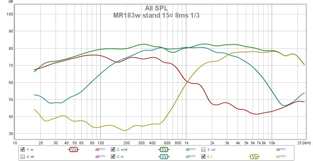

Next time, please use just one speaker and take measurements with mic at midrange height, distance 60-80cm. This way you will reduce room effect. Measure each way only and as 3-way. Then invert the polarity of midrange and measure the system again. Use 6-9ms right window and 1/6 smoothing. My examples below (LR2, no invert test).To see distortion use 90dB mean spl at 1-2m.

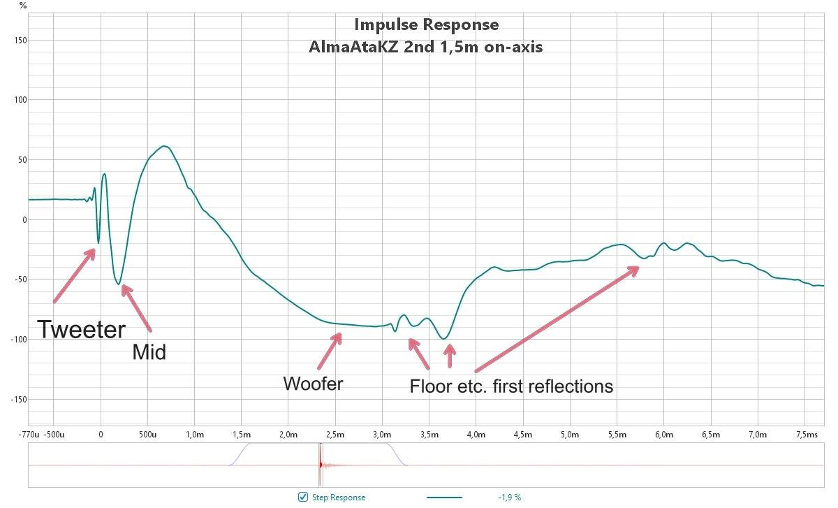

When I set up dsp without simulation, I set the mic height between mid and tweeter, at 60-100cm depending on how first reflections appear. First I measure and adjust only mid and tweeter, when short gating can be used. In a tall 3-way bass driver(s) measuring and matching need more distance and longer gating, preferably outdoos and groundplane.
The graph below shows time domain as step response of this project 2nd xo version, measured at 1,5m indoors. Step is another way to look at impulse, it shows polarity of drivers and delays between "ways". Now we can see that all drivers have negative polarity and that T and M integrate well. Intergration is analyzed from how valleys between peaks integrate, in case ot 4th order. Woofer peak comes too late, so mid and tweeter shlould have approx. 100us (0,1ms) delay. Floor reflection etc. appear a bit after 3ms. https://www.audiosciencereview.com/forum/index.php?threads/step-response-does-it-really-matter.1999/
