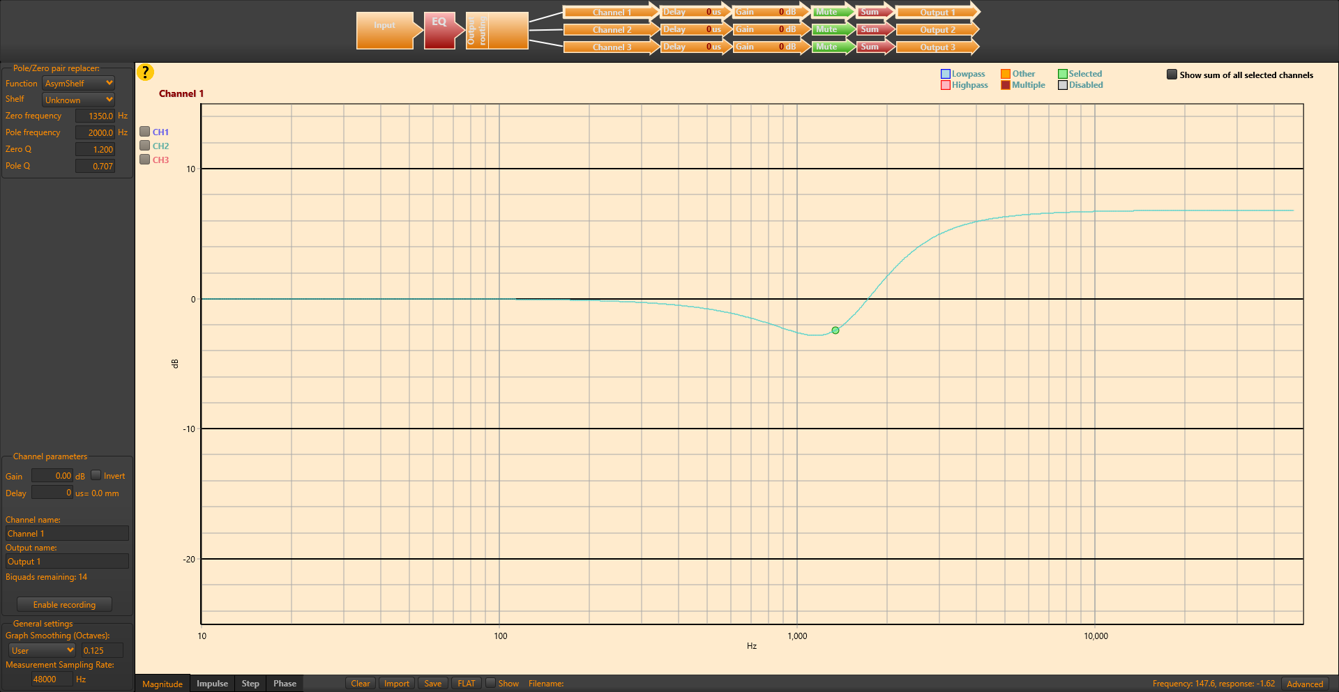

Here's the same filter presented in Hypex Filter Designer. I selected AsymShelf as the filter type. It looks like the gain would need to be set to -6.8 dB or so to get the response at 10,000 to be zero dB.

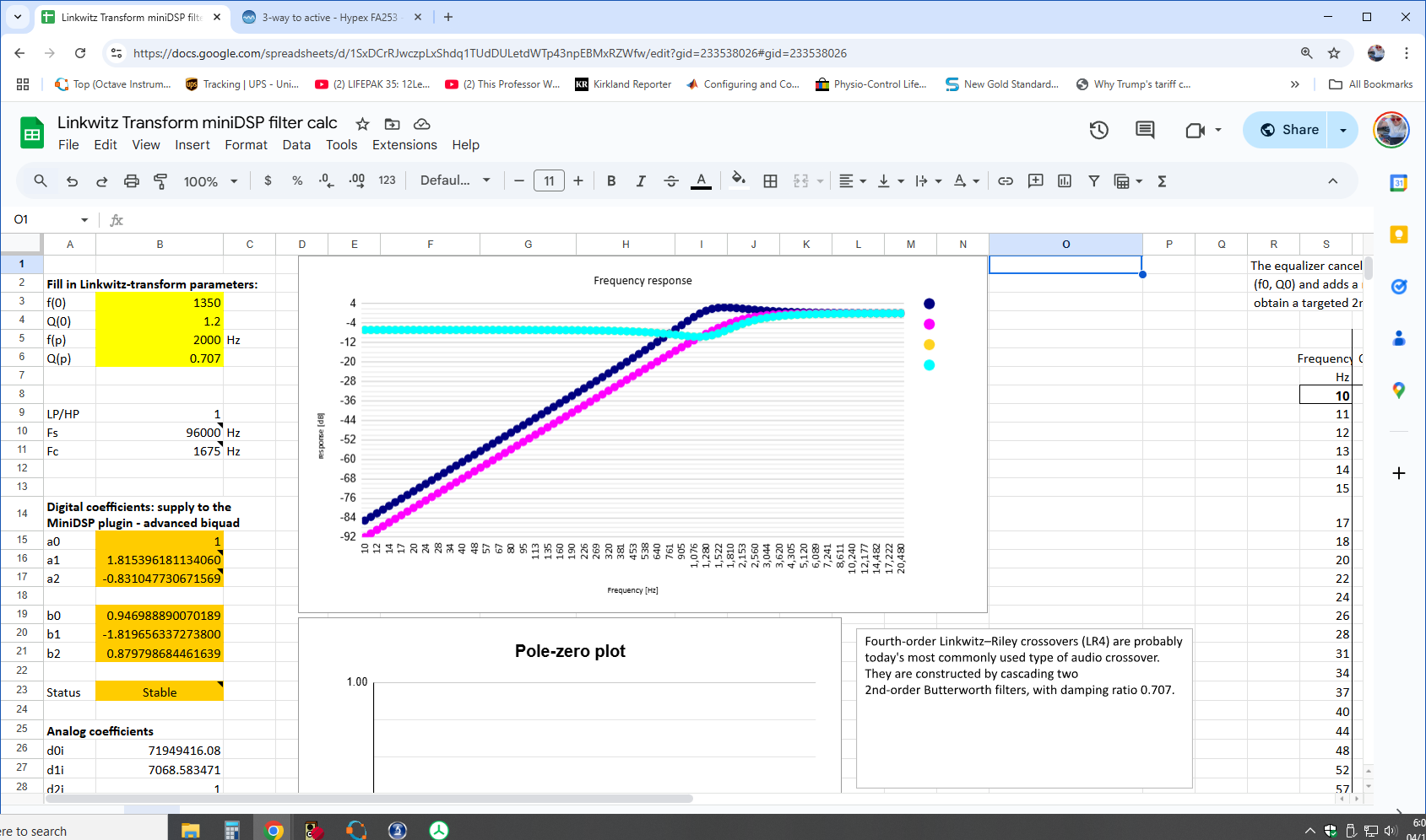

I see! So it is basically a way of achieving a LR4 (or near) curve in the resulting total acoustic response, as opposed to just applying a LR4 filter electrically. Well, if the objective is a LR4 acoustical, then this is one way to get to it. As many people say - DSP makes things simpler to implement. A powerful tool.Sure. Say the tweeter has a natural mechanical low frequency roll off at 1350 Hz, it is effectively a 2nd order high pass filter with some arbitrary Q set by the driver properties. If you just cascade a 4th order LR filter at the 2000 Hz desired crossover frequency, you end up with a sort of 6th order filter response and resulting phase shift that won't play nicely with the low pass filter on the midrange or woofer. Starting with the Linkwitz transform (asymmetric 2nd order shelf filter) the 1500 Hz and arbitrary Q response can be canceled and replaced with the desired 2000 Hz, Q = .707 response desired to form half of the LR 4th order filter. I have tried to measure the Q and low frequency resonance using DATS or other impedance sweeps, but a simple near field acoustic measurement and just eyeballing the Q value works well.
I made a copy of the miniDSP spreadsheet in Google Sheets to calculate the coefficients of the Linkwitz transform. The example below shows how the natural response of a tweeter with a 1350 Hz Q = 1.2 ( Dark Blue ) can be shifted with the filter ( Light Blue ) to produce a 2000 Hz 0.7 Q high pass response ( Medium Blue? ). I'm a bit color blind.
I'm not sure but the Hypex software may have the 2nd order asymmetric shelf filter in the menu. The miniDSP requires typing in the filter coefficients, which isn't great. The link below the figure takes you to the spreadsheet.
https://docs.google.com/spreadsheets/d/1SxDCrRJwczpLxShdq1TUdDULetdWTp43npEBMxRZWfw/edit?usp=sharing

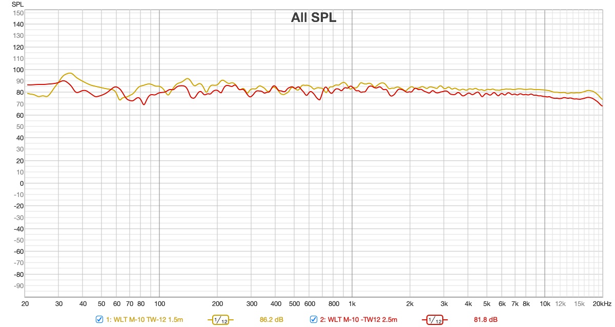

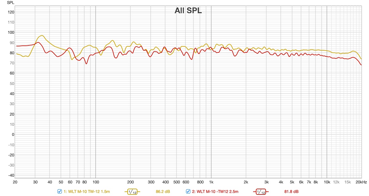

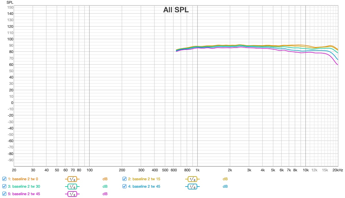

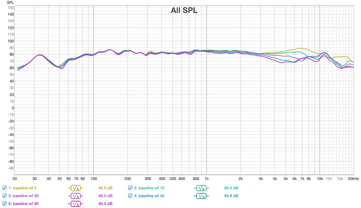

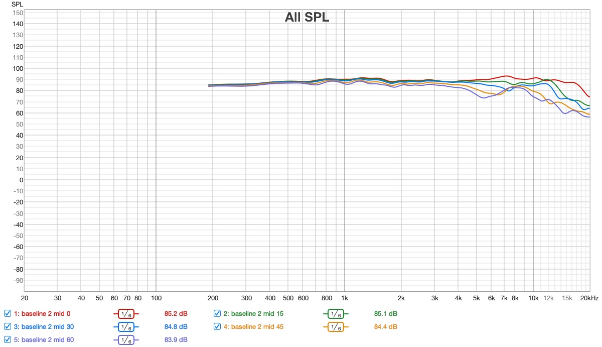

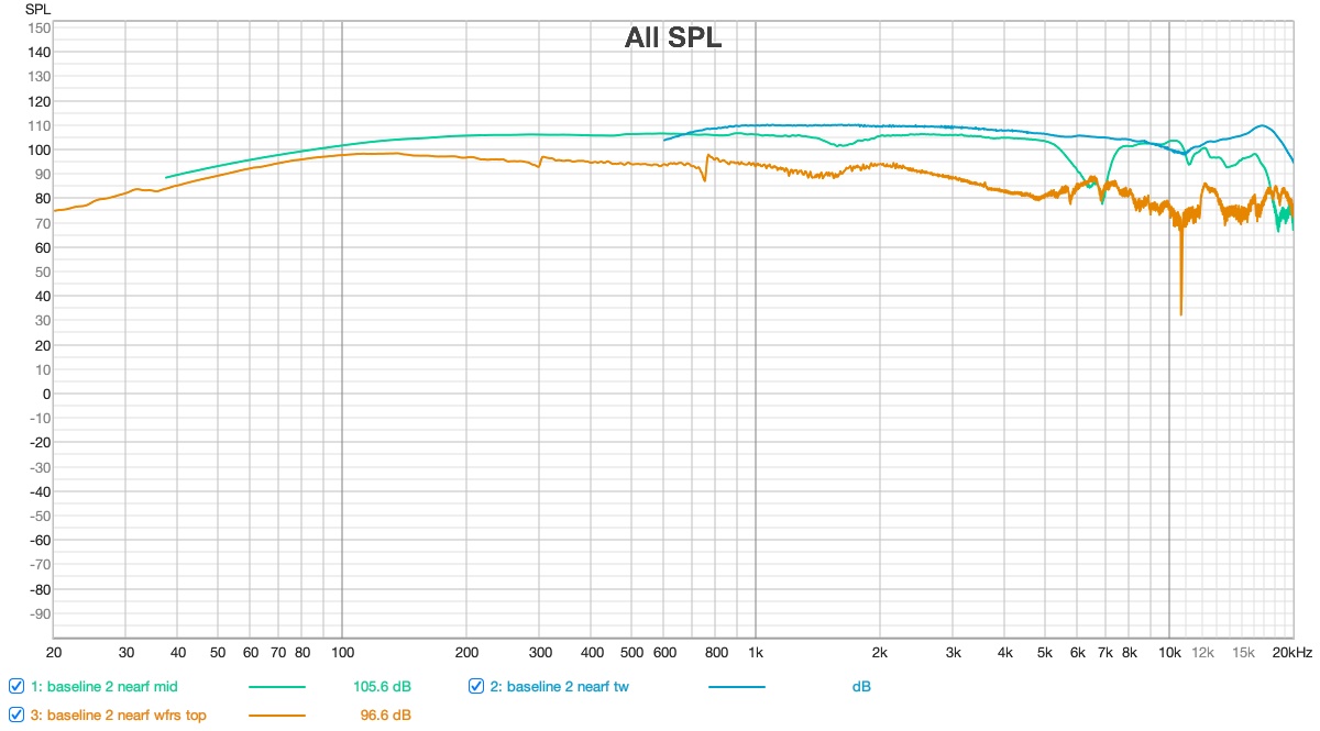

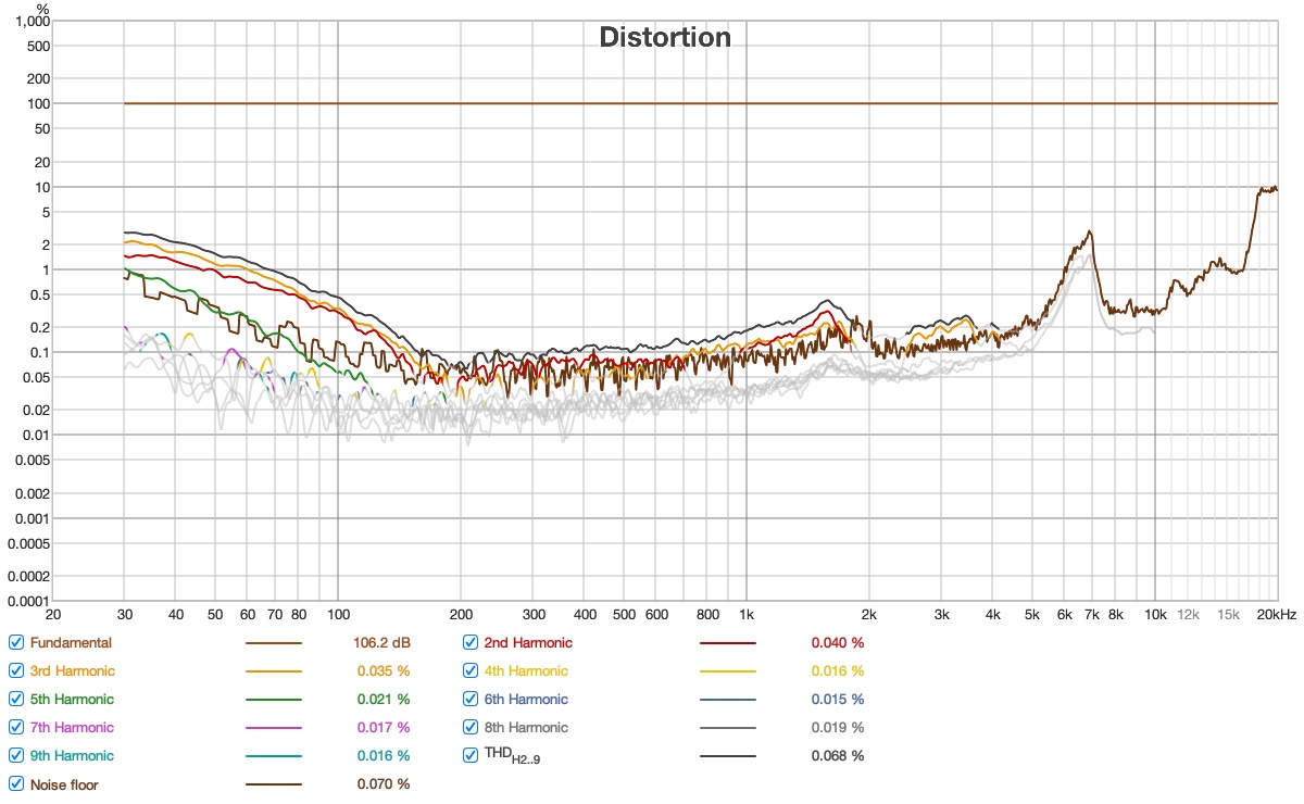

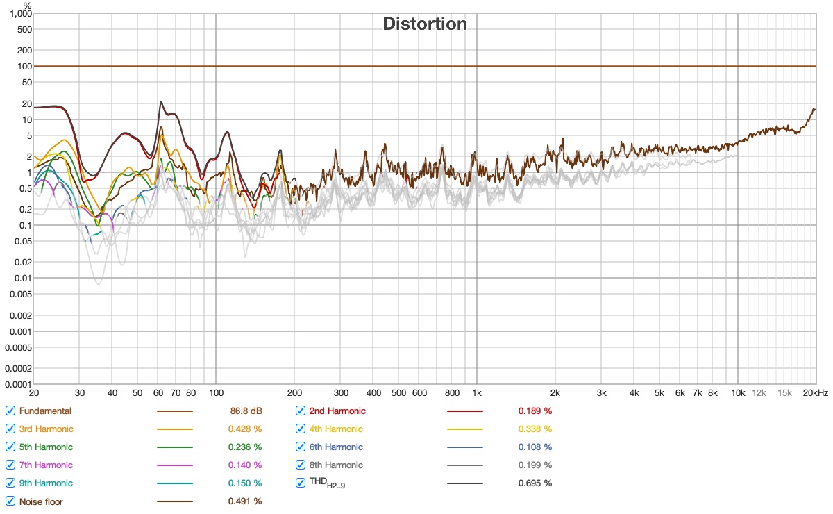

Second attempt at indoor off axis and nearfileds, as well as the overall speaker with a starter crossover set. Files attached.
I have paid more attention to speaker and mic positions, a bit of strategic pillow and blanket placement etc. The near filed are 2cm mic distance. Both woofers playing, mid painting at the top woofer, no screening of the bottom woofer.
Fro the overall speaker, used LR4 at 250Hz and 3kHz, dropped tweeter -12dB and mid -10dB and applied LT 60/30Hz. No other EQ whatsoever. Speakers already sound pretty good.

Great!Mid
Gate 5.3ms
Adjust vertical scale to around 50 dB range for meaningful graphs. (you used 210 dB in your graph!)
