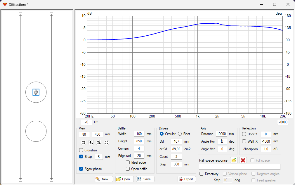

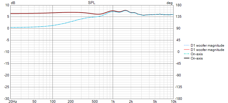

The required shelf filter may be much lower than that.
If I simulate a 160 mm wide baffle with a typical 5.5" woofer, I get a 4-pi response like this

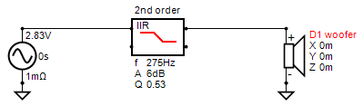

Here is a reasonable shelf filter to counteract that baffle step. A second order low-shelf of +6 dB at 275 Hz, Q=0.53
This is the filter that would work with an ideal 5.5" driver. Your woofers will have a response that is different, but this gives you an idea of what is reasonable.

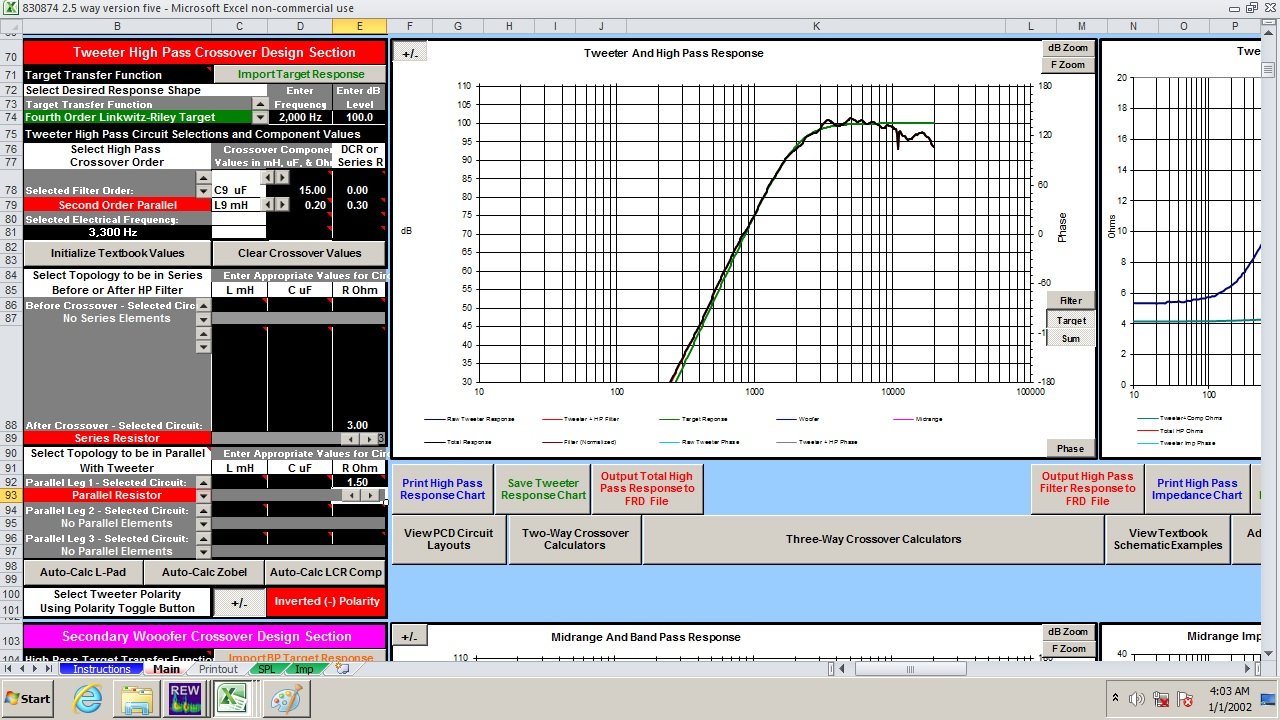

This is from a speaker measurement of mine, not this project. I know it's not critical that far below the x-over, but I'd rather be able to look at it anyway. Note the target overlay is the green line. In this case a LR4 at 2k.

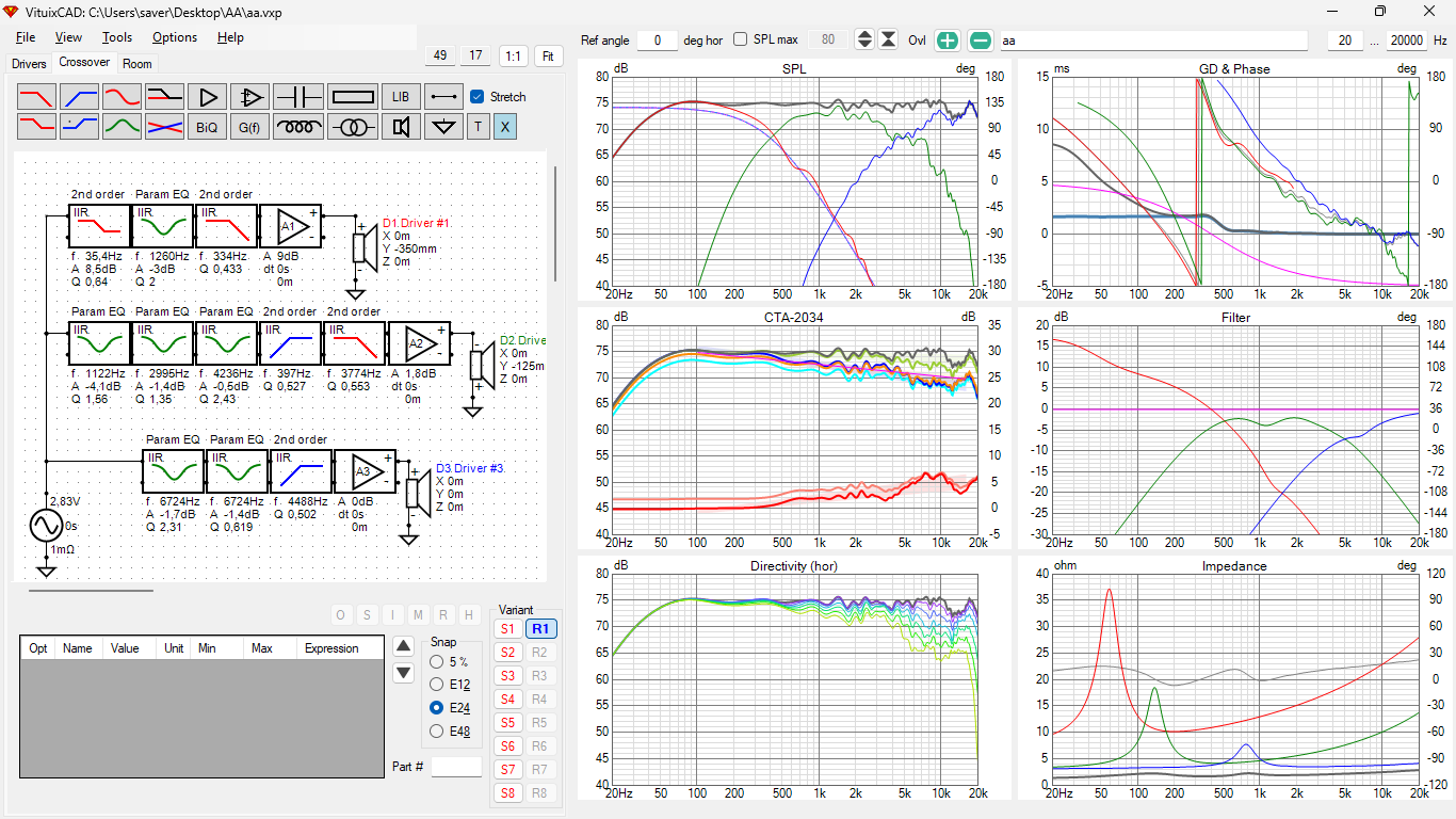

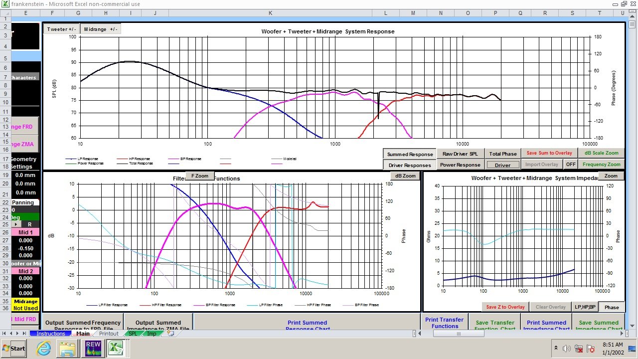

Here's what I came up with. I need to use the same woofer file that you guys are using. This one sure looks different down low. Like others have said, the measurements on the woofer are not great. Three ways are tricky down low. I think the other measurements on axis measurements were OK.
I'll not post the filters at this point, but there would be no real surprises if I did. Not being secretive. I can if someone really wants to see them.
I simulated the NF measurement for W and M and that's what I got.
Enclosure volume for both woofers is 10L and 1.5L for mid. Diffraction files and ctc distances are guesstimated from the pictures in the thread.
All FR exports are gated: I just followed the instructions given by Kimmo in his pdf.
The folder containing the export files and the VC project is attached.

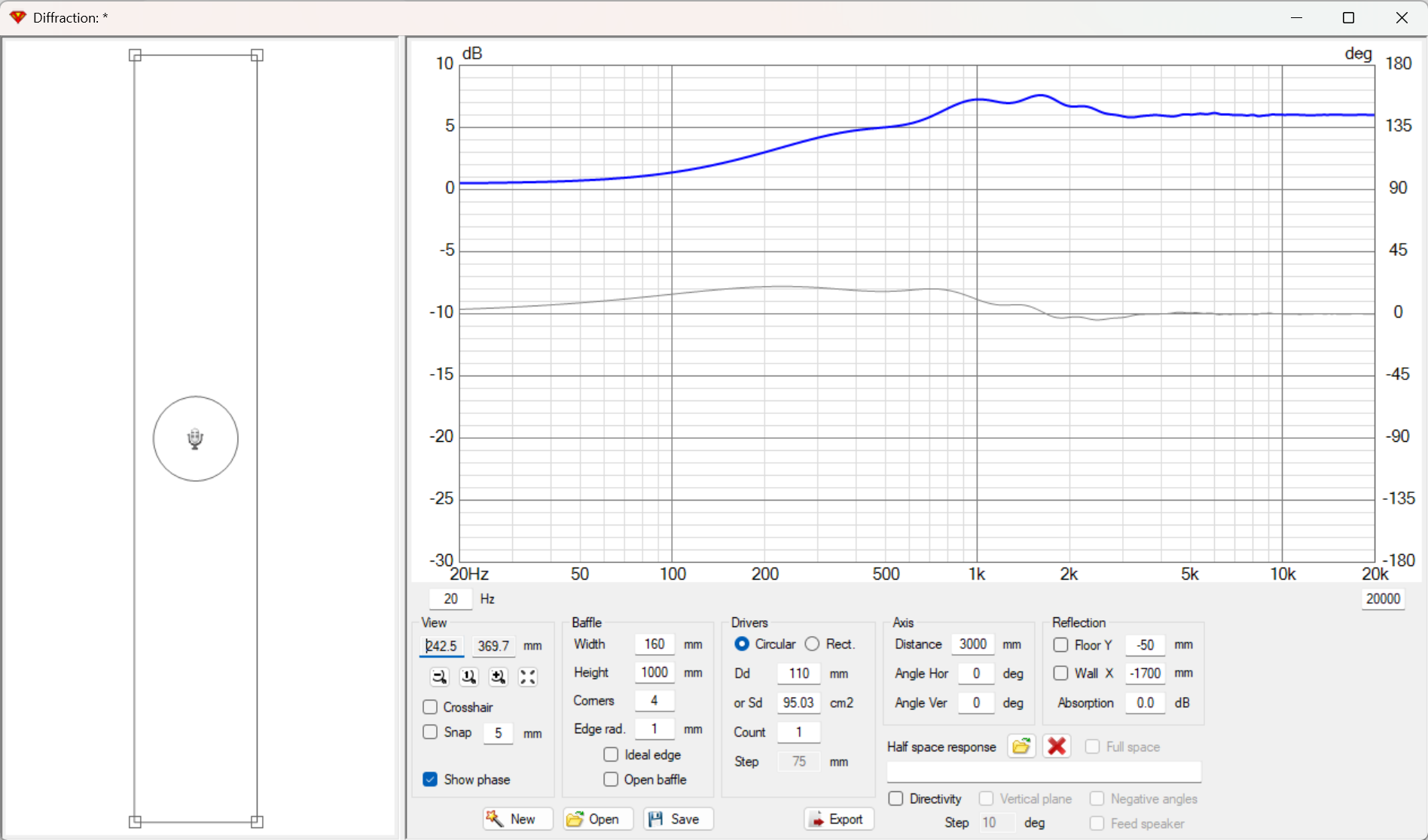

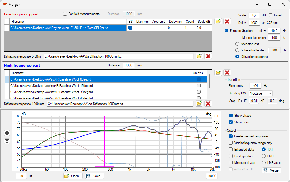

Measure NF response (mic at 5mm from dust cup) and export the file. If two woofers have shared box, feed signal to both woofers and isolate (not brake) the other (which is not under test) with pillow to prevent midrange frequencies going to mic too much. You do not have a port so you don't have to measure it.
Design your baffle in diffraction tool: use rouded edge as you have facets.
Export diff. resp. at 10m and 1m
Measure farfield and export the files
Open Merger tool and load your FR
Adjust the LF part level, choose a merging frequency (typically around 400Hz) and export your files (change your extension).

A few points to clarify.
  • 5mm ok for tweeter and mid, but the woofers have 20mm+ Xmech, so I will do 25mm distance, just in case.
  • I got the point about covering the 2nd woofer from the original post. However got confused by the 'to prevent midrange frequencies going to mic too much'. Why midrange? the midrange channel will be muted. Do you mean mids from the 2nd woofer? if so, why the mids be a consern and not the highs or lows?
