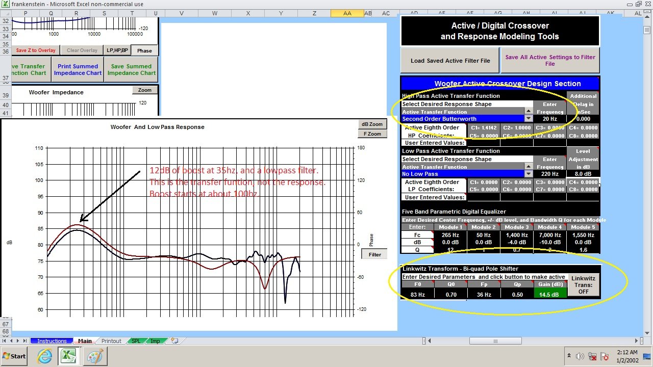

What you could do..... In addition to other measurements ...Not trying to change the plan of attack....
Ok, several of us have simmed the low end boost. I assume that programming one or all of them into action is easy. Since SPL varies with cone movement, and a close mic will show the roll-off, why not go ahead and program the bass boost into the unit ahead of time, and make a near field sweep. If it's a straight line from 200hz down to 40hz, you pretty much know what you got. If not, a quick adjustment will put you there. Then turn off the boost, sweep again, and let software predict what is needed. Then add it, and measure again, to verify it works. Either way works. Which is easier? I really don't see it as confusing. It's bass boost. You will decide how low to extend it. The deeper you go, the more excursion. I think for myself, I would shoot for a 40hz f3. , and possibly lower. What would be cool is if the setup has a limiter built in. Then you never have to worry about getting too loud.
Here's my estimate for boosting the low end. It's just an estimate. Looks about right on the graph to me.
Note.... Never used this LT function before. No harm in making adjustments. I went with what the transfer function looked like.
Reactions: AlmaAtaKZ

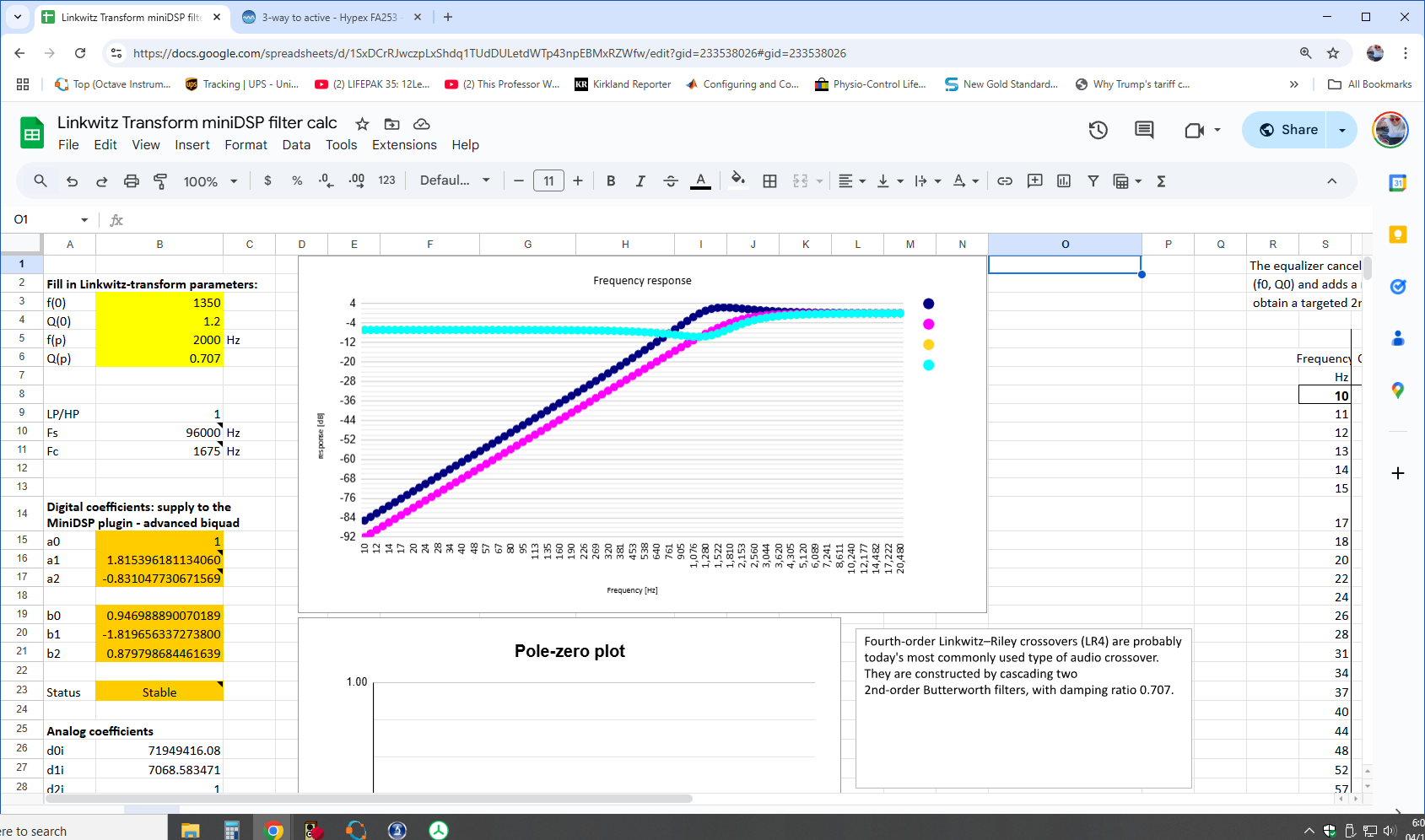

Let me understand this. Normally, in HFD, I would add two LR2 highpass/lowpass filters on both sides for form a LR4 crossover - which keeps the phase. Say HF and MF.
The above suggestion is to add a LT filter (asymmetric high/low shelf) on top of a single LR2 filter to form the crossover and keep the phase. Can you explain how the second approach works and its benefits?
Sure. Say the tweeter has a natural mechanical low frequency roll off at 1350 Hz, it is effectively a 2nd order high pass filter with some arbitrary Q set by the driver properties. If you just cascade a 4th order LR filter at the 2000 Hz desired crossover frequency, you end up with a sort of 6th order filter response and resulting phase shift that won't play nicely with the low pass filter on the midrange or woofer. Starting with the Linkwitz transform (asymmetric 2nd order shelf filter) the 1500 Hz and arbitrary Q response can be canceled and replaced with the desired 2000 Hz, Q = .707 response desired to form half of the LR 4th order filter. I have tried to measure the Q and low frequency resonance using DATS or other impedance sweeps, but a simple near field acoustic measurement and just eyeballing the Q value works well.
I made a copy of the miniDSP spreadsheet in Google Sheets to calculate the coefficients of the Linkwitz transform. The example below shows how the natural response of a tweeter with a 1350 Hz Q = 1.2 ( Dark Blue ) can be shifted with the filter ( Light Blue ) to produce a 2000 Hz 0.7 Q high pass response ( Medium Blue? ). I'm a bit color blind.
I'm not sure but the Hypex software may have the 2nd order asymmetric shelf filter in the menu. The miniDSP requires typing in the filter coefficients, which isn't great. The link below the figure takes you to the spreadsheet.
https://docs.google.com/spreadsheets/d/1SxDCrRJwczpLxShdq1TUdDULetdWTp43npEBMxRZWfw/edit?usp=sharing
