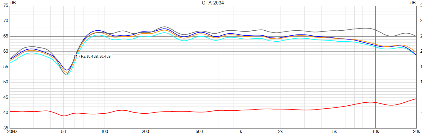

I wouldn't trust this set of measurements fully. The phase is crazy, I don't know what to make of it honestly. Probably just ignore it on this measurement set.
Get an initial setup if you like, but I'd get a plan to do a measurement set outside, as high off the ground as you can manage.

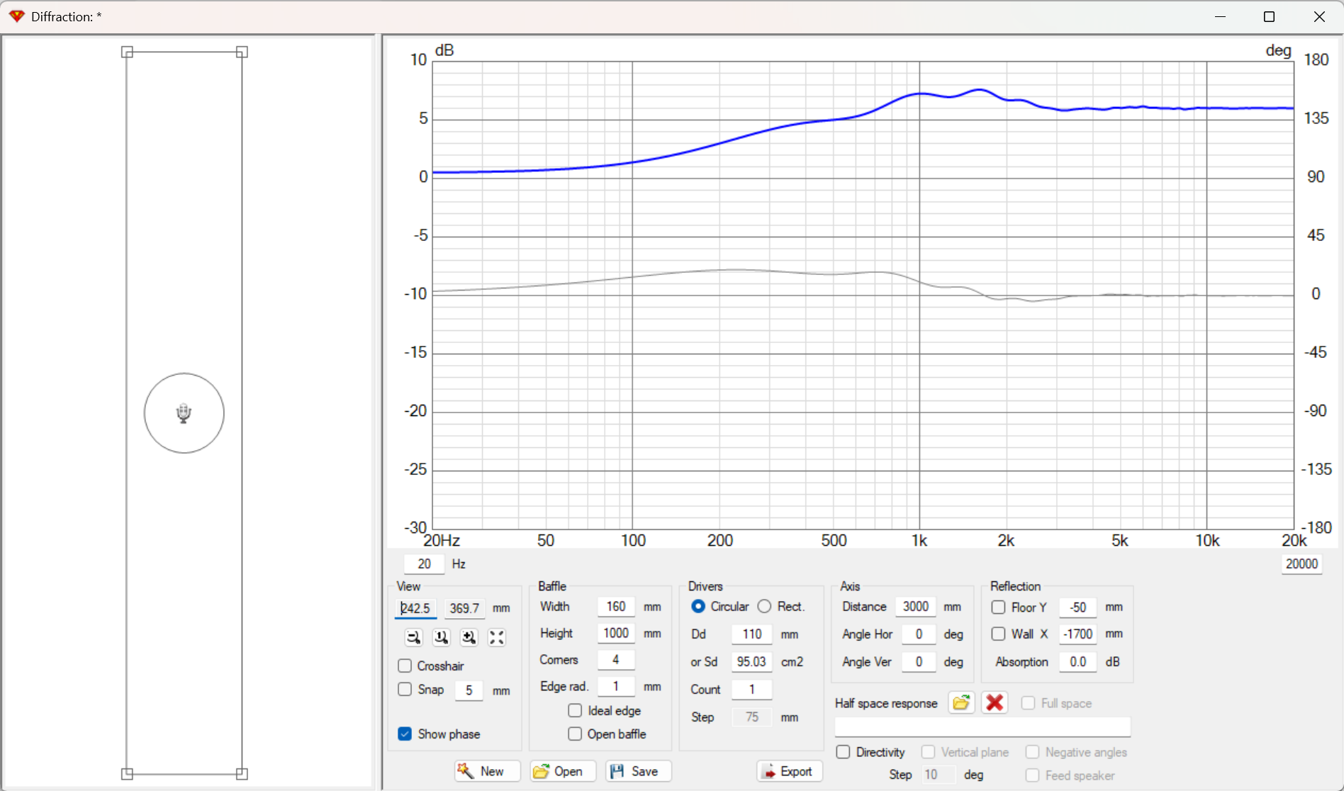

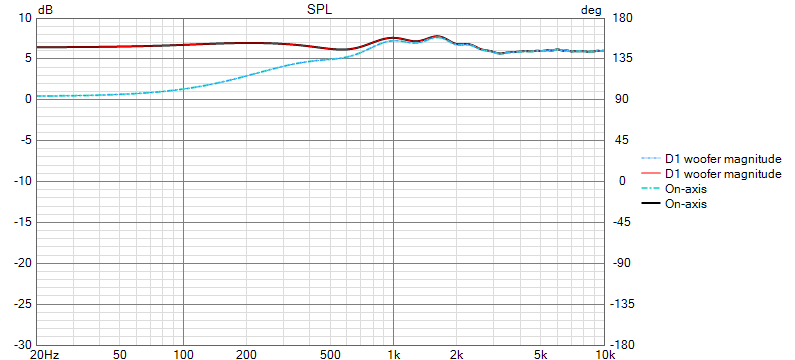

If I simulate a 160 mm wide baffle with a typical 5.5" woofer, I get a 4-pi response like this

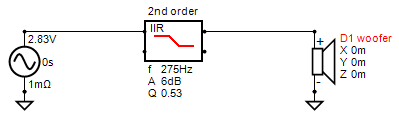

Here is a reasonable shelf filter to counteract that baffle step. A second order low-shelf of +6 dB at 275 Hz, Q=0.53
This is the filter that would work with an ideal 5.5" driver. Your woofers will have a response that is different, but this gives you an idea of what is reasonable.

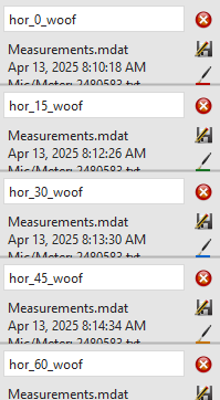

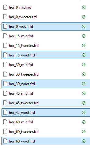

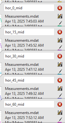

Open your initial measurements in REW. Label them like this:
Then select file->export->export all measurements as text. Then make the pop up look like this:
Save to a folder of your choosing. Recommend something like "initial FRD" or whatever you'll remember. Normally I'd include phase, but I don't know what going on with this measurement, so we're just going to ignore it.

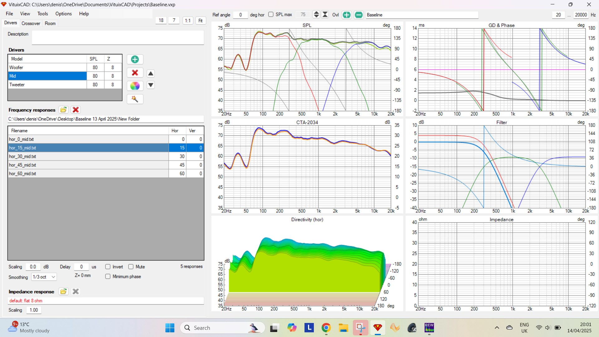

When VCAD opens, it looks like this in the upper left corner:

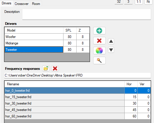

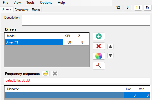

Click on the Drivers tab.
You should see this:
Click on the space where is says driver #1 and re-name it to woofer
Then click on the open folder icon to load frequency response files.
While holding the control key, click on each of the woofer files, should look like this:
Click open. Ignore the warning about phase for now.
Then click on the plus icon (look up two pictures) to add another driver, change it's name to midrange and repeat. Keep doing this until you have this:

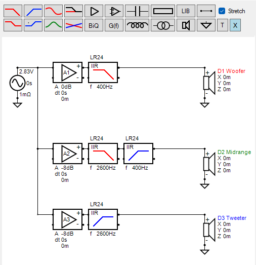

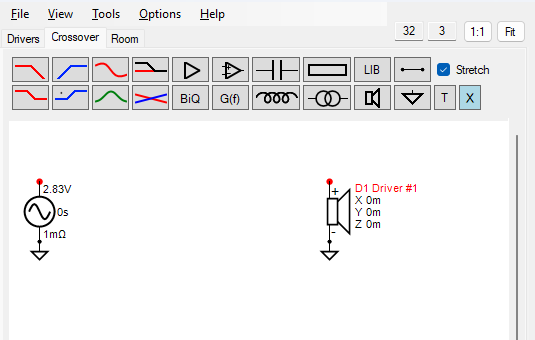

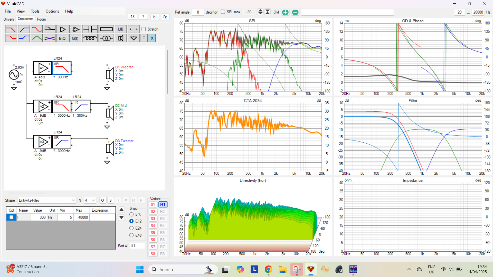

Click on the Crossover tab to get started. Below is a basic active crossover with no corrections. Each channel gets an active adjustment (amp) and a set of appropriate hi/lo passes.

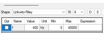

When you click on a high or low pass entity, at the bottom of the window, you'll see the following:
For now, just set all of yours to linkwitz-riley and N4 (LR-4).
The basic crossover above should look like this in the simulation:

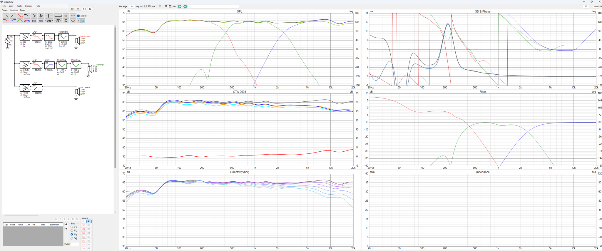

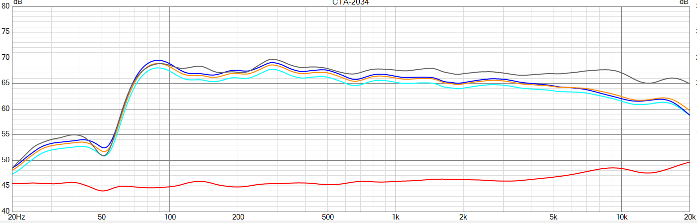

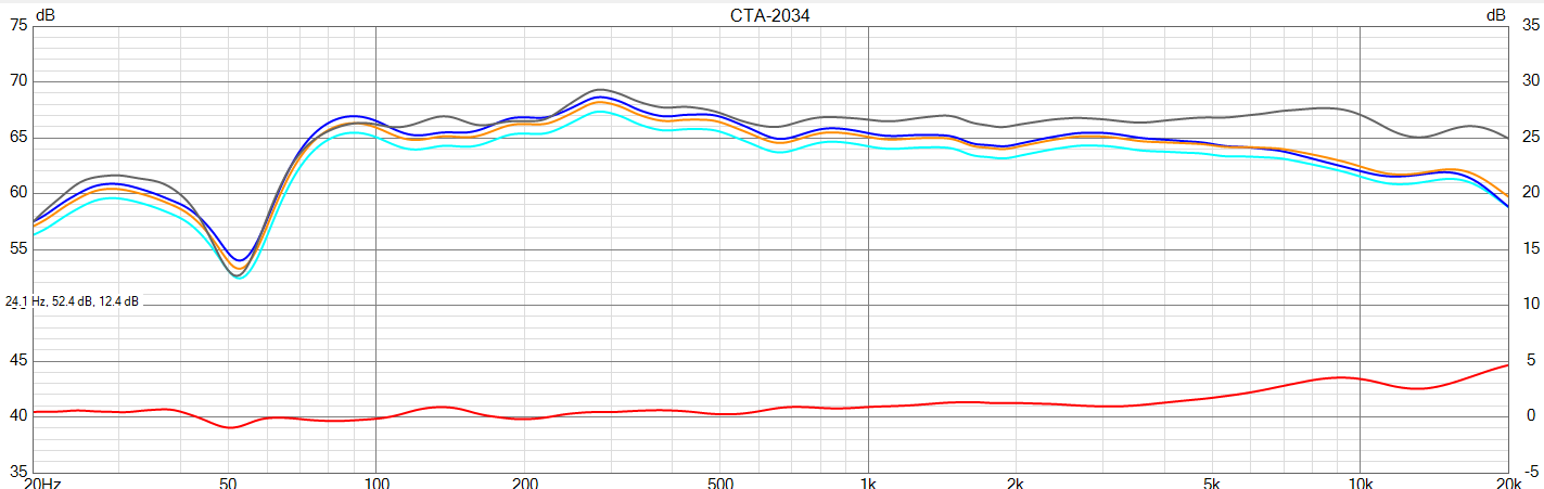

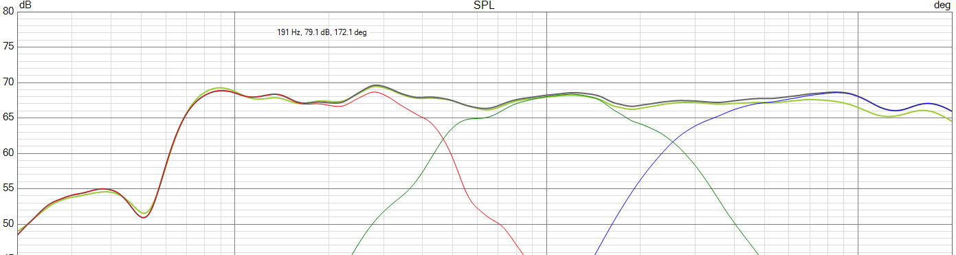

Ok, so now I'm going to start looking at both power response and the on axis response and see if we can easily smooth it out a bit. Don't go crazy, keep in mind our measurements stink.
Power response is the blue line (almost the same thing as estimated in room)

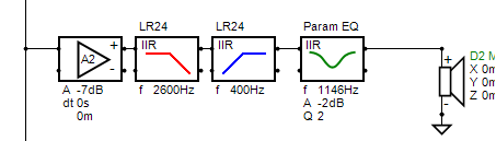

My first thought is the midrange response is peaky. This makes sense, the driver you've used has a rising response and fall off before the breakup. Our crossover only got rid of the breakup.
So I'm going to add a peaking filter of -2db, centered at 1146hz (put the cursor on the middle of the hump to figure that out) and use a Q of 2. I'm also going to increase the midrange volume up to -7db and lower the tweeter down to -9db
So now I'm reasonably happy with the midrange and tweeter for a first go at it.

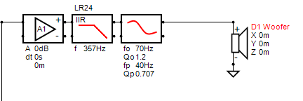

So our two big things to figure out are the linkwitz transform and the weird dip/rise that's going on between 100hz and the peak at 280hz.

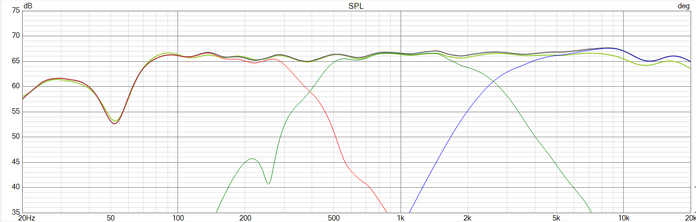

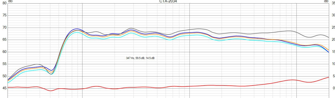

Let's deal with the LT first, it should be easier, and we know that correction is real. A bass bump and the steep drop off is pretty characteristic of a high Q alignment, so I'm going to guess 70hz and 1.2 Q. If you feel confident at guessing your final volume you could go back to re-simulate the enclosure, but just looking at the response and making it look "about right" is probably just as accurate. LT is the squiggle symbol. I'm going to set my desired pole frequency and Q at 40hz, .707. See below.
The sim now looks like this:
Better, but I'm going to drop the midrange back down to -8db

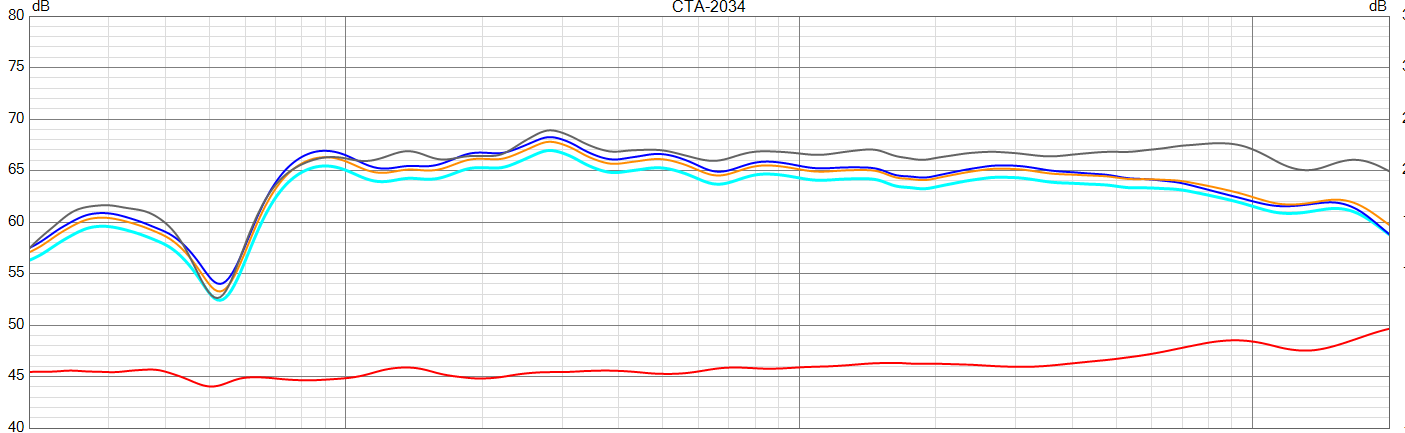

So now the dip/rise thing is just that peak at 280hz.

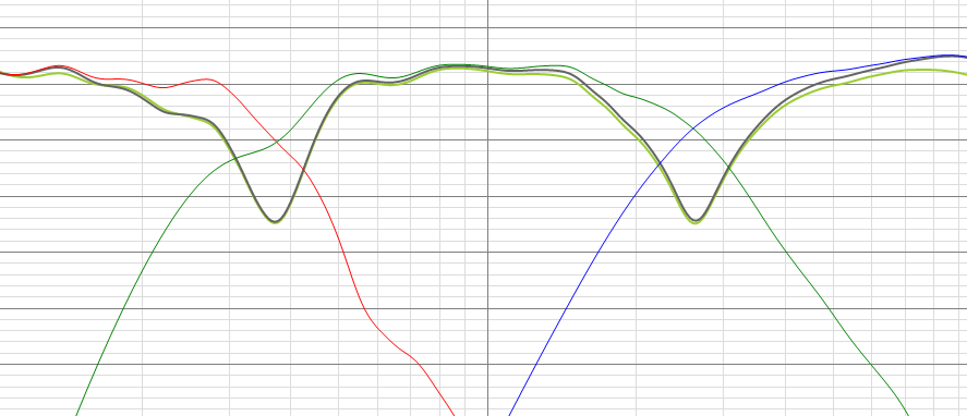

This is moving the crossover down to 300hz:

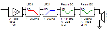

I'm not sure playing with the remaining bump is worth it right now. If I flip the mid polarity you can see there's something odd with the crossover here. I'm not sure it's real.

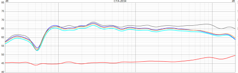

But as an experiment, I'm going to add a peaking filter to the midrange below the crossover point. It's -15db, Q 10 at 256hz.
You can see here where it is and how narrow/deep. and what it does to the response. But again, I have no confidence it's real. I'd probably setup the filters without that last part. Measure, then add the weird notch filter and try again just to see what it looks like / sounds like.

That looks about the same to me. If you can now measure the speaker as I posted previously, you can compare to what you have here in the sim. Low frequencies are hard to measure, but 300hz and up should be relatively easy.
