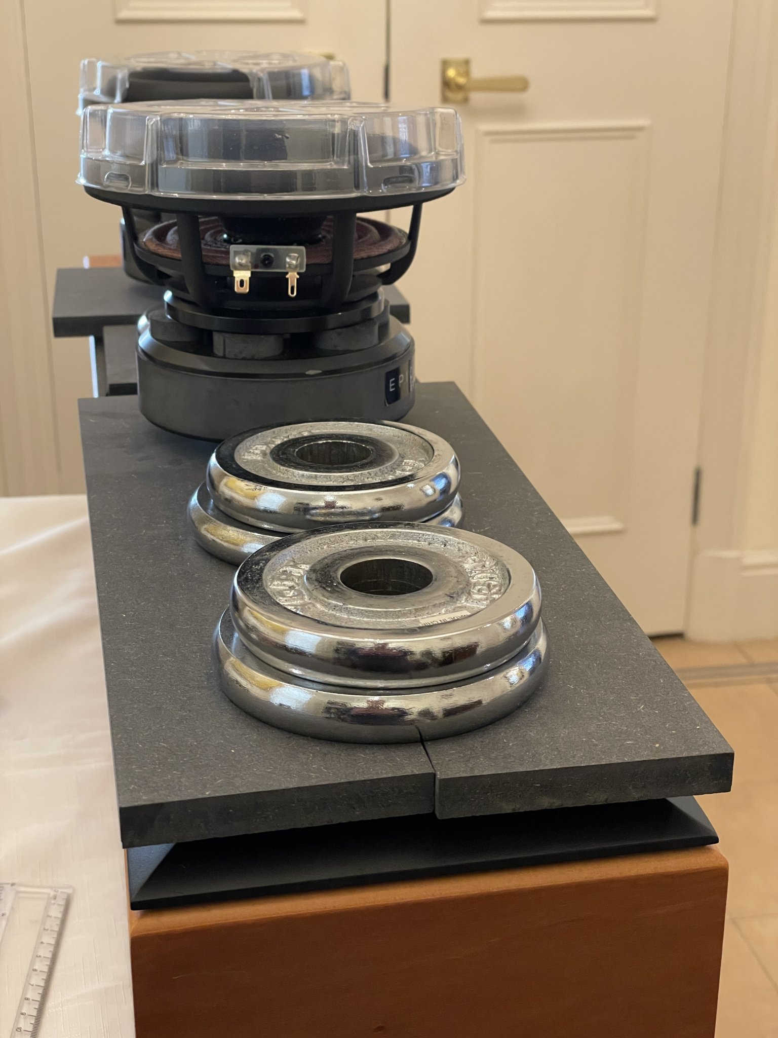

Trial fit of drivers on baffle after painting, neoprene lining and drilling. All seems OK.
The weight of the front baffle assembly is about 10kg 🥵

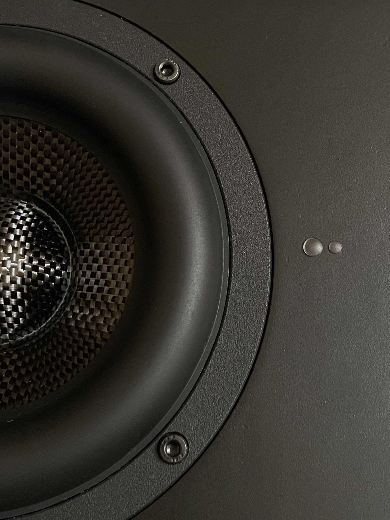

I was going to ask about those holes...kit light pipes

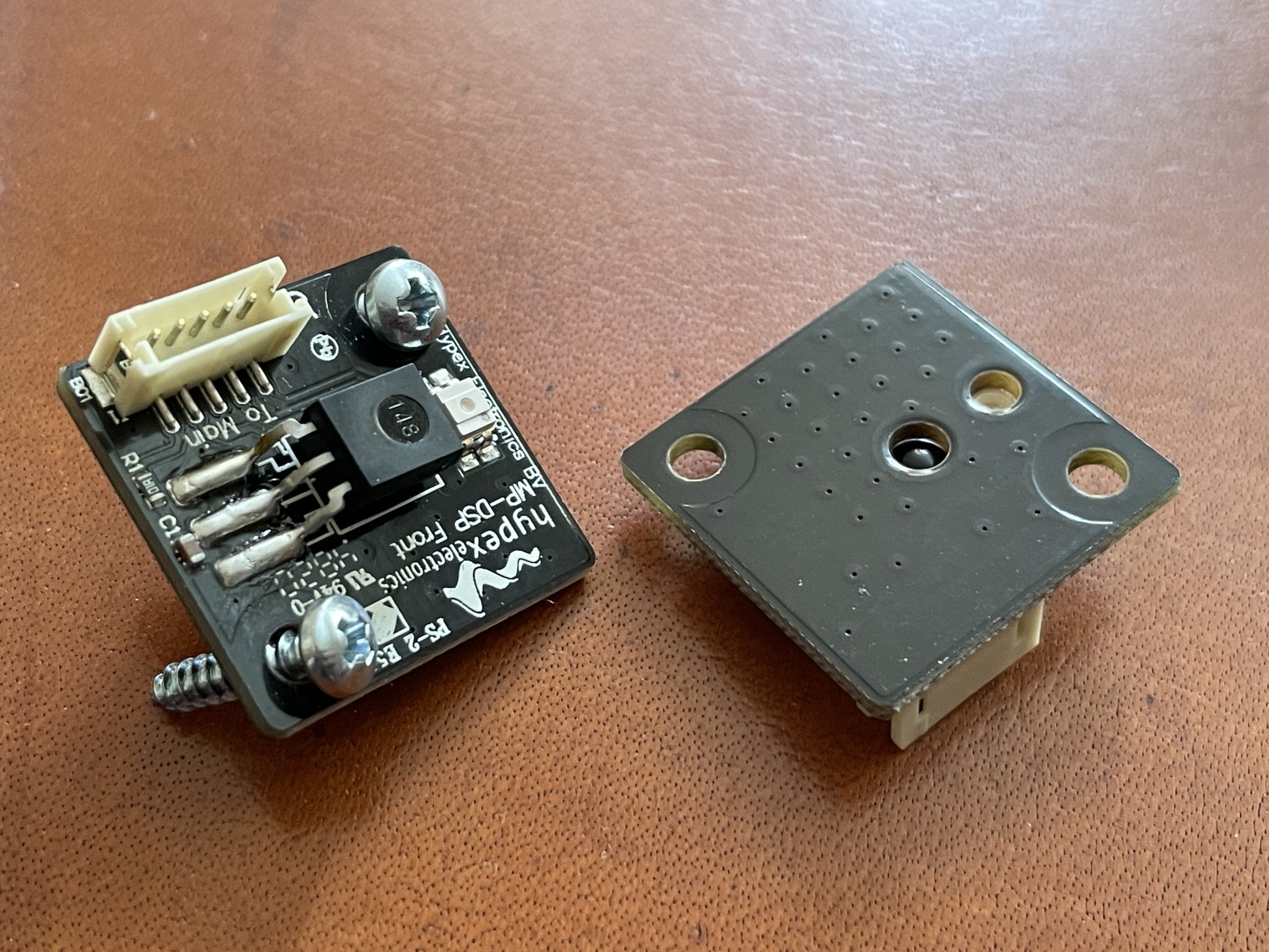

Remote kit PCBs (both sides).

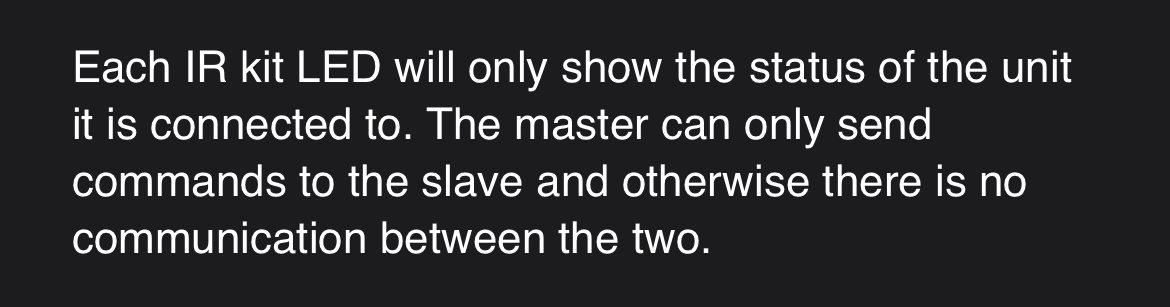

Only one is required for the master/slave pair to work, but I am using two for visual symmetry and to be able to see status indication on both speakers, although it is not documented if each unit will display status of its own amp individually or just repeat from the master. Could do with a clarification from Hypex.

Hypex responded quickly and clearly: each unit displays the status of the amp it is connected to. Good.

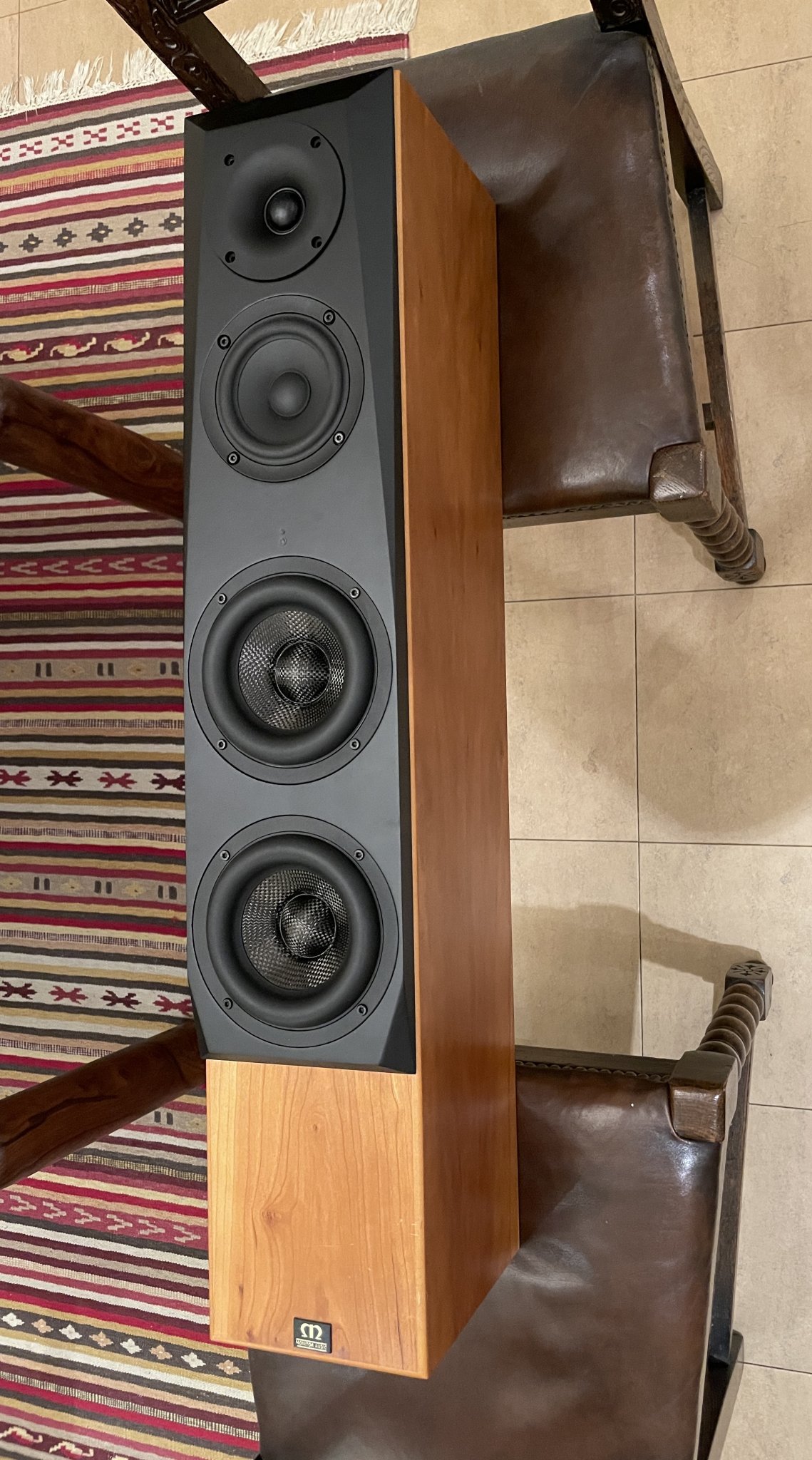

The first of the front panels glued on. This is nearly the final look (less a few driver bolts and the back panel). Getting there.

Second front panel goes on today.
Neoprene lining on box, align and glue panel on. I will then add 14 screws per panel. The panel is ‘floating’ on the neoprene lining.

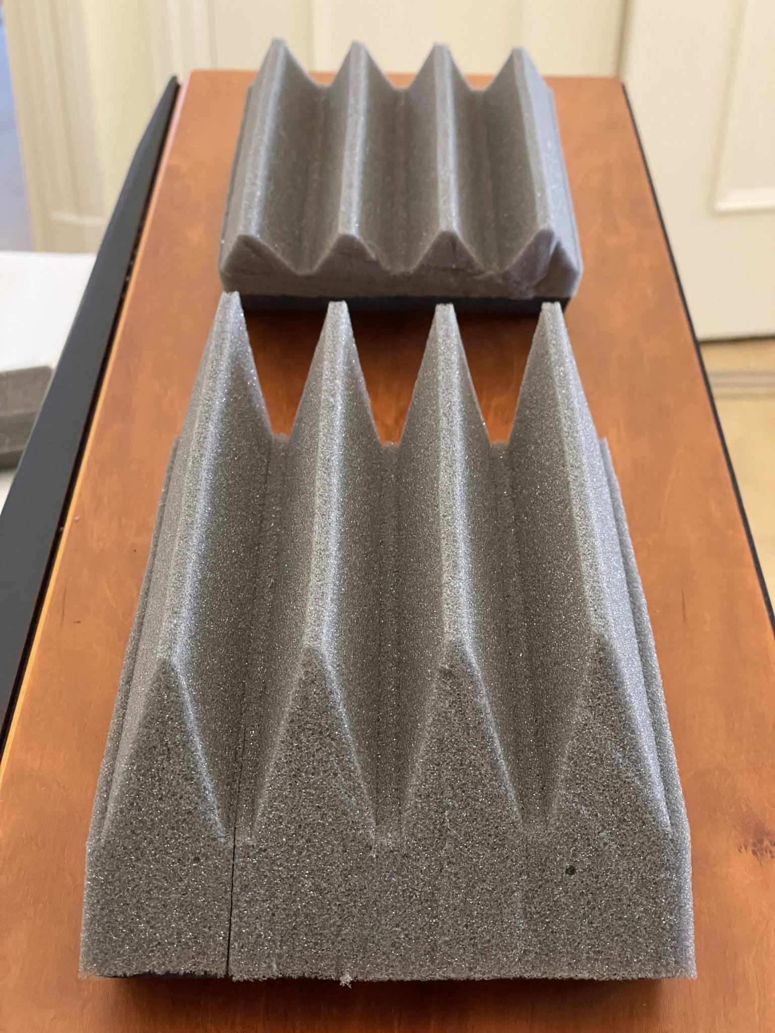

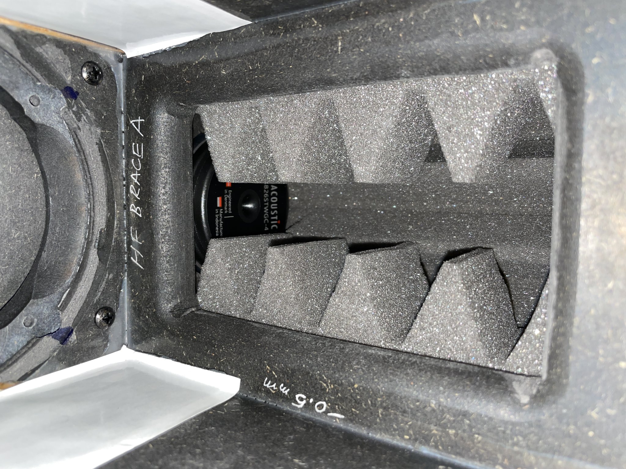

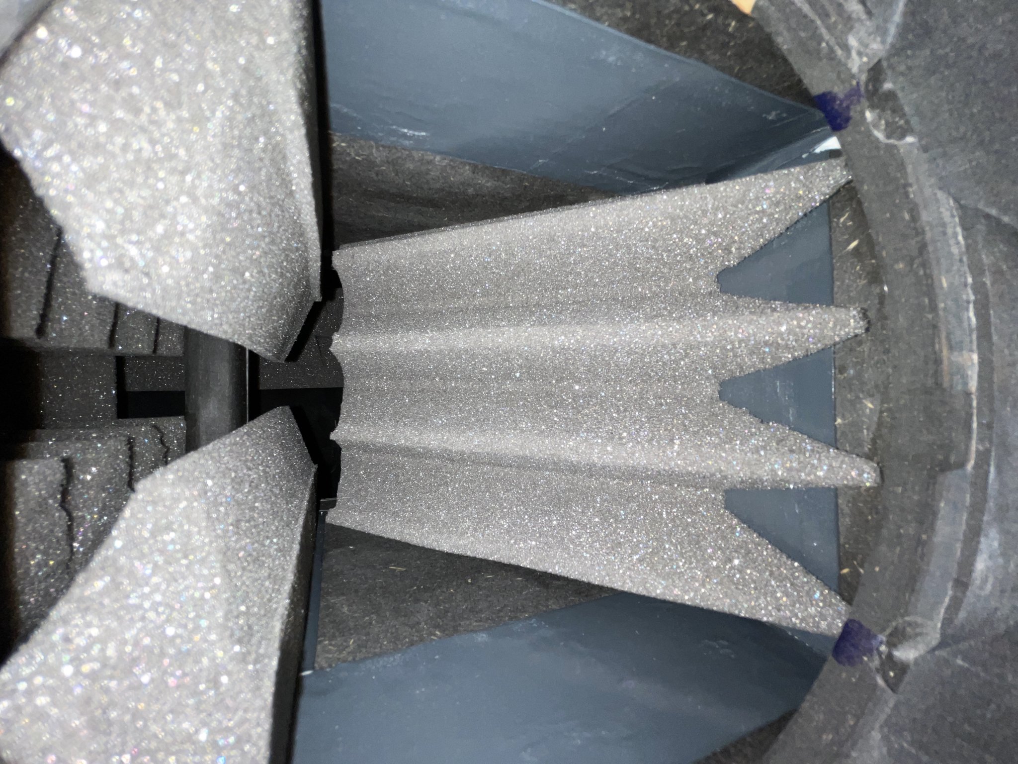

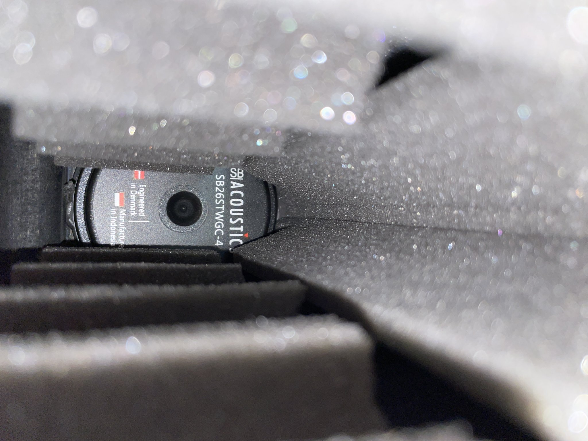

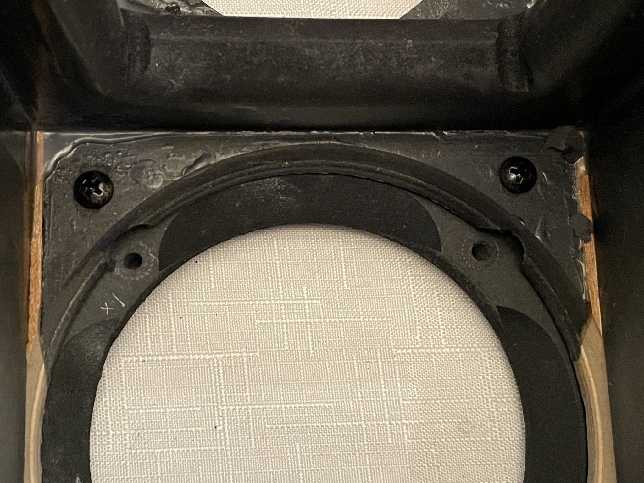

MF chamber lined with bitumen and foam. 45deg panels glued in - these panels is what the midrange driver’s backs will see. Then the reflection is facing this:

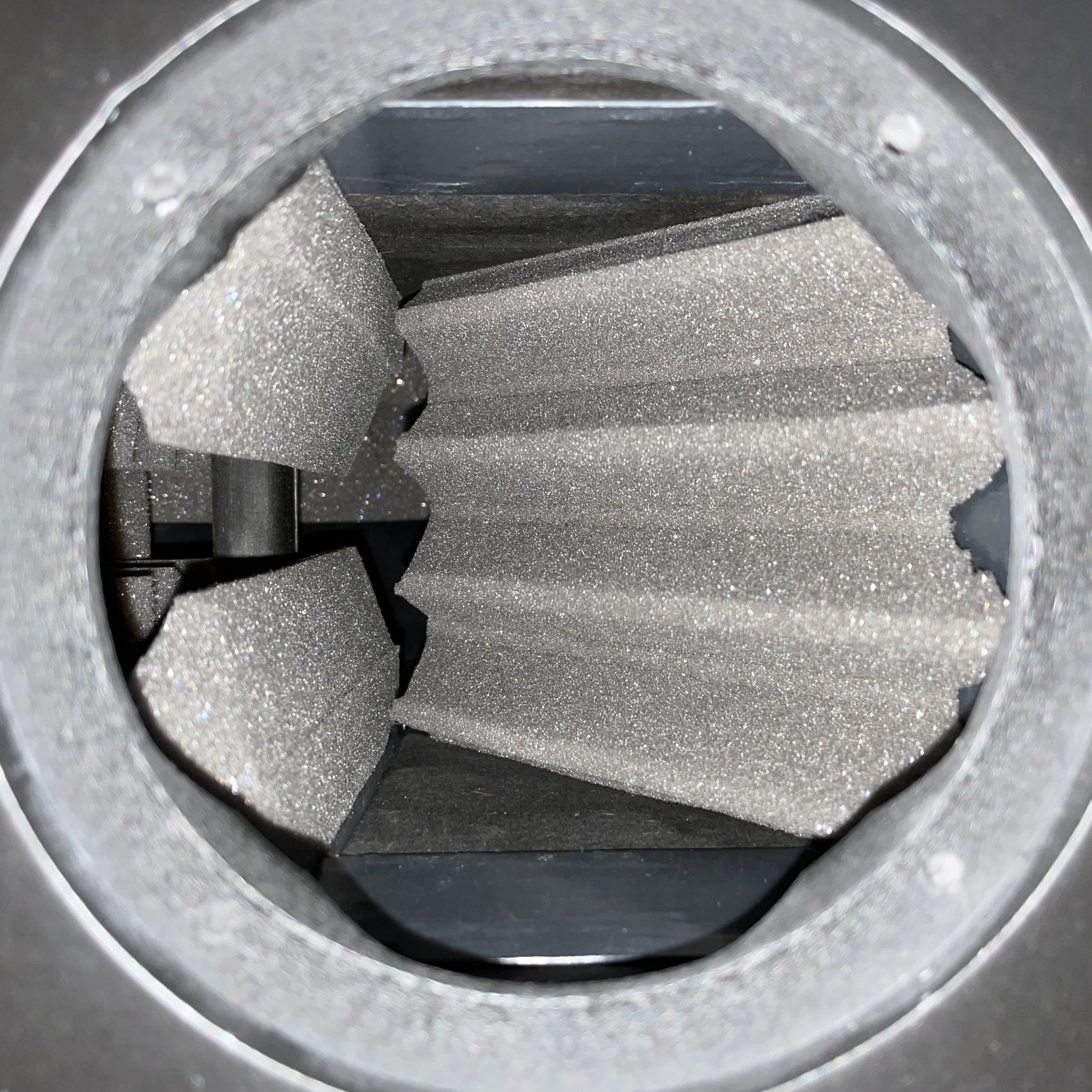

View in through the midrange driver hole to the 45deg panel behind it. The two side walls (pic top and bottom) will get another wedge of foam. The reflection goes left where there is lots of 5cm deep wedge foam.

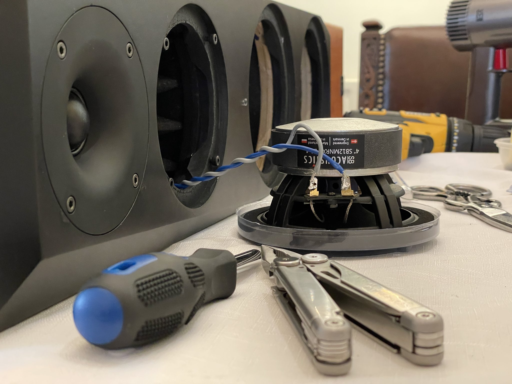

Soldering day.

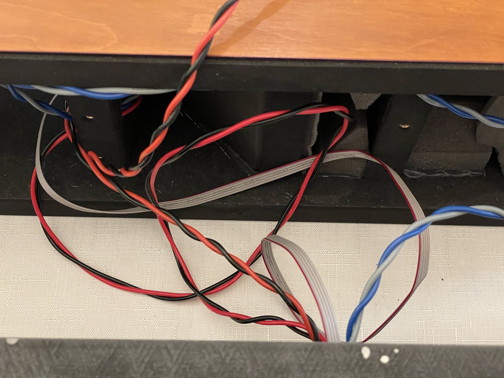

Cannot figure out which cable is which channel. Hypex manual says ‘main module’ is the 4x connector (red/black, blue/grey) and ‘additional module’ is the 2x connector (red/black). But it does not say anywhere which of the three channels is the tweeter (100W). I think the main module is 2x 250W. If so, the ‘additional’ one will be the tweeter. So I wired the blue/grey to the midrange.
you can find it on page 9 for nc 100 and pages 12 and 13 for nc 252
https://www.hypex.nl/media/7f/85/fa/1708610358/NC252MP_04xx_R14.pdf
https://www.hypex.nl/media/b0/4a/69/1708608357/NC100HF_04xx_R8.pdf
