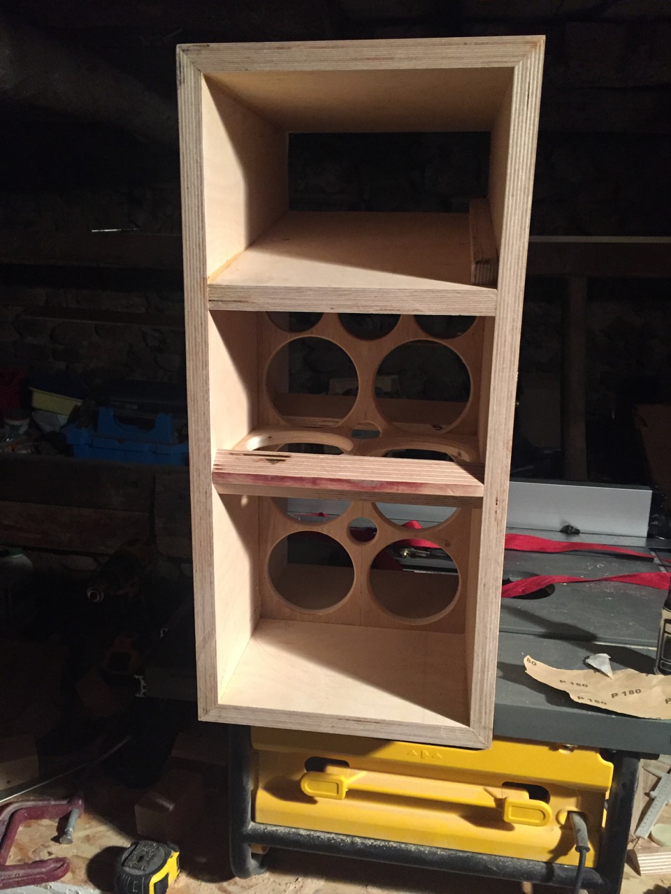

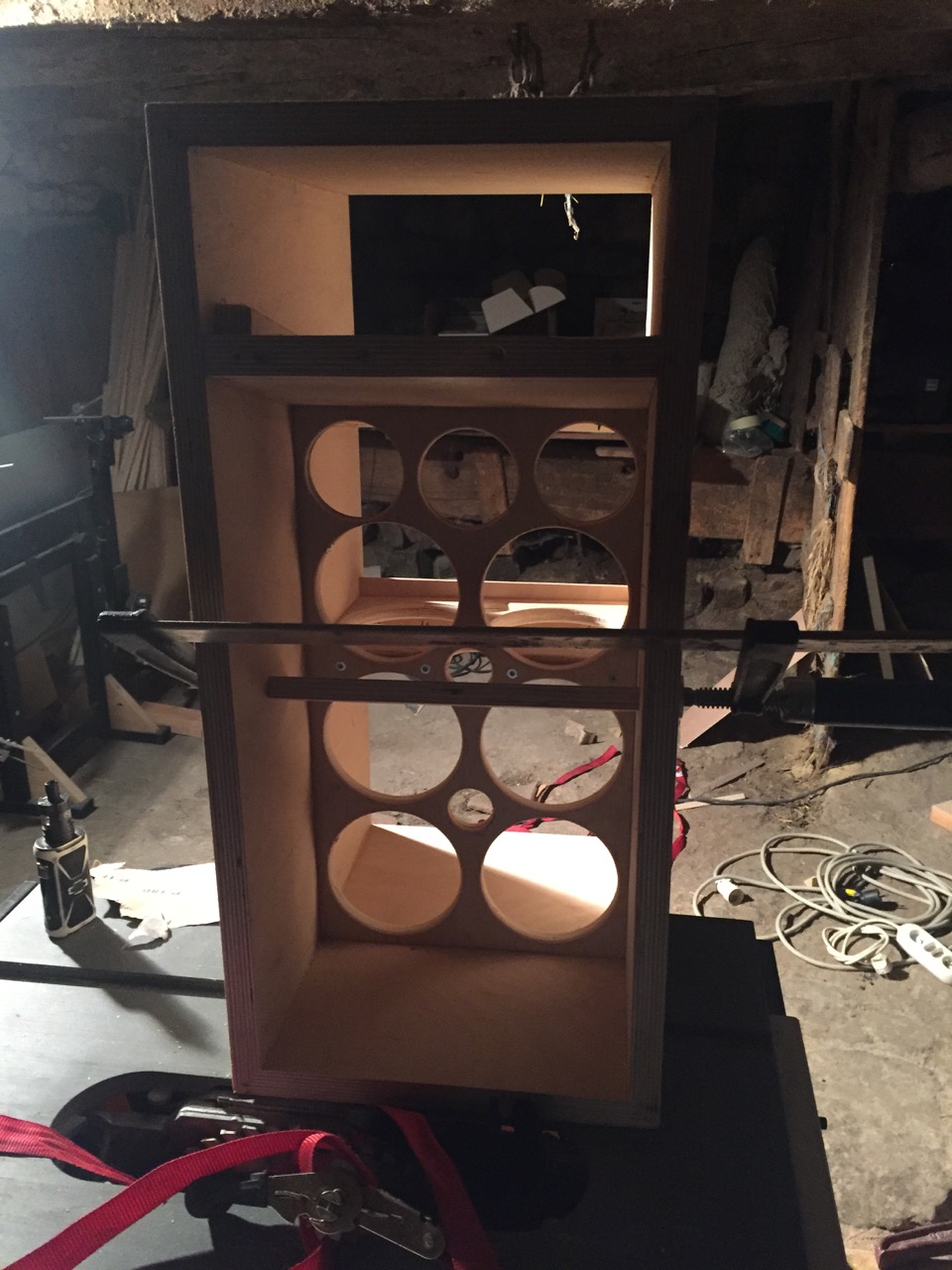

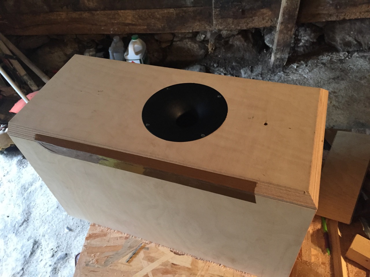

Hello everybody!
Has been quite a long time since I started this thread.
In the meanwhile I solved my necessity of monitoring in surround getting my hand on five pmc tb2+ that really do the job.

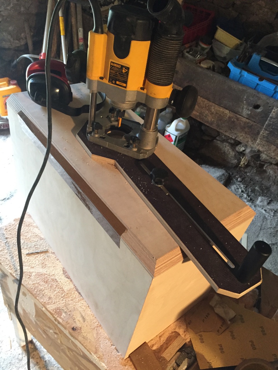

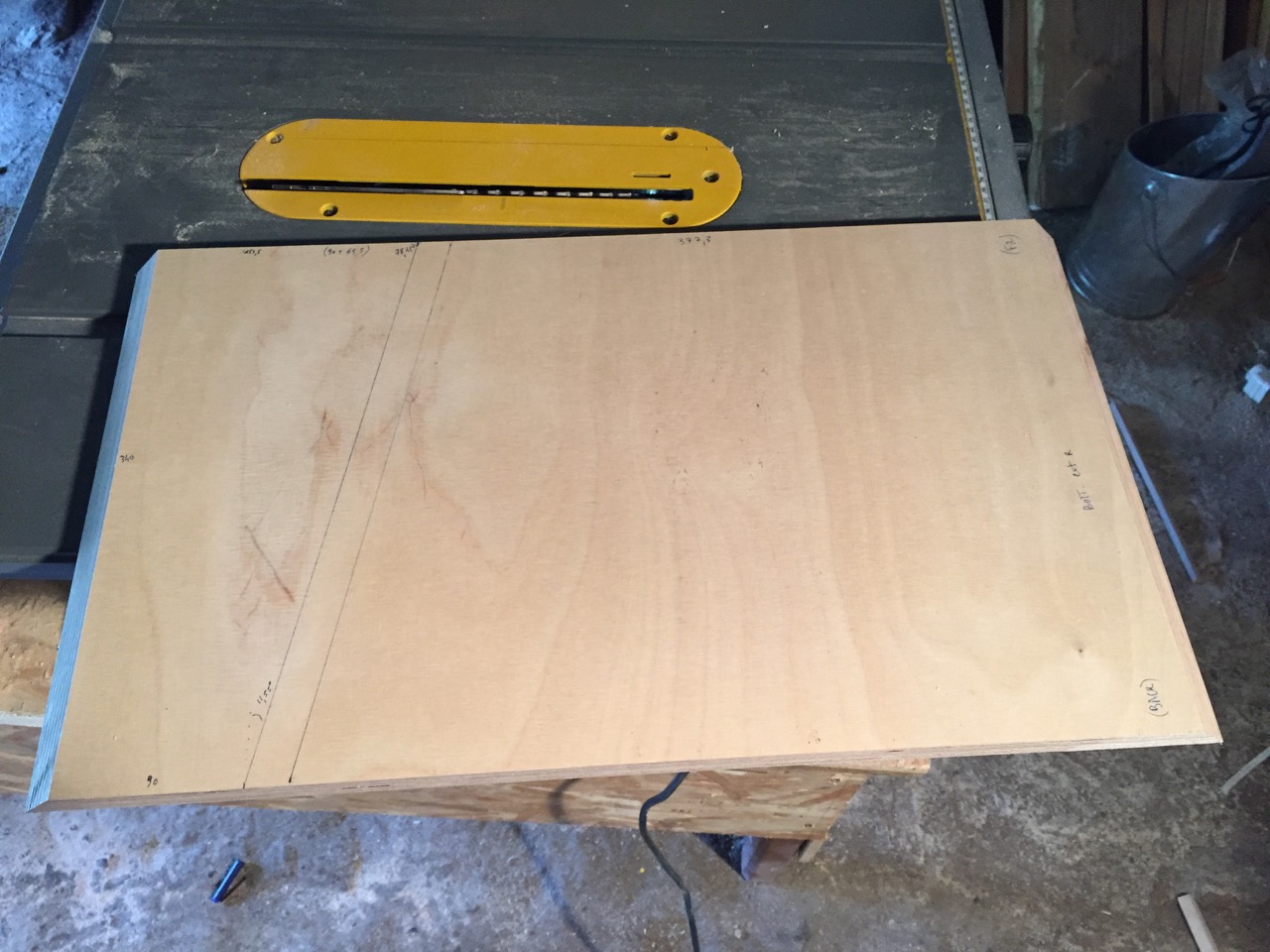

But this project was still somewhere in my mind and now, thanks to the loss of work related with the pandemic, I have the time to go on. I bought the missing parts to build a pair of those and started the wood working this week.
The chosen drivers are:
woofer: SB Satori WO24P-4
mid: SB Satori MR16P-4
tweeter: vifa XT25C30-4 with WG-300 waveguides.

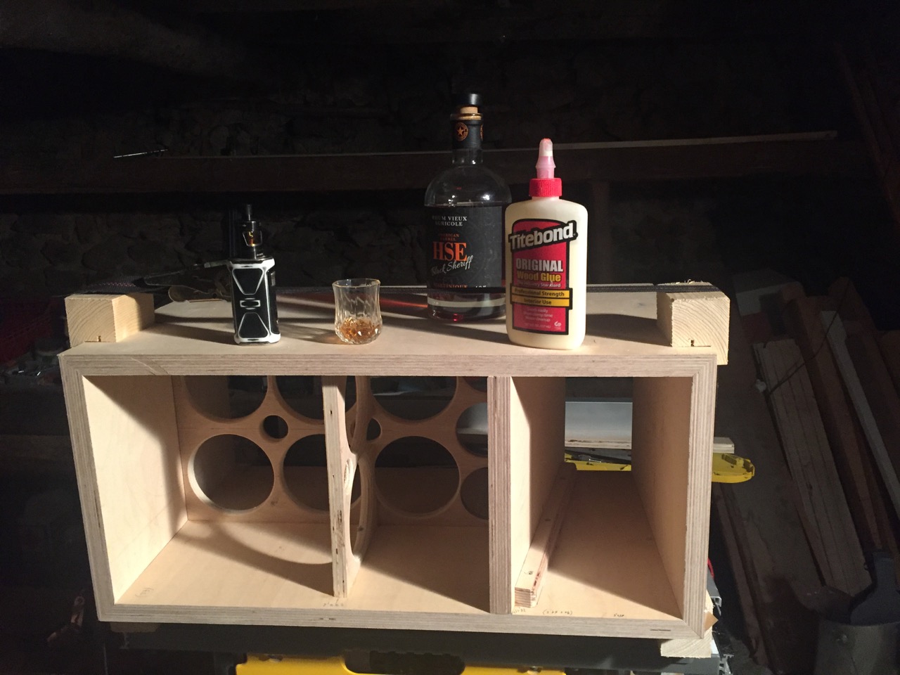

The idea is still a WTM sealed box, 30 liters for the woofer and 11 for the mid.

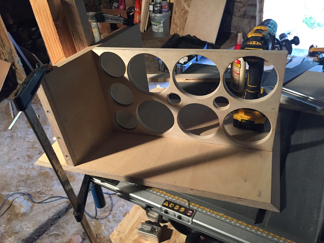

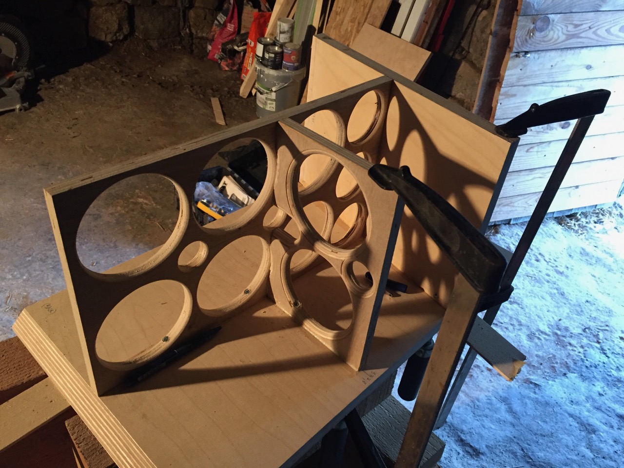

I would like to experiment on the mids, controlling the directionality with a sort of damped U frame, I'll keep you updated on this... pictures are coming..

Thanks for the kind words ! Hope to be able to make some measurements this weekend!
Keep you updated
Keep you updated

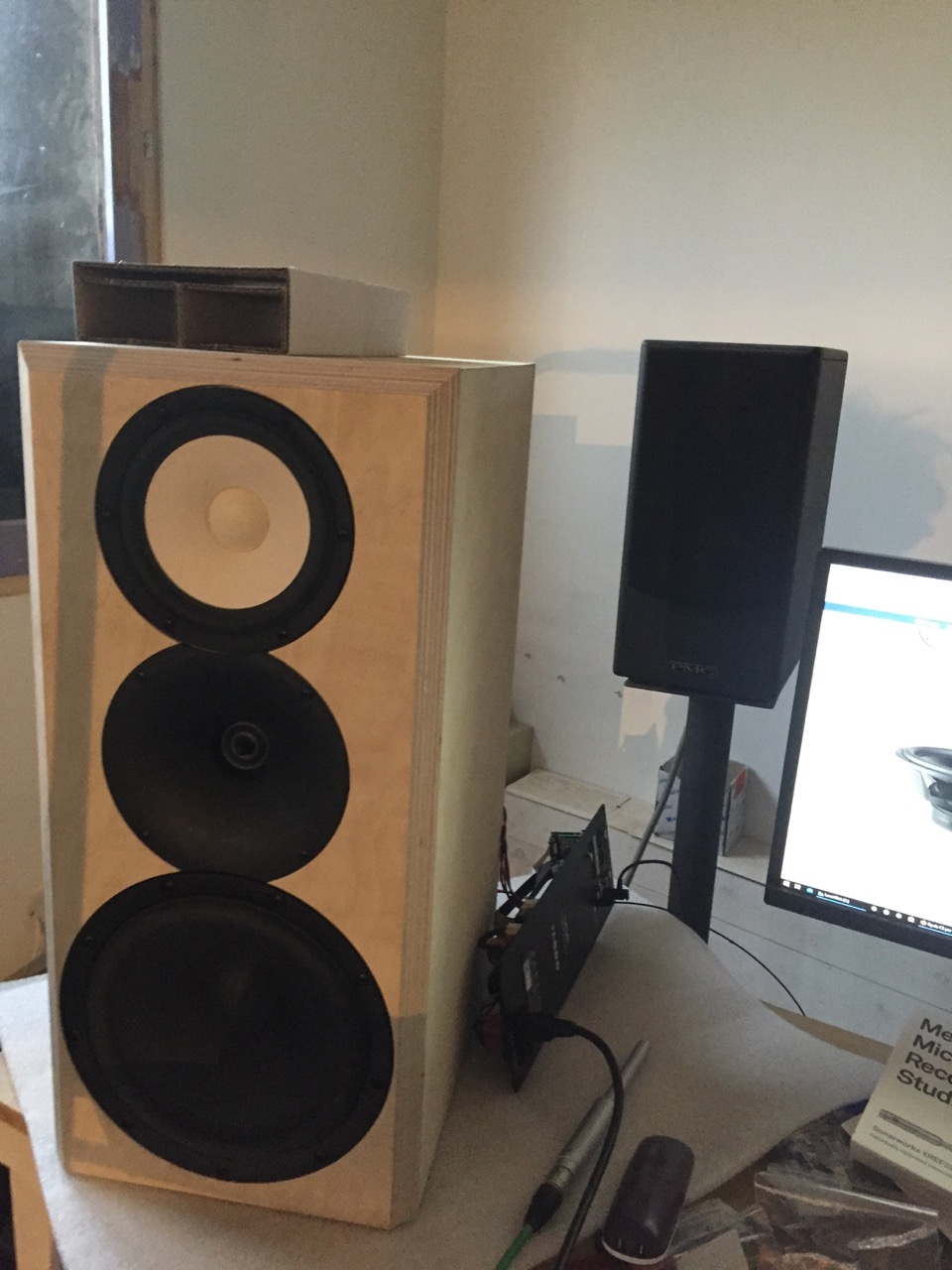

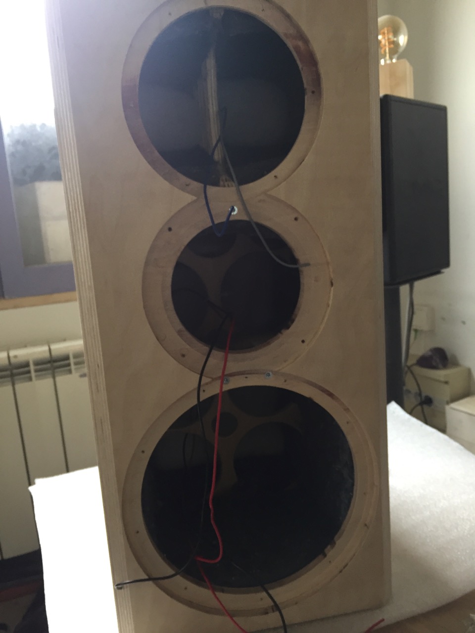

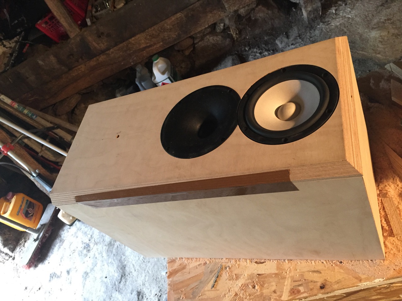

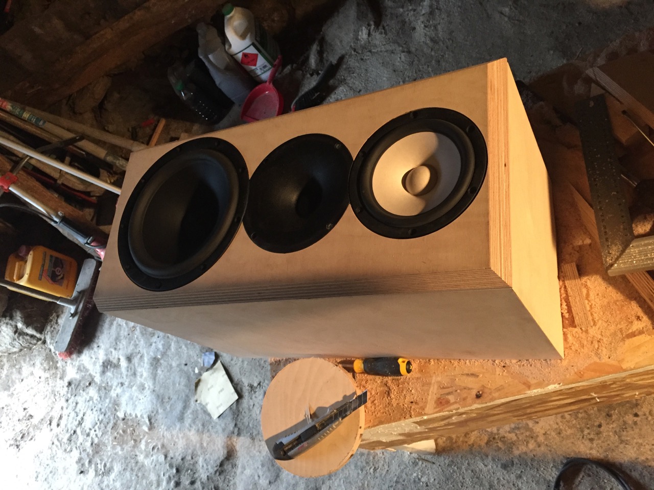

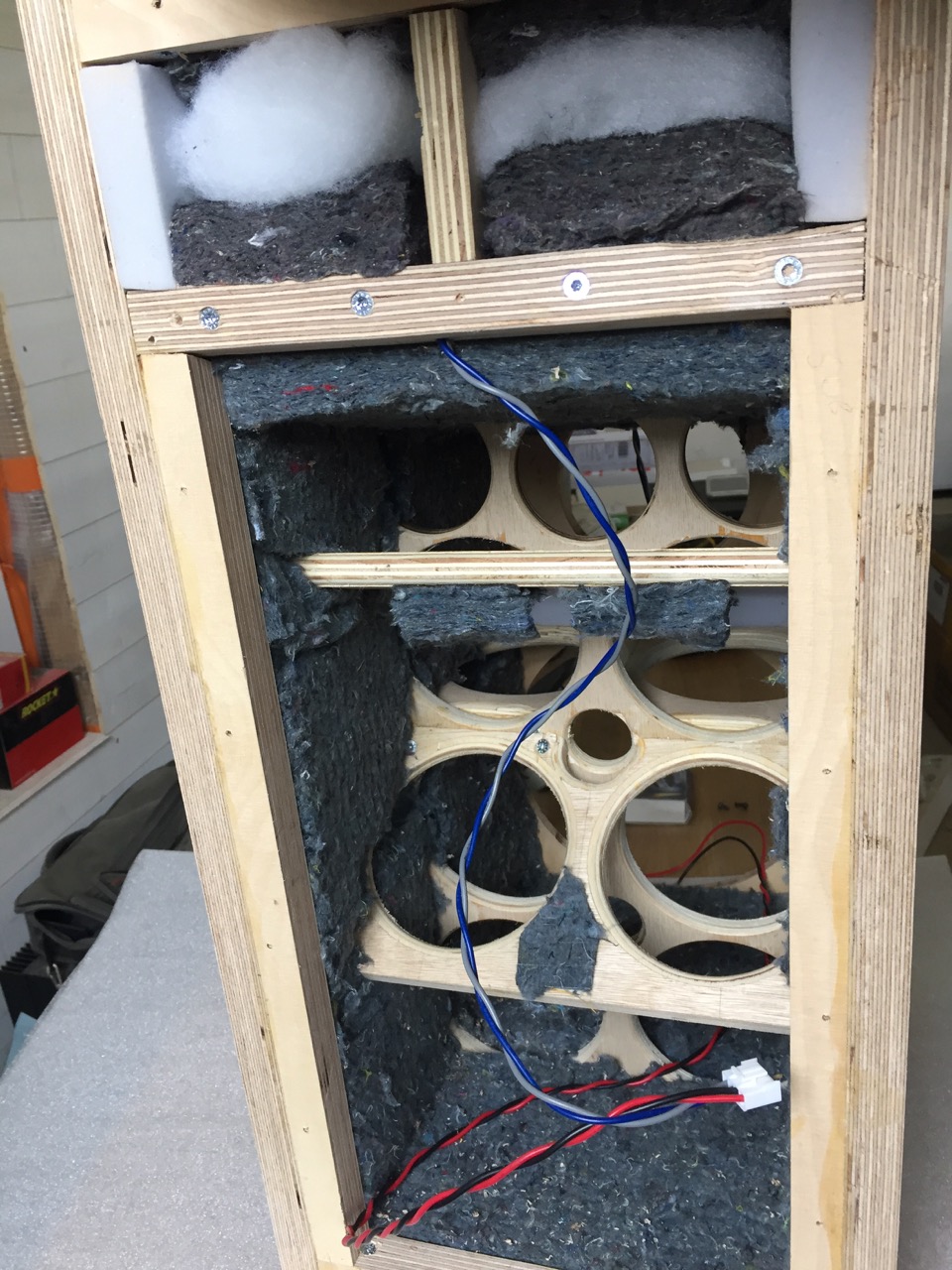

One of the speakers is finished, I did some crossover design but outside is raining hard so can't do real measurement...

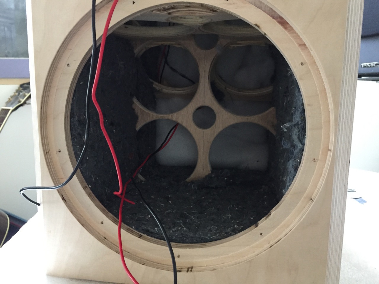

Some more pictures of the stuffing:
