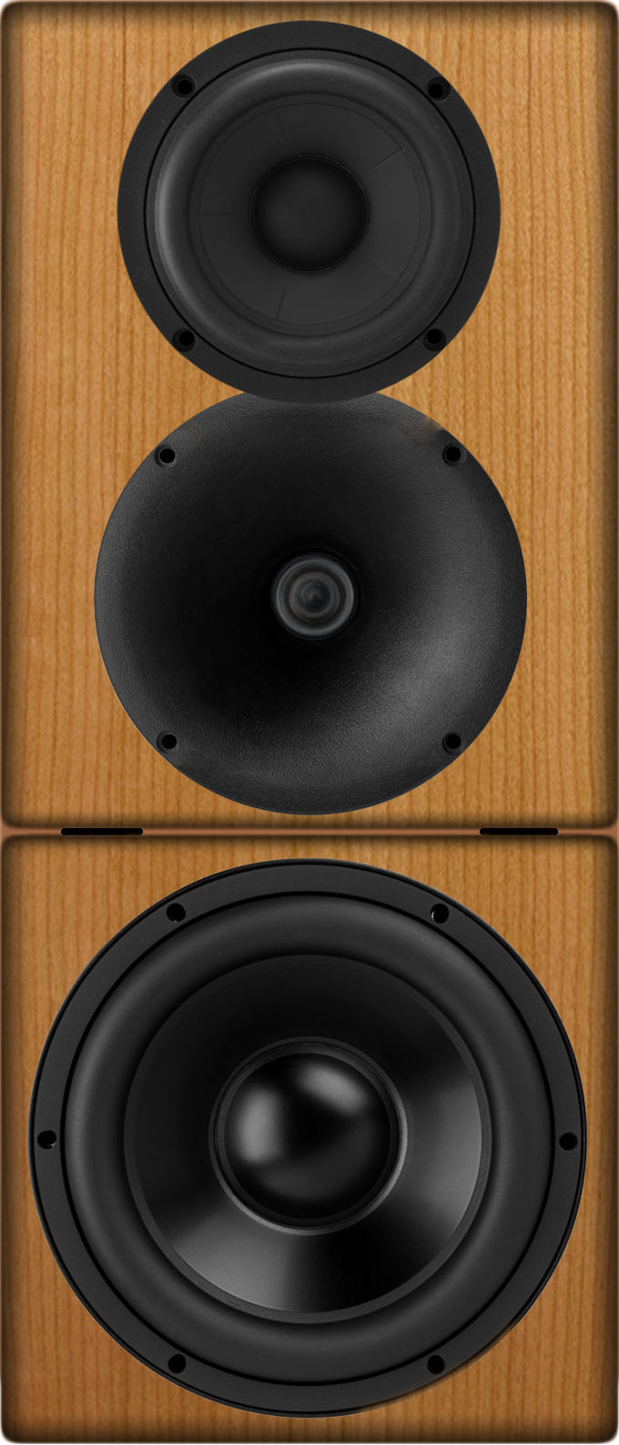

Which other 5" mids with flat response and low THD should I consider in your opinion?
@spendormania : Thinking at your bad experience with the RSS drivers, i was wandering if the reason could be the sympathetic resonance from the mid driver in the 900Hz-2k range . Were the two drivers sharing the same volume?

the mid and tweeter look fine. I would advise to swap the bass driver.
also the woofer is not 'badly designed, as such. more just appropriate as a sub woofer.

Do you guys think that decoupling MT from W is important for all these reasons?
'due to the WTM spacing, improves crossover integration between the W and the M.'
thats a fair point. as they are physically spaced further apart at the crossover frequency.
@250Hz wave lenght is 1.37mt, i'm not sure that 15cm makes a big difference.
Another reason for going WTM was to be able to use some speaker stands that I already have, and having T at the right height.
It also looks better I think ;-)

Thanks for your replies.
My initial selection was based on drivers that I have already listened to. Same tweeter is in my current setup, the mid driver (18W version) sounds great in Sveda Audio D'appo, woofer works well in GS-3a. I use DSP filtering so I'm really flexible here.
The reading / building of Troels project also influenced me (his SS 3way is great... never tried his more expensive designs).
All the mids suggested in this thread seem to do de job well. Expecially the sb15nac30 and sb15cac30. I guess the only way to know it is to build 2 speakers and try different mids before building the other 3 speakers.
For the woofer I need to do a choice before building cause it really influence the cabinet design and they cost more. I need a woofer that cad dig well to the 30Hz.
Mostly because in my classical recordings I need to take care of rumblings, foot-stamping, piano/harp pedals. That is the reason of chosing RSS as a driver that can do this in a modest sealed enclosure.
The only other choice in my price range would be Visaton TIW200XS with some dsp's eq.
I checked the seas woofers suggested but the don't seem to do the job and they are more expensive. I'm open to suggestions...
