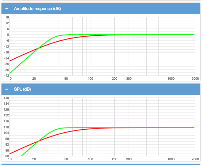

Peerless 83086 simulates well in a ported but not so much in a sealed enclosure...
SB23NAC is not bad, but still 6 db lower than Dayton RSS @ 30Hz.

OK, cabinet cost is also an important factor. Given a choice between:For the woofer I need to do a choice before building cause it really influence the cabinet design and they cost more. I need a woofer that cad dig well to the 30Hz.
a) A well-tuned high Xmax 8" driver in a compact box
b) More box volume and more cone area (e.g. 2 x 10 or 12 bipole) but only 5mm Xmax
My bet would be on the latter. The fat surround (a) gives more head room, but it also has to be less linear. Stiff heavy rubber = lots of hysteresis. A small VAS also means that the suspension is very stiff, so to minimise suspension-related distortion, the box should be relatively small, so that the air suspension becomes dominant.
IMD will be a b**** if you're trying to push +/- 5mm at 20Hz while XO at 250Hz. Use 2 x 10" or 12" with modest drivers in a bipole and you won't regret it. The only downside will be the large box, but even that will likely have some advantages.

Didn't know that driver. It's simulates really well in 20lt ported, tuned @35Hz, but in a sealed box it start sloping around 100hz...
edit: are you talking of STX W.22.250.8.FCX ?

I've got the W.27.400.8.MCDidn't know that driver. It's simulates really well in 20lt ported, tuned @35Hz, but in a sealed box it start sloping around 100hz...
