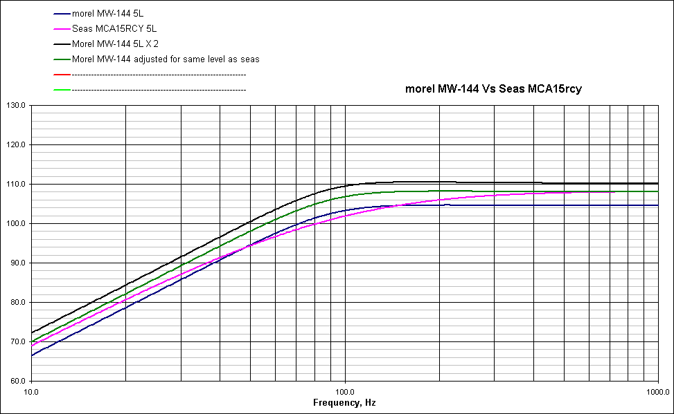

I have a new appreciation for my Morel MW-144's now after doing some modeling of the MCA15RCY!! It's main drawback for this project (the mw144) would be it's lower sensitivity (which is why I went MTM) but it really really does a better job (IMO) of being the midbass driver! I must admit I looked at a lot of stuff and did a lot of modelling as well before settling on the MW-144 (I'd originally discounted it before I learnt about MTM configurations). As I said early in this thread though, it Is probably out of the price range. It is around $30 US more per driver than the seas.
I tried modelling the seas as BR, but it had some nasty port resonances right where they would probably be problematic, I like the sealed better for simplicities sake as well.
I've attached a unixbox comparison of the MW-144 vs the MCA15RCY both modeled at 5L enclosure size. I think you will see where I am coming from For my own system I'm planning to cross actively at 200Hz at 12db/octave.
edit: to get the single MW-144 at the same level as the seas, I had to up the power from 80W (which is what I have unibox set at) to 180W! Just shows how important sensitivity is if you want loud, without too many watts! The MW-144 would be able to handle it (down to 200Hz still within linear range) but the woofer certainly wouldn't

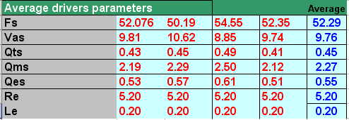

edit2: the ts params for the MW-144's were the average of my four drivers as measured, not manufacturers specs.

Your post confirms my findings in a few matters.
I found the MCA15RCY in a vented enclosure was a bit eratic and would require more work in the crossover. I'm unable to model a TL but I think would be a better option than vented. Your data confirms why I used an oversized sealed as it produces a smooth acoustic roll off which means the crossover has to do less work to achieve the target roll off as part of the work is already done. The other advantage was to provide a larger enclosure for backwave control. You can get similar roll off to the the Morel with the SEAS but means the enclosure becomes too small IMO for backwave control. The larger mid enclosure has those two advantages and only pays a small price in slightly lower power handling but the crossover can help that.
The other thing is you have confirmed is if you want to cross over lower (say <200Hz), then a mid woofer is the better option over a dedicated mid. For me the MCA15RCY needs to be crossed over >300 for 2nd order and maybe >450Hz for 1st order.

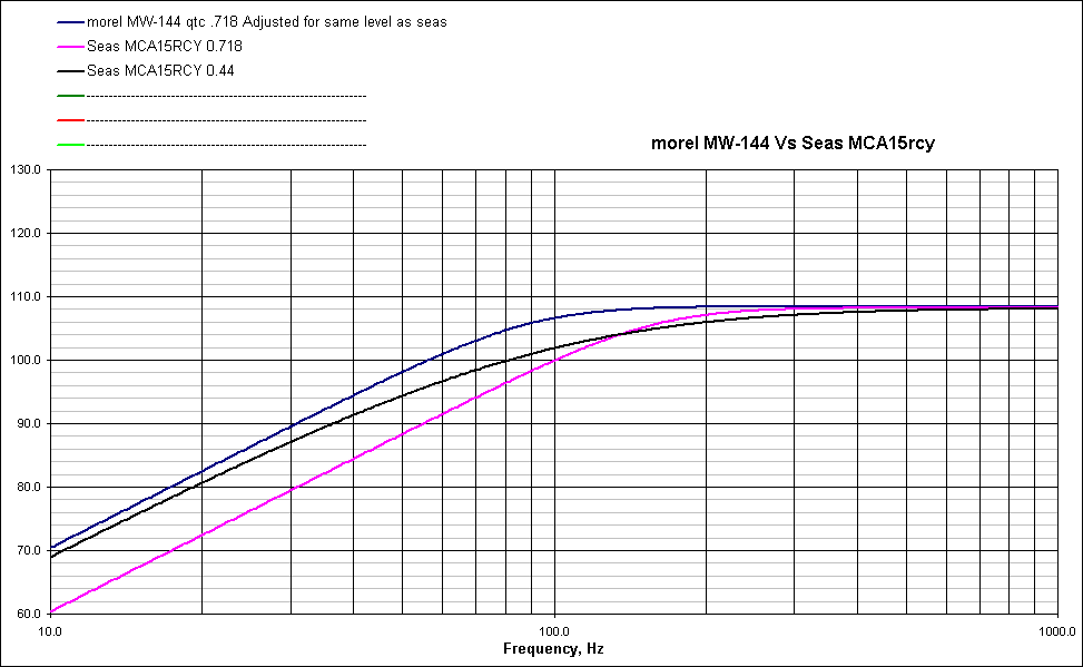

Hi Rabbitz, I revisited paying attention to the q of the enclosures this time! When you said it was oversized at 5L you weren't kidding!! I had to go to a 1000L box to get the q on the morel that low Definitely very different animals!!!
At 5L the morels box q is 0.718 and the seas 0.44 (according to unibox)
for a q of 0.718 on the Seas, box volume is a meagre 1.4L so I see what you mean about too tight for the backwave!
If I weren't concerned about that backwave I'd prefer to go with the 1.4L and try crossing at 300Hz with a second order electrical to try for a 4th order slope (but bear in mind I'm saying this from a theoretical view point as I haven't ever designed my own crossover).
It looks from unibox that the MCA would be down about 0.5db at 400Hz which is not too bad, but some might say the crossover should be at 500... The rollof is a bit shallower for the qtc of 0.44 is the idea to make it easier to match the woofers rollof to that of the mid (in the crossover region at least), since the woofer will not be rolling off at all (at the crossover freq), so to get a symetrical crossover the woofers filter transfer function will be pretty much all electrical? ie if we were to do the 1.4L and cross at 300Hz with 12db electrical on the mid, we'd need 24db electrical on the woofer (which is going to be expensive and more complicated)?
Am I on the right track? I think I completely missed the point originally

A mid enclosure with the driver crossing over (2nd order) 2 octaves or more above it's Fs is not going to be working significantly in it's piston range so I don't think it needs to be treated like a woofer box design (someone please correct me if I'm wrong). IMO a very low Qtc isn't a problem because of this and I think use of OB mids confirm this. What's the Q when using an OB mid driver? I don't know.
The bigger concern for me is backwave control as I have experienced it with a PL11MH /P11WH when used in a Qtc=0.7 enclosure. I chased the problem as a crossover issue but ended up being the backwave through the cone so when I changed it to OB mids it fell into place. The only other 3-way I have done used a 18W8531G00 (operating in it's piston range) in a sealed enclosure with a Qtc just over 0.8 and didn't have a backwave issue as the enclosure was 13 litres and a very different shape. I'm a bit paranoid with backwave issues I suppose. I got the taste of a lot of Infinity speakers through the late 70's and 80's that used OB mids as well as I think TL type mid enclosures and the absence of the backwave through the driver was a revelation.
With the crossover we are looking to sum at the crossover point about 6dB with 2nd order. If a mid is already down 1dB around this point I don't believe it's an issue as the crossover values would change to suit to give electrical filter crossover point that would be lower but would sum with the acoustic slope to reach the target.
The woofer crossover would still allow significant mids to be heard and summed with the mid driver to over 1kHz and in this style of speaker is essential to carry the weight and presence of the mids as the small mid could not achieve that on it's own.... it would surely sound weedy if the woofer was cut off too early IMO. A different story of course when using larger or multiple mid woofers for the mids.
I'm not going to get into the crossover but I think a 2nd order would be adequate for summing with the mid to give the required targets. More will be revealed I'm sure when Andre posts his crossover simulations.

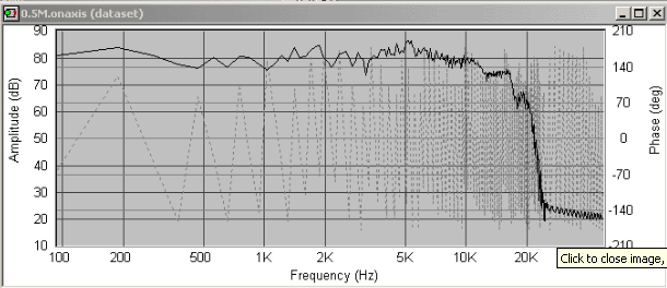

PS. attached is a graph from my three ways, taken quite a few years ago with a computer mic (so who knows what it's freq response was like) at 0.5M in room. I originally thought it was horrid, but with what I know now (especially about how much of an effect room interaction has) It really wasn't that bad at all (which janemann told me at the time). The drivers are being used outside of their ranges though (as they don't match well) so that is the cause of some of the problems with them.
Tony.

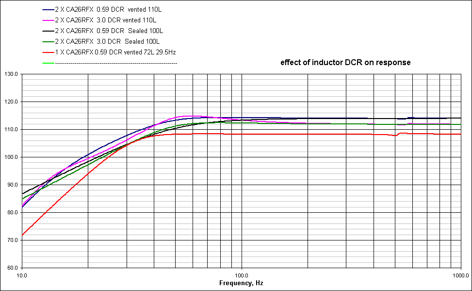

Hi Navin, increasing the DCR seems to have quite an effect on the reflex enclosures, less so on the sealed, but on both it cuts the level by 2db..
I've also put in a single unit at 72L and tuned to 29.5Hz (the 0.59 DCR actually helps with the low freq extention according to the model) for comparison...
Personally I don't see the need for two 10" drivers. The sensitivity of the 10" and the mid are actually very well matched with a single 10". Going to two in parallel doesn't appear to offer any great advantage in extention (though as Andre said it will give better tansient response) for a vented box (unless you go to a much bigger box of say 200L, but does require quite a 30% bigger box and it will probably need to be padded down to match the mids level... well that's my opinion anyway

FR: -6dB at 38Hz and 31kHz
Hope it is of use.
André
