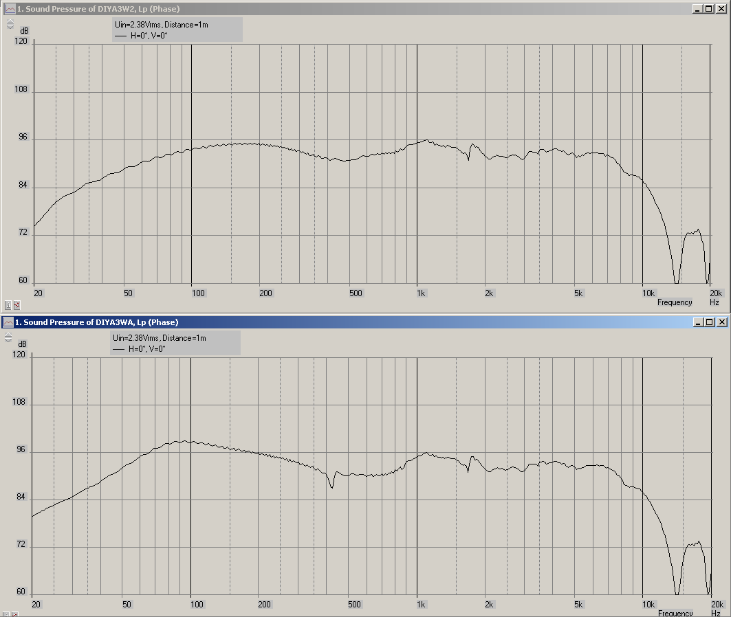

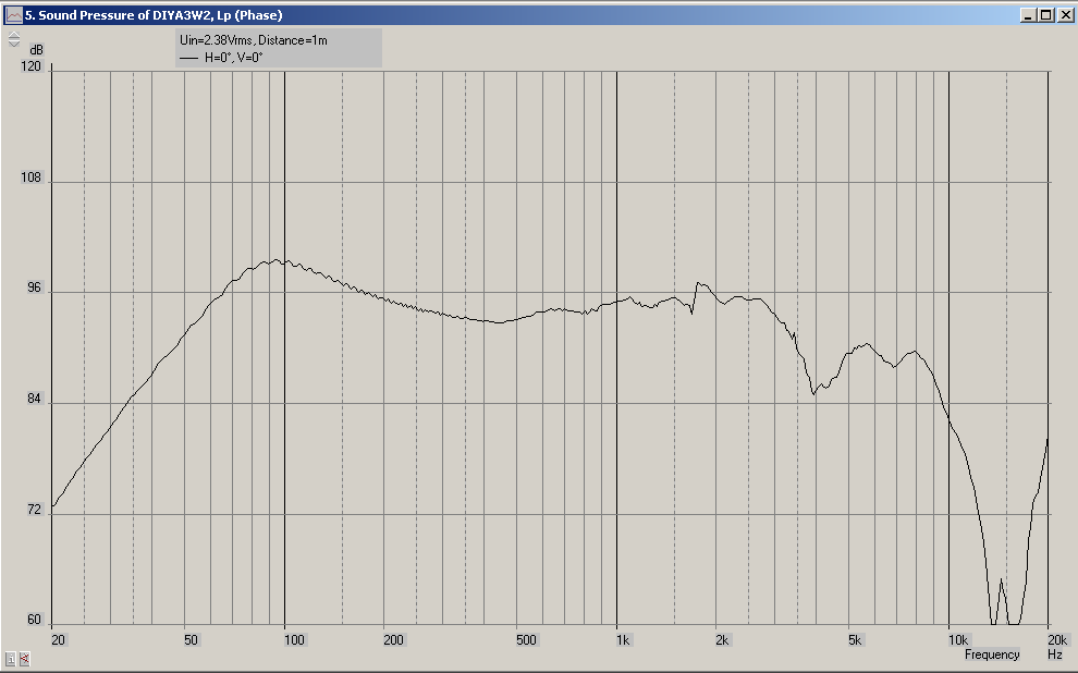

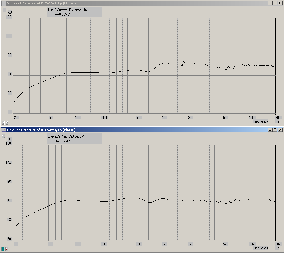

Well I have just simmed the whole thing in akabak, when I say the whole thing, baffle, drivers crossover and rear wall 🙂 The tweeter is sus because I don't have the T/S params for it, and also there is something very wrong with the reponse graph above about 10K.
This is 110L with the ports Andre specified, all the crossover components specified, and Rabitz inverted mid/tweeter (much better than with tweeter on top in the sim)
There is something very wrong with my model with repsect to the tweeter/mid but I think the bass part is probably somewhat accurate (although I'm not convinced it is doing ported, maybe sealed... I've attached two graphs, one with the speaker 1M from the rear wall, and the other with the speaker 20M from a rear wall. Unfortunately akabak can't simulate (at least I don't think it can) the chamfers on the front baffle, for that I'd probably use BDS. but not tonight!
I basically hacked one of the akabak exercises for this, and I've quite probably stuffed something up but it is a starting point 😉 I'll see if it will allow me to attach the akabak script in case any one is interested.
Tony.
PS. Navin, I thought it was really out of character for you to have specified a coil with 3 ohms DCR I was right because you didn't!!! SORRY! I should read more carefully!
Tony.

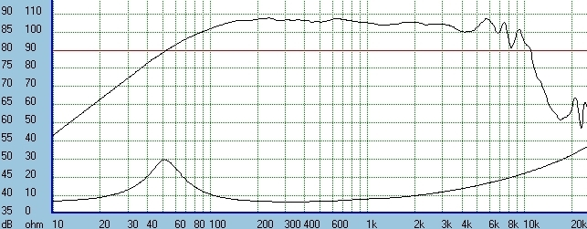

Hi all,
I know the MCA15RLY is an excellent dedicated midrange, but I'm wondering if the ER15RLY mid/woof could be used as an alternative? Slightly higher Qts and lower SPL but wow what a response curve... Zaph graph attached
seasons greets, Grant

midwoofers tend to have higher mms than true midranges. if one is corssing over at 100hz or so then a midwoofer is justified but if one is corssing over at 250Hz+ then a good midrange is better suited.

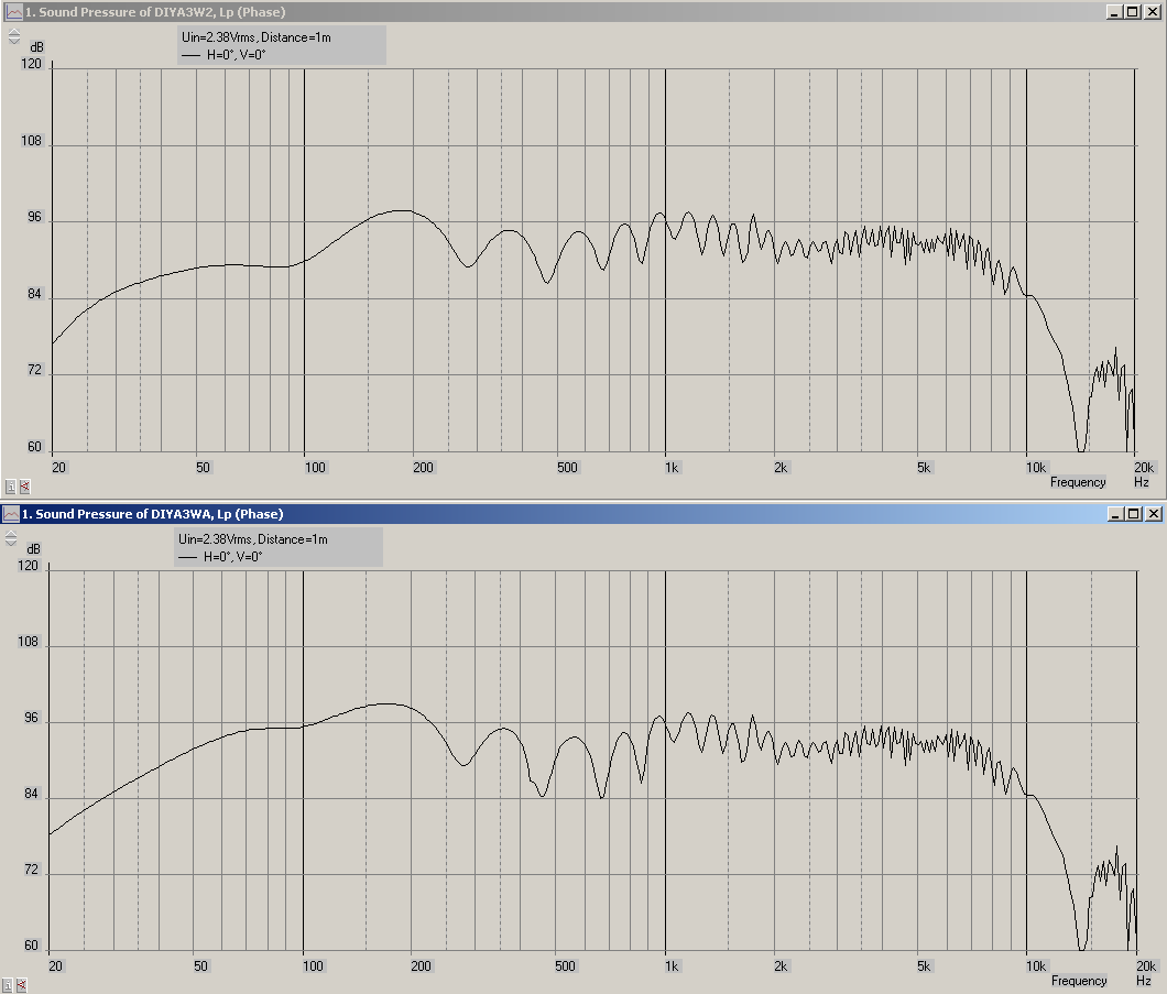

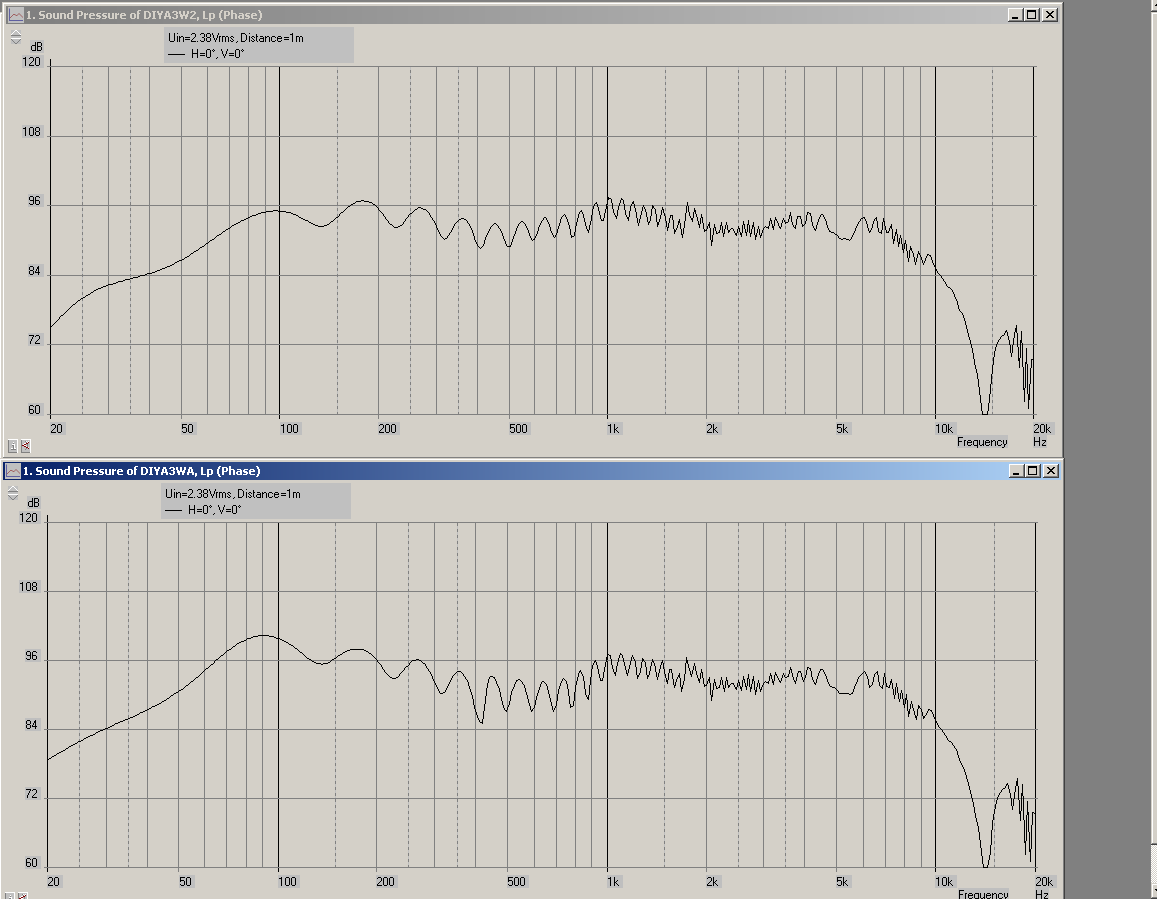

I've done some more playing with akabak today and have some new results. The first model I posted was definitely faulty, and the bass reflex was not working as intended.
The attached images are models with single CA26RFX in 73L box tuned to 29Hz (top graph) compared to two CA26RFX in 110L Box tuned to 25Hz (bottom graph).
The first is at a distance of 20M from rear wall to give an idea of the 4pi radiation. The next is at 75cm from rear wall, then 1M and then 1.5M and finally 2M.
One of the things I found was even at the 20M distance the baffle step didn't seem right, but a bit of fiddling revealed that the 1M height of the baffle seems to be having the same effect as a wide baffle and is actually re-inforcing the SPL.
Another thing I found was that the position of the woofer (in the single model) had a marked effect on the response. If it is near the bottom of the box there is a large dip in the response between 200 and 500Hz. The single and dual models are both with the woofer close to the tweeter, and then the second woofer directly below.
There apears to be some phase? issues (at least in this sim) with the crossover points... putting in an offset (into the baffle) for the tweeter seemed to improve things a bit in this regard, but crossover optimisation might help as well.
But all in all I think Andres' initial crossover looks like a good starting point! Of course this is just a sim and we would need real measured data to really optimise but certainly a very good starting point 🙂
I also substituted in a morel MDT30 tweeter simply because it has a flat response and I had the T/S params for it (as I can't find for the params for the seas, and akabak won't model it without). The reponse after 10K is still a bit of a mystery....
Oh the other thing is that I have guestimated the driver geometry for both the woofer and mid, from the datasheets diagrams (that is the cone depth) which does effect the simulated response.
Tony.

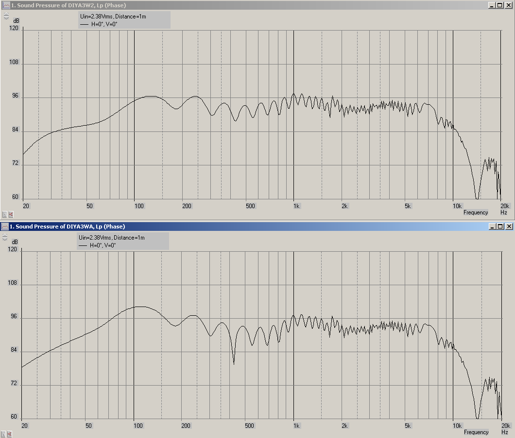

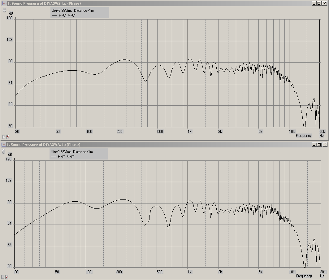

ok here is a comparison between having the woofer at a centre height of 60cm (top graph) compared to at a centre height of 15cm) bottom graph. I can only guess that the path length difference between the two heights and the mid causes some cancelation effects causing the more pronounced dip at around 500Hz.
Also I've attached the two different akabak scripts in a zip file in case anyone is interested. Note there is a lot of crud in them which is commented out 😉 I'm still getting up to speed with akabak!!
Tony.
Tony.

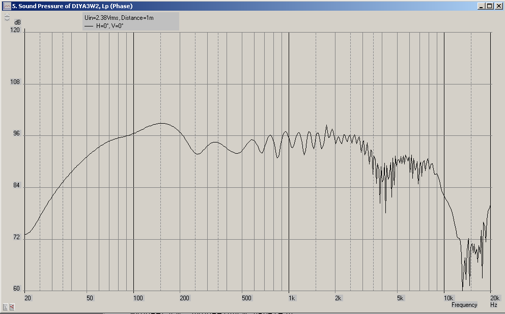

Hmmm the learning curve on akabak is steep.... The models I have posted so far should be ignored, I had the co-ordinate system for the baffle and rear-wall reflector all wrong. I get a nice tweeter response now (helps if it isn't positioned 80 odd centermeters above the baffle) 😉 All graphs previously posted should be ignored 😉 I might upload some new ones tomorrow if I feel confident I have ironed out the bugs...
Tony.
Tony.

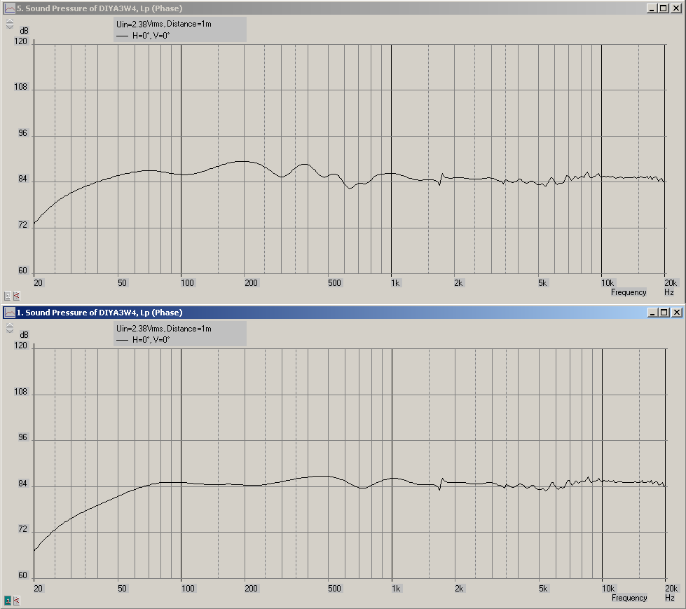

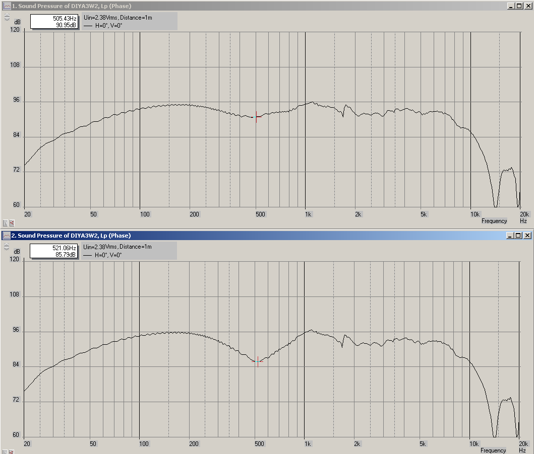

OK I'm going to post one more akabak model. I think now it is somewhat closer to being "correct"
The first graph shows the model without any BSC and the second is with 4db of BSC.
The second graph shows the BSC corrected on top and then the same with Rear wall (and floor) reflections turned on for just the woofer (rear wall at 1M behind). I've also set the absorbsion coeficient for the walls/floor to 0.33 to tame the peaks and troughs a bit, as the akabak manual states that they tend to be exagerated.
The crossover was initially done from within akabak as 2nd order linkwitz riley theoretical, then synthesised... I have hacked the midrange values to try and smooth out the reponse a little, so I really have no idea what the real alignment is now.
Crossover components as follows: (note I have no idea what I'm doing 😉 and I haven't adjusted for available values... )
BSC (from MJK's excell spreadsheet sans the zobel, as it dropped the mid too much)
1.8mH in parallel with 4.6ohm resistor This is in front of ALL other filter elements...
low pass: 6.93mH in series, 41.65uf to ground.
Mid: --- 0.35mh in series 7uF to ground --- 27uF in series 6.53mH to ground.
Tweeter: 5.71uF in series 0.95 mH to ground
As I said I have no idea what I am doing, but the graph doesn't look too bad to me 😉 4db BSC is probably going to be too much though IMO if close to a wall.. even if it is a decent distance away I think the floor reinforcment probably boosts it more than some peoples taste would allow.
I'm now going to cease posting akabak models and concentrate on modelling my own speakers for which I can take measurements and compare to the simulated results, that way I think I can get a feel for whether I am using the tool correctly, and what it's limitations are 🙂 If anyone with experience wants to grab the model and improve upon it, or point out where I have made gross errors, that would be great!! I know the first lot had major major problems, so I'm guessing I haven't quite got there yet 😉
Tony.
