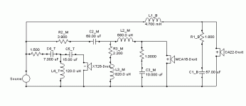

I'm working on a starting point design for this speaker. To keep it simple it's going to be a single woofer BR that should be easy to build. Should have an F3=35Hz and F6 just under 30Hz which should be plenty of extension.
I'll put up a simple 1st order starting point crossover (will need tweaking for sure) that may work in a series xo as well as a parallel xo. There is an alternative crossover that has been mentioned previously and based on Troel's 3W but with the MCA15RCY crossover section.
This will take a little time but I hope to have it up in a month or so. This should kick off the design and allow scope for variations by others to follow.

We could just use the manufacturers T/S specs and designing a "book" filter all second order and then lots of tweaking to get it right, what I have found in my experiments is the woofer almost always needs a second order roll-off but often the midrange and tweeter need third order slopes on the high-pass for best integration.
