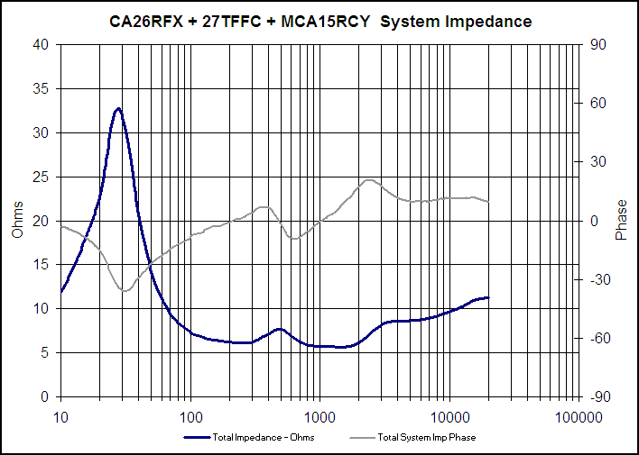

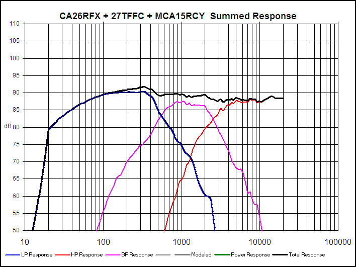

Crossover check
I ran some quick numbers through PCD. It's a bit rough and doesn't take variables into account or tweaked for best phase etc.
Using the 27TFFC + MCA15RCY + CA26RFX drivers, the woofer xo from the 3-way Classic, the mid xo on post #297 with 2R7 padding instead of 3R9 and a simpler 2nd order (5.6uF + 0.33mH with 3R9 padding amp side) on the tweeter which shows these drivers would work well with a simple 2nd order. Only the mid is reversed polarity.
I picked the CA26RFX as to me is the better woofer and worth the extra money over the CA26RE4X plus it is closer in behaviour to the woofer in the 3-way Classic (CA22RNX).
The 27TDFC drops right in and may need a tad of extra padding.
Not too shabby and if you look at the graphs, this combination has the potential to be very good and would be easy to tweak.

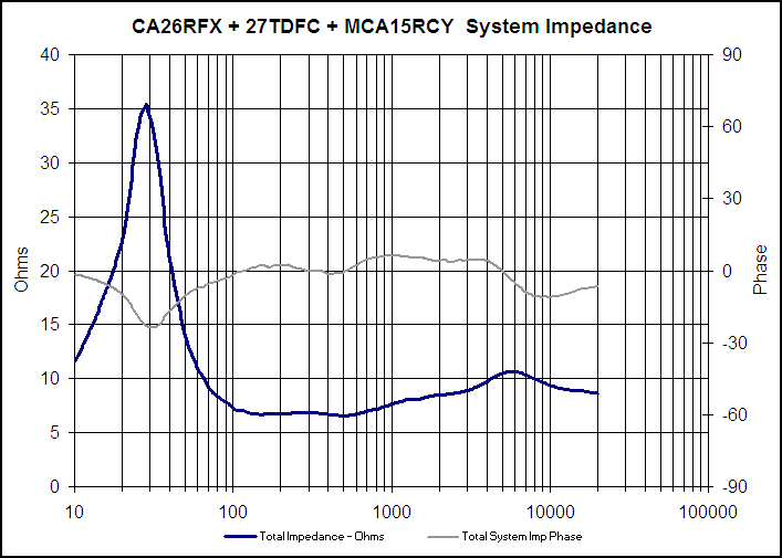

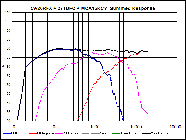

Crossover check continued
Due to the good behaviour of these drivers there is a strong possibility that a simple 1st order could be used for those who like the lower order crossovers. For it to work a zobel would be required on the woofer and an undersized zobel on the mid for roll off shaping. The tweeter is reversed polarity.
The drivers are 27TDFC + MCA15RCY + CA26RFX with the tweeter changed as the 27TDFC is more suitable for a 1st order crossover due to the lower Fs and previous experience with pushing this tweeter.
It may even work the same in a 1st order classic series crossover.
Doesn't look to bad either and once again a rough check in PCD.
Please remember my 3-ways suck but these posts do show the potential on offer.
A tad (0.5db) less padding on the tweeter and mid might be in order as the woofer will get some gain from room placement.
The moment you mentioned "1st order" I thought "series". Andy G had written a lot about series networks a few years ago. I built a 2 way series (using Vifa TC series components in 2004) and the experience was wonderful the woofer - tweeter integration was seamless.
Nice work this is a lot of progress. Is the later design (with TDFC tweeter) 1st order?
BTW did you only account for the drivers electrical characteristics? or did you account for the driver topology and cabinet dimensions as well?
Navin
I live close to Andy G and very familair with his 1st order series speakers and the sonics they provide and he was the one that got me into them. If I didn't mention series Andy would thump me big time. :whip: Most of my designs use classic series or AR series crossovers but there are some with parallel crossovers (don't tell Andy).
The 27TDFC in post #315 is using a 1st order filter and the damping resistor in the L-pad helps the roll off to reduce issues at Fs.
The crossovers only use the driver's behaviour and only a rough exercise to show the potential. The frd and zma were only coarse traced manufacturer's graphs as I have a problem with my hands using the mouse with extended clicking. It's a shame there's not some good frd / zma databases out there as there must be so much measured data around. Maybe there can be one added at diyAudio in the future.
