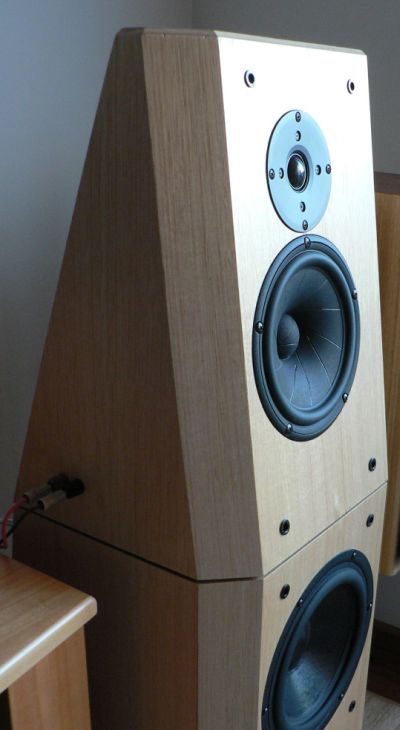

With mine I went with a sloped baffle for the tweeter and mid woofer in an effort to get reasonable time alignment with the woofer etc. I left the woofer firing straight out and low as it places it more off axis to reduce the amount of mids arriving from it to the ears.
The angle of the baffle for the tweeter and mid woofer helps with getting them more off axis and not pointing directly at the ears.
Very nice woodwork. The drivers are all ScanSpeak? or is the woofer another make/brand/model?
The tweeter is the Peerless 810921 (replaced a S2905) so is essentially a Scan Speak as they made them, mid woofer 18W8531G00 (coated), woofer M22WR-09-08. I did try a 22W8851T00 but didn't work as well as the M22WR in the design.
There's are bit of chip out around the top edge which was a bit disappointing but these were cut down from an OB mid design and became sealed in the mids. Cutting and trimming finished enclosures is a real pain as normally associated with the whirr sound is clunking sounds as timber splinters and breaks out. :h_ache:

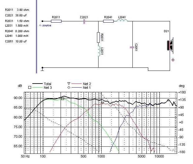

I'm posting a pic of the mid crossover for a MCA15RCY which was an alternative requested by a builder for the 3W Classic speaker. Troels supplied this information and is untested with the 3W design but he was confident. I hope I'm not stepping on his toes or annoying him by posting this. If I am, I'm very sorry. :sad:
The reason I want to post it is the mid crossover is the hardest to get right IMO and this would be a great starting point for the crossover design. The tweeter crossover from the 3W would work and could be easily tweaked. The woofer crossover would need some work and as it's a 10" woofer, the mid crossover point may want to be lowered a tad to suit. There is a bit of padding of the mid driver to suit the 3W and which means there is mid SPL available.
Maybe someone in Denmark may be able to obtain the help of Troels as he has bags of experience with these type of SEAS drivers in 3-ways. Madisound design service is always another option but maybe not in keeping with the diy and learning flavour of this thread. Hopefully someone will pick it up and run with it providing a learning tool in the process.
