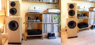

I believe the cost of the individual drivers doesn't determine the quality of the overall system, their implementation does. Marrying three good, well suited drivers with the right cab and crossover is what makes it sing.

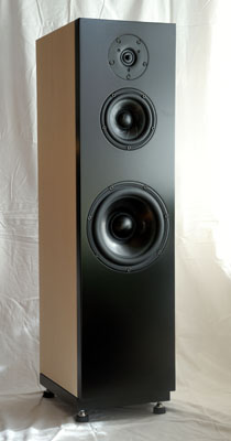

My "reference" 3-way uses relatively low cost drivers - Seas woofer, Vifa mid and Scanspeak tweeter.
