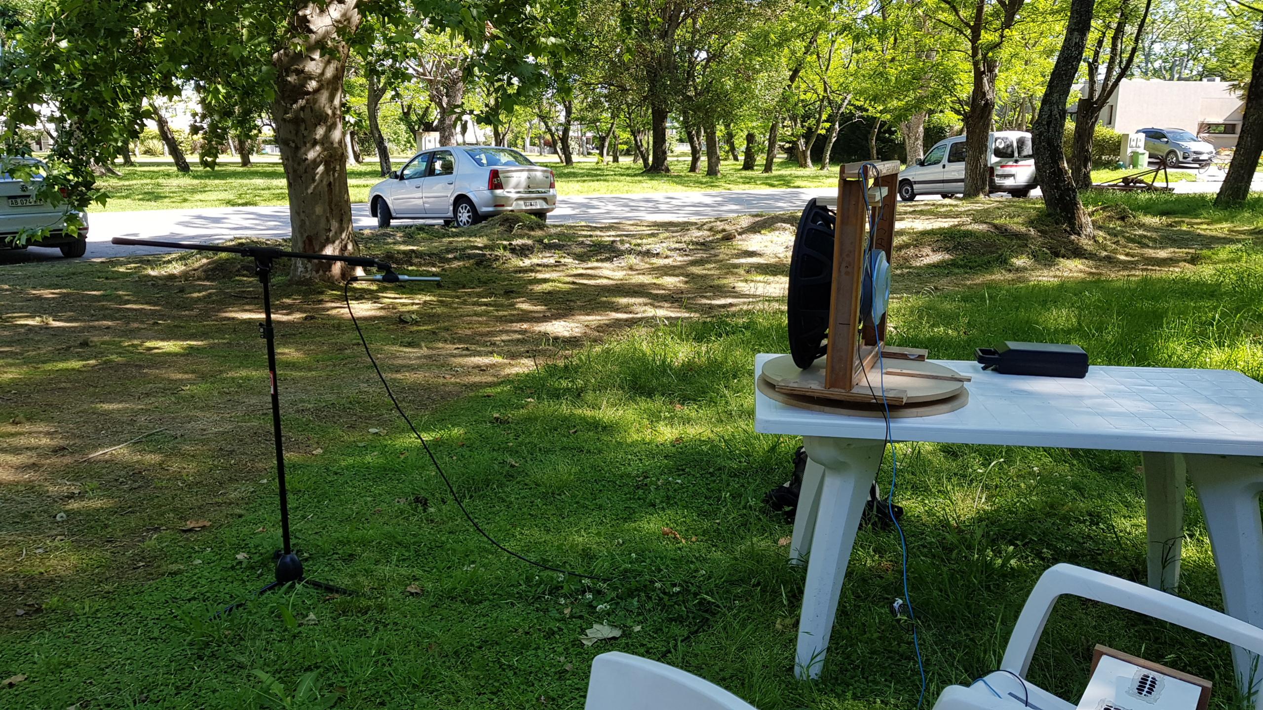

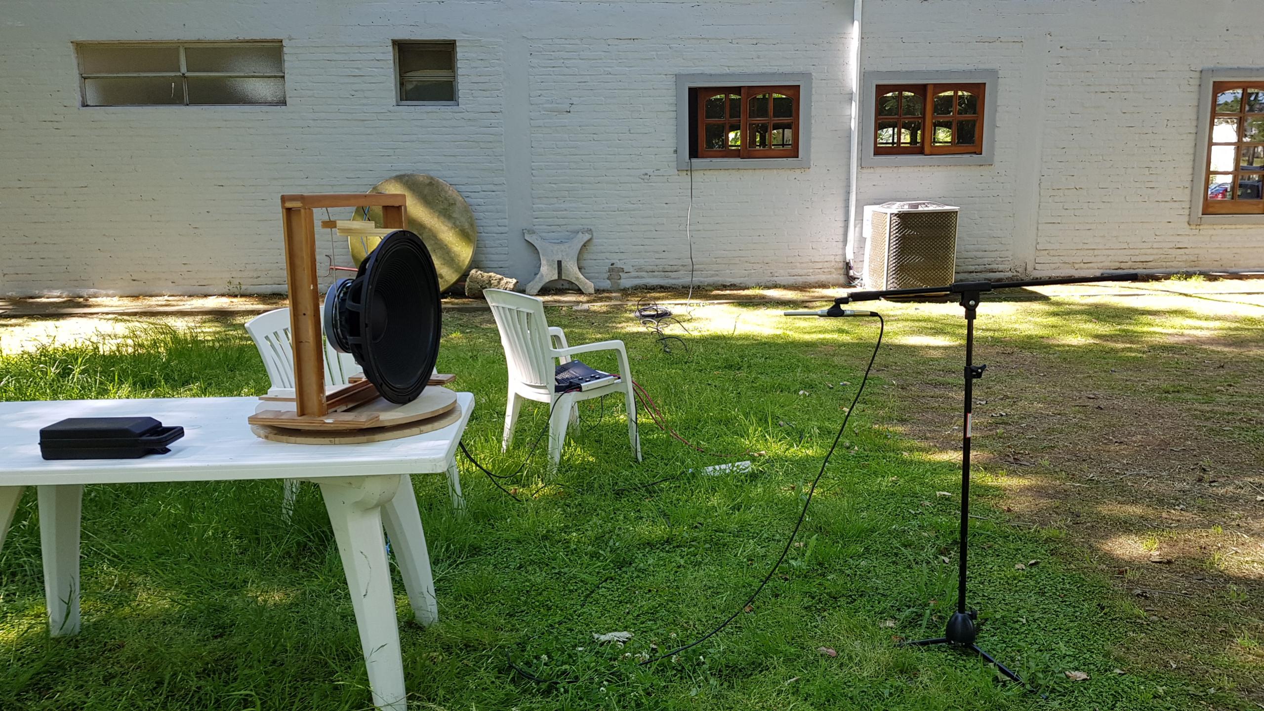

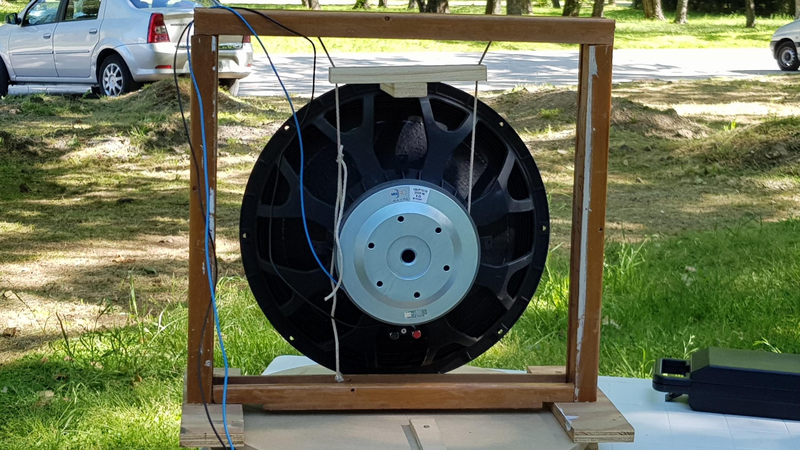

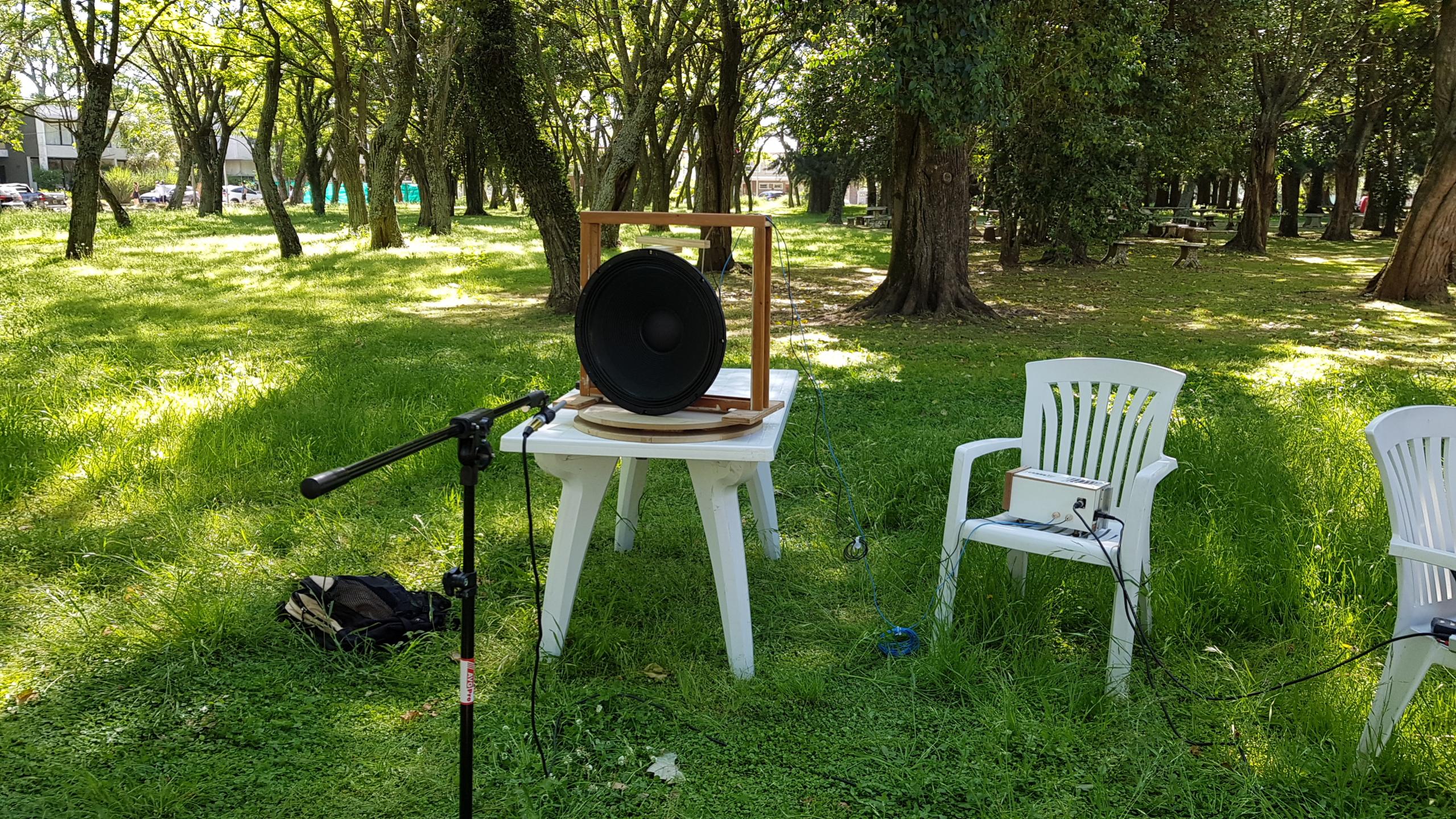

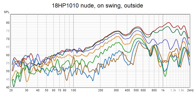

I was able to run outside measurements of my new 18" nude on a swing, 0 to 180°. It was a windy day and the 18" moved with the wind given the swing and large surface, despite the weight. Ran out of time to do the other drivers.
The space was quite open: about 70m to any flat surfaces on three sides and 10m to a wall (extender power cable being the limiting factor). At 0° the speaker axis was parallel to that wall, so hopefully not significant reflections. The woofer center was about 90cm to 1m off the floor, and so was the mic. The mic was 1.1m away from the dustcap. Measurements every 15°, REW set to automatic windowing width. Graphs are smoothed to 1/12 for clarity. Pictures of the setup attached.
Here are the front measurements, 0 to 90°:
The back half:
And front vs back (limiting number for ease of interpretation):
What do you think?
Here are my takeaways, shared to get feedback in case I'm misunderstanding:
Looking forward for your insights/opinions!

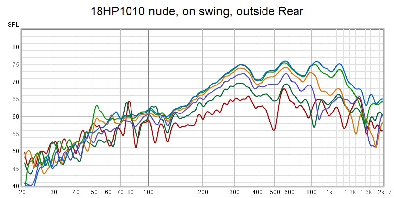

The back half:

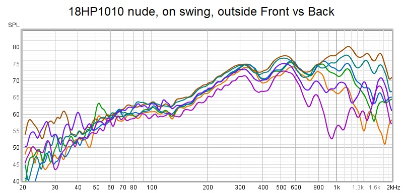

What do you think?
- Front vs back response are pretty similar, which is what I intended when choosing this driver.
- The driver seems usable from 50Hz, maybe even lower, but there are 3dB between response at 50 and 70Hz, so might be better to cross at 70Hz.
- How high should I cross the top? I use Acourate, that effectively lowers everything above the target curve I could go up to 650Hz (71dB at 15°) and that would be 11dB over the response at 70Hz (60dB at 15°). People usually cross 18"s lower, though, so maybe 300 or 400Hz would be better. Too bad I didn't get to measure the midrange today

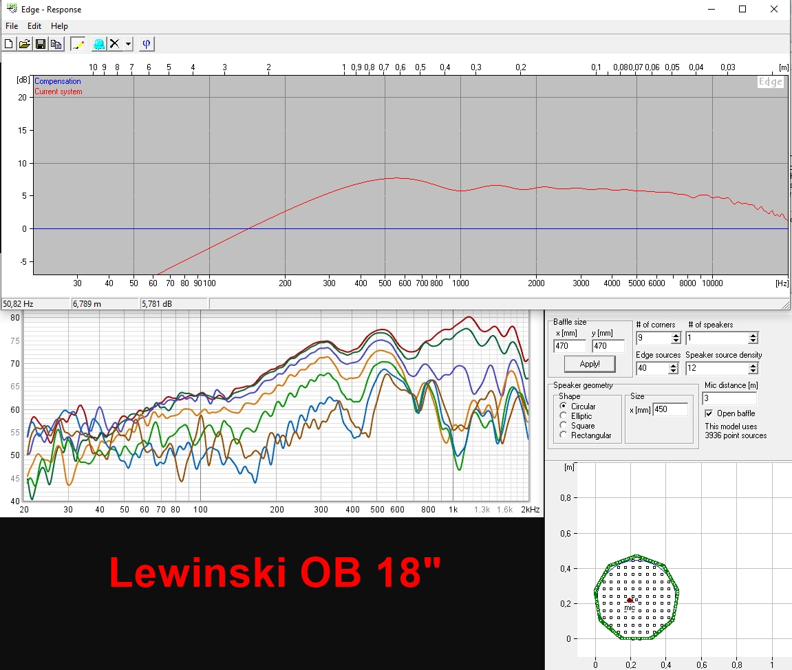

Turntable and table were too close to the driver, looks like they are causing the dip at 400Hz. Ground bounce is around 150Hz, estimated distances from pic. Freq-dependent windowing per 15 cycles seems to be default in REW and it looks ok, but for Vituixcad etc. sims I don't know...
Wind noise around 55-60dB but low end is pretty much predictable.
Here is Edge sim compared to your measurements
When you consider xo, remember that preferably one octave above xo shoud be smooth and with constant directivity! So xo in 400-600Hz range? And yes, you'll need lots of eq in low end!
