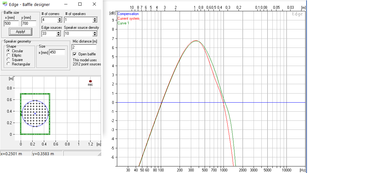

Why is mic so high in Edge sim? There is cancellation because of vertical source distance showing. This is real, but I wouldn't design anything based on that. Always take on-axis sim first to see "ideal" response. Off-axis sims are useful to find out where and when directivity gets messed up.
Attached is my sim with mic on mid-driver height and above it like in Lewinski's sim.
I was simulating closer what real conditions would be, but I see your point. Thanks for taking the time to provide a thorough answer.

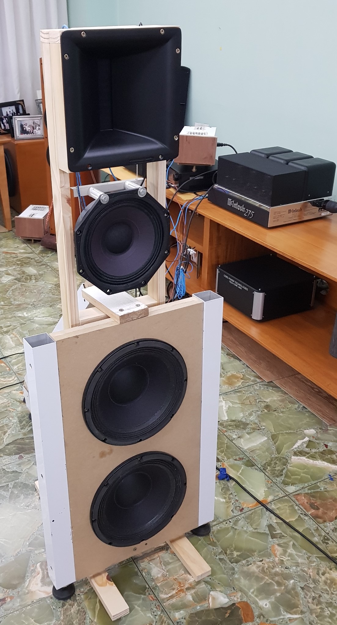

Made some progress. I had an issue with my soundcard which took a fair amount of time to figure out it was a hardware issue only affecting two channels, so I was able to circumvent the issue and measure using other channels.
Anyway, here's where I stand: built one speaker, playing mono.
Two 12" sealed subs play up to 70Hz
Two 10" OB from 70 to 500Hz powered by the Hypex UcD amp (the low gain in these amps forced me to re-route soundcard channels as not all of them have the same gain)
Swinging 8" bafleless from 500 to 1500Hz powered by one channel in MC275
TPL-150H with back cover as sold by Beyma from 1500Hz up, powered by MC275.
XO: NT 2nd-order. Digital XO and filters generated in Acourate.
Sounding good. Many things to try out, though. I turned the speaker around 90 degrees and opened the dividing panels so the room is now 10m long and speakers are 3m away from the [now] front wall and 7m from the back wall.

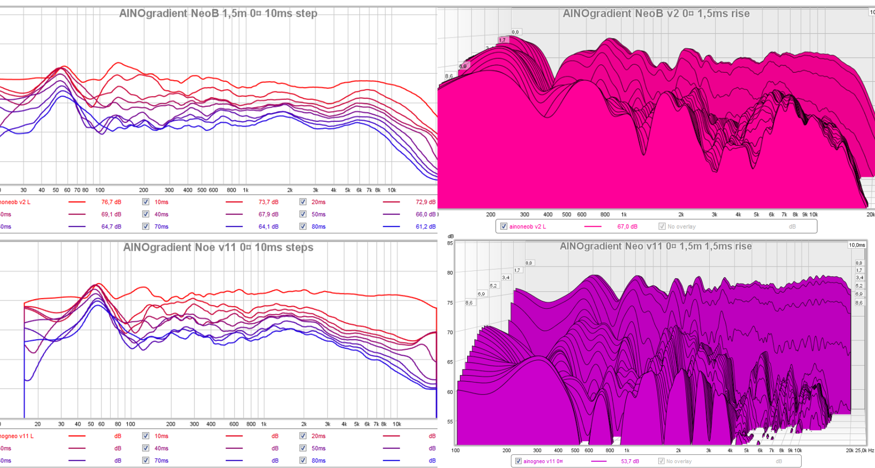

Here my horn tweeter version of AINOgradients with and without backside tweeter - at listening spot/on-axis. Crossed around 3500Hz and it was very easy to hear the difference! On-axis response was not equal in these measurements, but I had numerous settings tested and the backside tweeter stayed until I purchased B&G Neo3 planar dipole tweeters.

I'm not sure what to take away from the plots you attached. The top graph is with back tweeter and longer decay?

Lewinski, yes upper was with backside dome tweeter and Fountek Neo 3.5H on the front (version NeoB). More measurements from that time in my AINOgradient thread.
Yes the B&C midrange obviously doesn't have perfect dipole radiation around 1500hz, but in a rom total radiated power front/back seems to be more important than the perfectness of backside radiation pattern.

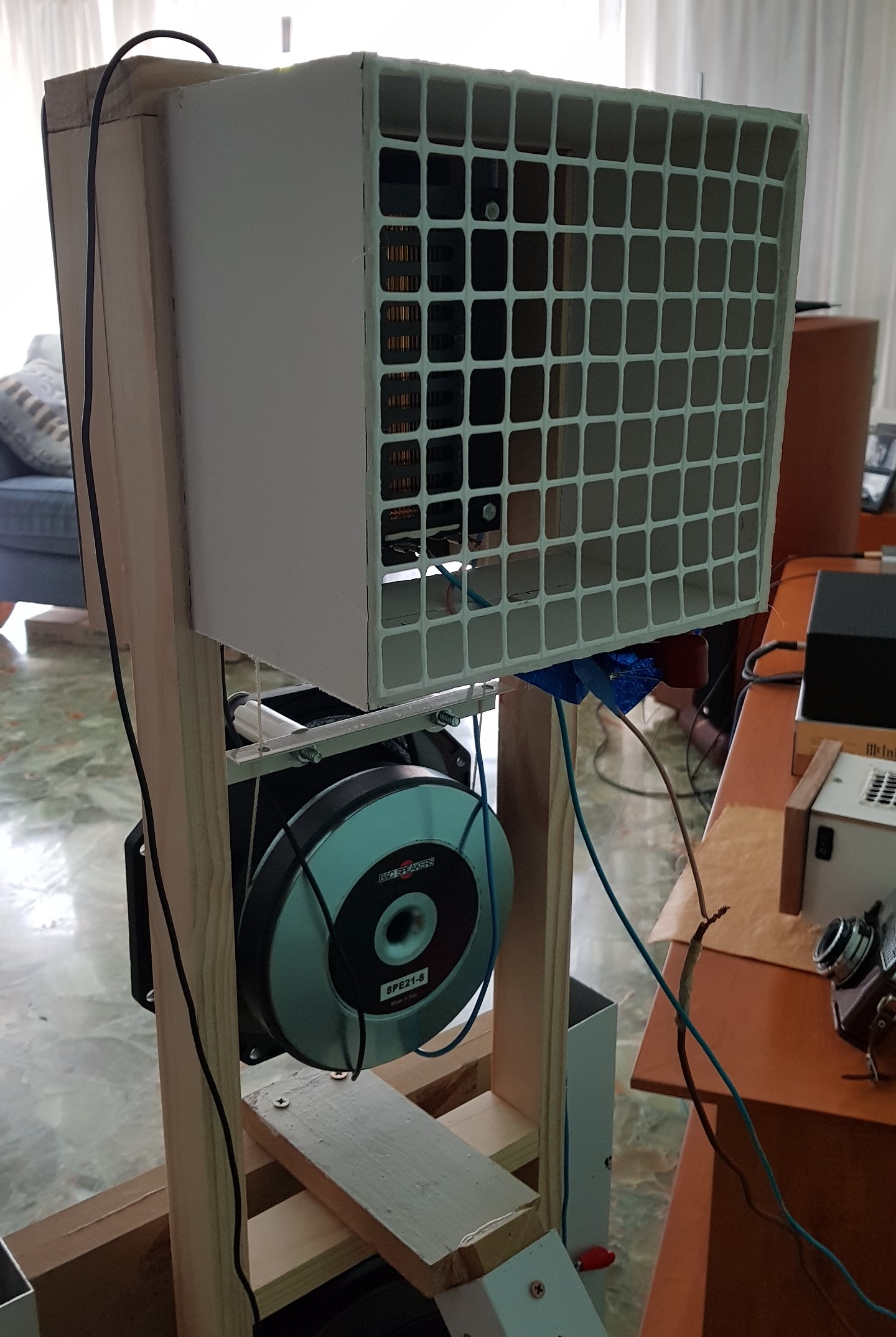

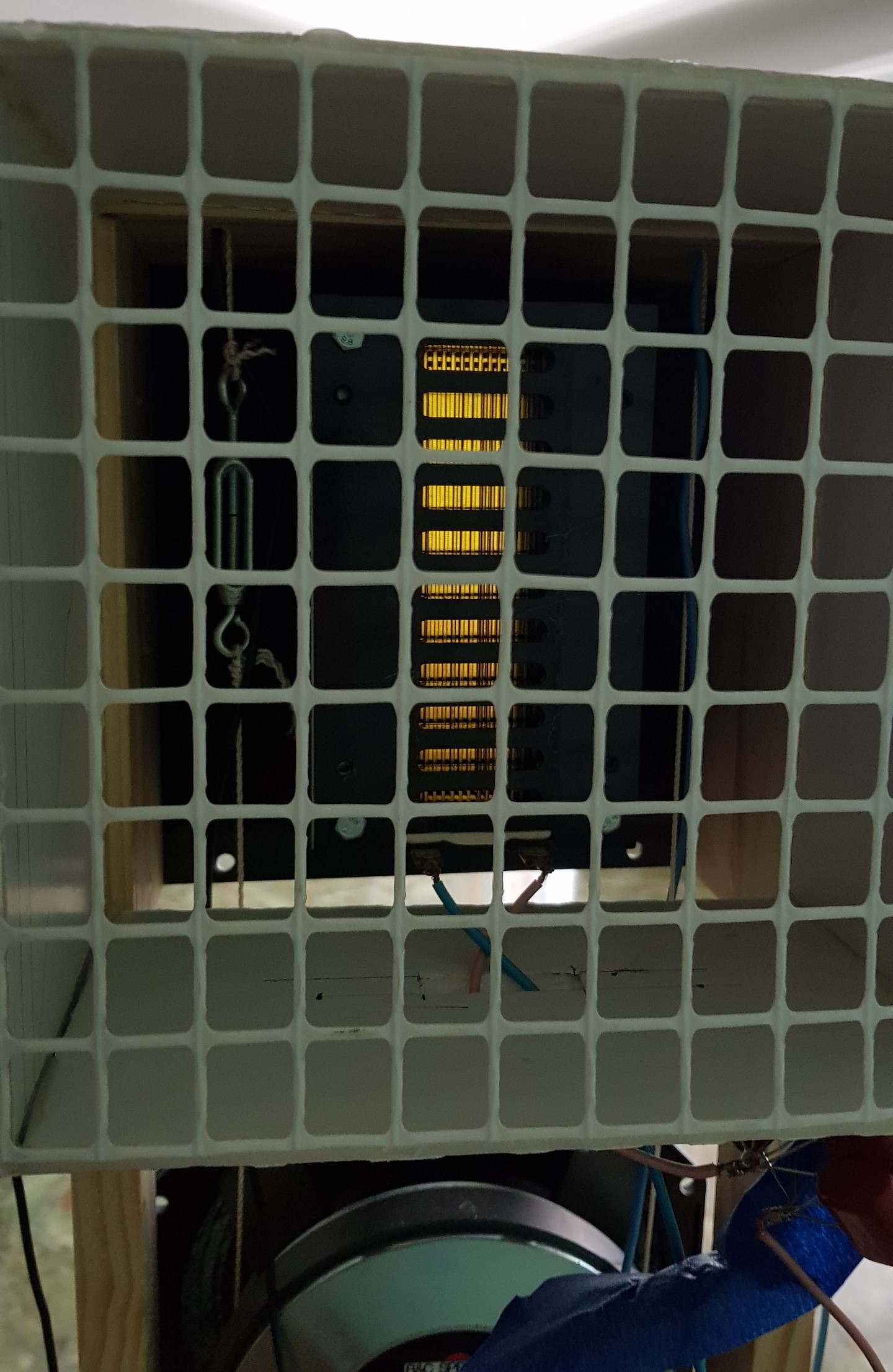

Yesterday I went ahead and removed the back chamber in the TPL and assembled a quick foamboard box around the back with an open back, yet I glued a plastic fencing piece to prevent large objects to get close to the magnet/membrane.
So now I have a waveguide on one side of the AMT and open on the other. Still not symmetric dipole.
Been doing some listening and I like what I hear. I have not remeasured and adjusted the filters.
It's fun to hear treble from the back of the speaker. Has taken me by surprise a couple times while doing something else on that part of the room.
More listening needed :D
