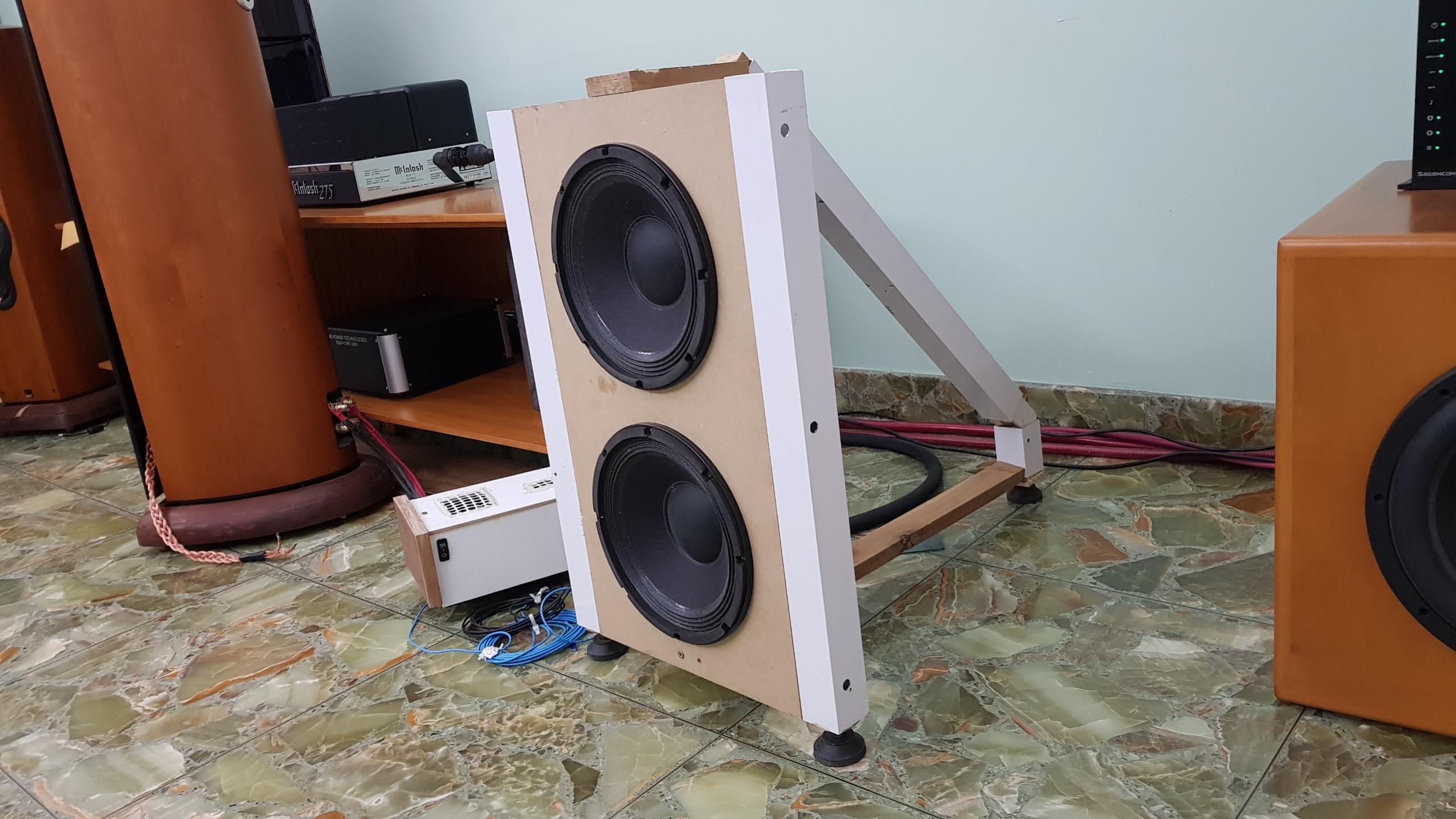

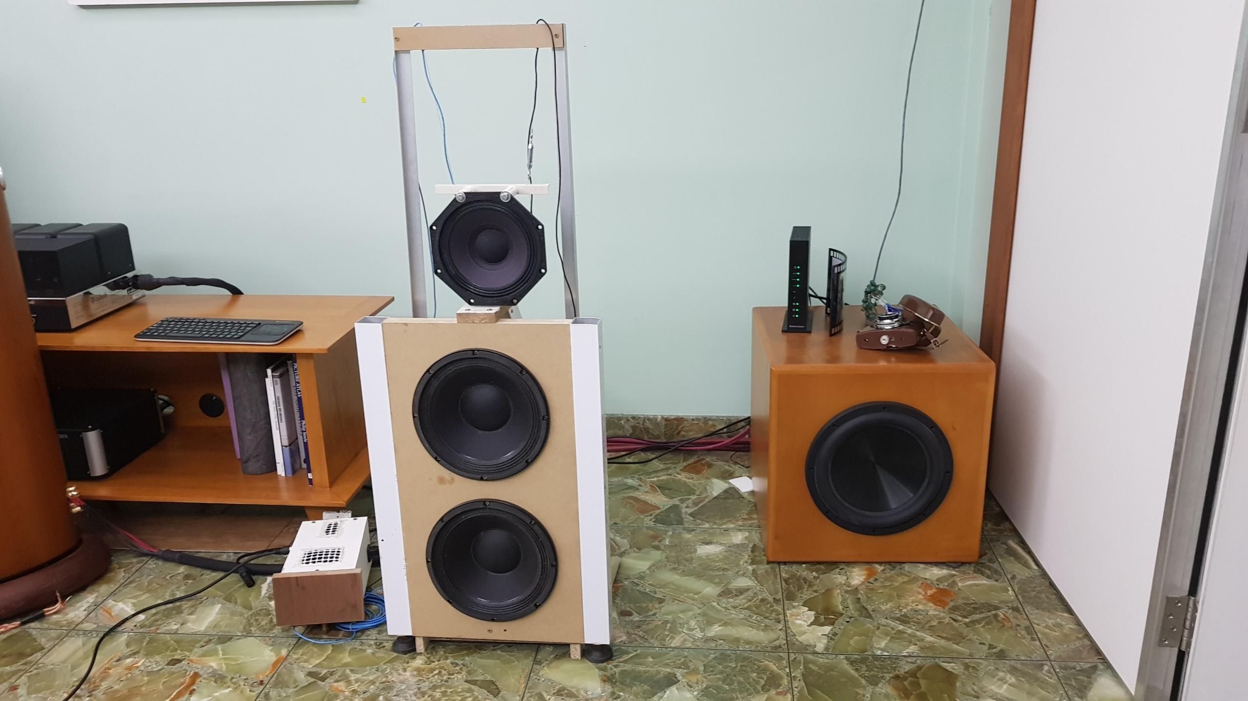

Added the third leg to the baffle so it is now free-standing. A little progress.
Unfortunately my Lynx Hilo soundacard has developed a failure which I've been troubleshooting with Lynx support, but seems I will need to send to them - that means a long waiting time since I'm in LatAm...painful. And imparts a delay on the project.
Anyway, looking into building an H frame to hang swinging baffleless 8" midrange and make makeasurements with a 2-way soundcard meanwhile.

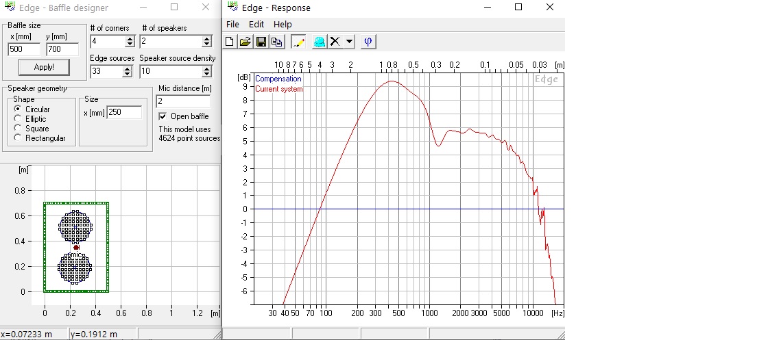

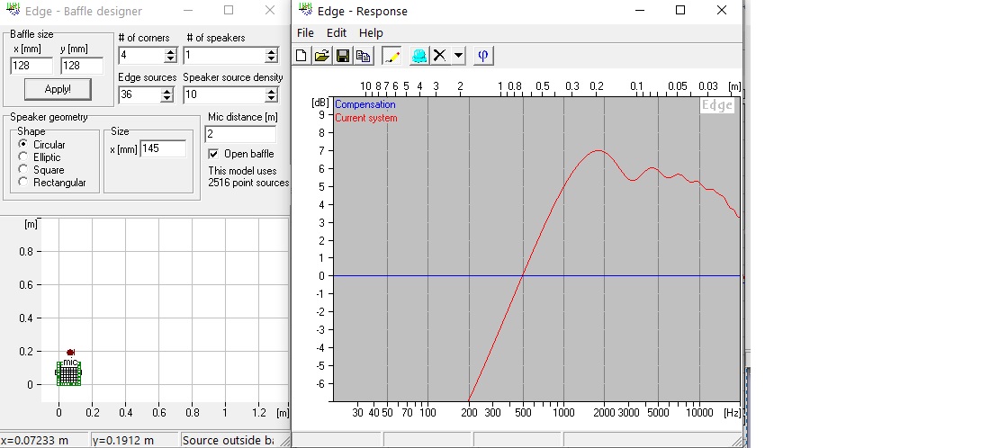

Attached the Edge simulations for 2x10" on the baffle and 8" baffleless. The latter is simulated as 145mm diameter since that is the cone diameter (without surround), and the square baffle has the same surface as a 145mm diameter circle.
From the sims it looks like the 2x10" on baffle should be ok up to 400Hz, and the 8" bafleless should be ok from 300-400Hz up to 1800Hz or so. Would you agree?
BTW, how do you graph two curves in Edge?

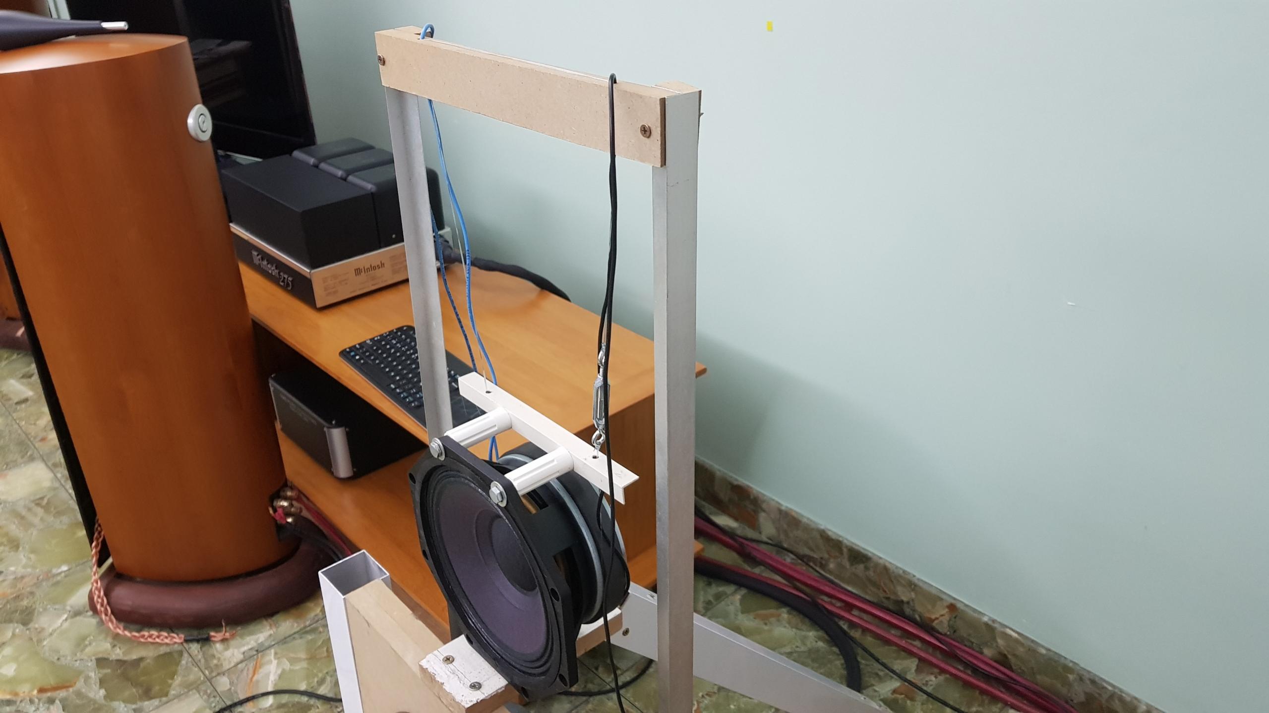

Midrange on swing
Inspired by threads I've seen, particularly mige0, I did a dirty test to keep the midrange baffleless and on a swing. The 8PE21 has about 3mm to the piece of wood attached to the 10" baffle. This is a test with materials I had at hand. Hanging on fishing line is on for a test, but I would think it will creep over time, so to be replaced with steel cable eventally.
The intent was to be able to measure the double 10" OB and 8" baffleless.

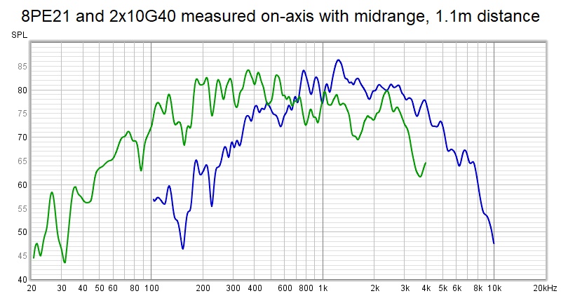

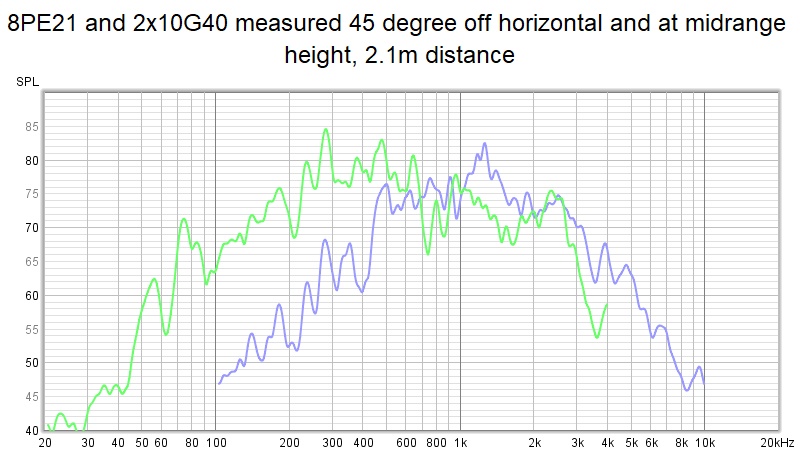

I ran some mesurements...indoors...live in an apartment and can't easily do this outside. Does this render everything I measure useless?
Attached the measurements of the 8PE21 baffleless, on a swing, measured on-axis and at 45 degrees horzontal. I applied 1/12 smoothing so we can readily see the 6 dB/octave slope. Nice to see it confirmed, BTW. It seems to me this could be ran from 300 to about 1500 or 1800Hz. Dipole peak is around 1500Hz. What do you think?
Also attached an overlay of 2x10G40 and 8PE21 on axis, and another at 45 degrees horizontal. Promising for the twin 10" to run from 60 to 300Hz (15 dB compensation required, dipole peak at 400Hz), and have the 8" from 300Hz to say 1500Hz (about 10dB compensation).
Eager to get your feedback!
PS: Thanks Juhazi for the tip on Edge!

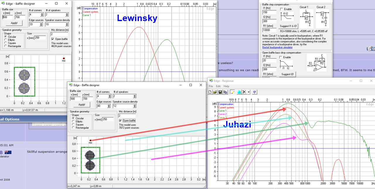

I wouldn't lowpass above 800Hz, too much variations above 1kHz!

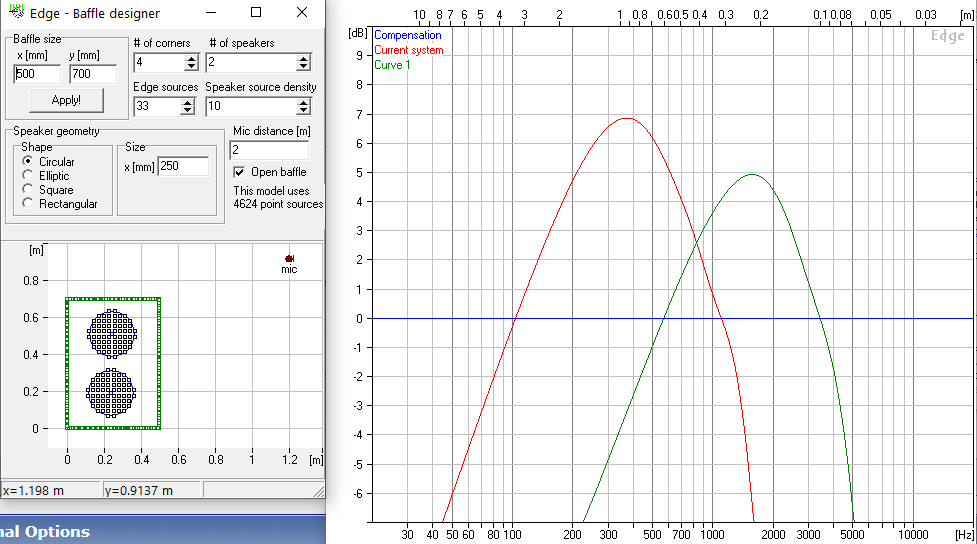

Why is mic so high in Edge sim? There is cancellation because of vertical source distance showing. This is real, but I wouldn't design anything based on that. Always take on-axis sim first to see "ideal" response. Off-axis sims are useful to find out where and when directivity gets messed up.
Attached is my sim with mic on mid-driver height and above it like in Lewinski's sim.
