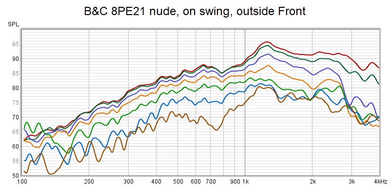

I was able to run outside measurements of the B&C 8PE21 on a swing, 0 to 180°. Driver and mic were about 2.2m above ground (this time concrete). It was windy again, in fact quite windy. The driver balance with about 2cm amplitude (1cm each way), and the mic moved too.

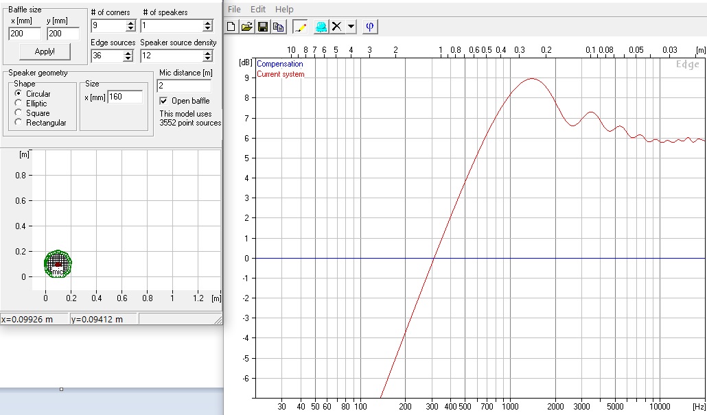

Simulation on The Edge:
Front measurements 0 to 90° at 15° increments, with 1/12 smoothing applied:
Seems well behaved. At 300Hz it's exactly 6dB down vs 600Hz. I was hoping to be able to xo at 2kHz, but it might be too high, looking at the drop at 2kHz and 45°. Right now I'm crossing at 1.5kHz.

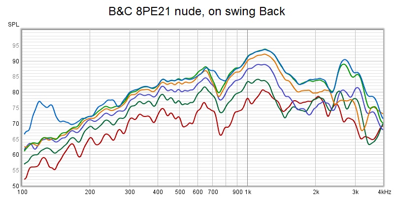

Back, 105 to 180°:
Kind of as expected for a driver with such a large diameter motor, not as clean as the front. I guess the dip around 800Hz is somehow related to that. And drops fast after 1.5kHz.

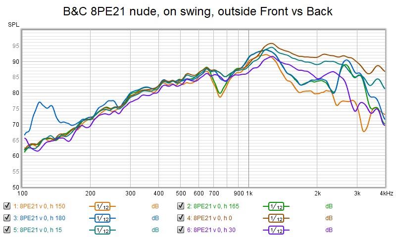

Front vs back:
The higher response at the 180° measurement at low frequencies must be wind, which was picking up towards the end. In fact I decided not to measure the tweeter because of the wind.

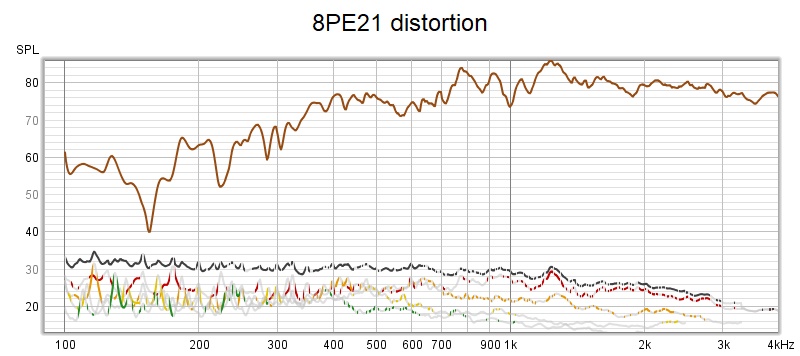

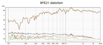

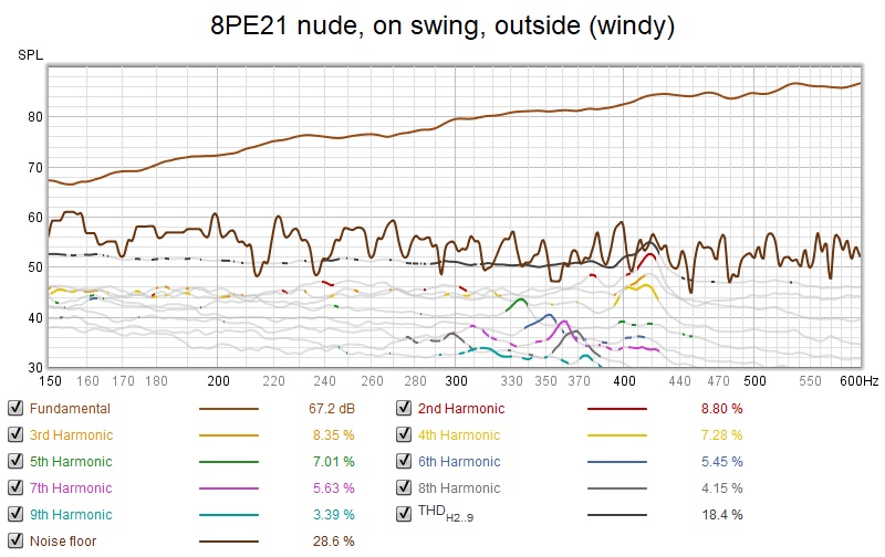

This time measurements were done at 90dB (vs 75dB last weekend for the 18"). Here's the distortion plot of the on-axis measurement:
I think the noise floor (wind) was just too high to arrive at any conclusions. According to the graph, at 300Hz THD is about 30dB below signal, but don't know if this measurement is to be relied upon.
Thoughts?

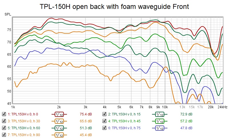

Today I measured the TPL outside. It was 2.2m above a hard floor, with no other nearby surfaces. It was windy again, but at least the TPL is not on a swing.
Front measurements 0 to 90°, every 15°, with a protection cap at 1.1kHz approx:

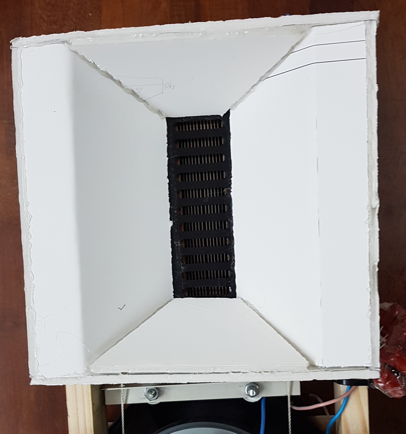

I assembled a simplified foam wave on the back, with similar depth to the Beyma waveguide:

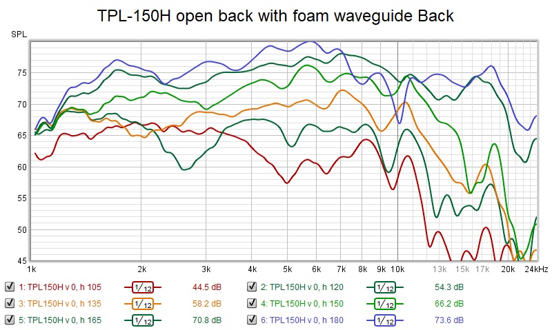

These are the back measurements, 105 to 180°, every 15°:
Seems response is fine above 7kHz, which was mentioned before as a threshold for meaningfulness for the back wave.
Would you agree 1.5 to 1.6kHz should be ok for xo, and dipole behavior seems acceptable?
