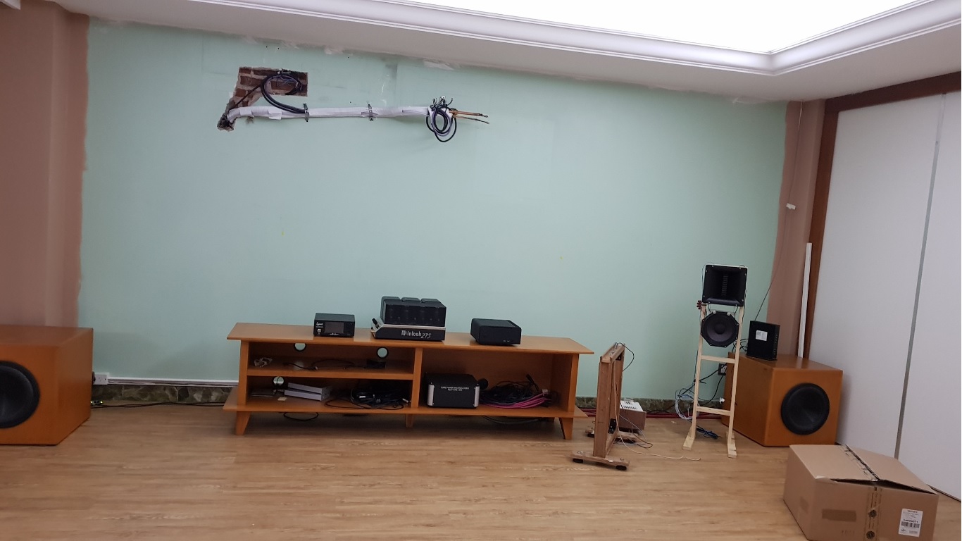

Right now my system is disassembled because of contractors working. I've introduced the nude 18" midbass on a swing, lowered the tweeter/mid structure, and added the back waveguide to the tweeter. Quite a bit of changes. I should remeasure with Acourate to get new filters and do some listening.

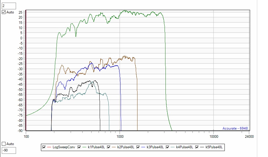

I was using 80, 500, 1500Hz xo with NT2 (with the twin 10" on open baffle). Thinking of using 70, 350, 1600Hz NT2. Measurements of the 8" on #118 don't show much difference in distortion at 350 vs 400Hz, although I might need to remeasure distortion indoors because of the influence of wind when I measured the 8".
In deciding where to xo the midrange I measured distortion per Uli Brueggemann (Acourate) wiki pages:
Interestingly, between 300 and 400Hz k3 is higher than k2. Dunno if that's a significant factor. But k3 is 45dB down from k1 even at 300Hz...suggests 350Hz would be just fine for this 8" running nude?
I'll run the same for the 18", although it would be good to get a grip on the interpretation of the graphs before progressing 😱
I would think the 18" wouldn't display that much distortion at 70Hz and these SPLs, but I guess it's worth verifying.

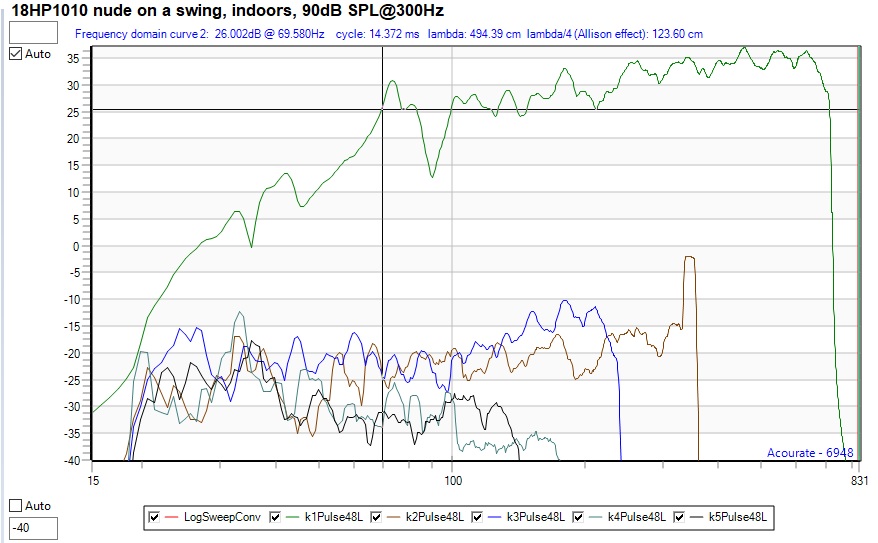

I went ahead and applied Uli's approach to measuring distortion (like in #127) to the 18HP1010 nude on the swing, measured at 90dB SPL (at 300Hz) indoors:
Worth noting the 13dB trough at 90dB, clearly a room effect that I'm hoping is significantly mitigated with the awaited room treatments.
In terms of distortion, it stays low into the lower registers so the limiting factor seems SPL, or how much correction do I want to apply between extremes? 70Hz looks like a safe bet.
So will remeasure and create xo at 70, 350, 1500Hz NT2.
Opinions welcomed!
Opinions welcomed!

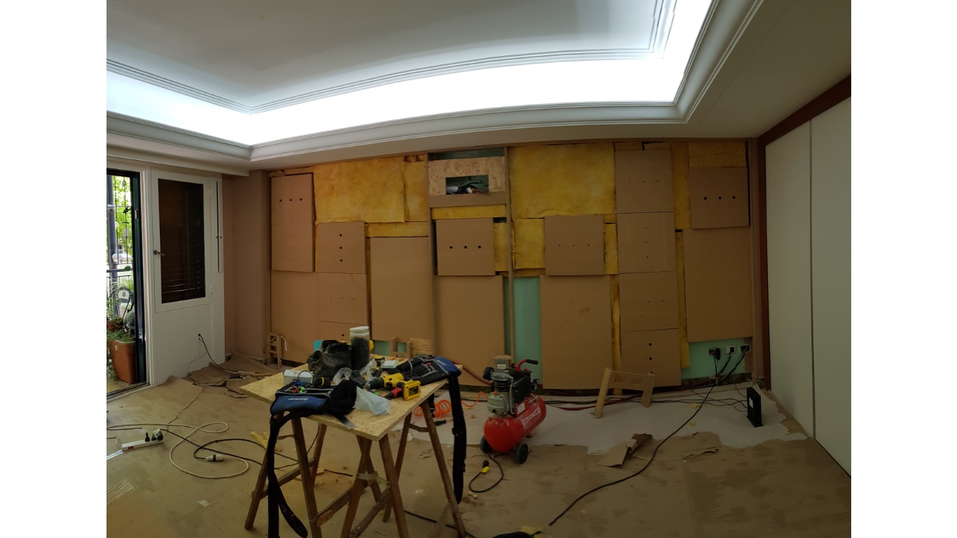

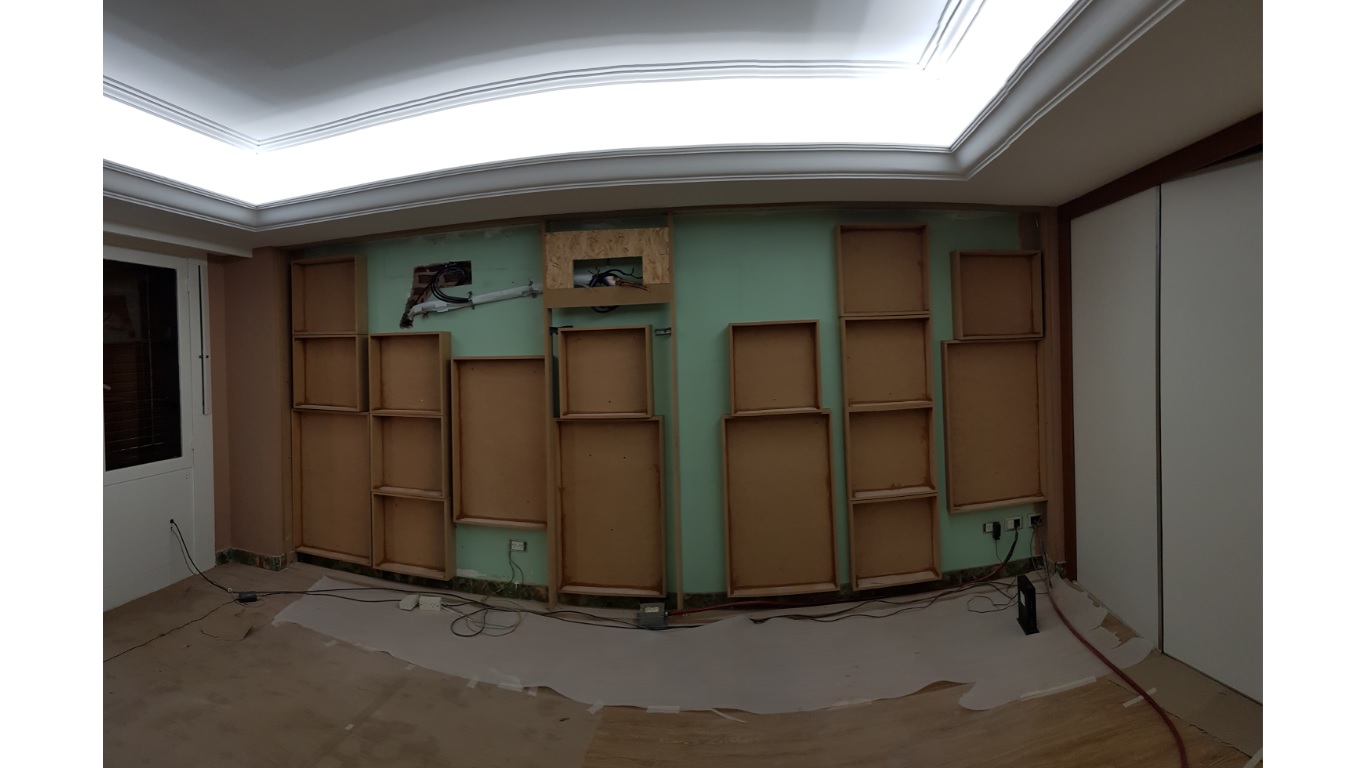

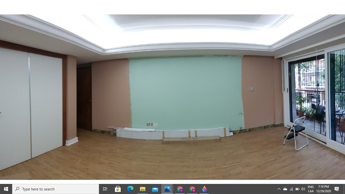

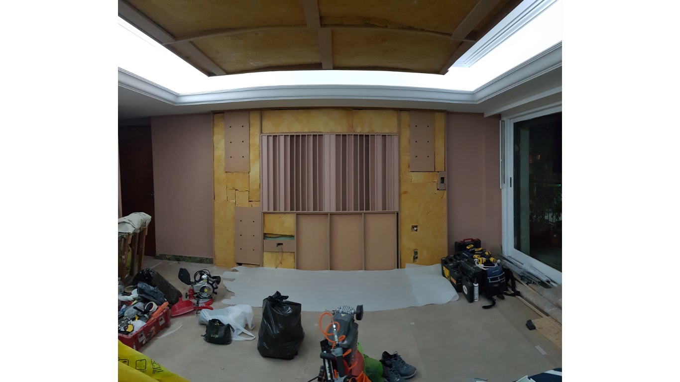

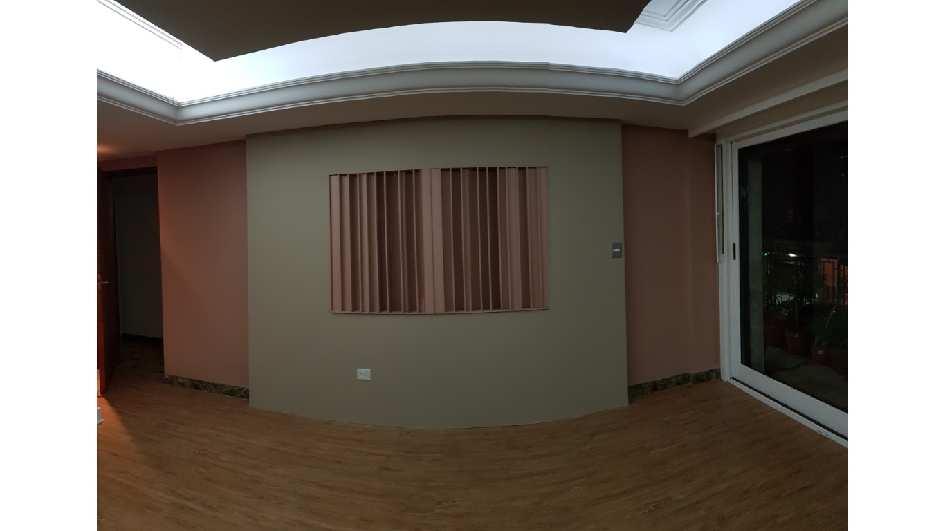

Treated room
Finally, the room is basically done. Treatments are in, only some smaller aesthetics aspects need to be tackled.
Original dimensions are pretty bad: 5 x 5 x 2.4m. In reality the room opens into another 5m room, so 5x10 with open white panels. Lot's of bass traps tuned at 35 and 70Hz, and some broader range bass traps too. 3 walls completely covered (front, back, ceiling) with 17 & 20cm panels.
Happy this is finally behind me. And wife is happy!
